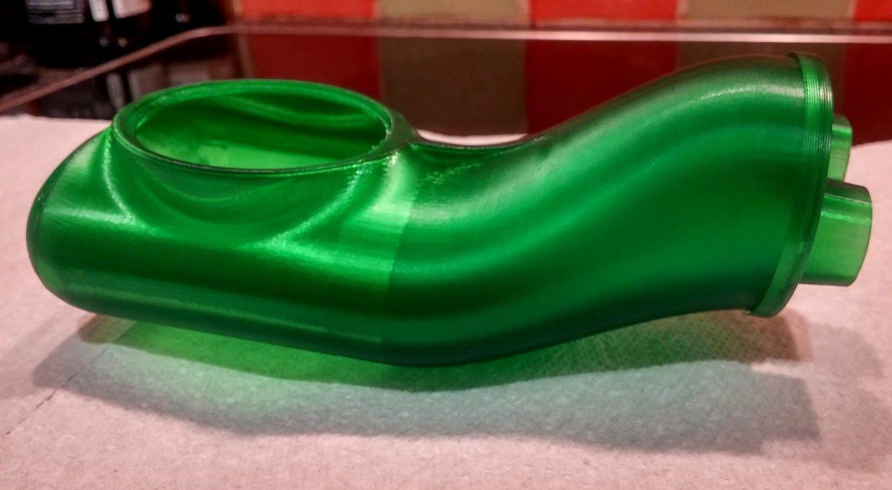

Are you going to drop the STL in the useful 3 D prints thread.Well I'm hooked. I can hardly believe I was able to do this at all and it came out bang on target first attempt.
A 12 hours this is never going to be a production machine but for one offs like this (maybe 5 off) it is ideal.
Just took a flying guess at 2mm wall and relatively standard settings for PETG. The surface finish is excellent, almost satin gloss.
Now for the lid then hopefully some more interesting designs...

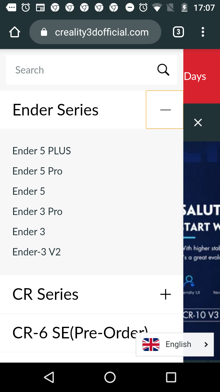

I bought one anyway. Ender 3X 3D, direct from Creality, shipping from Czech, £169.
I'll order up some PLA (?) separately since they want $44 for 2kg which seems high.![]()
Do you have a link to the one you bought? I can't find at that price nor a shipping to the UK option.
Easy to tell - the Y axis extrusion on a E3 Pro is 40x40. It's also got a more efficient (and CE approved?) power supply.I think the 3X is a 3 Pro
I don't think it is the same. Check the extrusion the bed sits on (20x40 on Ender 3, 3X; 40x40 on Pro). They're both 24v PSUs but AFAIK only the Pro gets the "Meanwell" branded one.I don't know which extrusion you mean. It does have the 24v PSU which I recall wanting, it also came with a glass bed (and the fibre one).
<edit> found it: https://www.creality3dofficial.com/...fxW_DV8CKB-tAmISfP5ojpeqz0b5_PbRoCScMQAvD_BwE
The "3X" is a 3 Pro with extras.Lucky me...

It may also be that PETG is an easier material for the Ender 3, I haven't really tried PLA yet and I think I'll probably stick with PETG for now. A black reel just turned up so my prints should start to look even better, especially in the dark!![]()
PET-G is a little weird, if you hit the sweet spot it comes out beautifully, but it's a very narrow range depending on what and how you're printing. PLA copes with a much wider range of temperatures, overhangs, geometries, etc.
These airboxes were single-wall thickness PET-G and came out airtight every time but they took some dialing in to start with:
