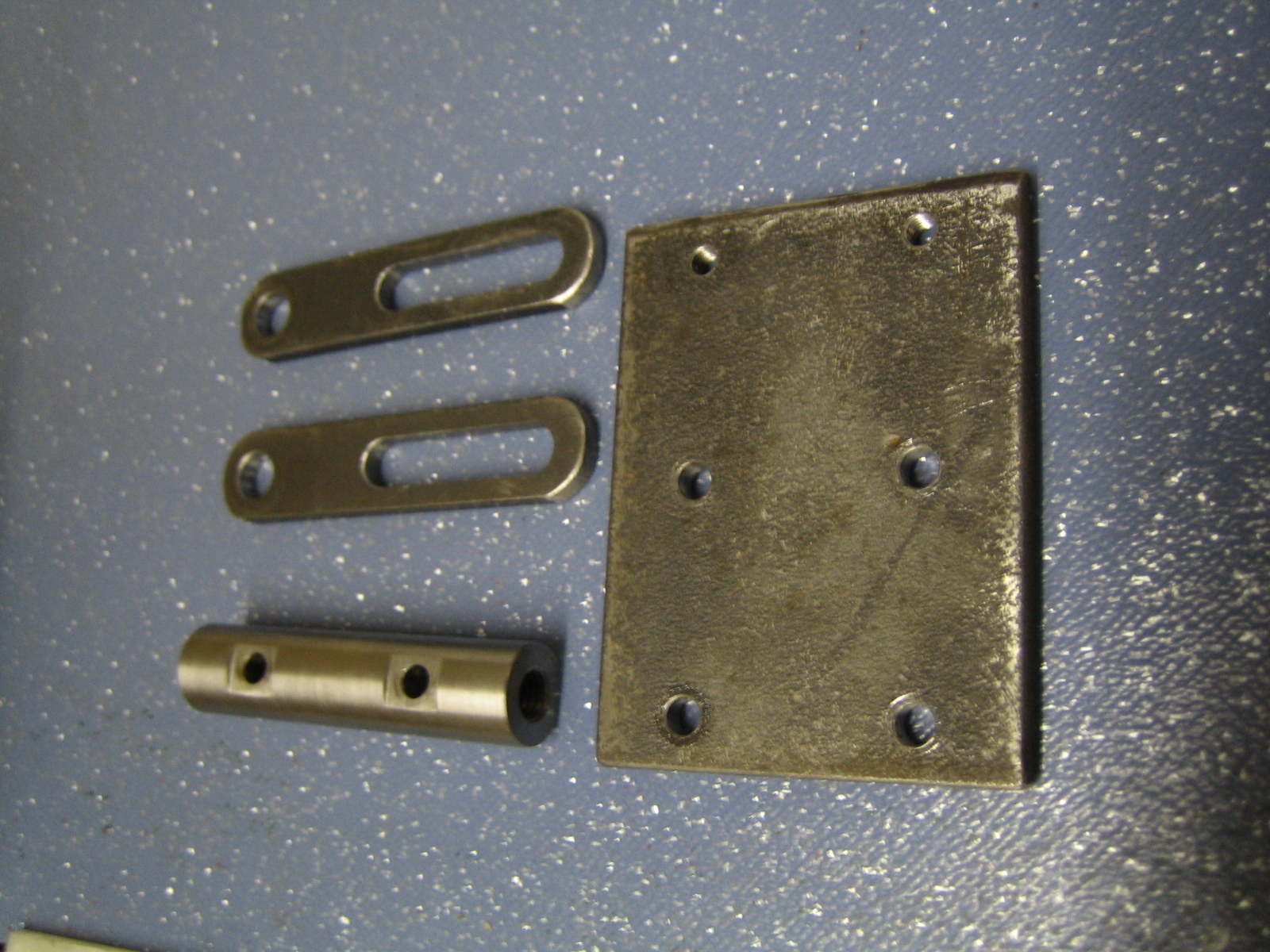

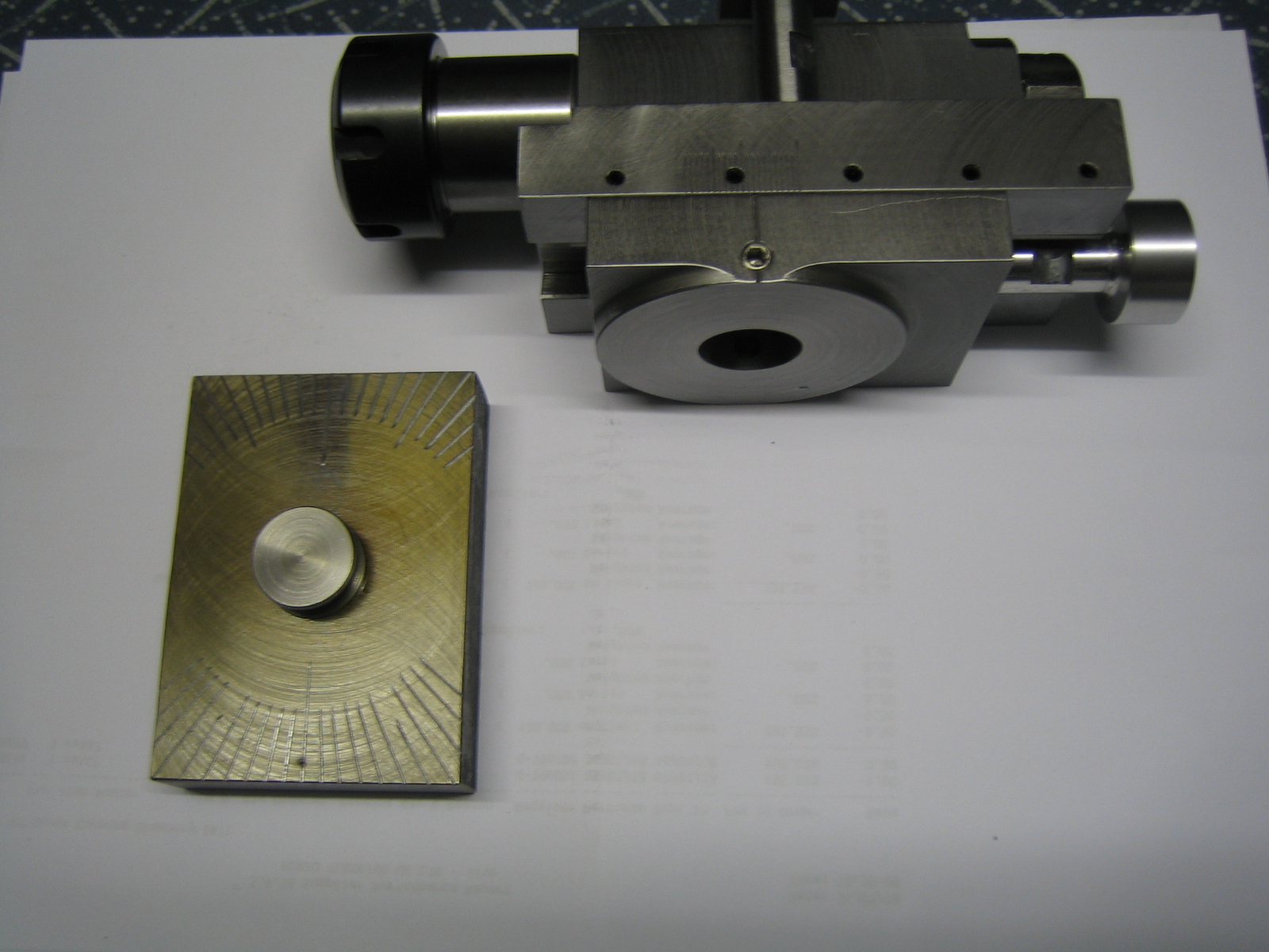

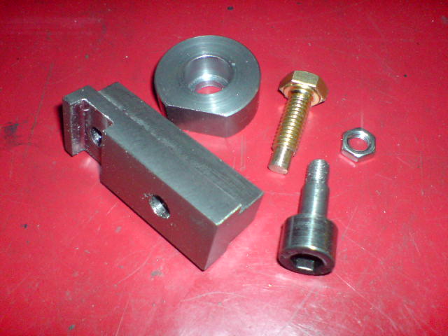

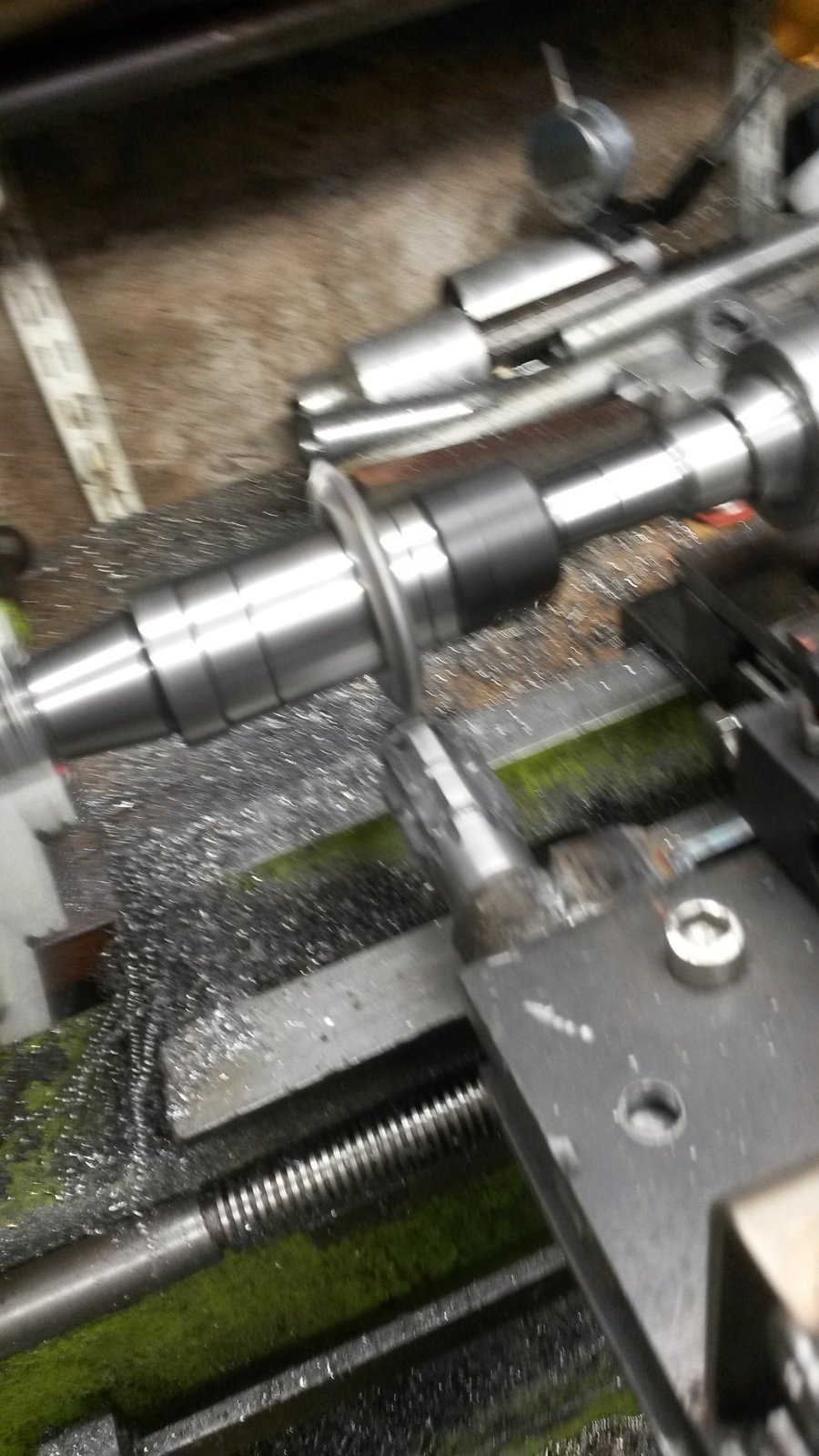

Nice Richard.These are hardly gonna set the world a light but I’m machining a some pin bushes for an old bucket linkage.
En24 bar stock. You can imagine how long that takes taking that ring out of that lump of bar on a model makers lathe lol.
Out of interest how long did this take and how did you price this?

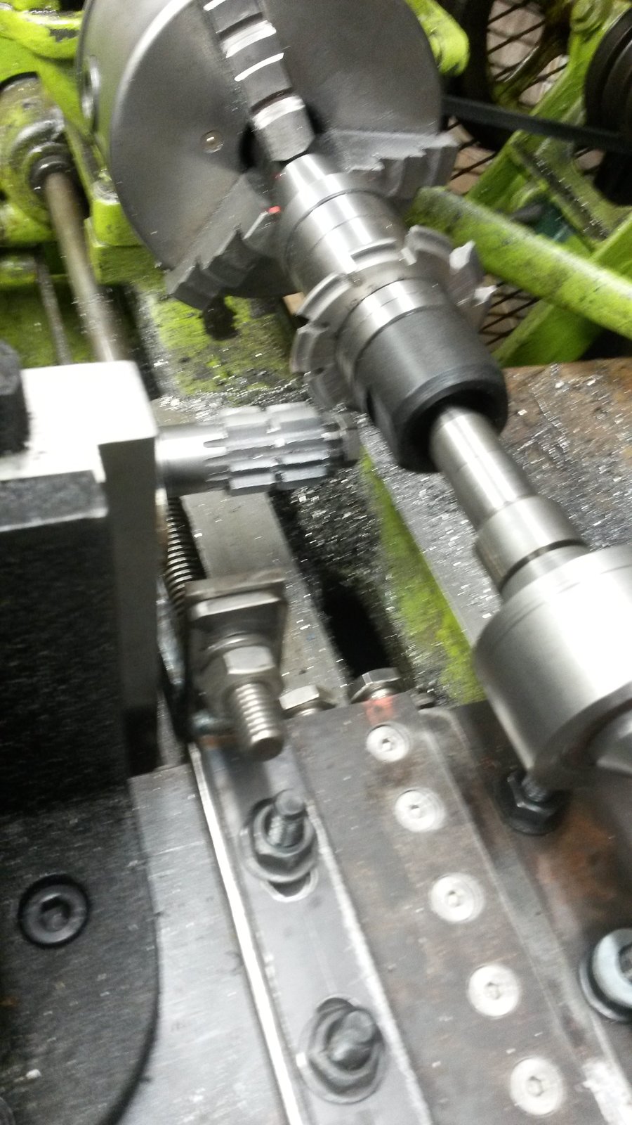

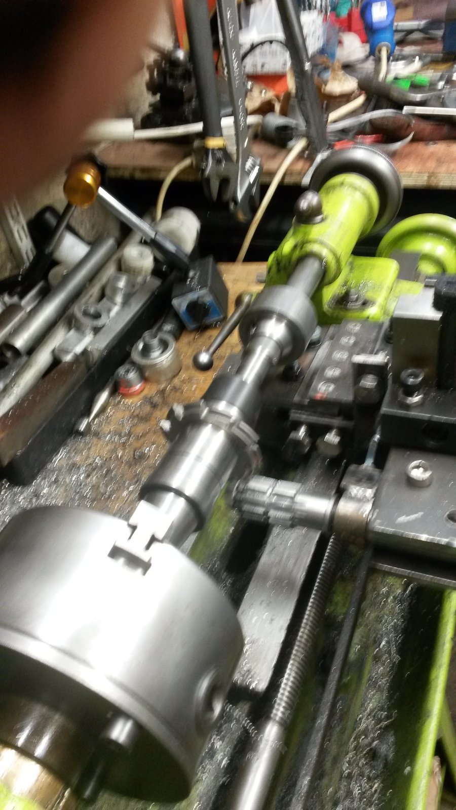

but had to machine 2 new shaft ends for a Westwood powered grass collector sweeper today. The bearings on both ends of the shaft were goosed. The pulley side was so bad there were no balls left in the bearing and it had obviously been run like this for some time as the shaft end was extremely worn. (Note I got the sweeper unit 2nd hand for £30, so worth taking the time to repair). An hour later and I had 2 shaft ends machined up on the lathe. I then had to grind off the weld on the outside of the pulley to remove the worn shaft end and a good pressed in fit for the new shaft end was achieved and welded for good measure.
