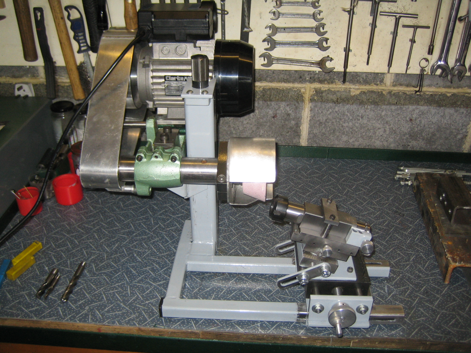

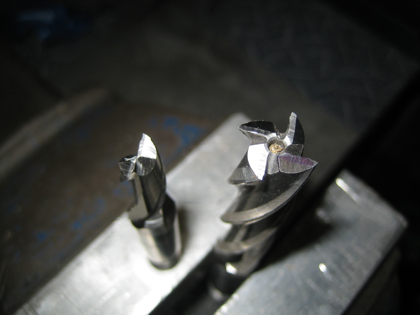

Tool Cutter Grinder results
still need to sort out grinding the sides, I have made up he guide but am not happy with the forward motion control yet.
Angles for grinding drill bits are also doing me head in, especially when I can grind them by hand easier

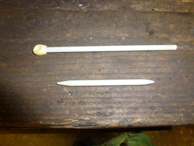

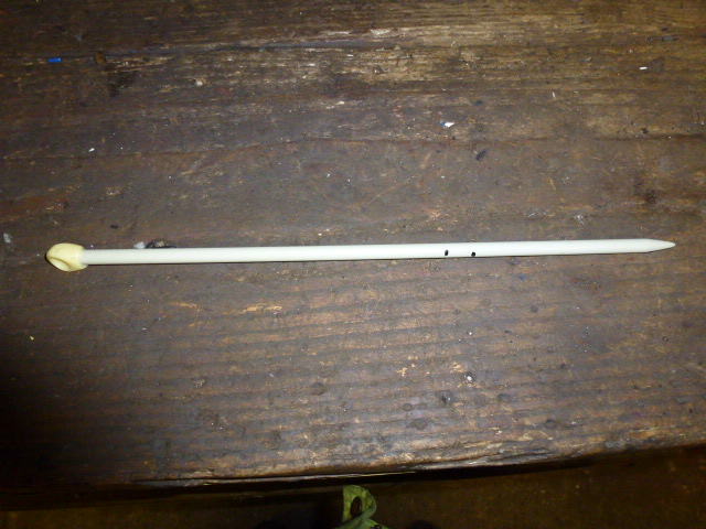

My Mum needed a cable needle for something she was knitting..........
The finished article. My Mum was amazed that I was able to put a perfect point on it, now I have to make another one from the rest of the needle! But it earned me a few brownie points, something to have in reserve!

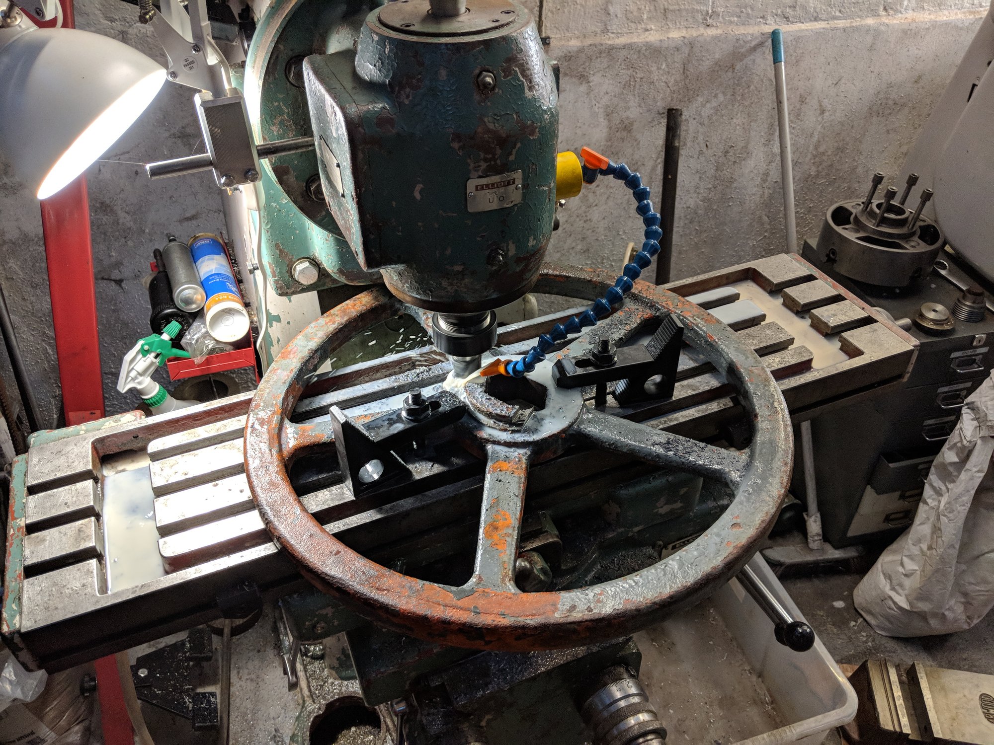

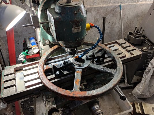

too bigger cut in one go?Milled the hub/boss off a couple big ol' cast iron valve wheels for a mate, going to make them into bases for bar stools.
I know coolant is a bit frowned on with cast iron but after it obliterated one cutter I did what needed to be done!
Will these feature in a new thread?
I know coolant is a bit frowned on with cast iron ...
I use coolant all the time when machining the cast hauler plates, not so much for tool life but more for containment of the dust/chips. Just have to make sure you clean up well afterwards or it sets like concrete. Then again even when machined dry you should clean up well as it is very abrasive.
Good point although in my case I have a very fine filter on the coolant pump output that won't allow anything like that to pass. Prior to me having that I was constantly getting the coolant on/off solenoid valves choking.
