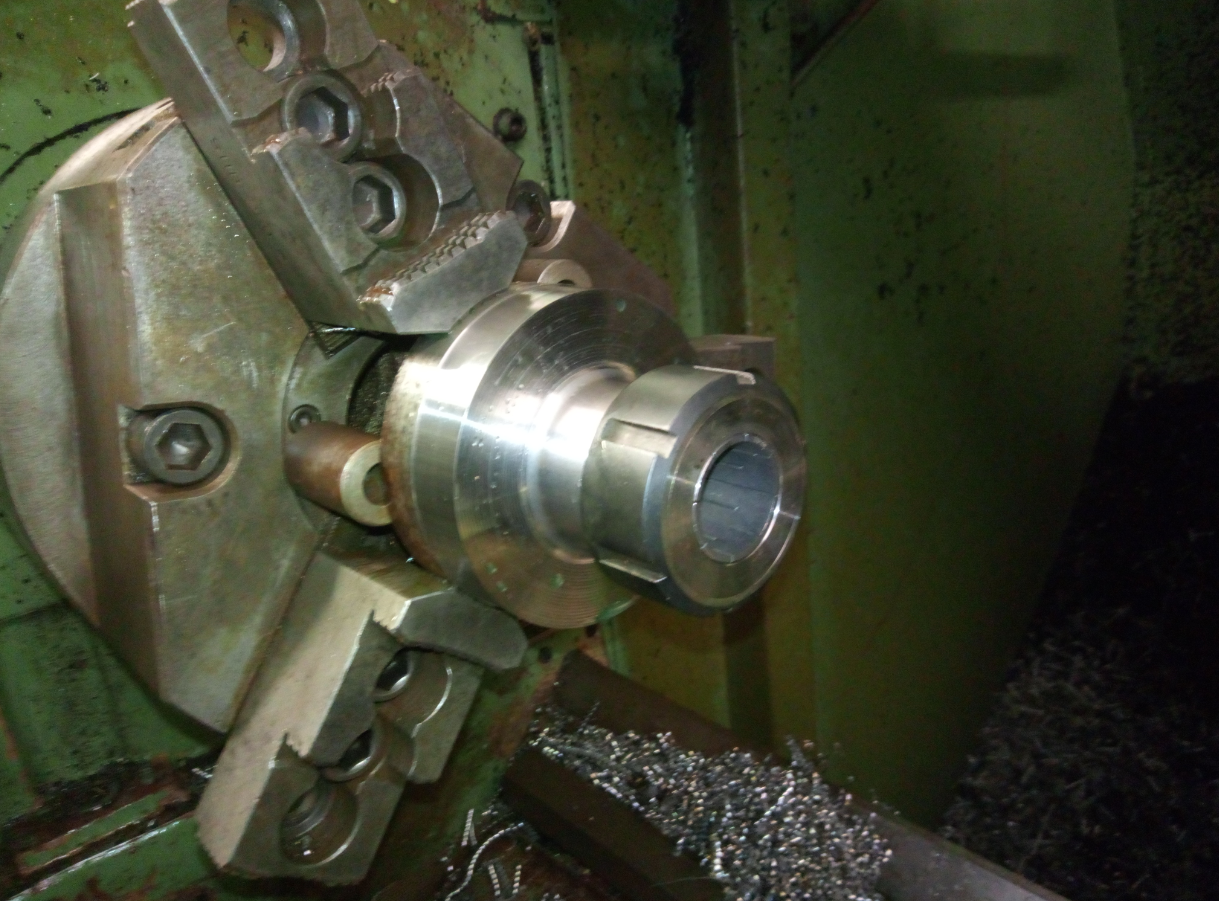

So as it was 11am I thought I will wait until I have my dinner then head up to the Cat. I had been looking for ER40 lathe collet chucks but they were all quite expensive so I had a look in the shed and found some 4" dia steel, some kind of tool steel but not sure what.

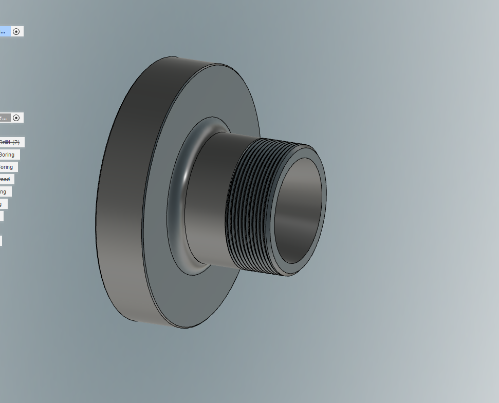

So started Fusion and drew this up.
The to Manufactirer side of Fusion for the toolpath.
Then into the CNC with the steel and made this.
Collet and nut fit fine.

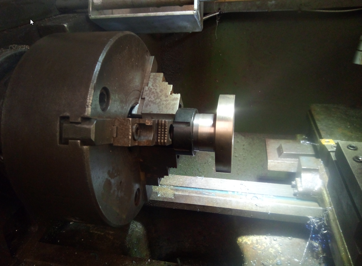

Not enough meat left to part off in the CNC so easier to just chuck in the Triumph using a bit of 25mm dia in the collet yu hold it.
So now I have an ER40 collet chuck for the lathe
I had the steel to hand so was cheap enough for me to make for myself, if I hadn't then ...Interesting to see the tolerance/concentricity it holds. You could have a job making a few of those
Seems pretty good, chucked some stainless in the Triumph and clocked it, under 0.01mm runout. Put collet chuck on the stainless and clocked it, about the same runout.Interesting to see the tolerance/concentricity it holds. You could have a job making a few of those

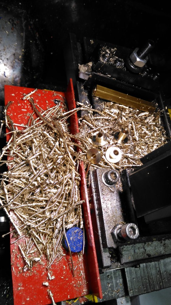

Nice! A well honed tool there. What was the doc, it looked very deep?I found time to make aome headlight mount spacers for the bike. As I choose brass I thought it'd be a good example of how to get nice swarf - almost all of it curls and easy to clean up.
I tried to video it but it seems none of my cameras work in the workshop, but when I test in the house they do
Cheers for the suggestions, I don't have CNC and the lathe VFD was not on. I have consigned the gopro clone to the bin and bought a new one. The SLR is now working so I really don't know what the problem was!Radiated electrical noise from VFD or CNC system confusing the camera, perhaps...?
