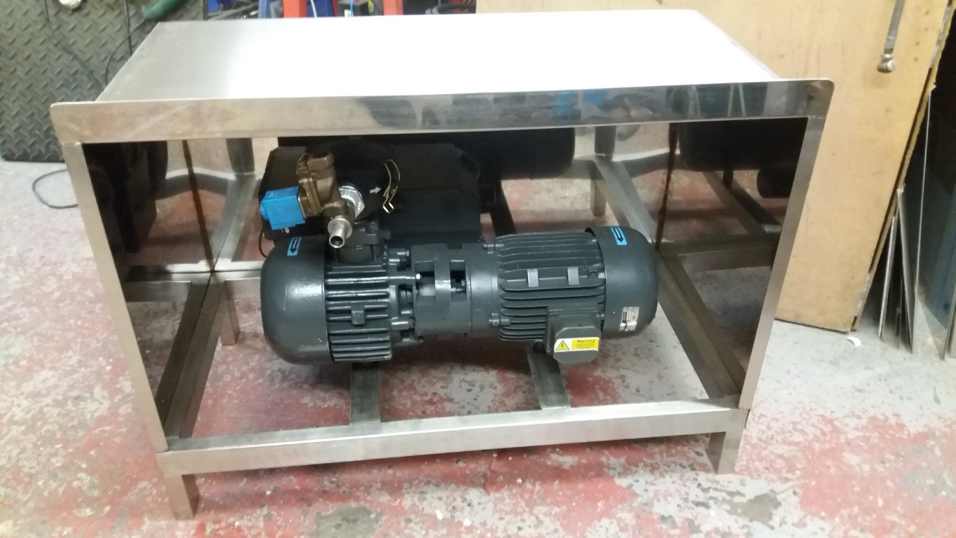

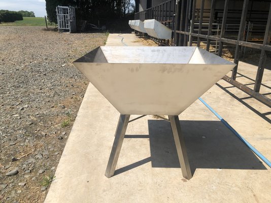

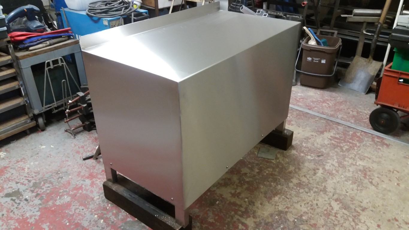

Fit some gussets inside to stop it flexing, these are autogenously welded with the tig.

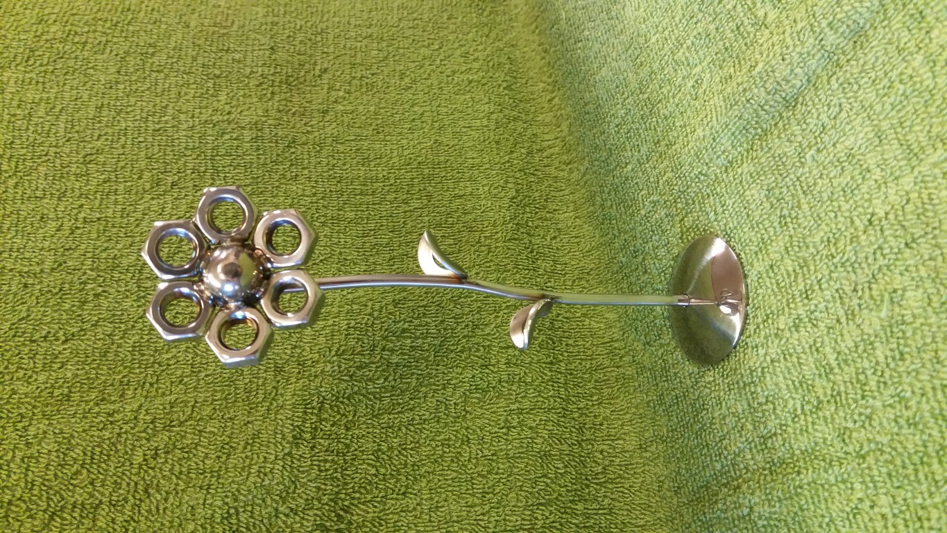

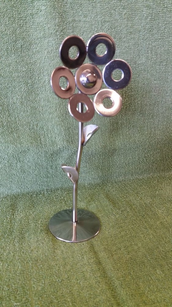

Simple but elegant.Another ornament, much more fun than proper work,
All stainless of course, M8 nuts, a dome nut for the centre, the stem is a 10swg arc welding rod, leaves are a flat washers with a bend and the base is a laser cut disc formed into a dome on the flypress,

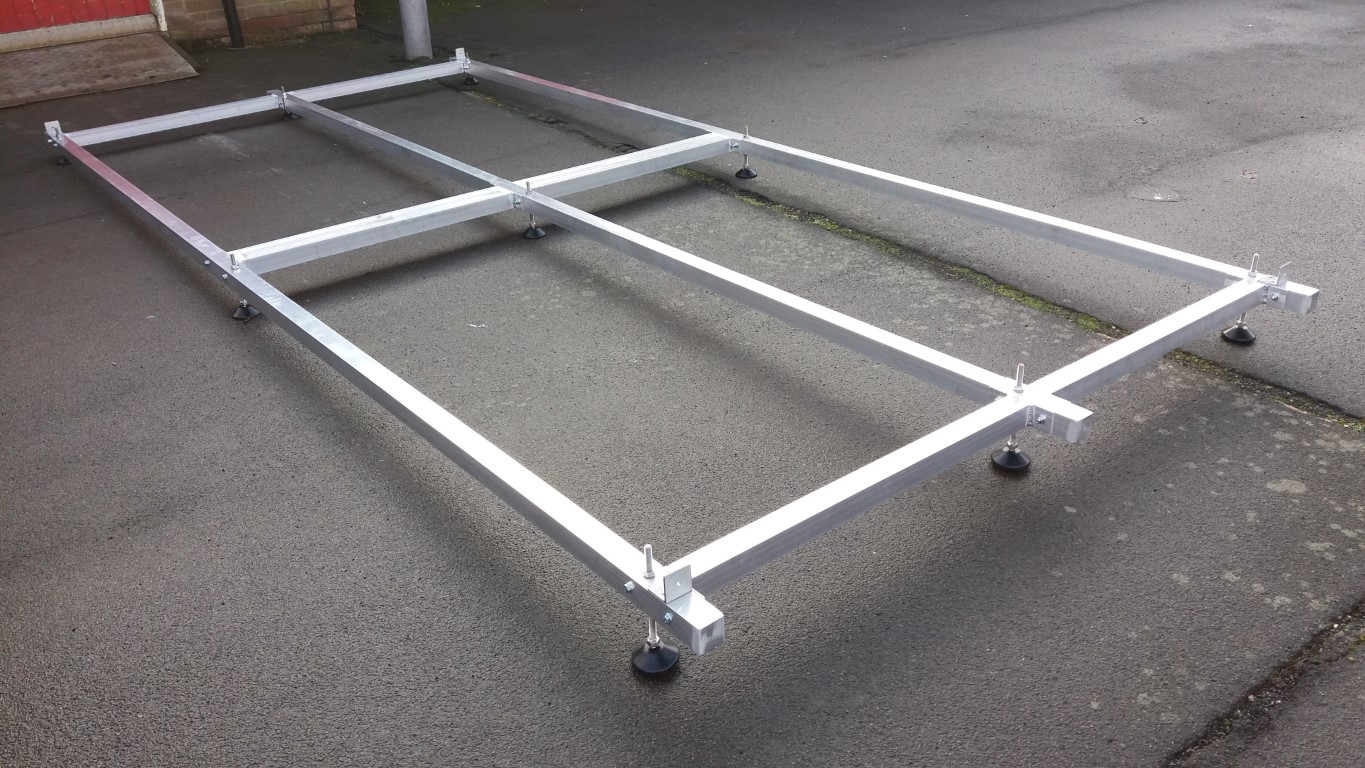

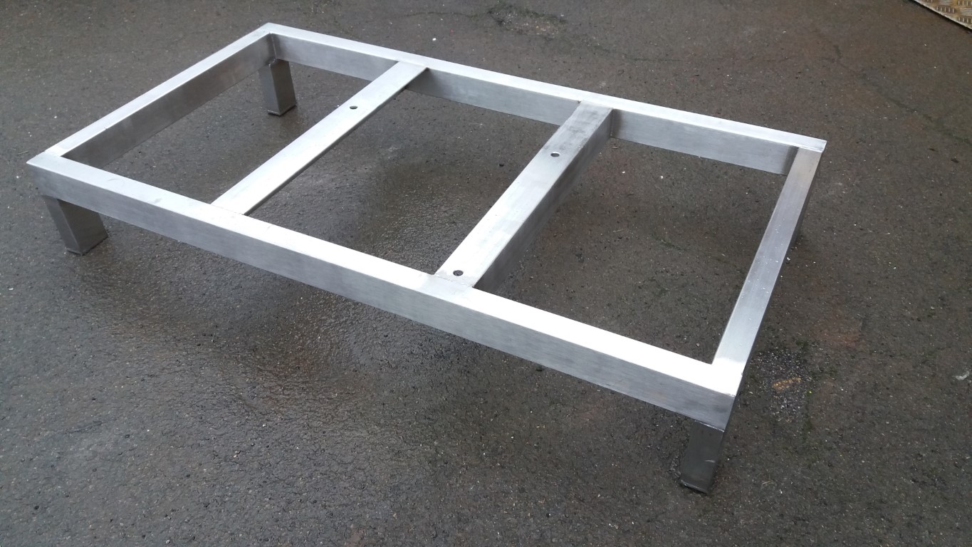

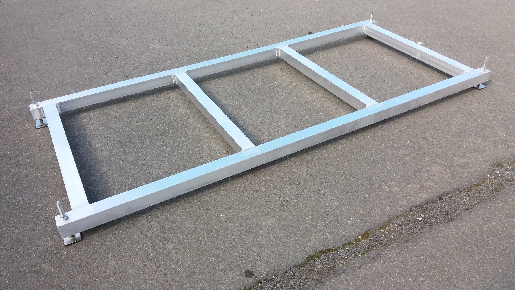

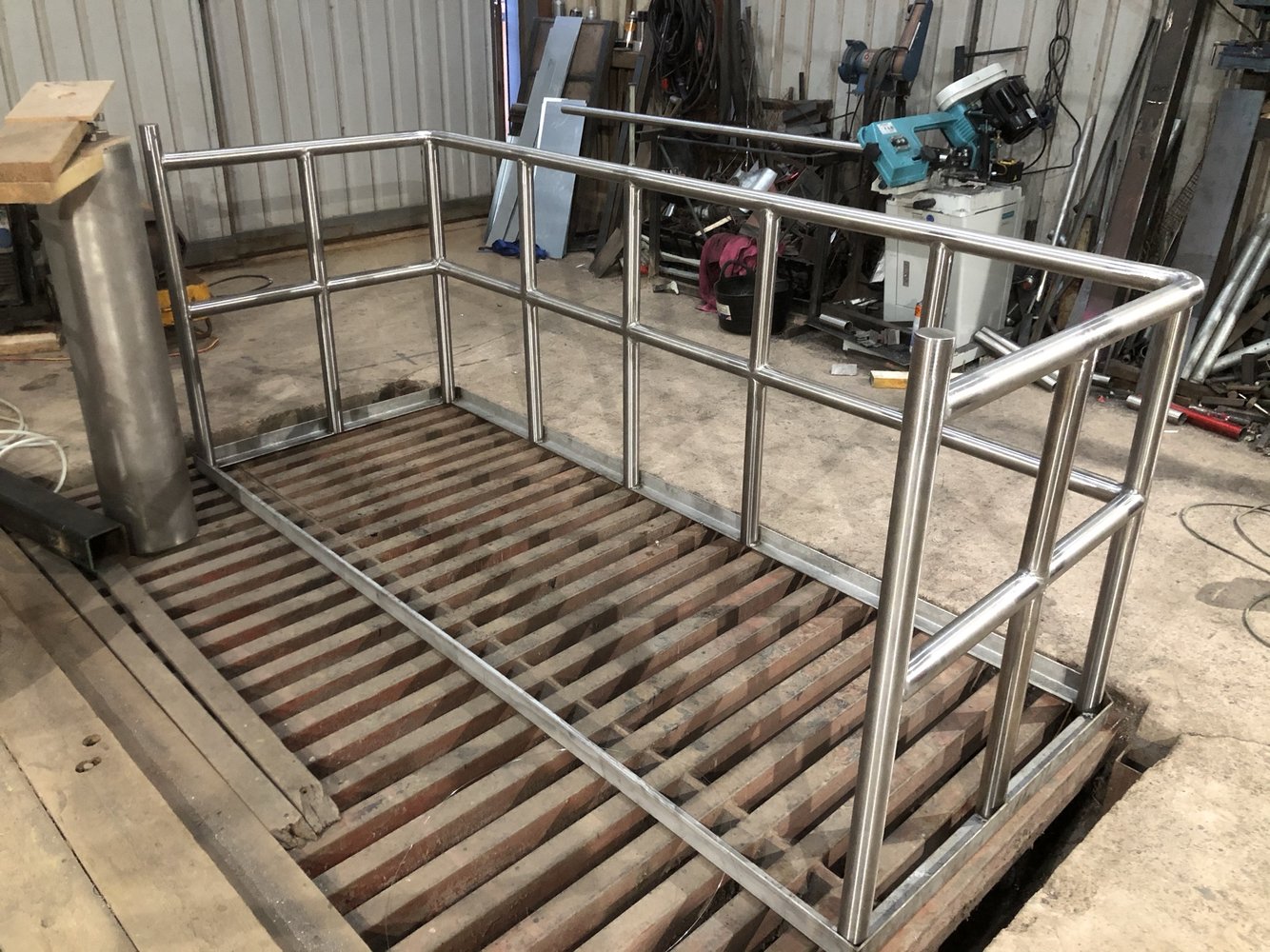

what make is the handy looking saw in the background please.Trawler shelf made from 48mm tube and 50mm angle, just waiting for the grp flooring to turn up,View attachment 276999
That’s the Axminster saw, takes a little bit of setting up and a really good blade to make it a good saw.what make is the handy looking saw in the background please.
many thanksThat’s the Axminster saw, takes a little bit of setting up and a really good blade to make it a good saw.
