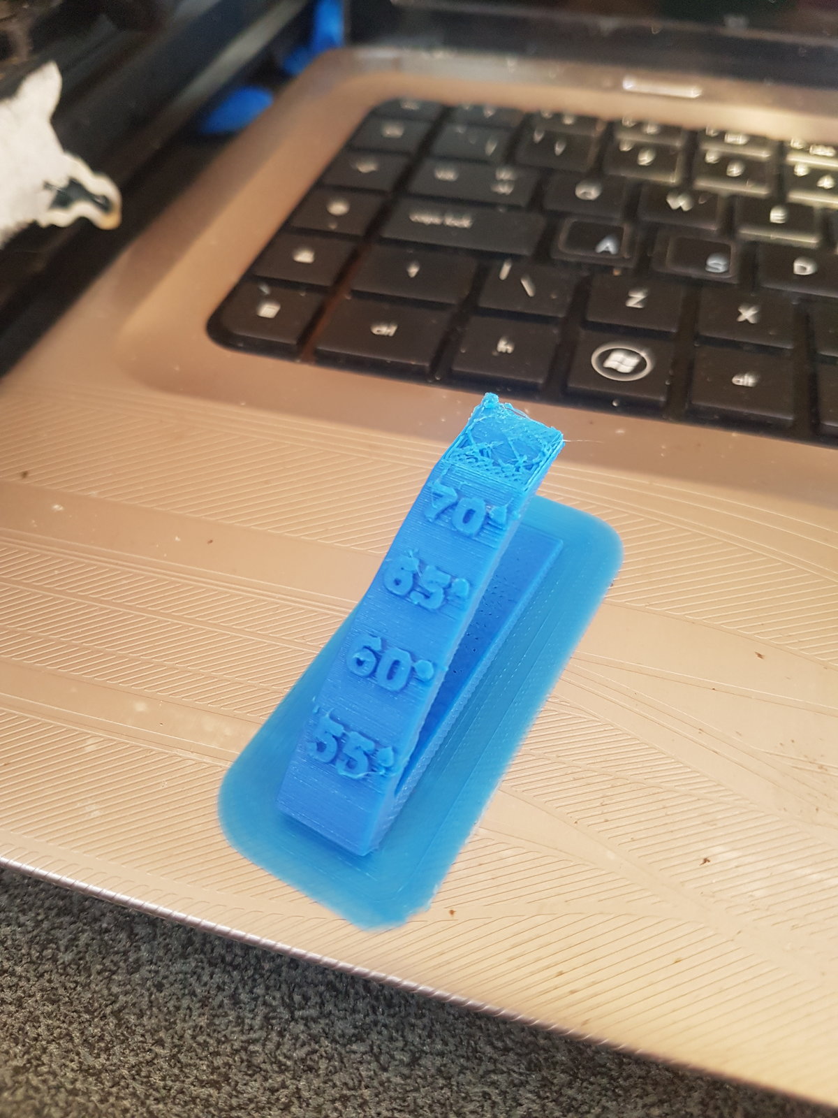

Interesting comments....that was sliced with Cura 15.02 i stead of tbe latest version.Little dinosaur being nice enough would lead me to believe it's not mechanical though, plus due to the nice progressive acceleration on each axis doing circles I find they are one of the nicer finished parts. Definitely not pretty.
That said I just installed later Cura and first print is a bit pants - one thing though I accidentally used 60mms not my usual 50.
This is why I hate upgrading things that work. Though I would give it a try but turns out maybe no benefit.
As above i used a different version of cura BUT i did have to clean the hotend due to blockage caused by too hot settings in the old version of cura i installed. It wanted to print PLA at 240 with a bed of 70.Think there lots of options for that, to fast print speed, loose drive belts. Bed or hot end not moving smoothly. Also looks a bit under extruded
Oh no...something else to learn about chords and exporting.I bet that facet look comes from the STL.
The pics from thingverse looks the same.
On a cylinder triangles won't be visible but it will be faceted if chord height is set too large when exporting to STL.
what is it??This is a bit poo but does work when supports removed
the curiosity will get to youwhat is it??
I looked but still cant tell...thats why i asked. Lolthe curiosity will get to you
I have decided that its way way easier using a lathe...lol.PLA is generally accepted to go a bit past 60 degrees so 60 is a safe angle so the results are expected
ABS apparently tolerated less
STL doesn't contain any printer info
Early cura I am still using
Later one too many setting and clearly from finishes they need tweaking as don't suit mine.
I think on issue is between settings (defaults if you like) and preferences (the stuff you configure that you prefer. I saved my old cura profile and imported it and it still messes with stuff and pointed out there the preferences deviated from settings.
