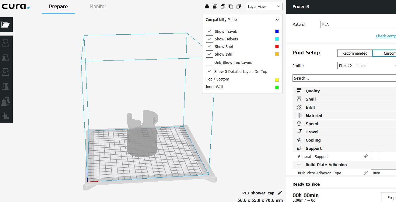

Open it in Cura and play with the settings, the design has unsupported edges so you would need Support enabled, I would be tempted to redesign it so that the support was inbuilt and easily removable when done.https://www.thingiverse.com/thing:1666671

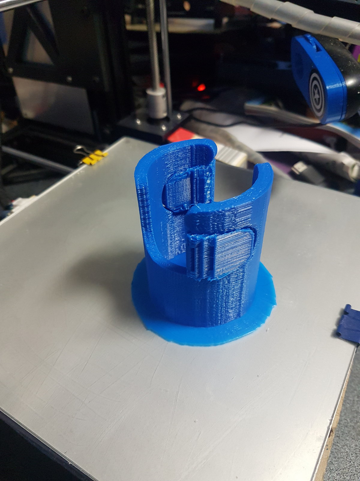

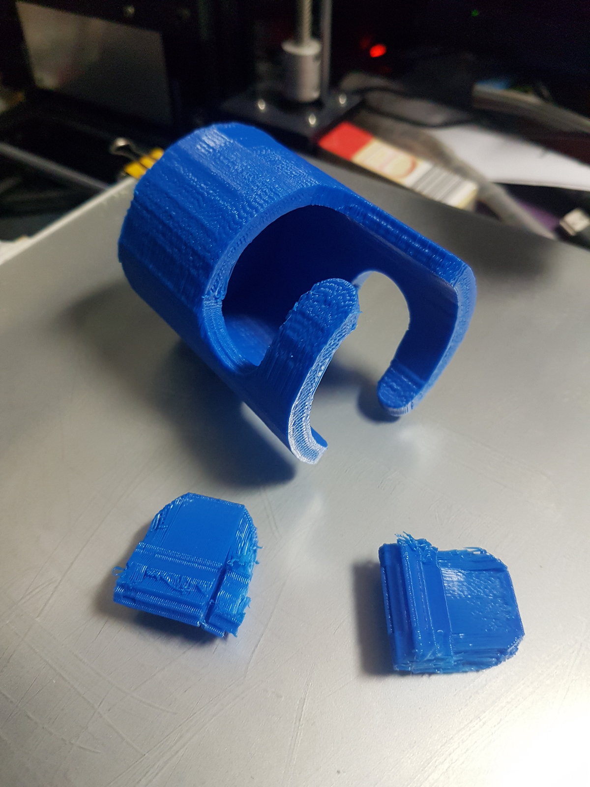

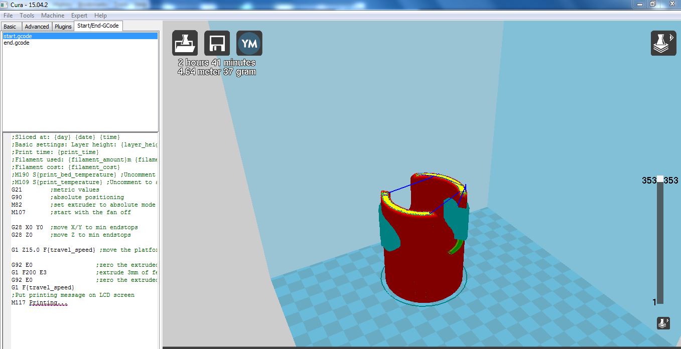

this is what I am trying to design. mine would be primitive this would be better but according to the comments it does not print correctly and as after slicing it seems like it will take 5 hours to print. so the comments might be correct.
how do I check what it will print out like?
