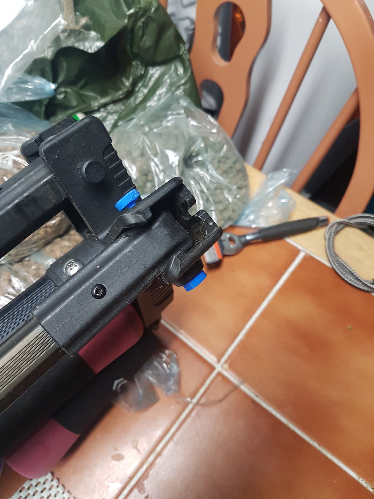

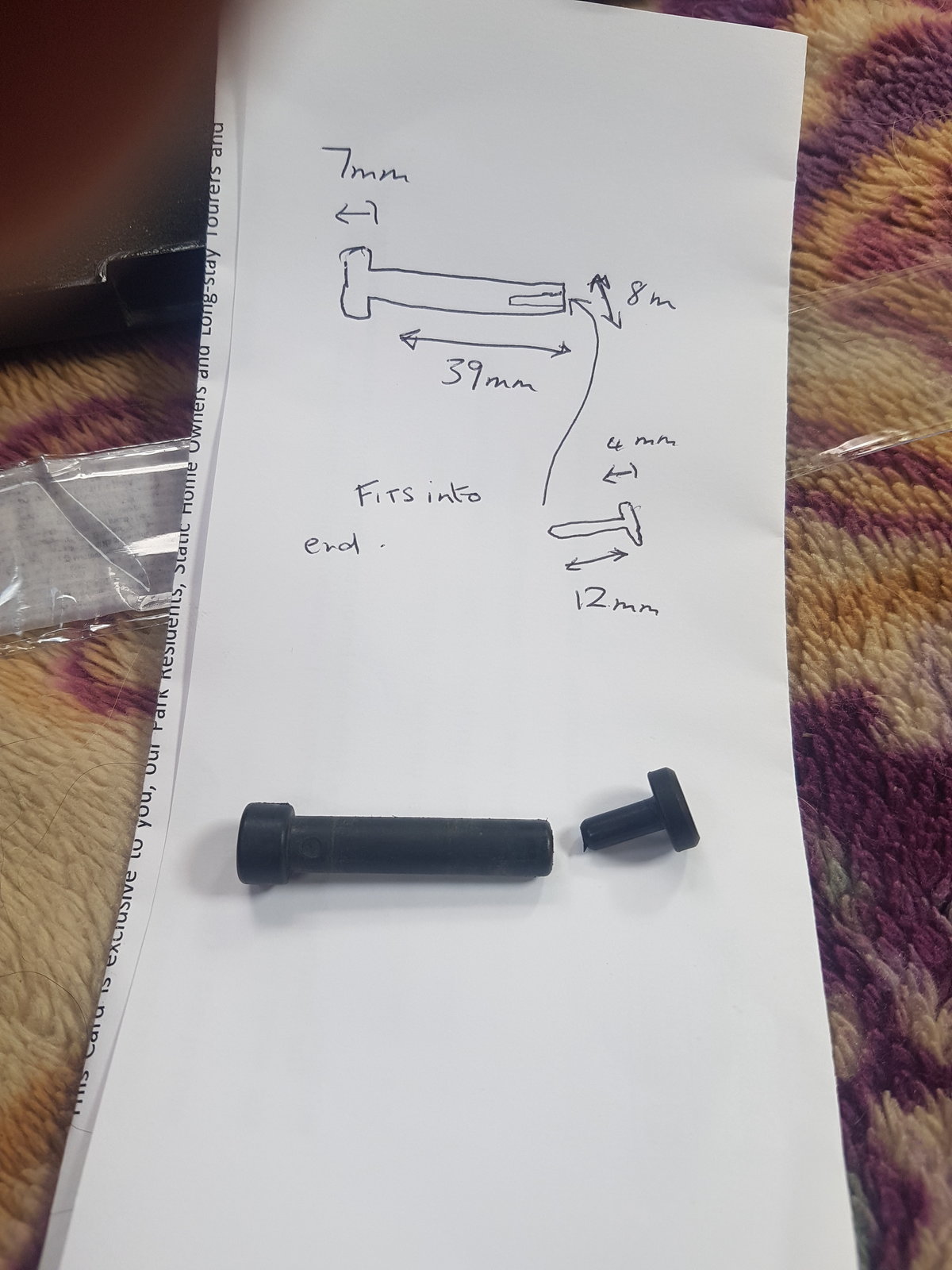

Getting there lads.

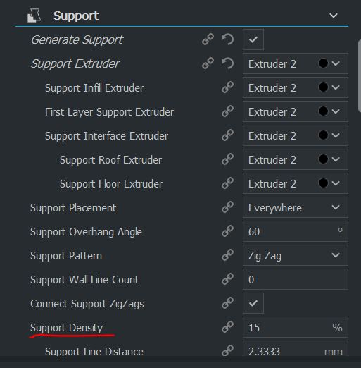

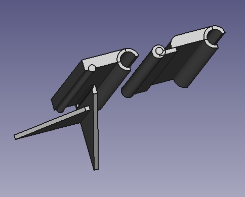

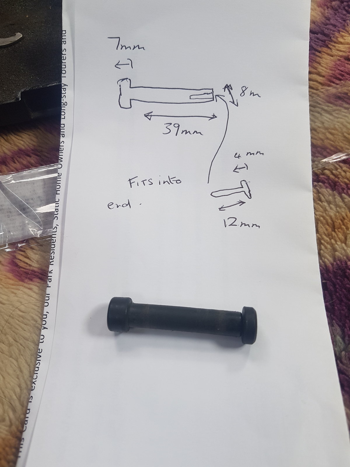

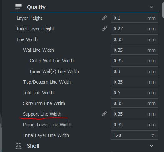

1st print wanted some support so it messed up the pin at the bottom.

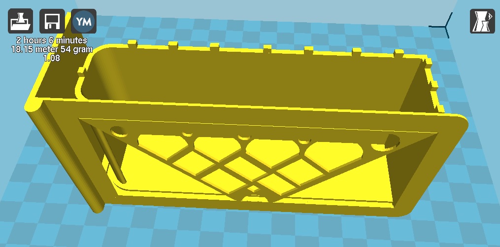

I turned on support but its actually welded it too well lol so i need to see what the setting options are. Just running off the 1st try on the main body but if it all fits i wont be concerned about asthetics for tomorrow
