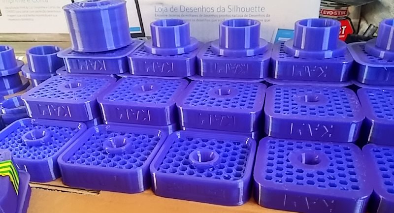

As for print times - printers are slow, no two ways about it, but also for anyone using it to make production brackets, bushes, parts that are faster/lighter to make as part of another job, they're probably using the time making the other bits while it prints anyway - and anyone making production parts batch parts is going to have reworked their printer for more speed or bought a commercial one that can push a lot more plastic than say your A8 does.
Just for comparison, going from your earlier settings (40mm/s, 0.2 layer, 0.4mm nozzle) - that's only 4mm^3/s when it's at full speed - those batches of mounts I was doing a while ago:
Were printed with it pushing 32mm^3/s -and I've just about finished modifying the printer so it can go to 40-45mm^3/s - it makes a massive difference in terms of what you're waiting for, and if you don't mind spending a little more there's machines that then make mine look silly. Even then, I generally just stack half a dozen on the bed, set it going, go and work on other parts.
Obviously, for even bigger batches of parts, you can print moulds or tools to allow you to make them more conventional, faster ways, but without any serious tooling/moulding costs.
