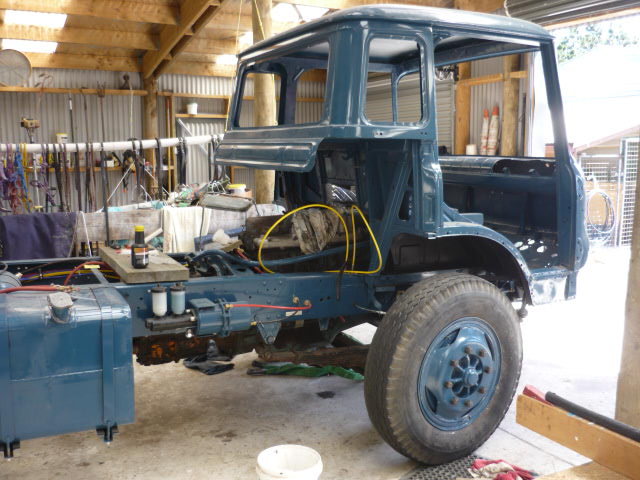

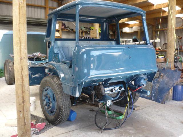

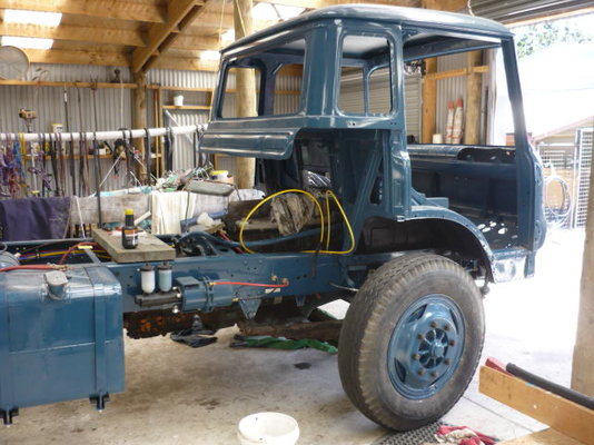

If I ever get round to it, I plan to use some scrap plastic rear mudguards as liners for under the cab.

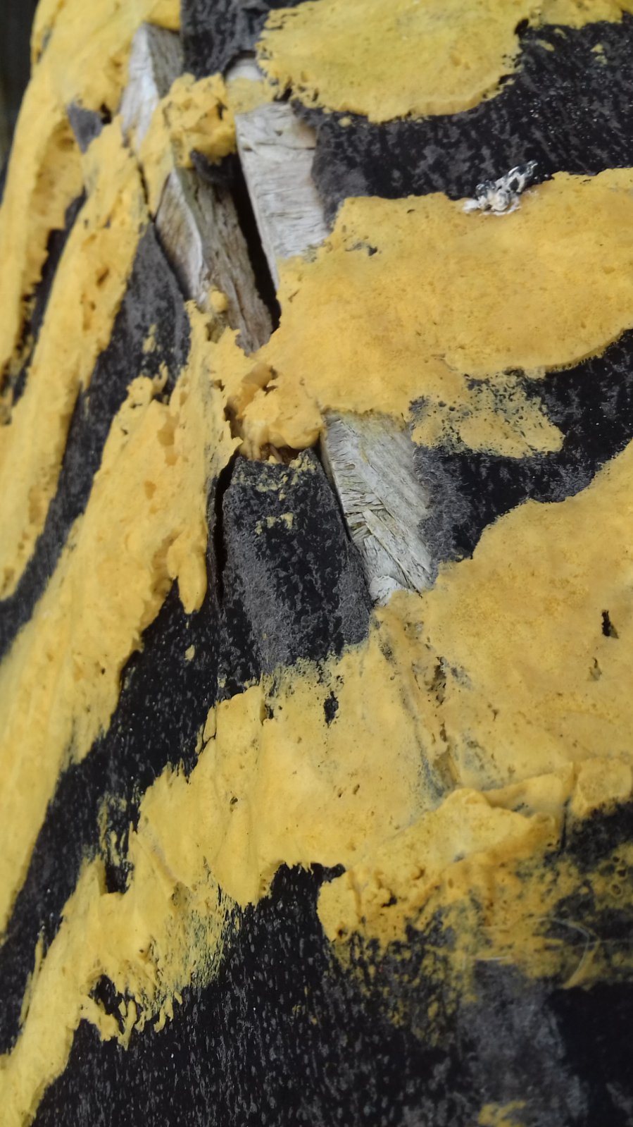

I think spacers to give an inch clearance between the liner and body will create enough airflow to prevent trapped moisture and also skim over the top of any seams or pressings. I have deduced that a lot of rot in my trucks can be attributed to condensation, forming in the roof skin and various other single skin uninsulated panels, running down inside box sections. I am considering using expanding foam and EPS in these areas. I have never heard of anybody doing this before or if it was a bad idea. Apparently austin tried this in the 60s but used a moisture absorbing rather than repelling foam. Needless to say the rot which ensued was devastating. I don't want to copy that mistake. I intend to do a test panel which I will weld, just to see if the whole thing goes BOOM !
Mate of mine made some wheel liners for his rr classic out of cheap flexible dustbins cut into shape, might be possible to bolt a couple of bits together to line a lorry arch.

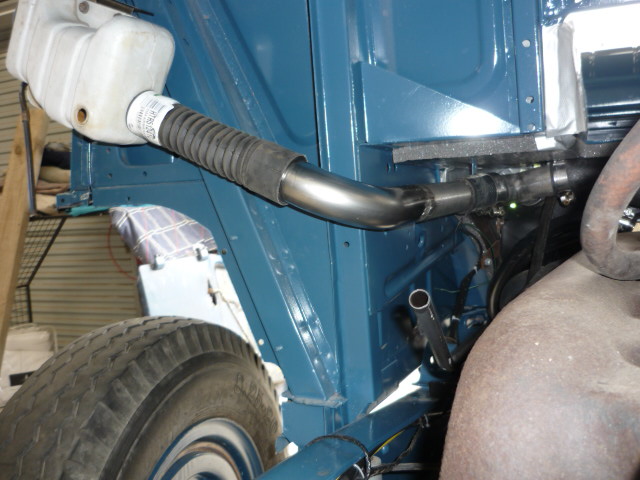

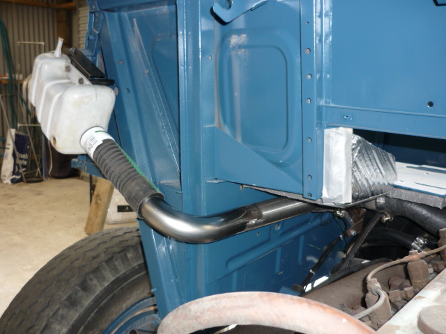

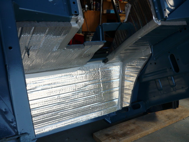

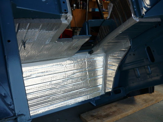

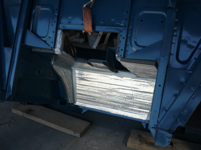

Anyone who has driven one of these will know that they are both hot and noisy.
That looks lovely quality insulation. If it ever peels off though, can it hit the fan or land on the exhaust? I have used a metal strip across one I did that prevents it falling where it can cause trouble. I was wary of using the nice thick insulation like you have as through lack of knowledge I couldn't decide how much hot air that should be rushing through the small gap between engine and cab would be restricted. I chickened out as our trucks typically after a long drive have to shunt skips and that is a really great point to overheat. I put insulation inside the cab but I am looking at yours enviously.Ticking off jobs that need doing before the cab goes on...
...put in some sound/heat insulation. Anyone who has driven one of these will know that they are both hot and noisy. This foil lined one is designed to go under the bonnet or in this case on the cab around the engine. Pictures rather poor, sorry.
Hi, Even using a closed cell foam which supposedly won't absorb water, will hold any moisture against the walls of the panels. I think it would be best to leave the boxes empty for air to circulate, just paint or wax in there.
Colin
