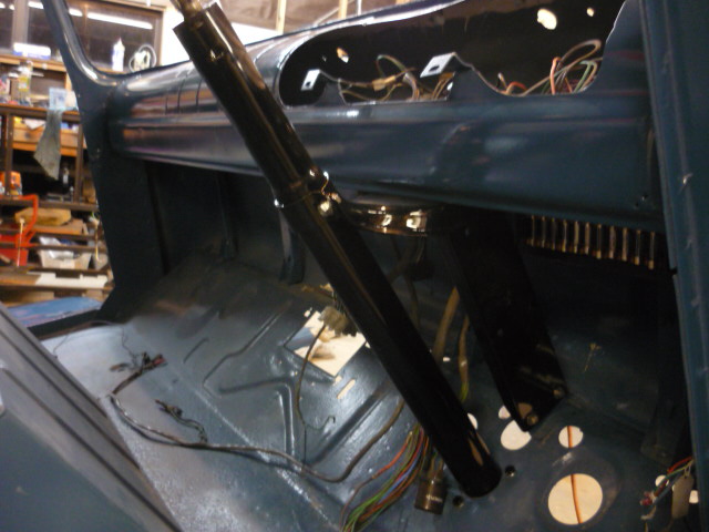

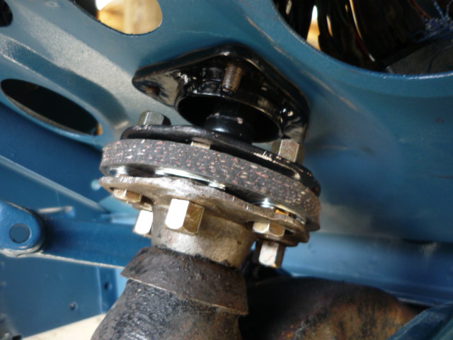

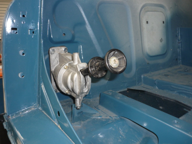

Time to refit the steering column. I now know that this has to be done before the cab goes back on.

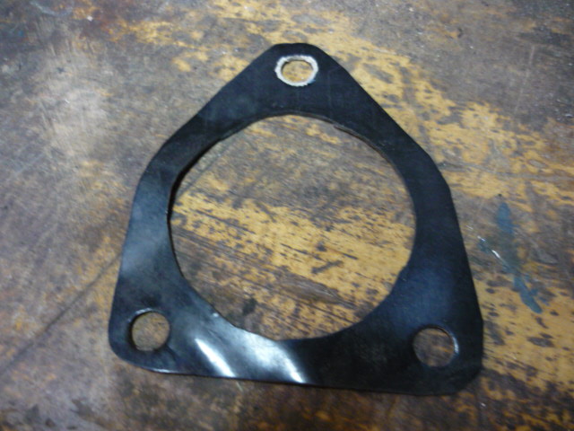

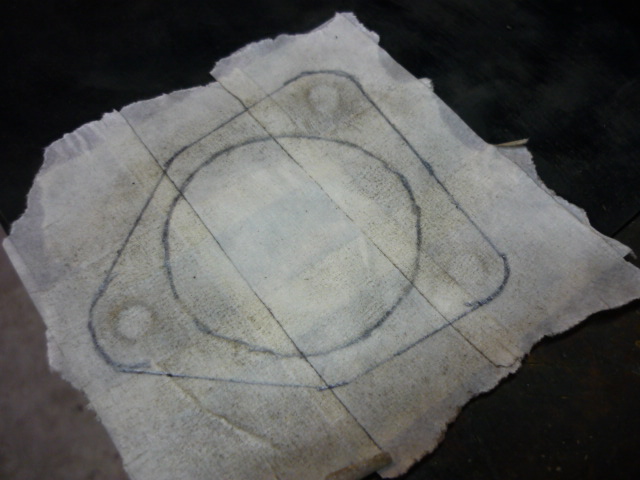

I used a trick learned from the Binky series of videos to make a gasket for an awkward shape:
Cover the area with masking tape and then rub with a grubby finger
then transfer to rubber and cut out for a neat gasket for the steering column base. There was no signs of a gasket there before but every little helps I guess

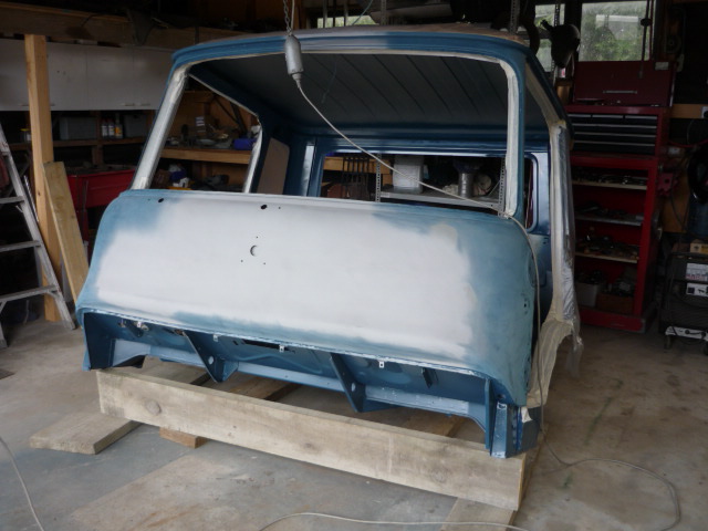

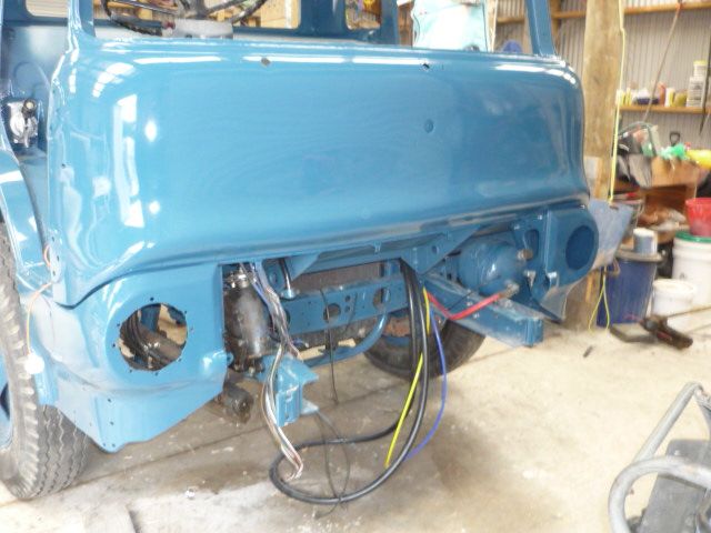

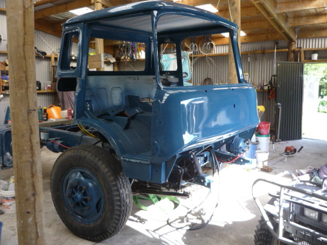

I know it's a bit of an 11th hour thing but I had a thought, the panel below the gearstick that is seen above sloping off to the left, if that had a hatch put into it would the cab ever need to come off again?
It's a mystery why they did not put better engine access in. The guys who worked on these trucks in army mentioned cutting holes in that panel and then just riveting a patch back on to do things like water pump changes. I did contemplate cutting it all out but for a truck that is not in commercial use it is probably not needed.
A truck being used for business would do more work in a week than this one will do in a year. If you said that the cab would need to come off once a year in commercial use (and it's probably not that much) then mine becomes once in 52 years which will not be my problem by a long margin!

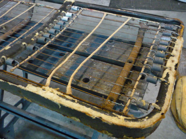

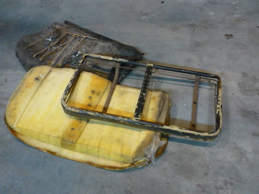

Least comfortable passenger seat ever made. It's like sitting on wood! If you are recovering it add 2 inches of sponge!
I had the seats on mine re done about 20 years ago and they never went back in. I'm sure the guy converted the base to woven belts but I'd have to go look.

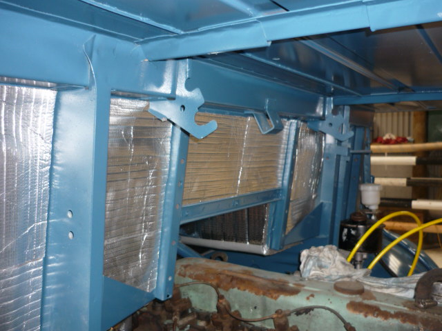

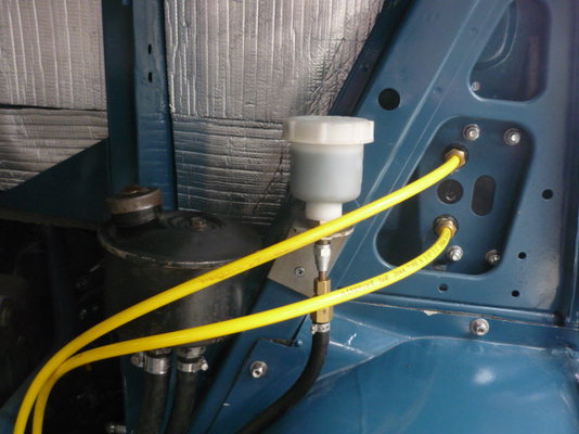

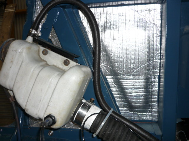

I refitted the coolant tank and added some sound/heat insulation
I took ages trying to track down a new low coolant switch and in the end found that it is exactly the same as the switch that people use in aquariums! There are any number on eBay for a few dollars each.
The insulation also makes it much lighter under there

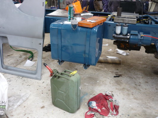

... amazing how much can come out through a pinhole in my welding that I could not even see!
So tank drained down, taken off and re-welded.
All good now.
I'm also taking the opportunity to measure the fuel gauge sender at different depths since I am pretty sure the new one I bought is not going to match the gauge on the dashboard.
