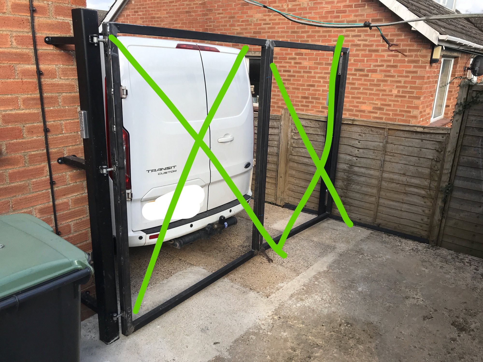

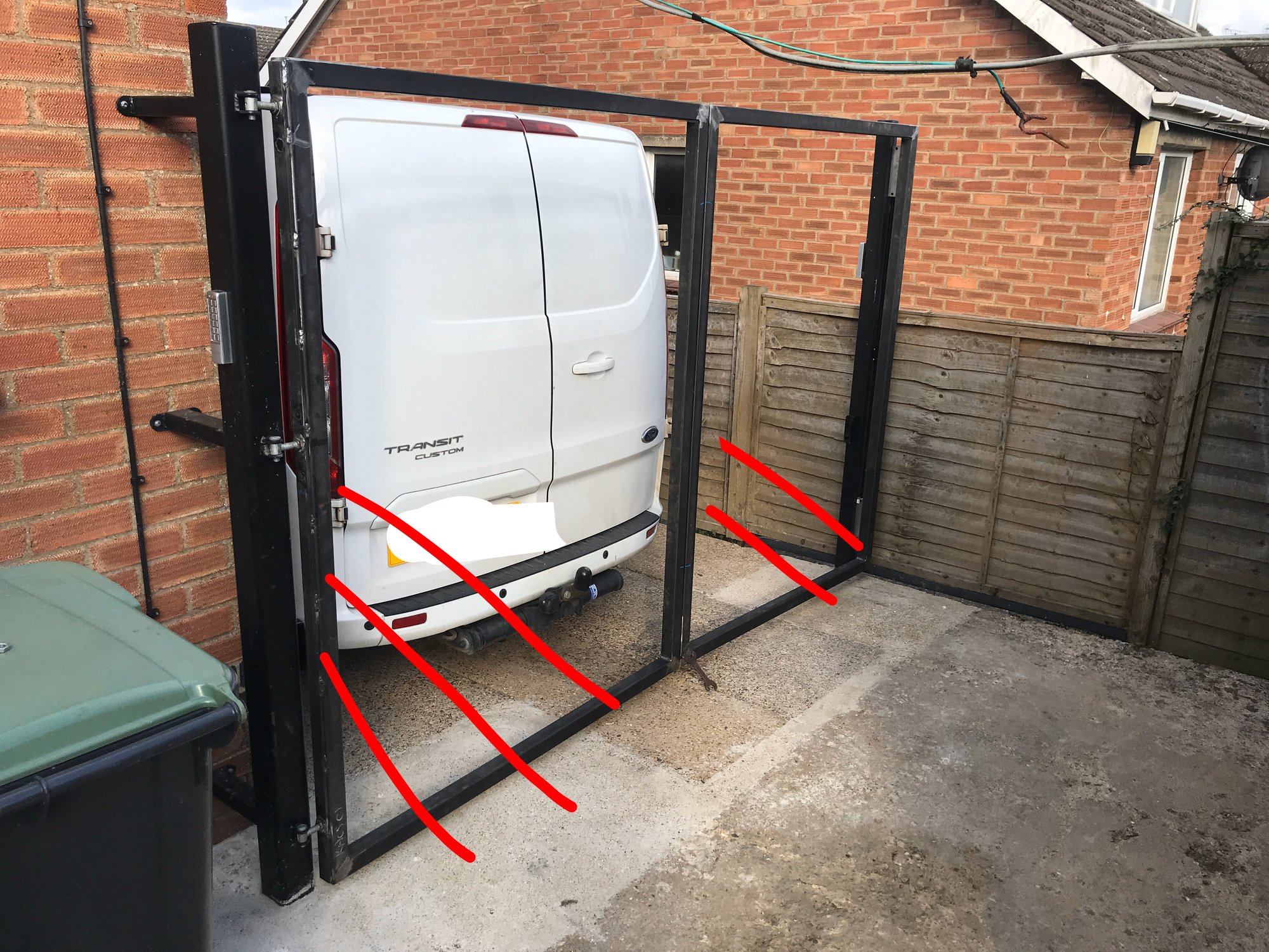

I meant like it just looks ugly to the eye. I have some plans on how I want to do the joints but as I say I’m not sure how to work the measurements out. I’m not good enough on CAD to do itAh OK I get you now.
Do you have some ballpark dimensions (and guestimates for the weight) of the panels?
The closer you tuck the actuators and linkages into the hinge the greater the forces required. So although the "ugly" mechanism you posted is that it does have the benefit of providing extra leverage.
I did see that design but it’s no good for me as I’ve already made the hinge with standard hinges. Like on a normal door (but weld on ones)This is quite a neat design but does require some gearing for it to work so not sure how it would hold up outside:
If you send me some dimensions I can mock it up in CAD for you, probably easier to fiddle around in that than work through the maths.I’m not good enough on CAD to do it
Vaguely, I use to do a lot of trig during my apprenticeship with cutting tool tips etc but even then I still can’t remember it all as I had to do some working out not long ago. Messed it up haha.If you send me some dimensions I can mock it up in CAD for you, probably easier to fiddle around in that than work through the maths.
To be honest there's probably shortcuts to it (like I saw some simple questions in the FAAC kit) but I'd end up having to do it from first principles with some trigonometry (do you remember SOH CAH TOA from school?).
