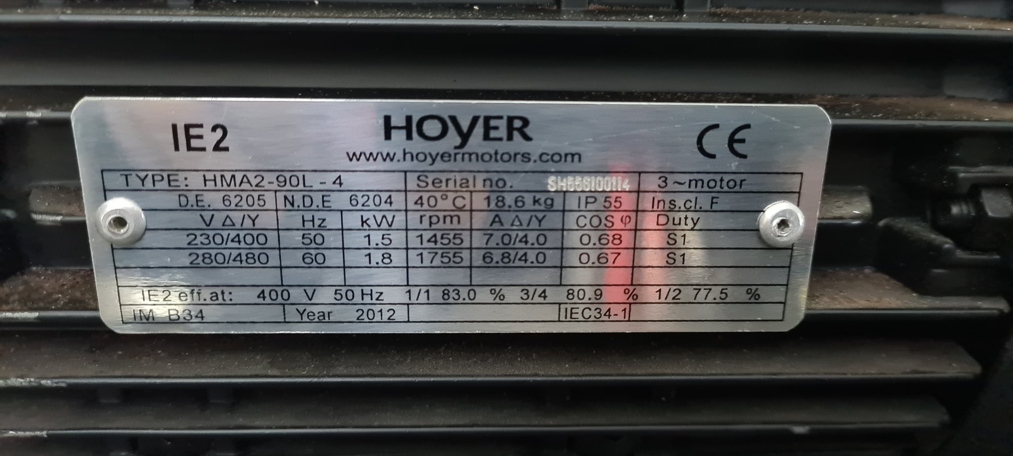

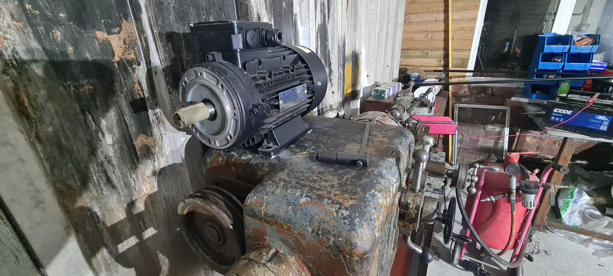

) 3ph 2hp 1.5kw motor.
then 58mm pulley should get you about there.
