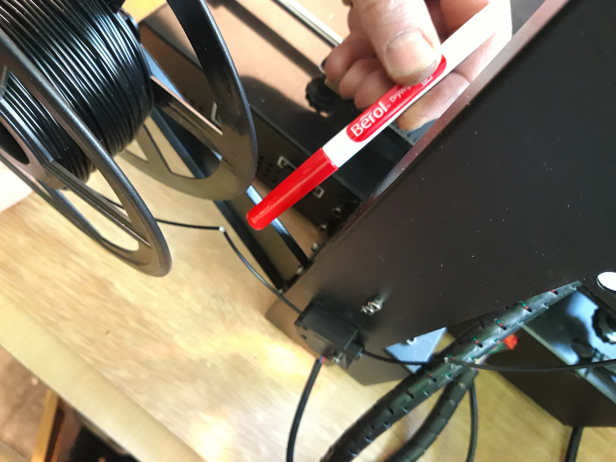

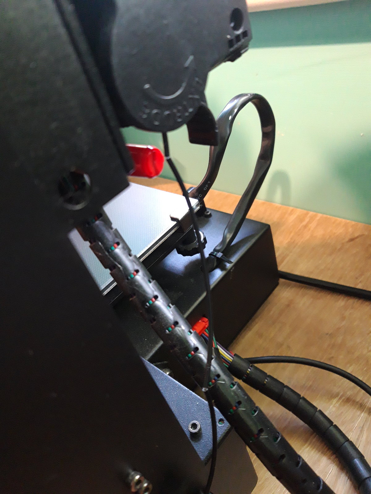

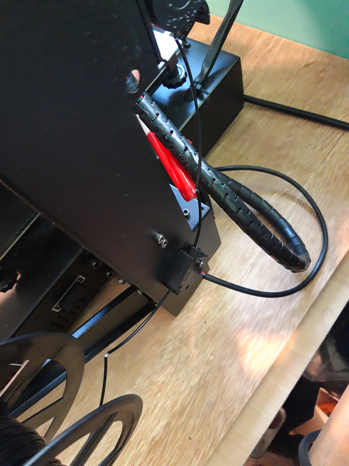

I extended all the wires from my printer and moved everything I could outside the enclosure.
PSU, Motherboard, Mosfets and filament reels are all on the outside of my enclosure.
This has meant that I can bolt my printer down making it much more stable and less prone to print artifacts from the frame moving.
The only maintenance I have ever needed to do inside the enclosure is on the extruder head and with the filament on the outside its less likely to go soft before printing which can be an issue with PLA.
