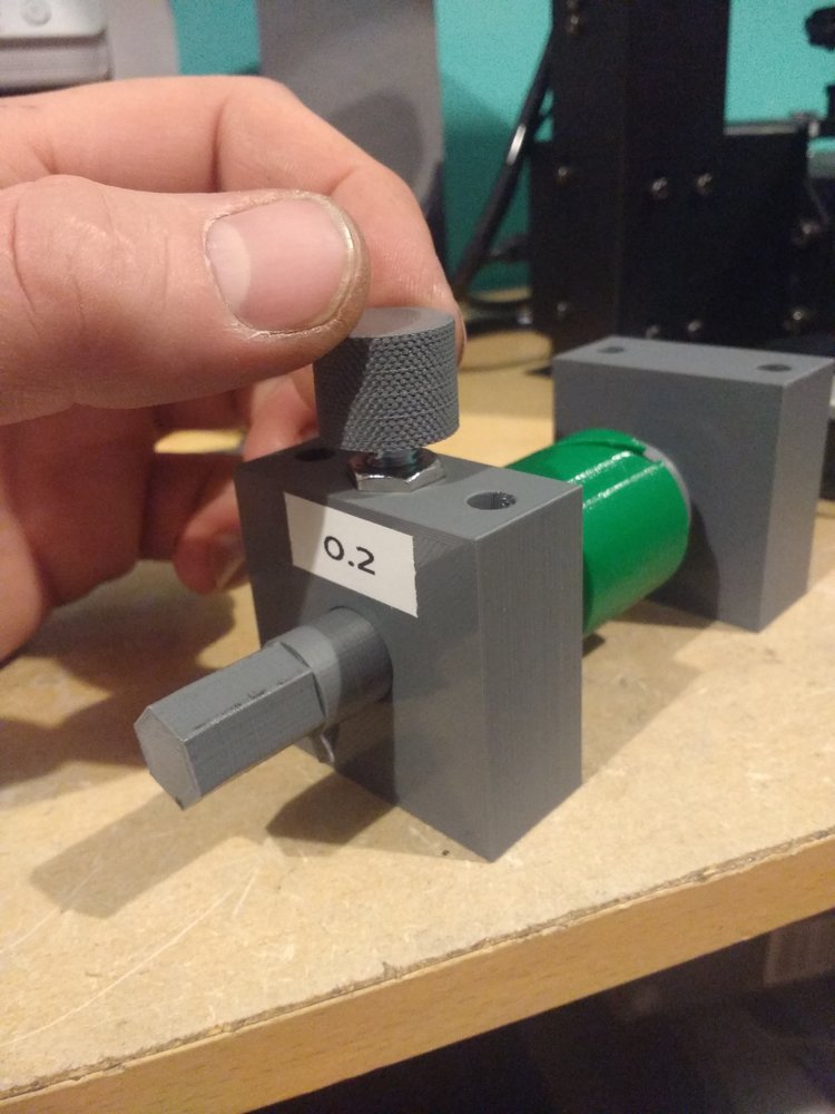

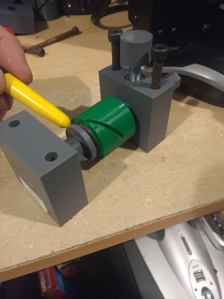

Why do they need a retainer plate.?The plan was to use the M8 bolt with the knurled cap, as a shaft tensioning bolt.
This will only work if the cap head bolts are used with a retaining plate:
Not if it was super glued in... But I do see what you meanWithout a retaining plate, as you try and wind the bolt in to tension the shaft, it just pushes the nut out:

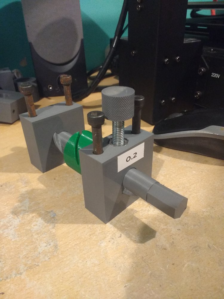

Added a little slide on restrictor, to limit the spiral cut to nom a quarter turn:
So another 4.5 hour print at a much better quality and bingo.

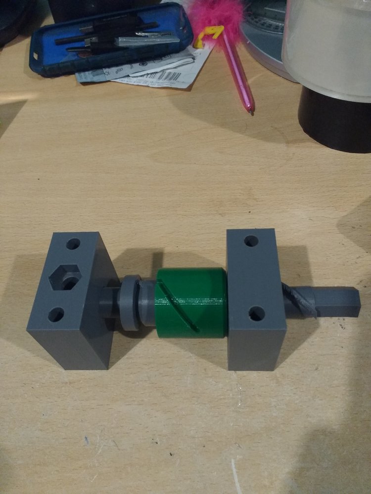

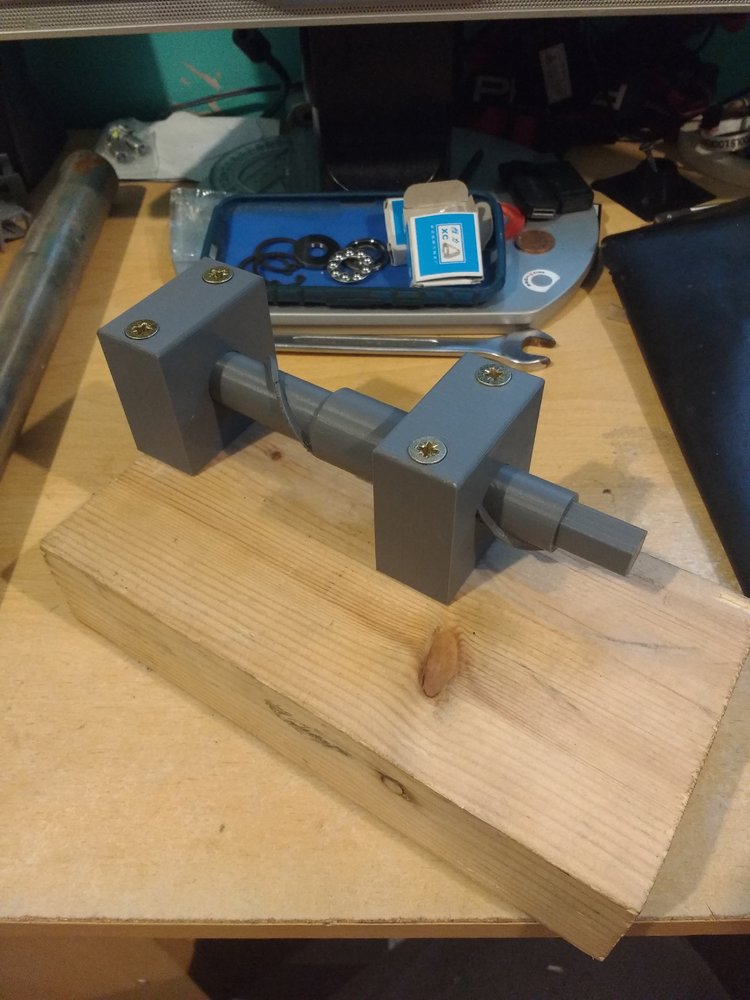

Nope, no idea. Looks interesting though.Figured start its own thread as there are likely to be lots of tries before we get it right. Regular readers will be aware of what I'm trying to do.
Basically this...'ish in PLA:
The latest failure print. On the up side, the M8 nut fits a treat and it's nice and glossy!
Failures:

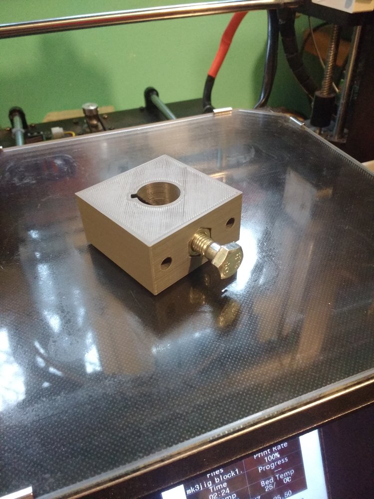

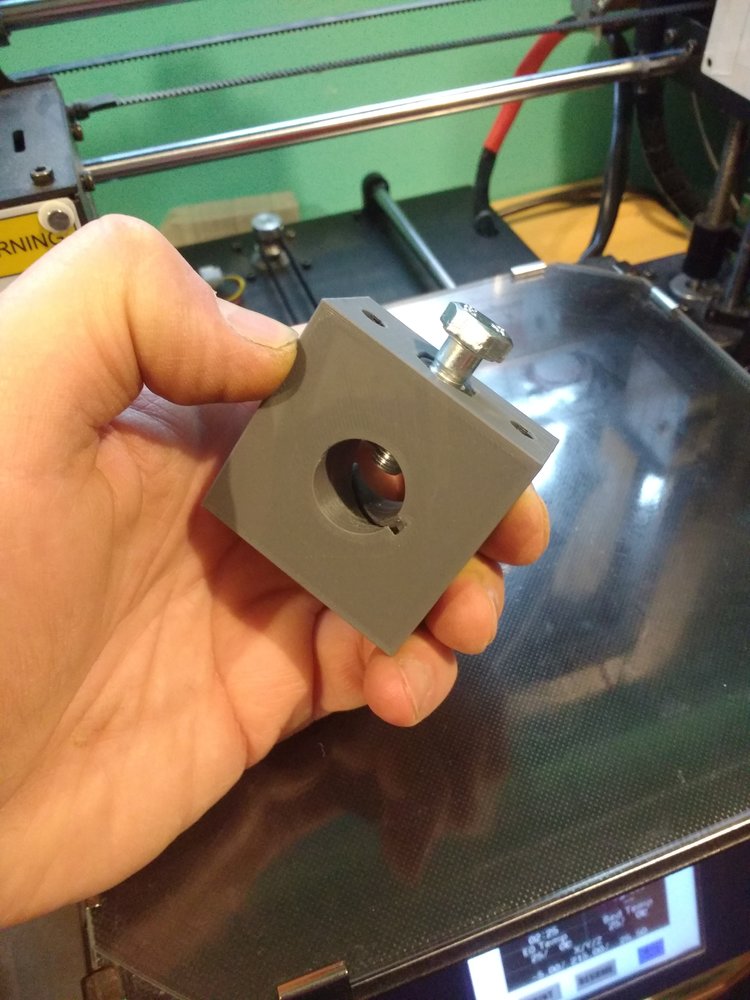

The only thing that might be an issue is I seem to have printed two of the same block... So I need to check if its going to work

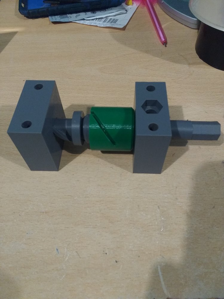

Yeah much smoother....are both blocks the same as I have 3 blocks with the nut in it due to a reprint as I had two blocks with the nut hole in. LolDoes this help, at the starting point looking from the hex end:
From the other end:

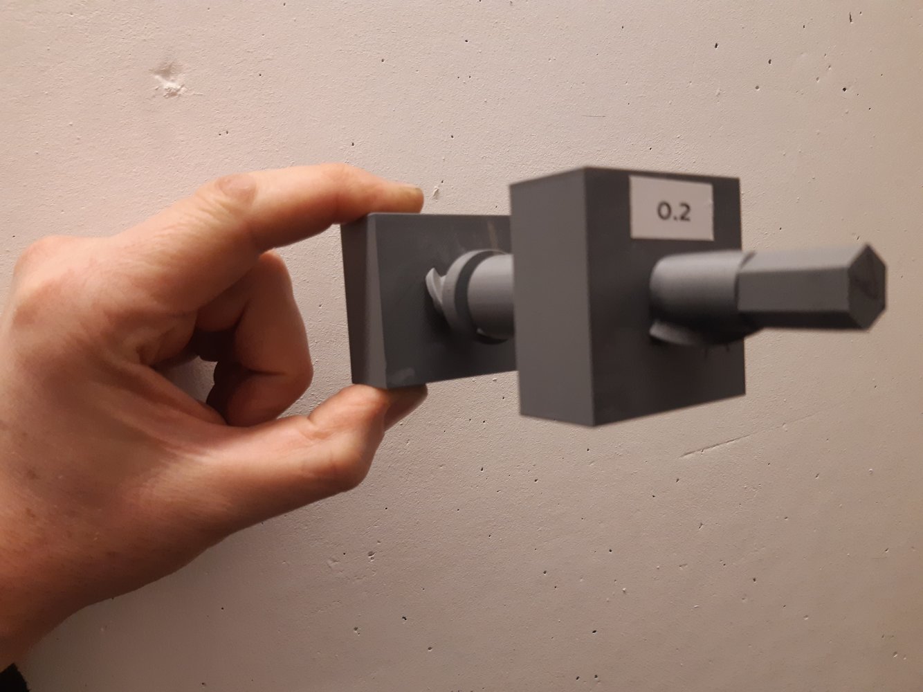

Guessing your layer height was less than what my lad printed at. On your video the sliding action sounds much quieter.

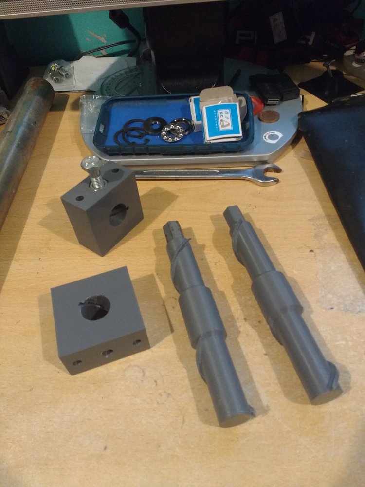

I think I mixed up the file names.
That said it looks like the block at the rear works fine upside down.

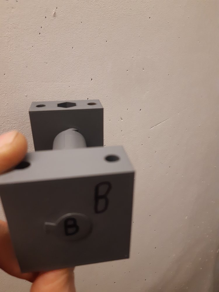

Makes sense now then..lolBoth blocks have an M8 nut hole in but the threads are different. You will have the block on the right with the nut hole in top, the one on the left with the nut hole on the bottom.
When you cut the other slot, you turn the blocks over and the nut hole will at the top on the left block and bottom on the right block.
