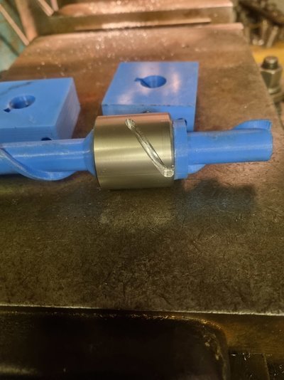

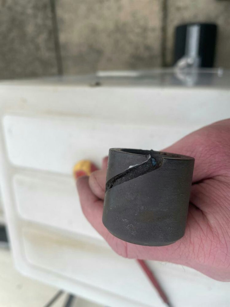

Have you got a chamfer both ends of the bush? Can't

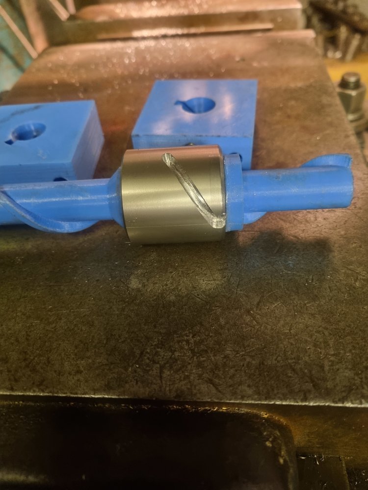

Have you got a chamfer both ends of the bush? Can't quite see.

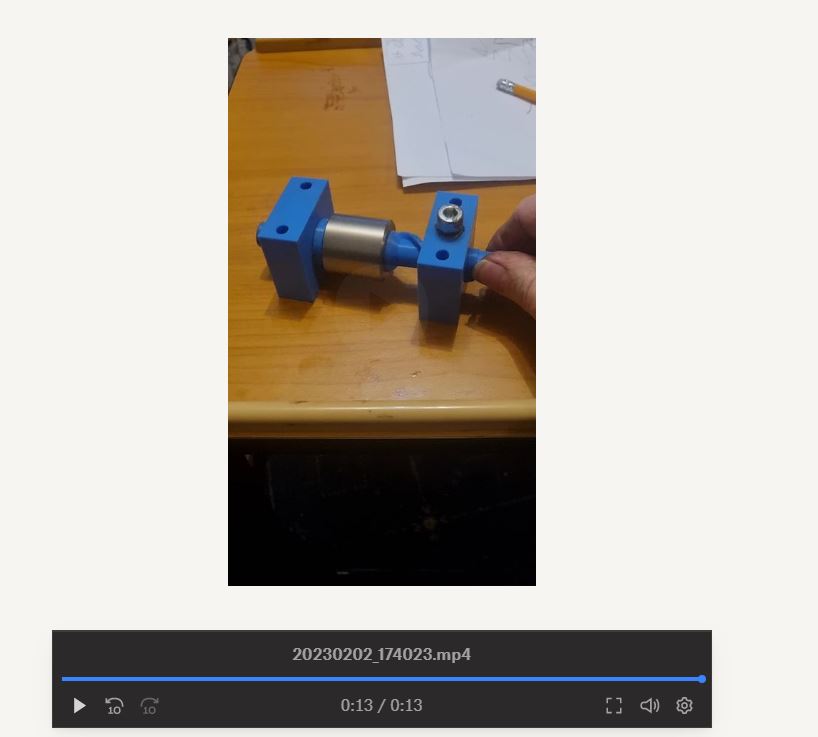

Good thats the one...but I see it and then another one replaces it..I am guessing its a cache problem...I see this one:
MMmmm yes I can see that on the photo. How many Mm would that be?Just to note the cutter has to go in parallel to the axis a little, 3mm, before the spiral starts.
Also.how deep is the spiral cut.

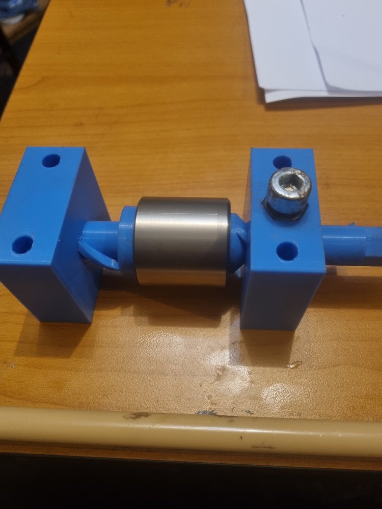

Interestingly one side cut flawlessly.Dropbox
www.dropbox.com
Nearly there...that's the last cut of one side.

Just need the internal circlip grooves measurements.
Blown away here! @ukracer thanks a million for this, so pleased for a number of reasons. Particularly that it worked, vindication of the process! Another string to the 3D printing bow this afaic. Love the old meets new thing too. Who needs 4th axis / CNC?Seriously this I'm sure is more than great for what I need.
I must admit I did think it would catch going back up the cut.
When you go back up to restart you have to be 100% you returned before backing out one time took a small chunk out of the entrance to the spiral.What minor error, I can's see it?
