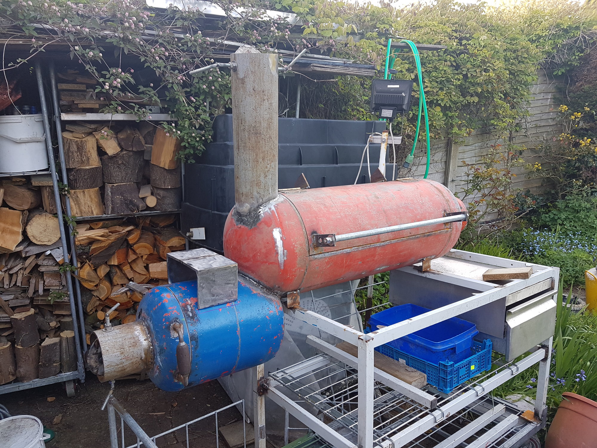

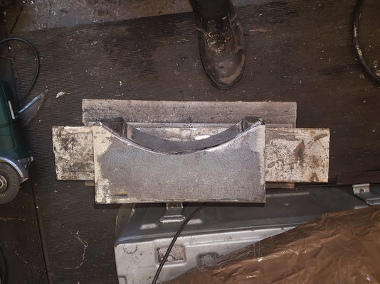

Please enlighen me, As I thought the smoke usually goes up & across the grill, Then out the chimney on most smokers I've seen?no its a reverse flow smoker

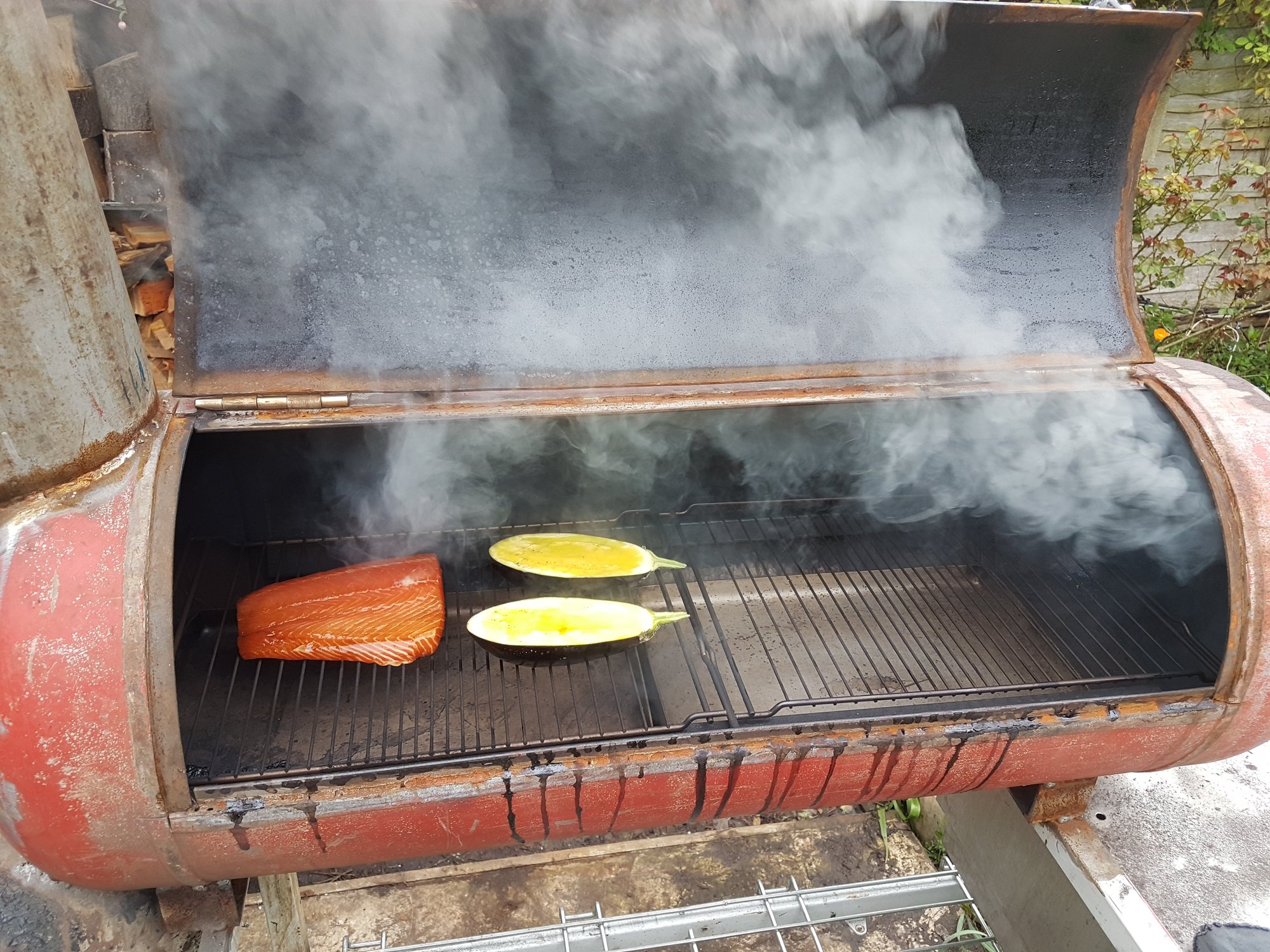

the smoke goes under the false floor that was welded into the bbq cooling as it does so then comes up and over the food before going out of the chimneyPlease enlighen me, As I thought the smoke usually goes up & across the grill, Then out the chimney on most smokers I've seen?
Sounds good! Lets hope it cooks some great slow cooked Meat.the smoke goes under the false floor that was welded into the bbq cooling as it does so then comes up and over the food before going out of the chimney

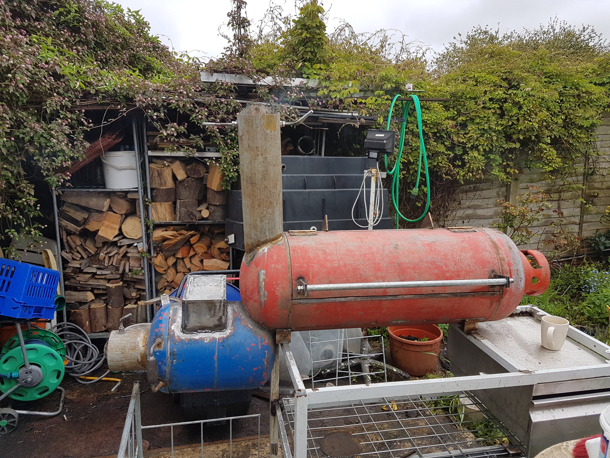

it aint going to be leaving my back garden thats for sure! but it is on 4 decent casters I do need to come up with a brake idea for the casters though.I tell you one thing it looks real heavy!
Braking casters?it aint going to be leaving my back garden thats for sure! but it is on 4 decent casters I do need to come up with a brake idea for the casters though.
Any ideas?

I also need to make a cowl i am thinking baked bean can with a plasma cut pattern in it
