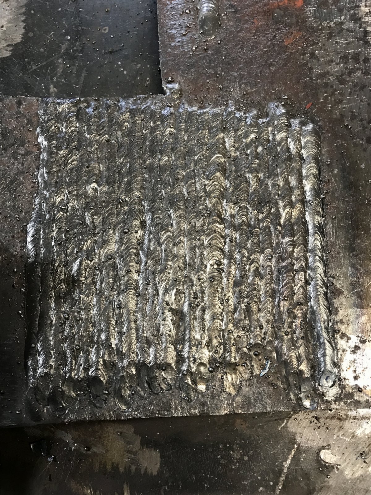

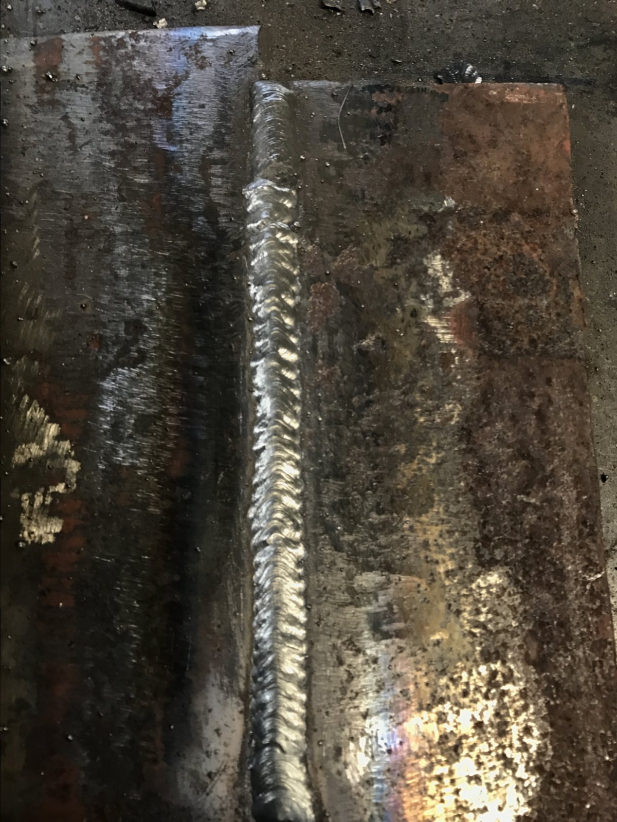

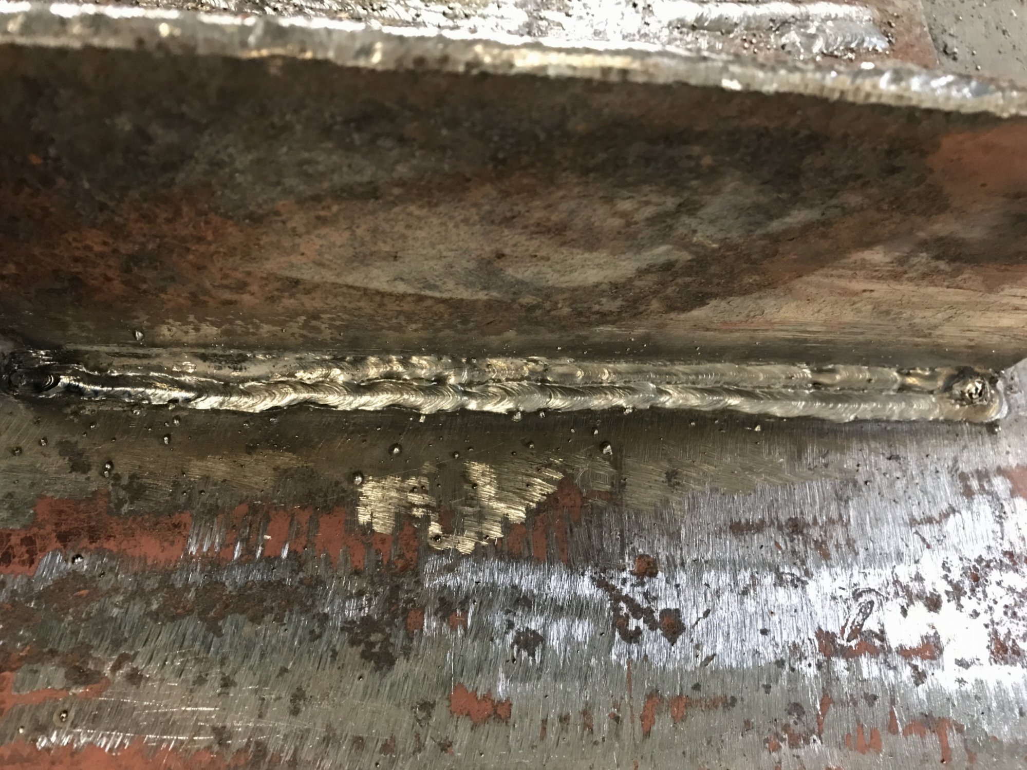

Fillet comes before any out of positional work IMO. Your vertical and overhead devotes much more skill than a 1G butt and fillet joint.Yes just straight runs. Practice them in the horizontal vertical and overhead positions, then get cracking on the fillet.
Exactly.From what I know the downside of weaving is that you can get to much heat into the piece and effect the grain of the metal. Rich I'm sure you know if this is true or not. But yes avoid the weaving, there is sometimes applications for it, but on a flat cap no needed. I you've the opportunity try out some different elctrodes.
