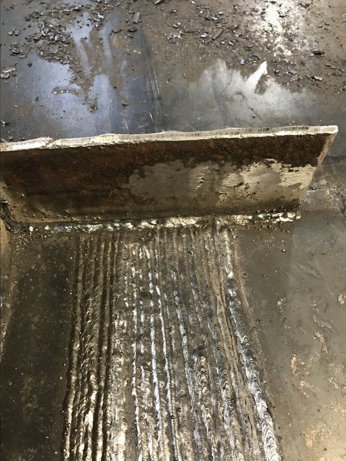

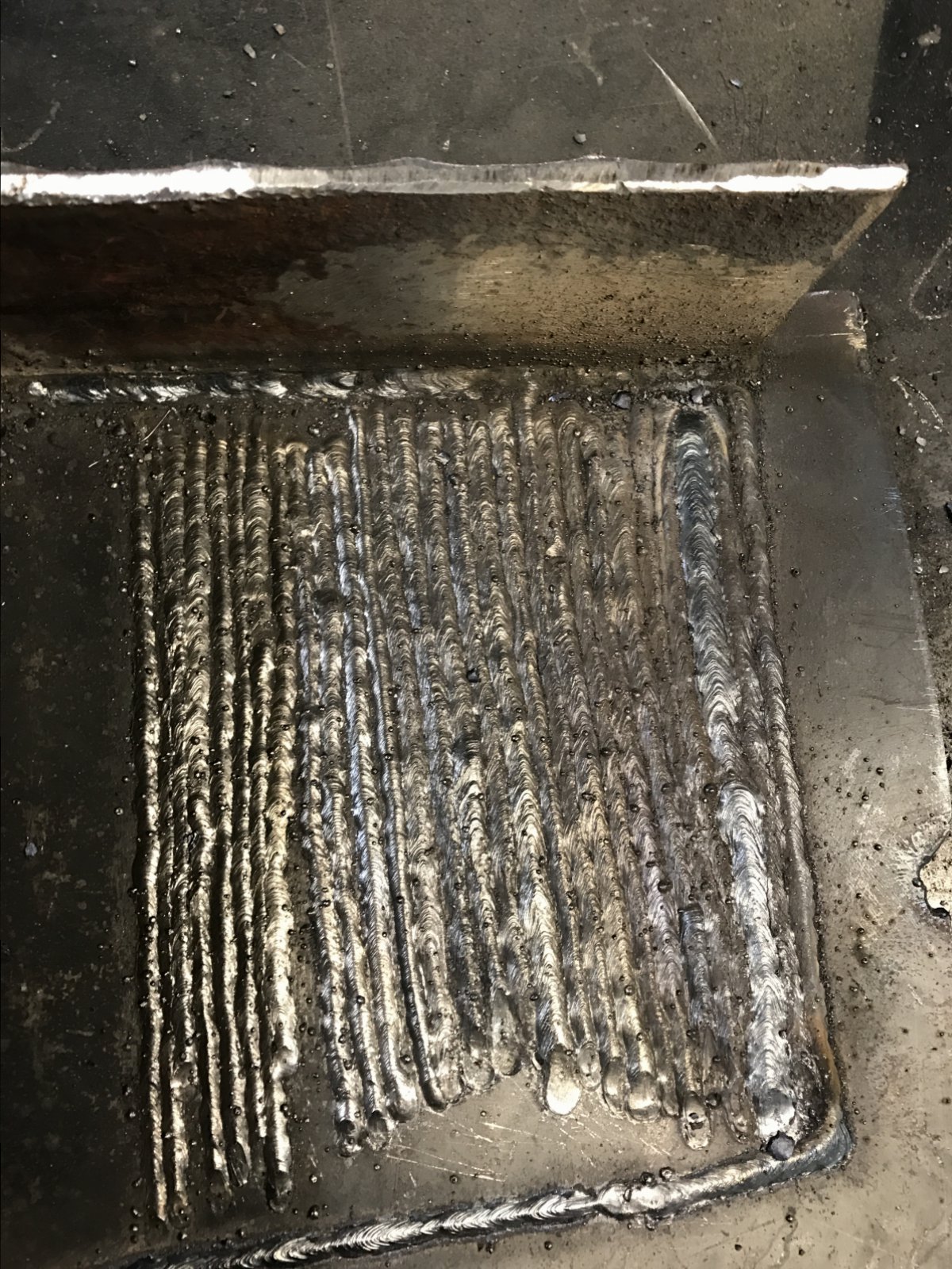

In short by not weaving you reduce heat input.
This in turn reduces the grain size in the microstructure. Smaller tighter grain size makes a tougher weld and doesn't effect the toughness of the parent material as much as if you had a high heat input.
A second and a third run refines the grain structure even further.
Grain growth I believe is the term used when describing a welded joint that has been put in with a lot of heat input. And it usually results in low toughness when charpy results come back.
A lot of stringent mma wps's actually state a run off length. Ie for every 400mm of rod burnt off you should of deposited 250mm of weld length with a tolerance either side.
This way there is control over travel speed and there for control over heat input.
Very interesting. I know that when you are producing a wps every run will be timed. Possibly not on all but those I've witnessed have been.
if you watch right in, you can see the little ripples forming as you go, if you see a swirl, thats most likely going to be a slaghole (which is where I'm off to next as its Saturday night
