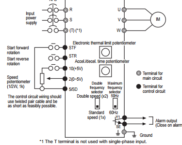

Thanks I shall take a look laterACDC drives.
Then you need controls don't youYou just need a three phase motor that runs on 220v.
Wiring up a VFD is pretty simple.
It takes the 220v single phase mains and converts it to three phase.
Only a potentiometer for speed adjustment. You don’t have to have jog and all that stuffThen you need controls don't you
Is that not built into the vfdOnly a potentiometer for speed adjustment. You don’t have to have jog and all that stuff
Yeah, remove it.
Just a simple DOL starter I’d imagine?yeh when it burns out it will be the 3 phase and vfd.
I will need some kind of switch though! Unless the breaker counts!
I’d think this is what you’d need but I’m no electrician. https://www.toolstation.com/dol-sta...OHJes6GseoX-vY-U2-zKKVoi8T6LYR7EaAiN_EALw_wcB
