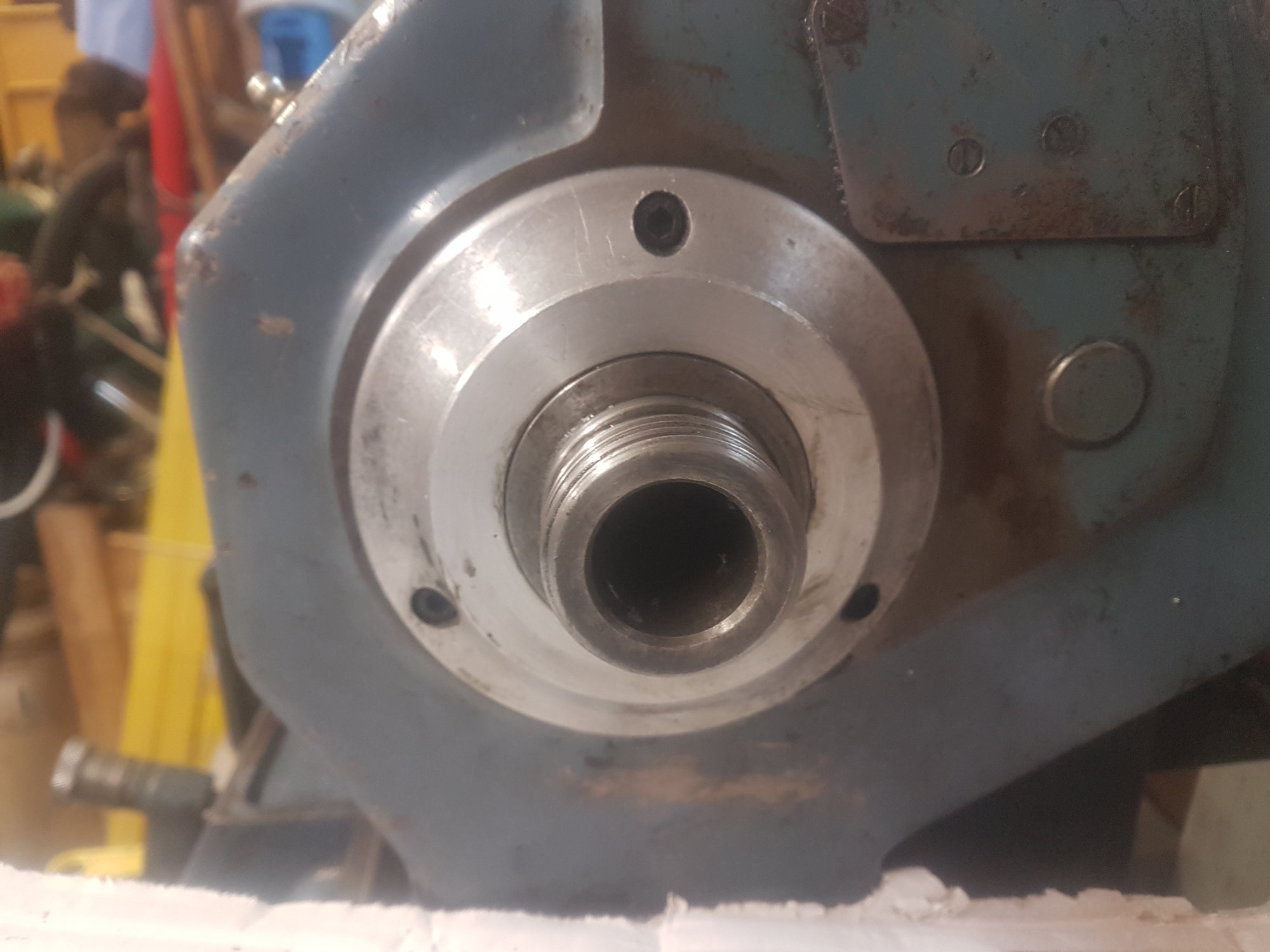

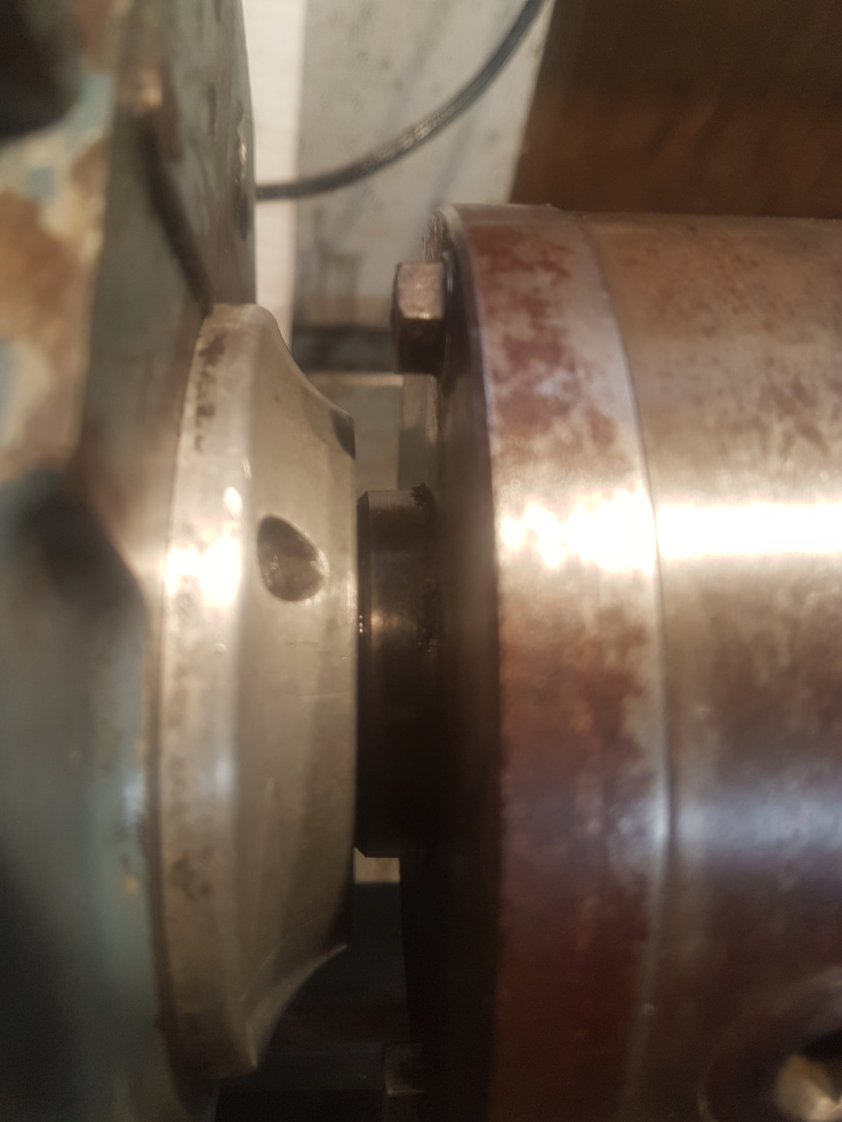

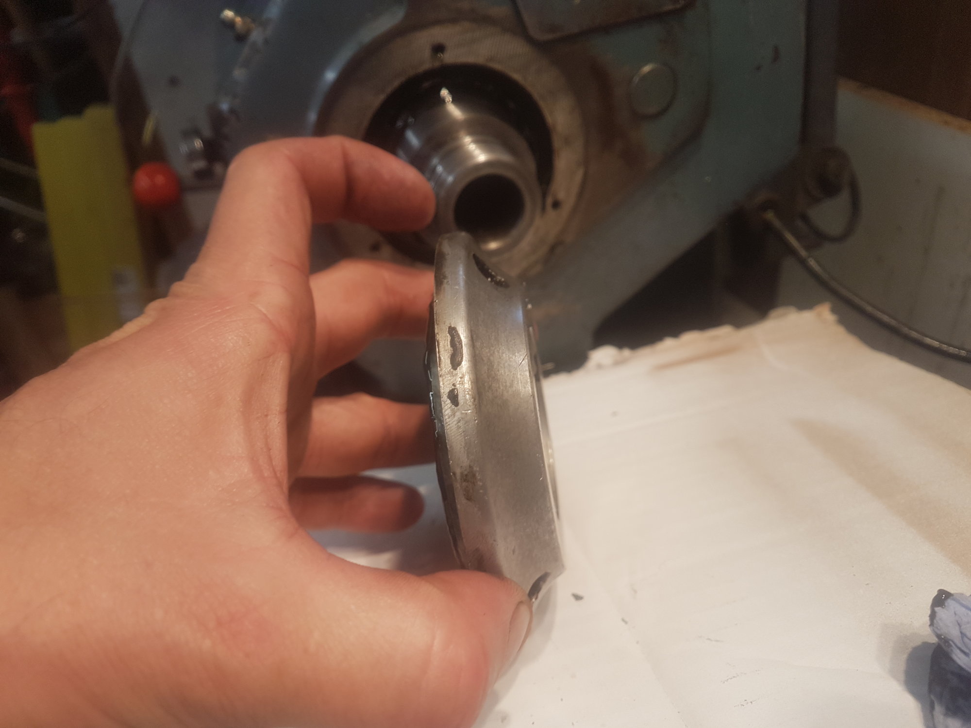

would you turn it in the 3 jaw or on a face plate
Looking at the part would be a 3/4jaw.would you turn it in the 3 jaw or on a face plate
Wouldn't be easy to mount on a faceplate
Whatever gets the job done.3 jaw will be fine! never used a face plate they are in the rust tank as we speak. what kind of mounting hardware do i need for the faceplates? or is it anything goes
er i need to look closer at mine tomorrow when i pull them out of the tank no T slots but I have a T plat that colud bolt onto the face plateWhatever gets the job done.
Have a t slot plate for mine. Should come in handy.
here they are, any way i will have a spare if i mess it up not likely though spares are goodNeither did I. Flicked back to seadogs post to look.
Normally just holes for mounting nuts etc.er i need to look closer at mine tomorrow when i pull them out of the tank no T slots but I have a T plat that colud bolt onto the face plate

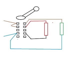

Great that clears things up for me, I have a few multi meters all digital ones though.
No the terminal cover has no diagram unfortunatly
There is only the one cap.
I dont understand this part?
The terminal connecting start windings and cap you leave as it is, the other start terminal and the far end of the capacitors you use as one coil in the CarpoCAD drawing (and will still give a meter kick), the remaining two terminals as the other.
thanks Dave, I think I need another drawing pretty please!?You have 5 terminals, 2 of them only connect to each other, that's the run winding, meter will read open circuit (OL on most digital meters on ohms) to the other three.
The other 3... there'll be two that show a low resistance, that's the start winding - BUT for it to work, that needs the capacitor attached to one end of it (you may find one of the run winding terminals has 2 wires on it, that's likely to be where the cap attaches - if so, leave them connected, dont connect it to the drum switch, and connect the other two of those three terminals to the drum switch).
Dave H. (the other one)
Here you go, live (brown - note the link between the terminals, vital or the motor'll just sit there and buzz/smoke)) and neutral (blue!) in from your cut out switch on the left, two separate coils on the right - buzz them out with a meter to get the right terminals in the motor junction box, Robert's one's parent's sibling.
Don't forget the earth to the motor casing (and drum switch housing if it's metal)!
Exactly - if you reverse both it runs the same way, instead.so only one winding needs reversing the start winding?
so the cap can go on either one of these two windings
