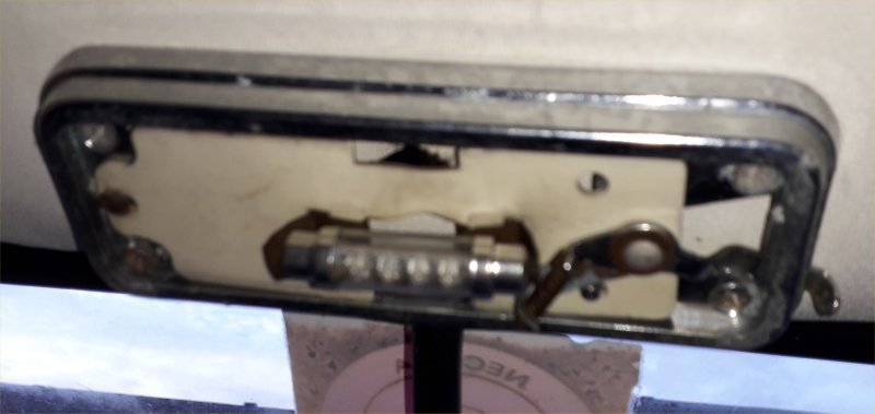

Scimitar Coupé 1966 interior light unit…

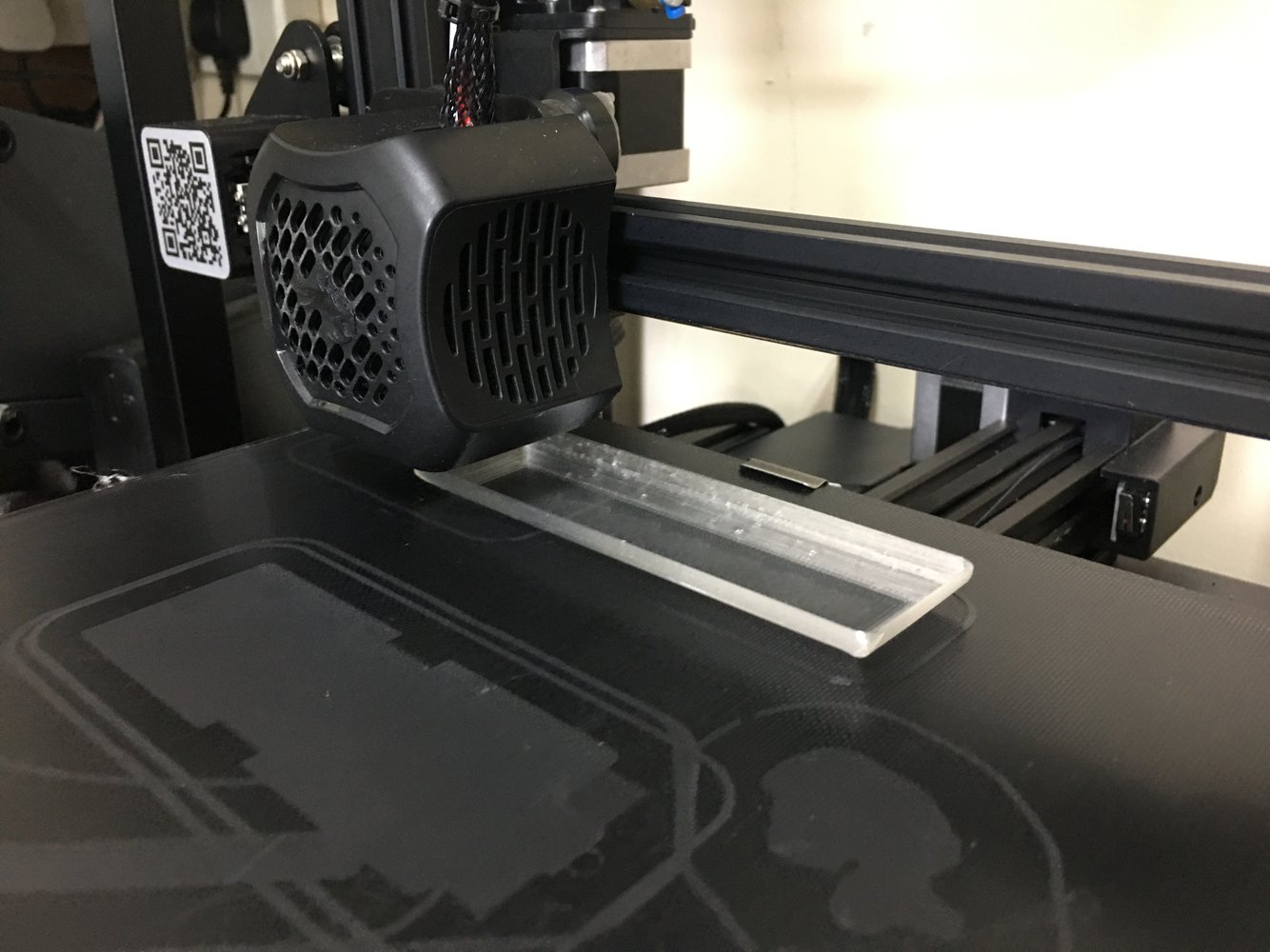

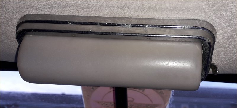

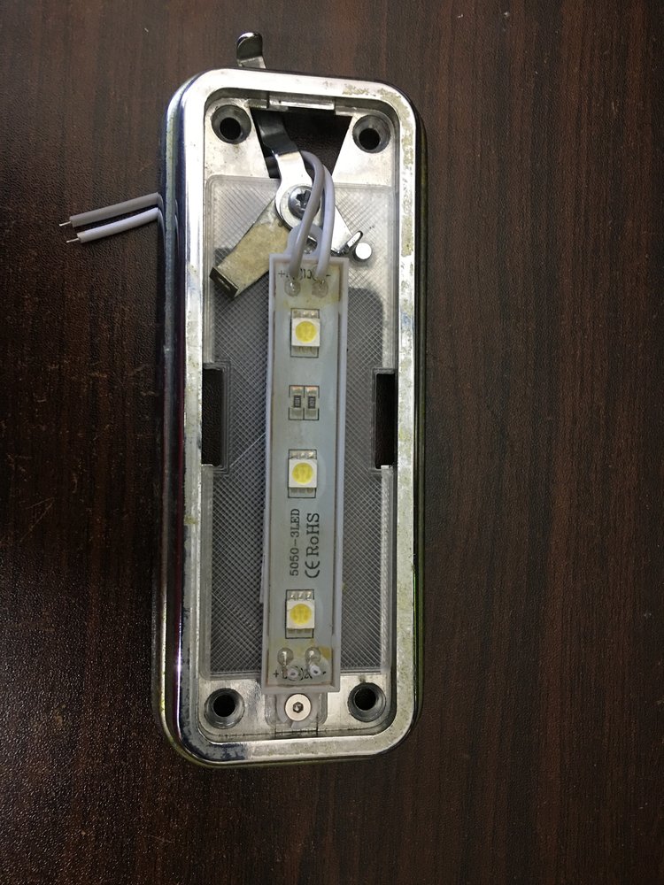

This is all that is left of it, so we have the technology, we will rebuild it. (And convert to LED). Just waiting for some transparent filament to show up now.
View attachment 304826 View attachment 304827
What filament did you order?
Im told PLA wont hold up to the temperatures inside or outside a car in full sunlight.

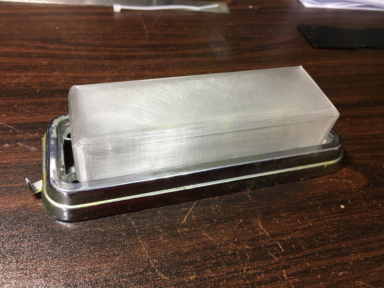

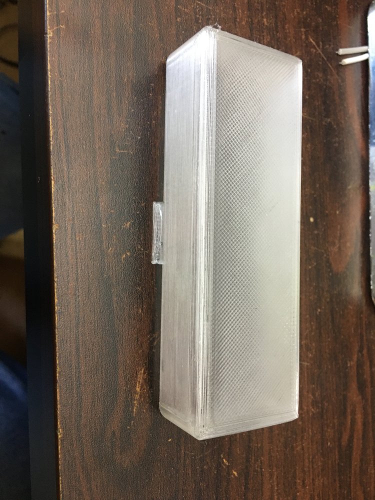

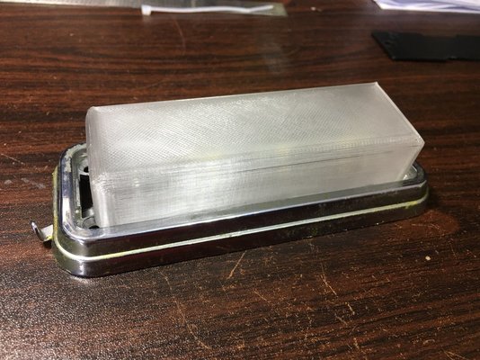

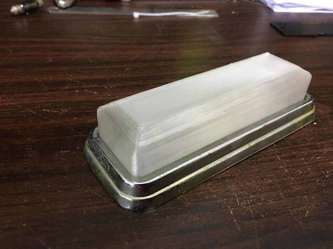

Stuff like this i can totally see the practicality of owning a printerThis is the wrongly printed lens fitted, the correct one with a nicer profile is an hour to run yet!
View attachment 304911 View attachment 304912
That's cool filament....This is the wrongly printed lens fitted, the correct one with a nicer profile is an hour to run yet!
Problem is you do need some skill to design it in the first place.Stuff like this i can totally see the practicality of owning a printer![]()

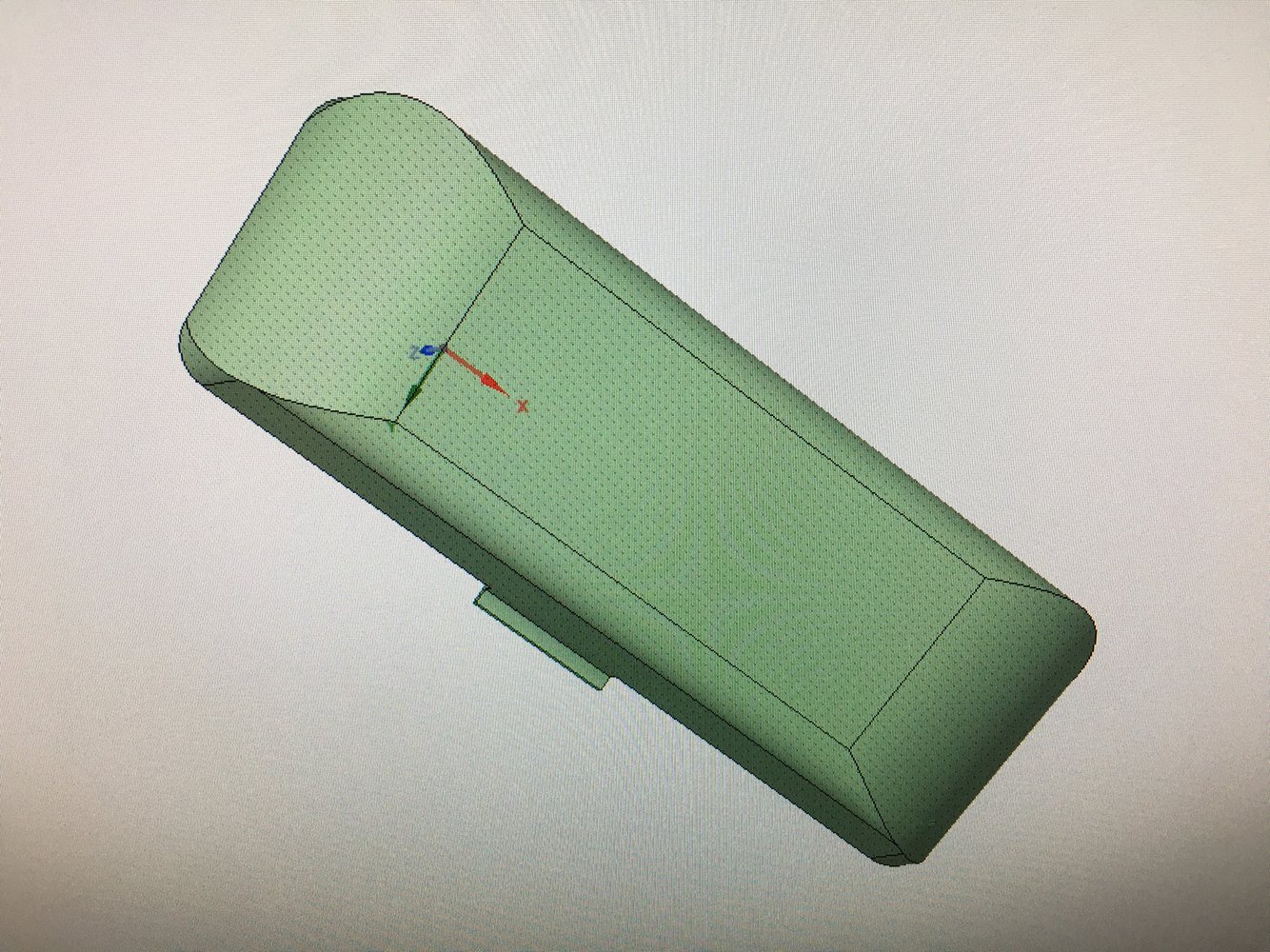

Did you design the part too?This is the wrongly printed lens fitted, the correct one with a nicer profile is an hour to run yet!
Yes Parm. I used Design Spark Mechanical. Steps are:Did you design the part too?
