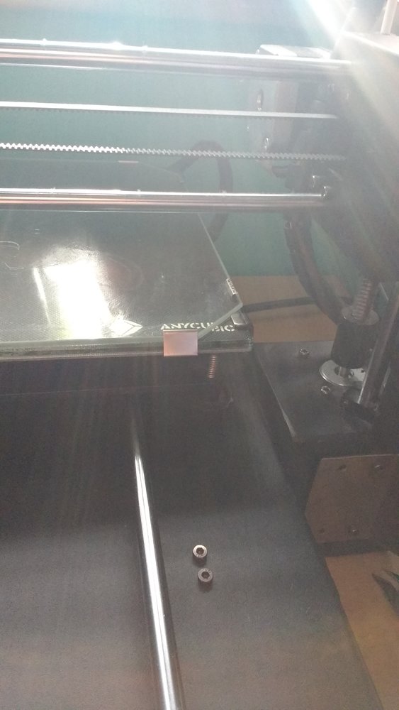

Have you got any insulation under the bed? The black packing foam is fire proof apparently. If you need the higher temperature. Either that or a heated enclosure....ESUN ABS print currently running. Setting it up, I couldn't get the bed temperature up to 110C, after half an hour the best it would reach was 107C. so I modded the slice for 240/100 and so far, no warpage and it looks reasonable quality.
No. It is the glass bed in use. I didn't have any trouble when the weather was better, but it looks like 100C is adequate anyway.Have you got any insulation under the bed? The black packing foam is fire proof apparently. If you need the higher temperature. Either that or a heated enclosure....
I meant on the underside of the heat pad, where the springs live, like this...No. It is the glass bed in use. I didn't have any trouble when the weather was better, but it looks like 100C is adequate anyway.

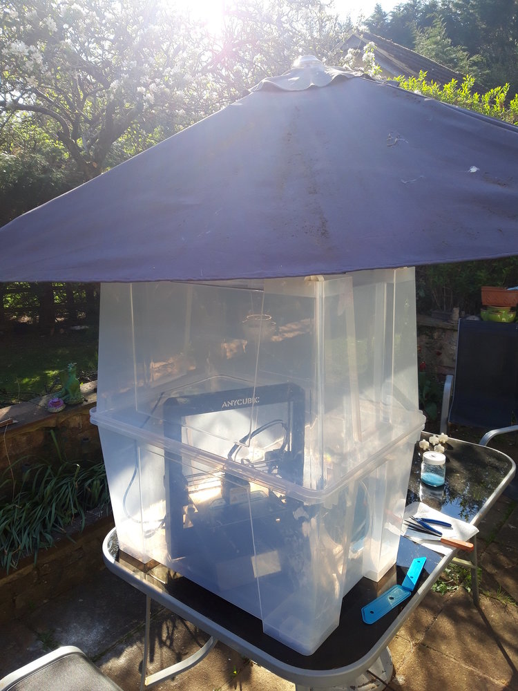

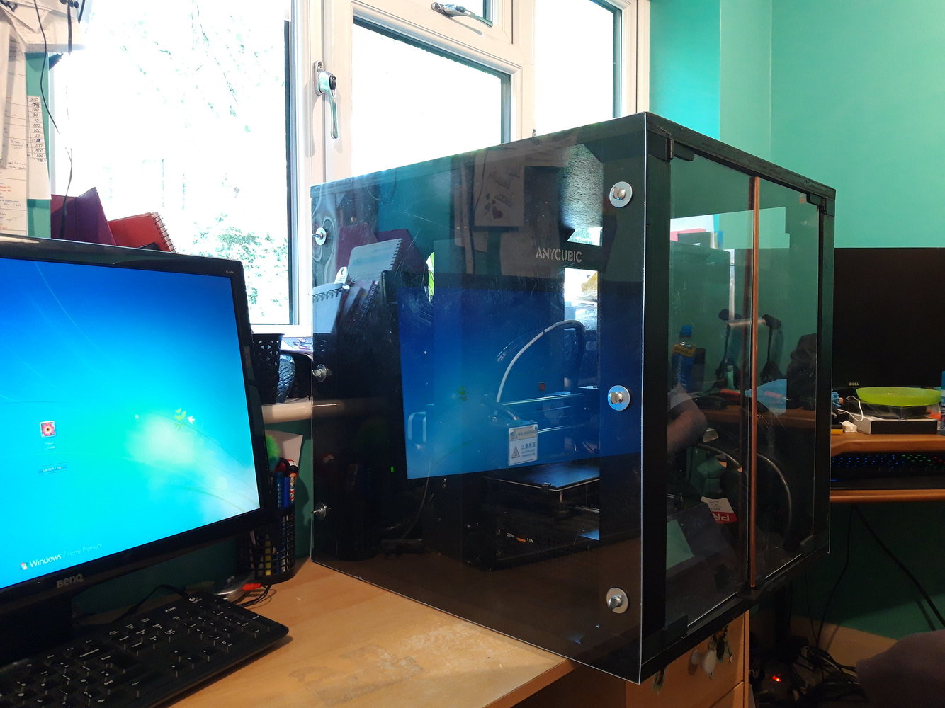

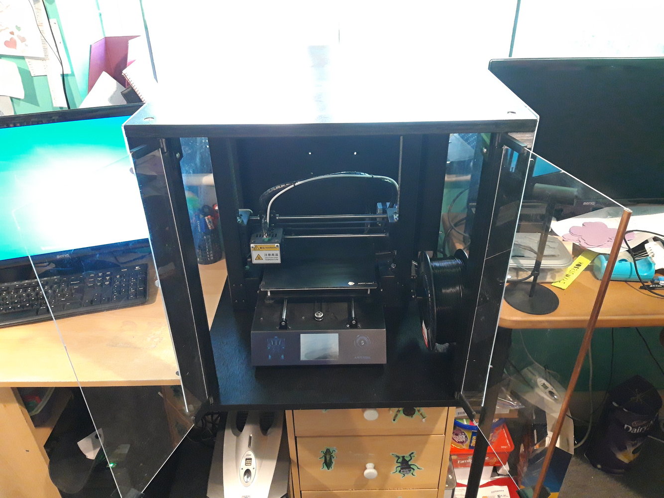

An enclosure is high up on my round tuit. Maybe I could find a design for a round tuit and then it would be easy?![]()

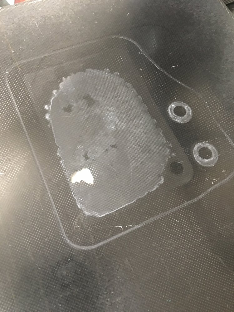

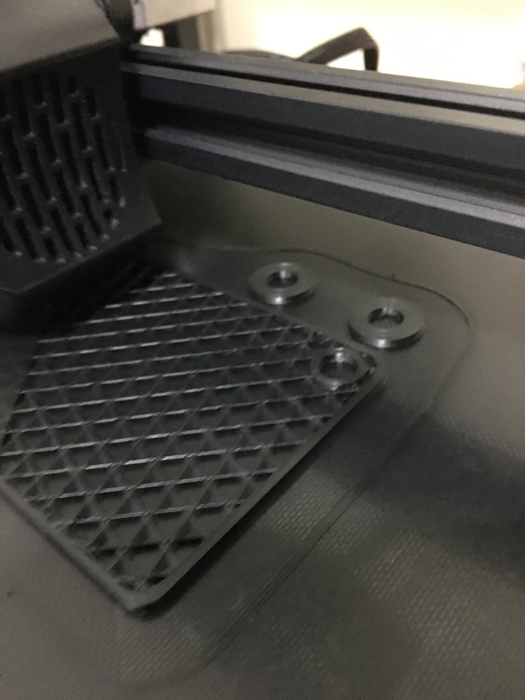

Is that an Anycubic Ultrabase?
Overlaid my lads here with a custom cut to shape, borosilicate glass. Not cheap, just shy of £50 but really good. I can give you the details where I got it from.
For sticky filaments I use a layer of Kapton tape to protect the glass bed. Not really needed for PLA if you let it cool.
