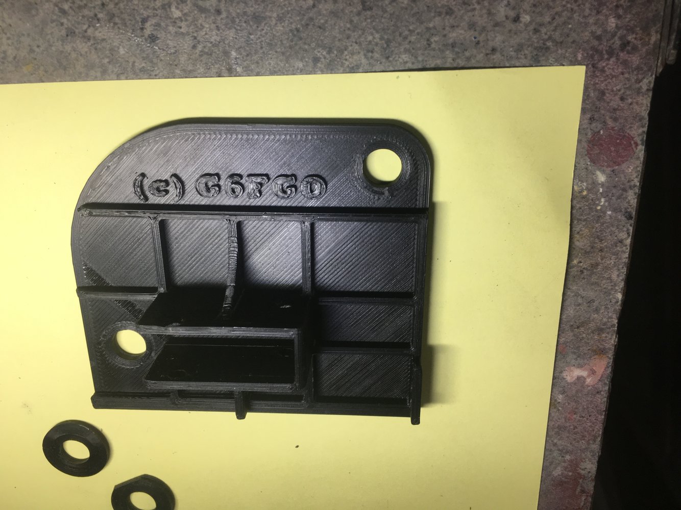

Just flip it over, same happened on my Ender 5, works fine
Yes, cooling fan is off.Usually when printing abs the part cooling fan is off. Not sure how you have it.

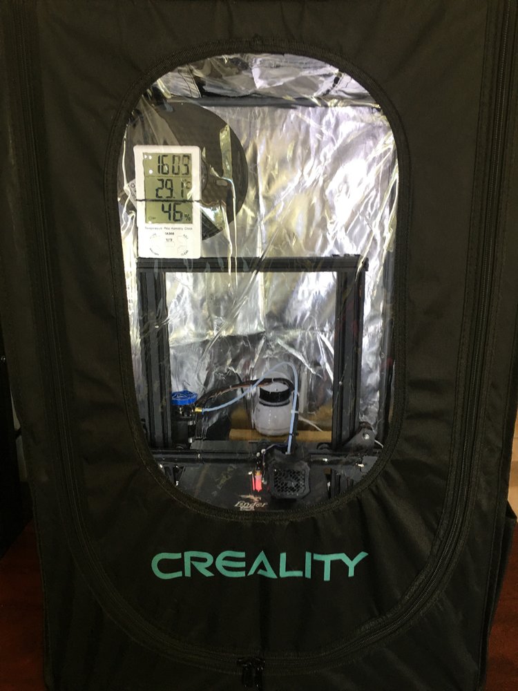

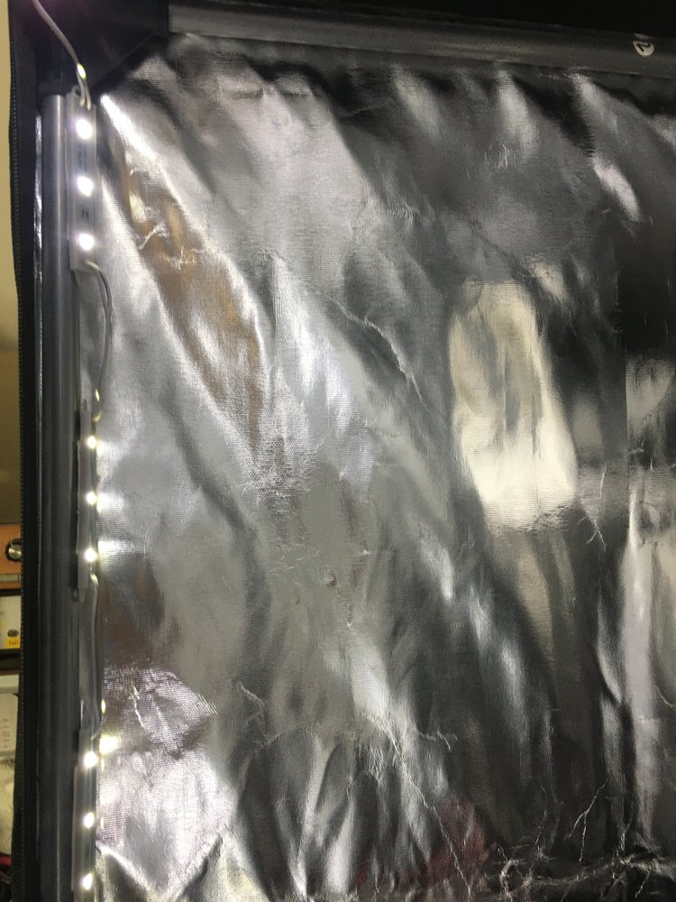

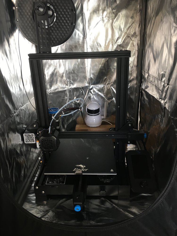

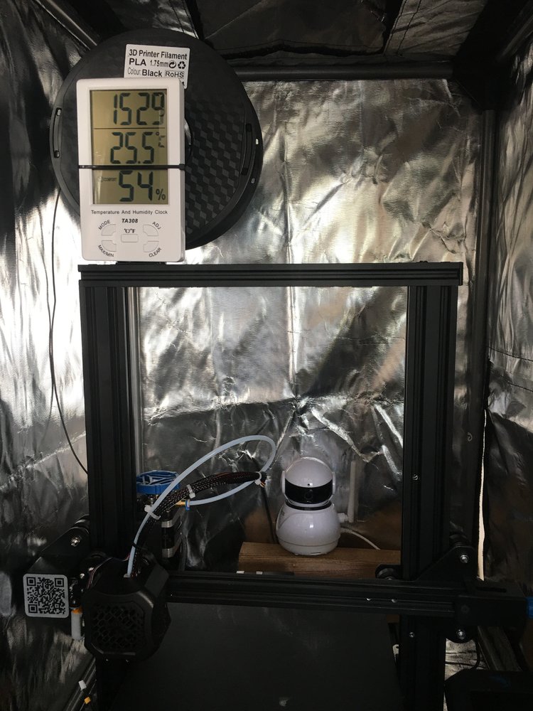

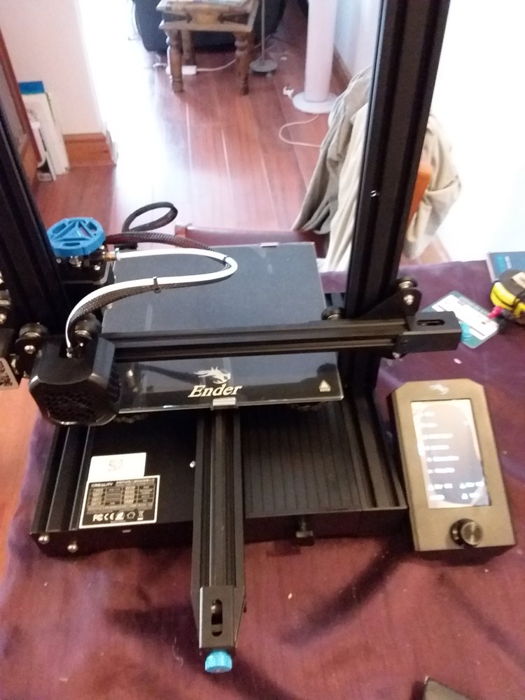

The new bed and enclosure have arrived. Some pictures...
I have ordered what claims to be a Borosilicate bed for £20
Is there a reason it has to be ABS?
From reading online its a pain to print with.
Could you add a heater to the enclosure?

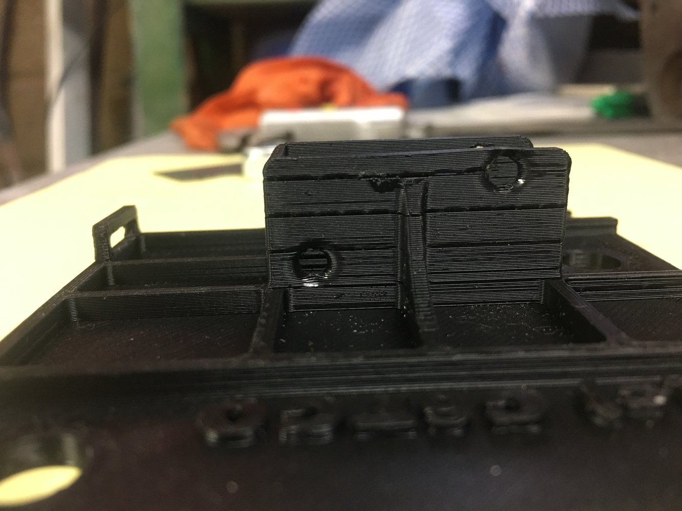

Maybe worth checking with a temperature tower print?

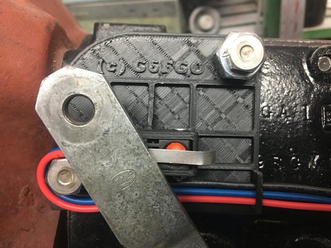

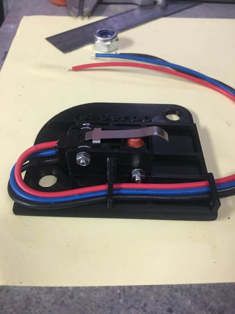

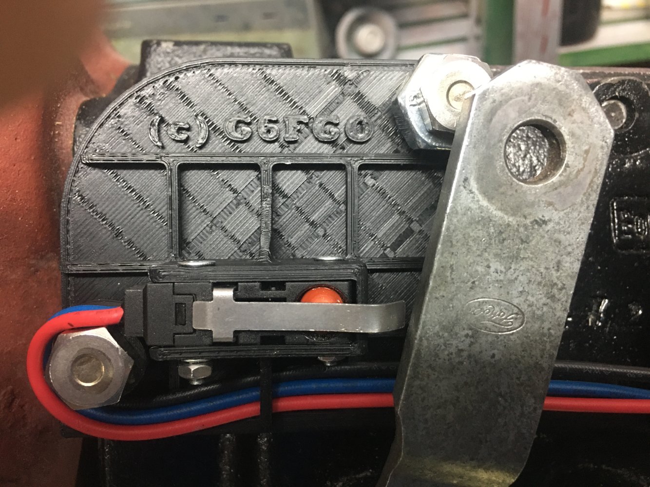

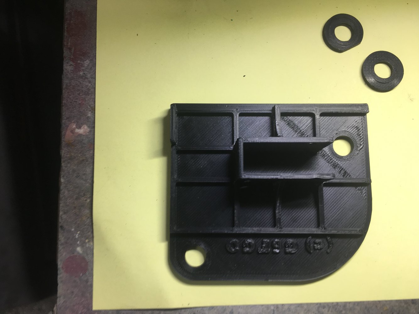

ABS warps easily and I bet the switch holder warps and then that causes layer adhesion issues.
Can you modify the model to bulk up the bits that are breaking or add gradients in material thickness changes?
