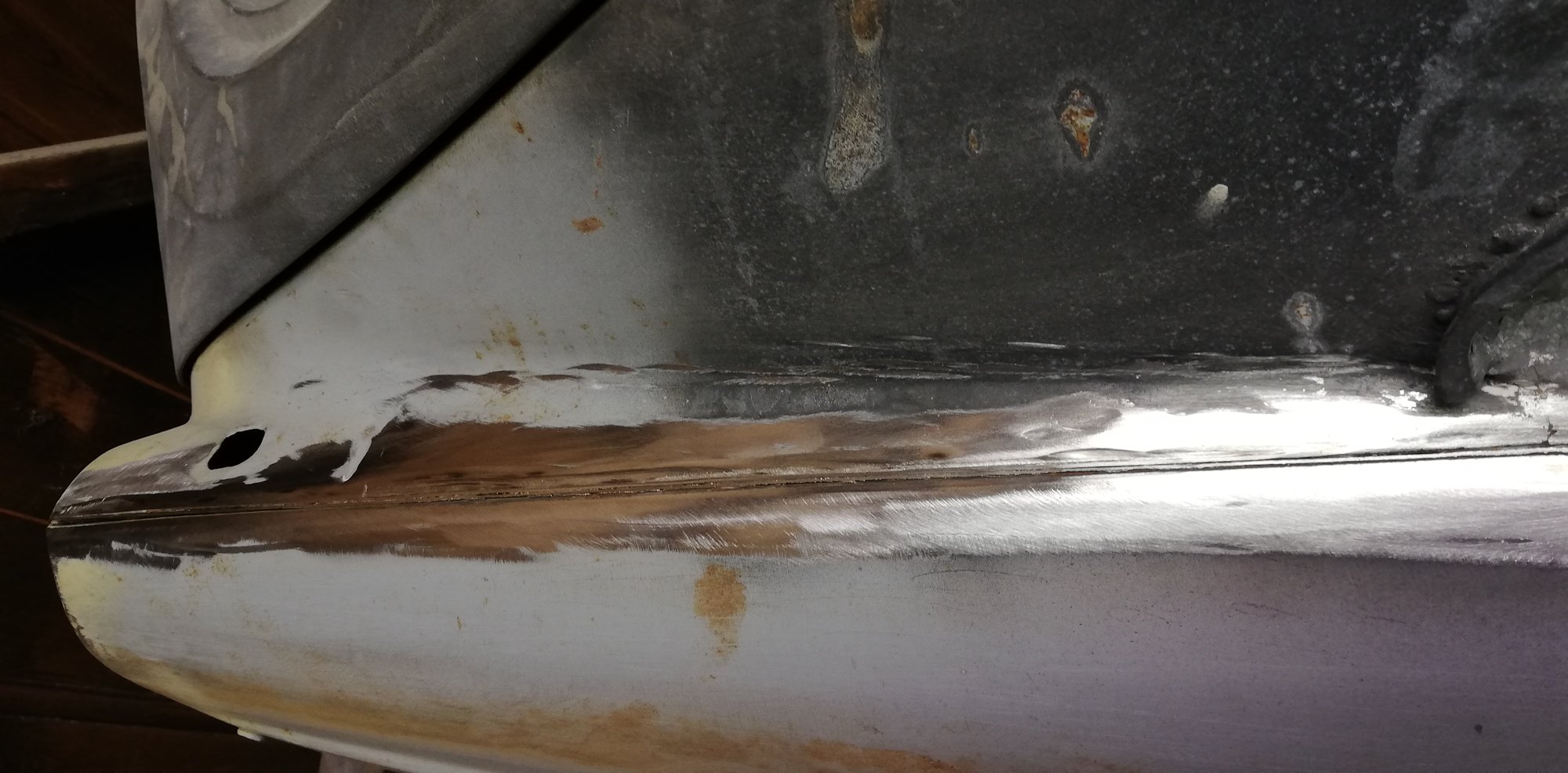

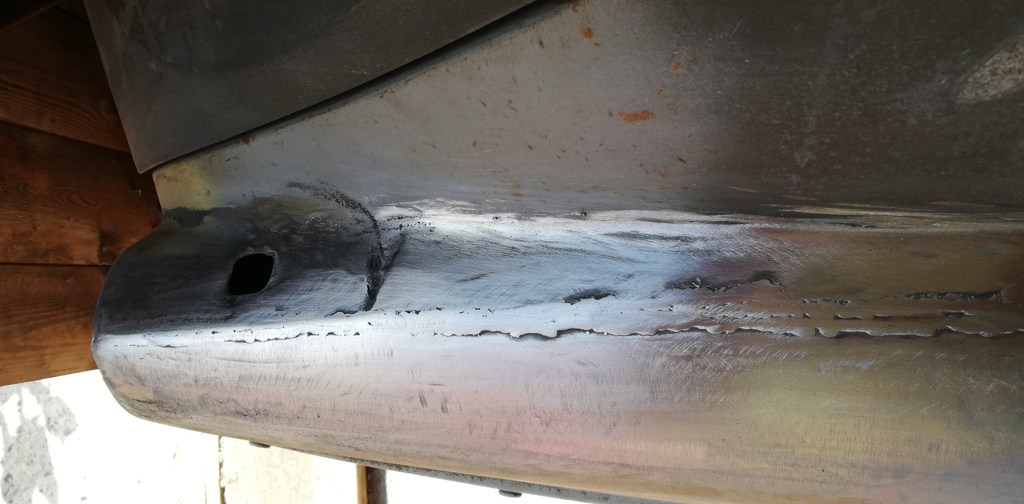

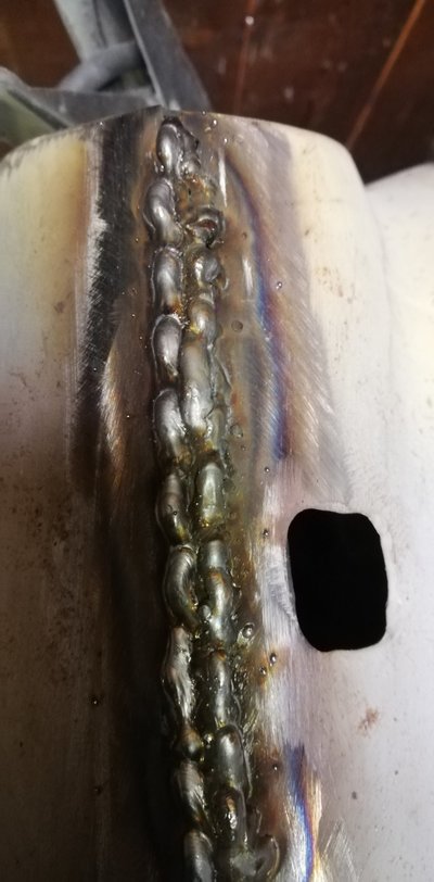

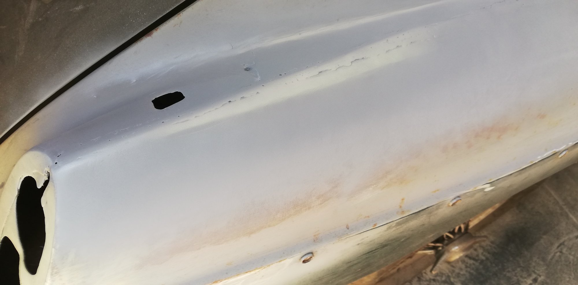

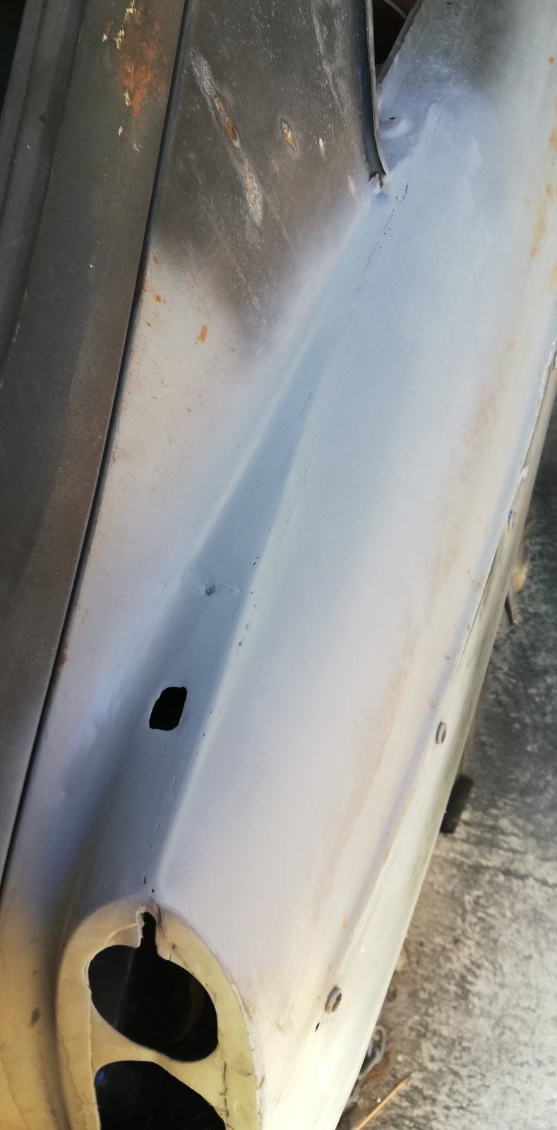

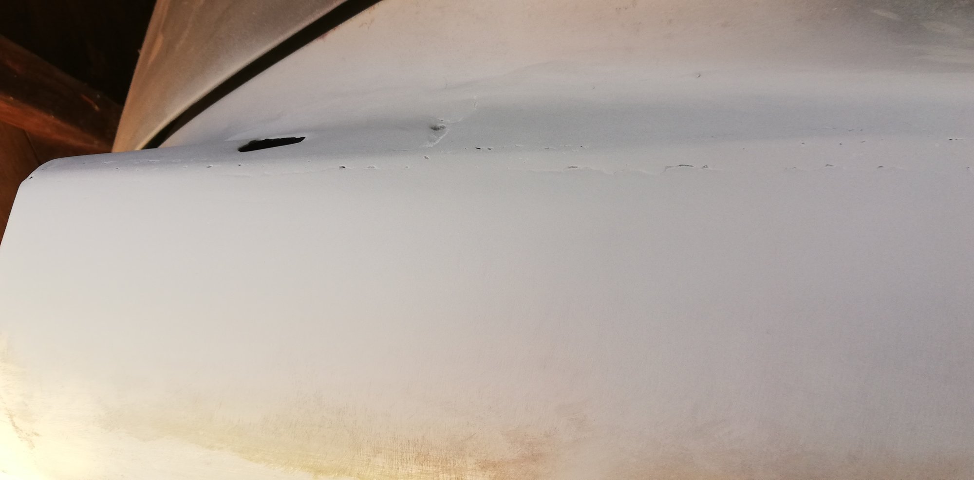

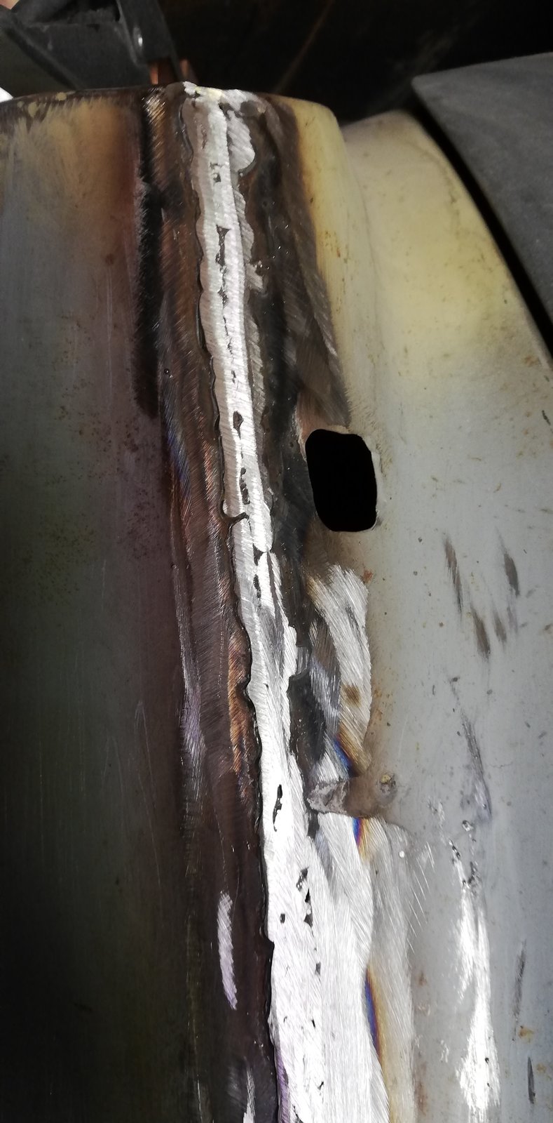

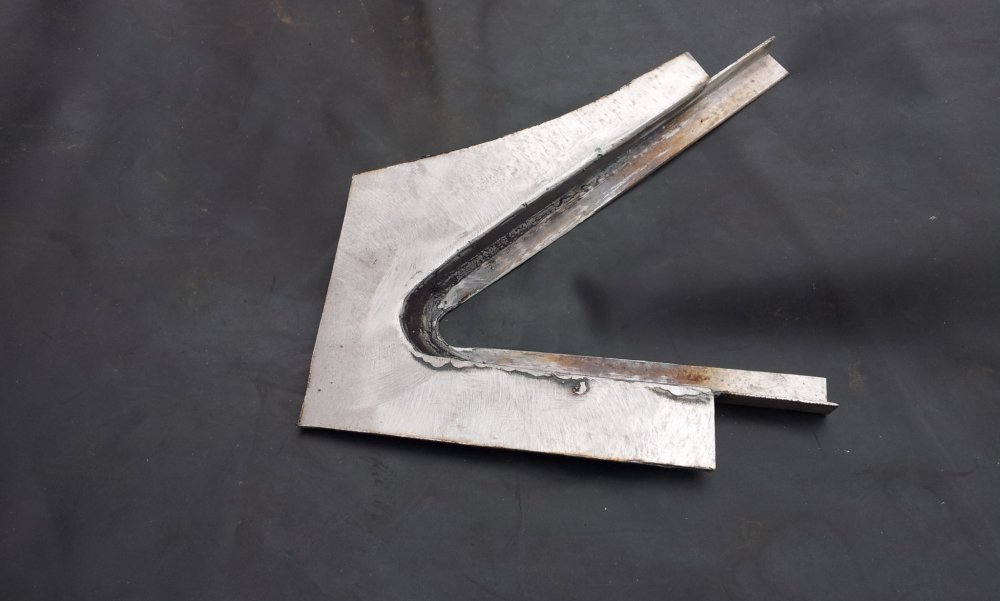

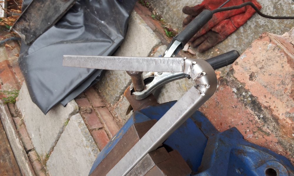

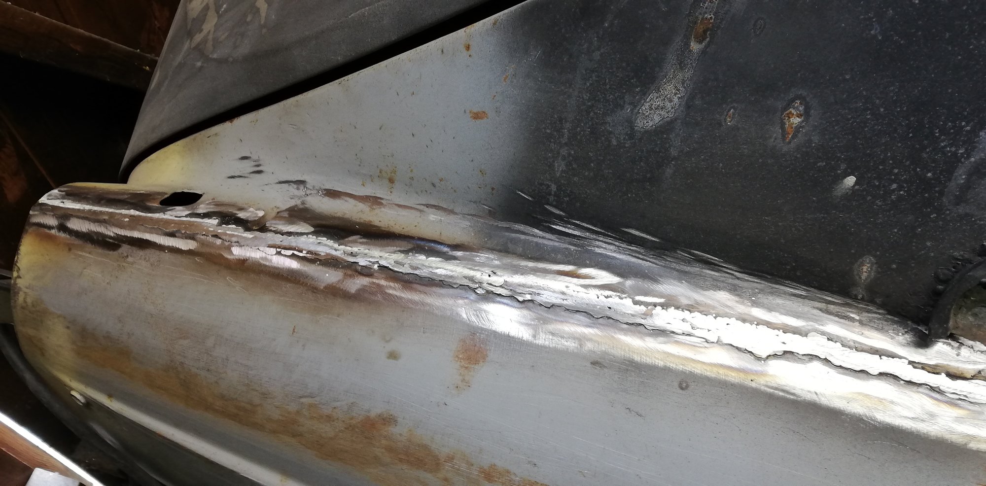

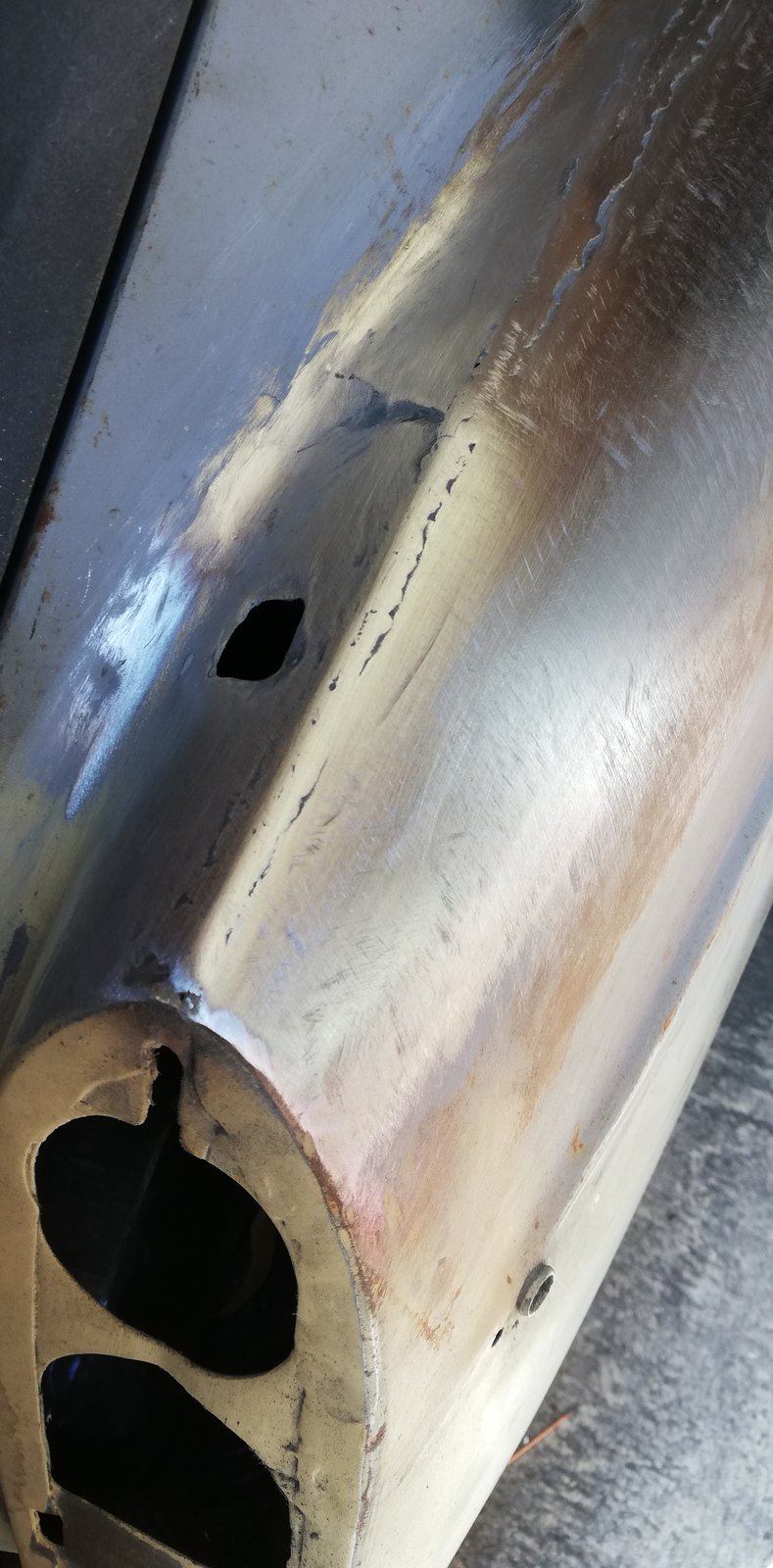

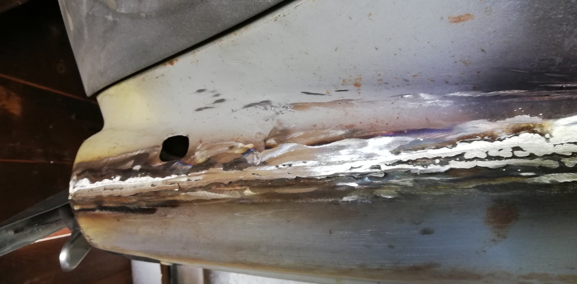

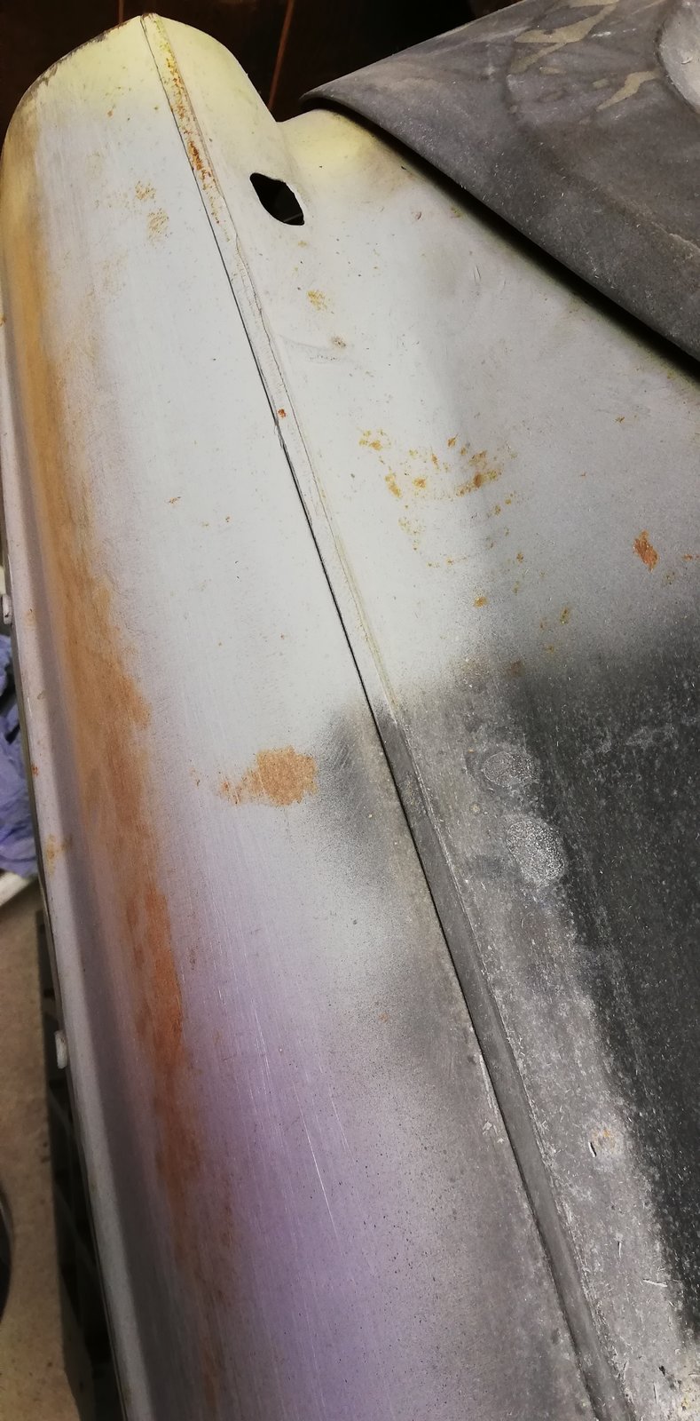

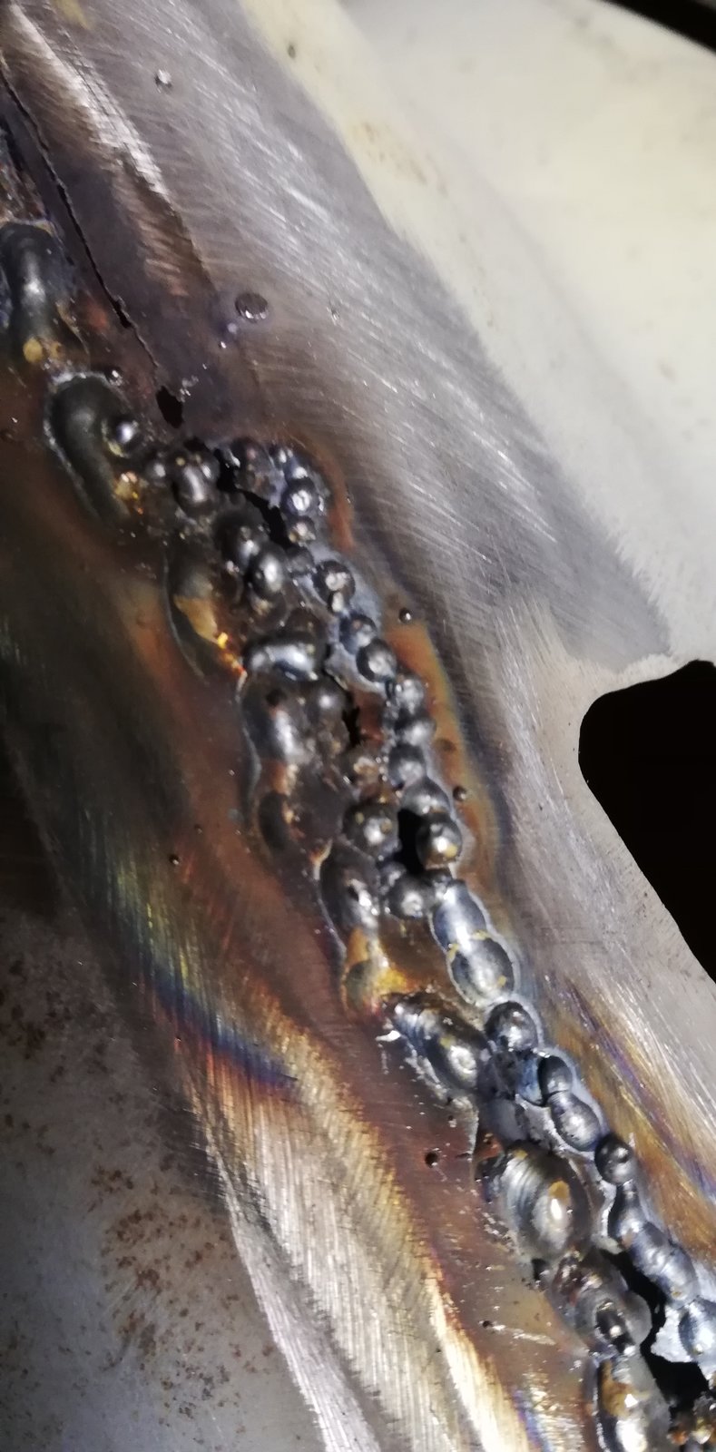

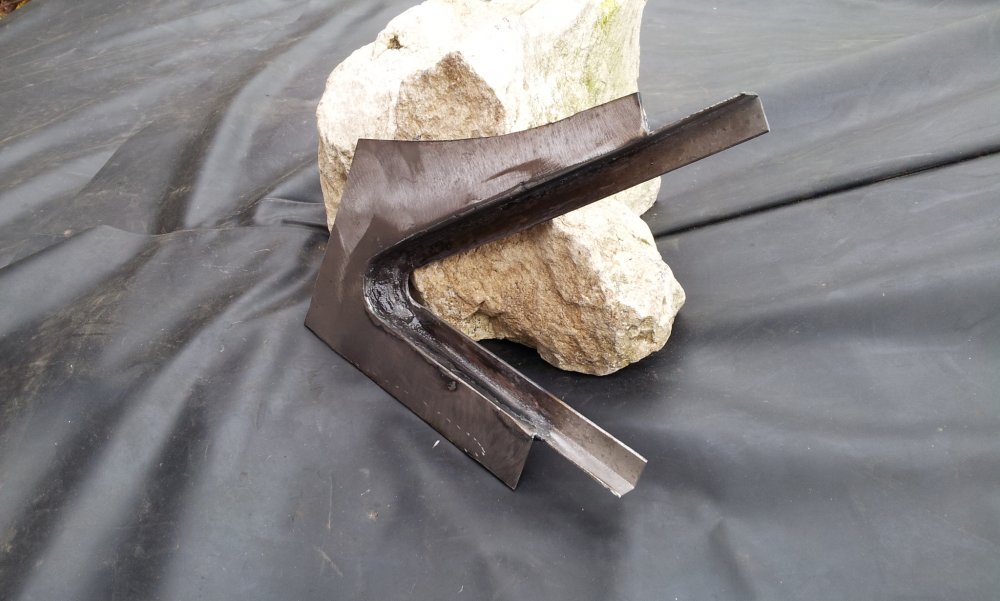

Decided to finish off a job on the door post that I have been putting off for a while.
A good while back I made the basic box shape but didn't drill amd tap a thicker plate to screw the hinges too and then weld it in place.
So these are the pictures all together for the door post. Think it's the A post. I never get it right.

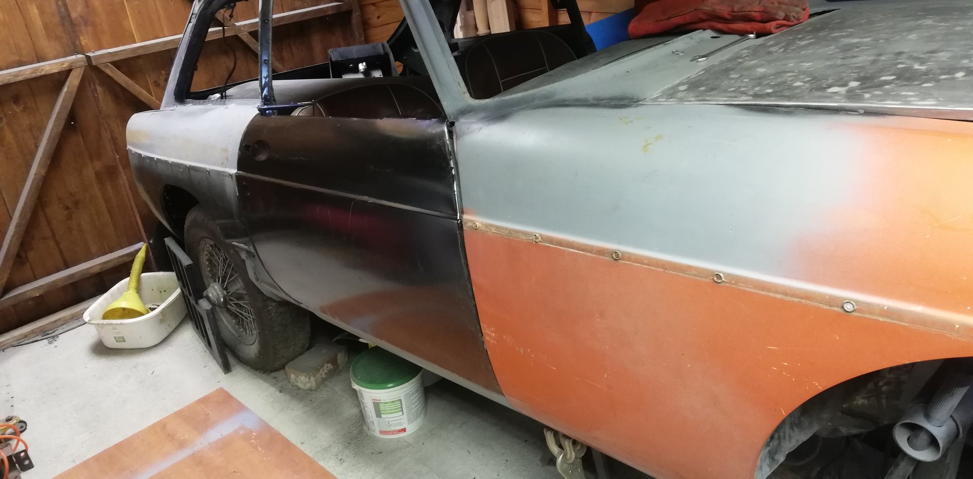

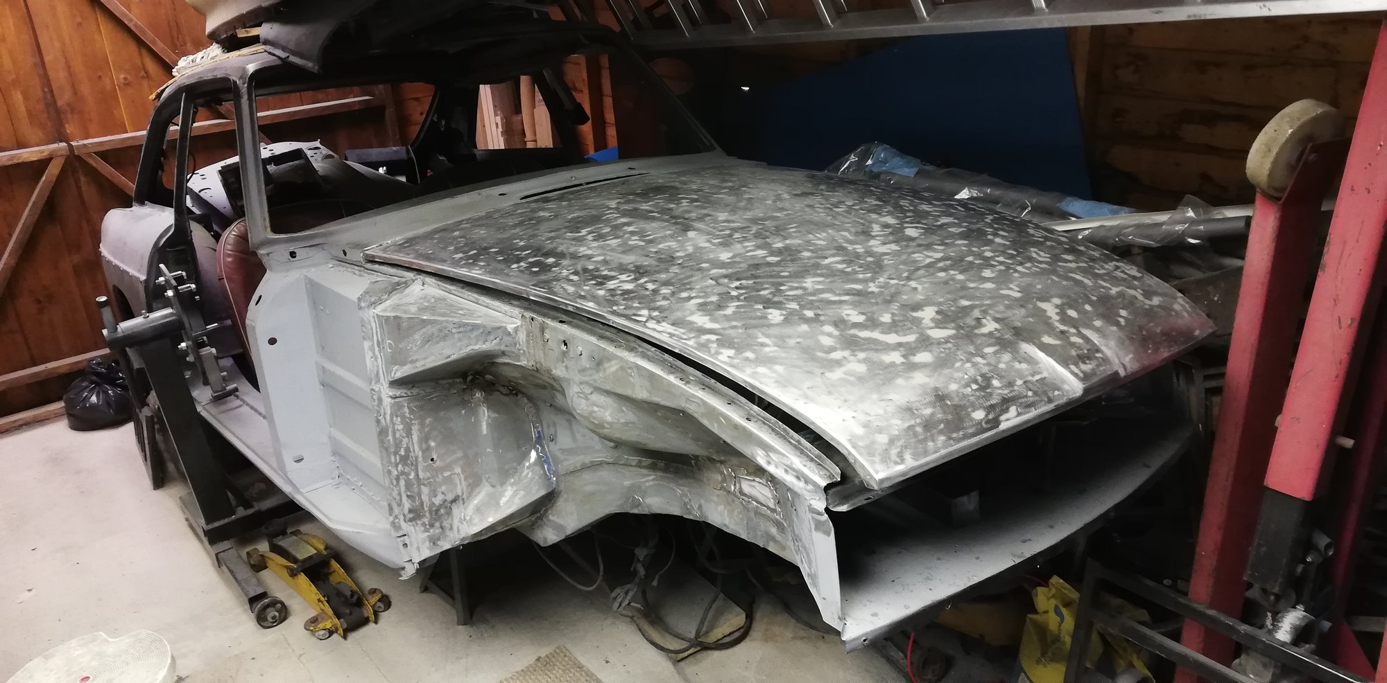

It does mean I can get the passenger door skin on the frame and back on the car which is the next job I think
What have you done in the way of bracing the door gaps? Without braces things tend to move all over the place and you will probably find that out only when you come to fit the doors. Leading is really very easy, but only if you have a very controllable heat source. Seemed to me that things like blowlamps mean either too much or too little heat, and tend to make things pretty difficult.
