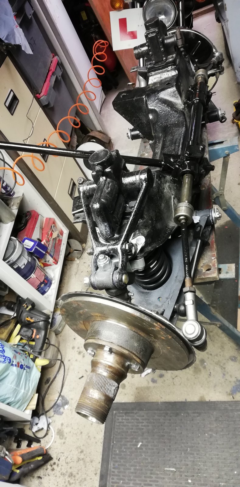

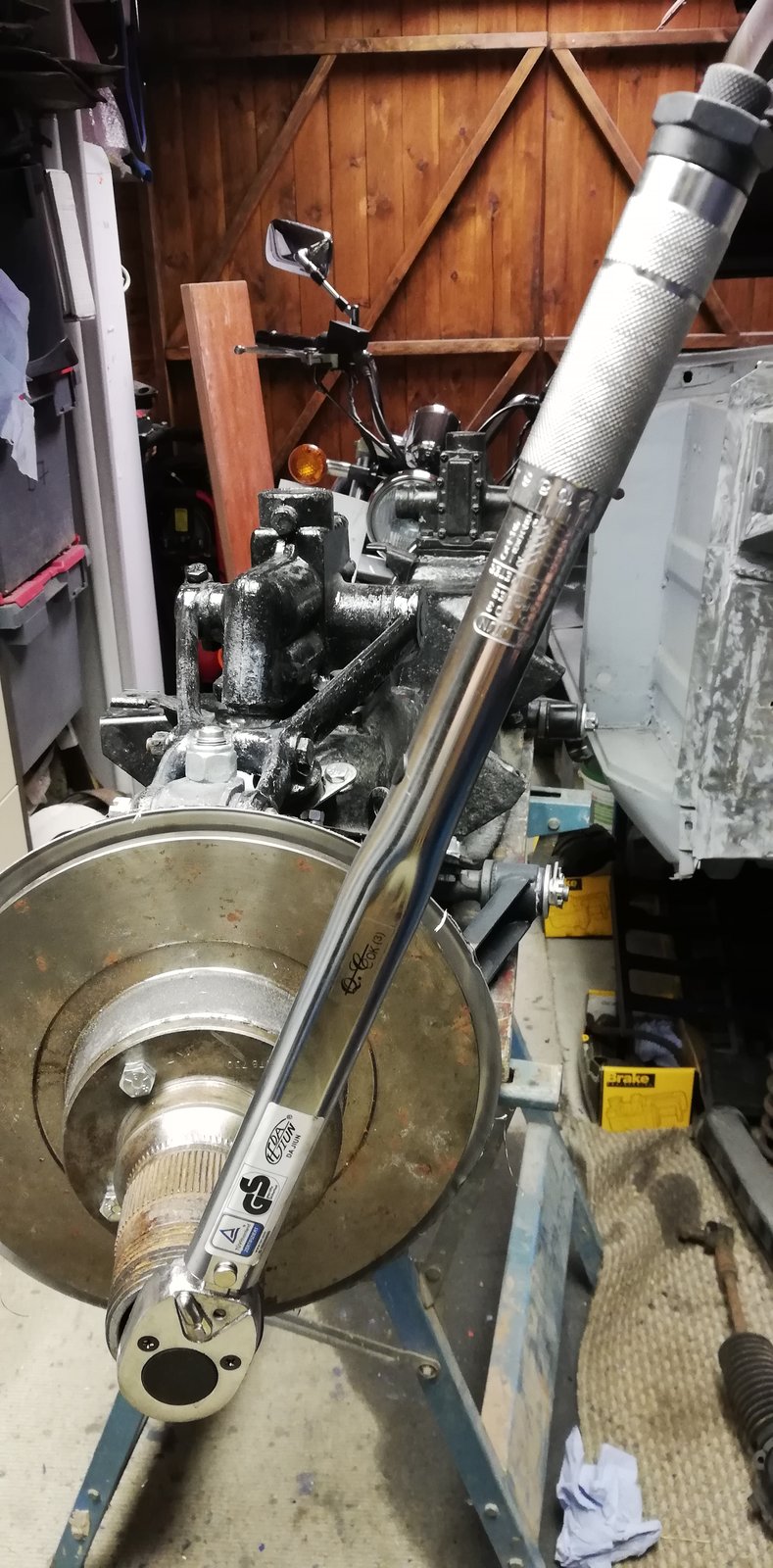

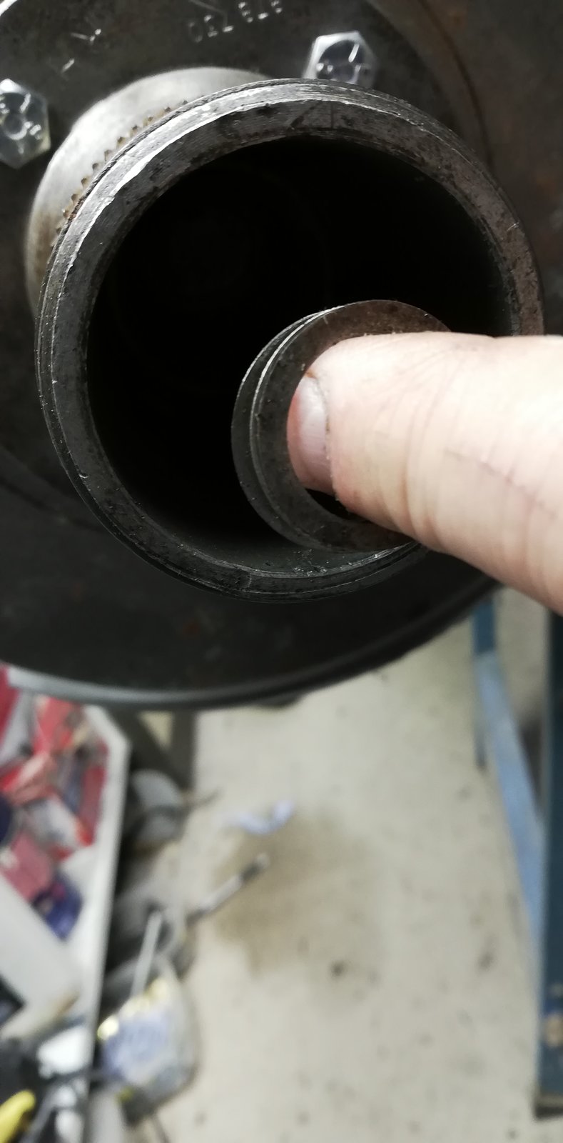

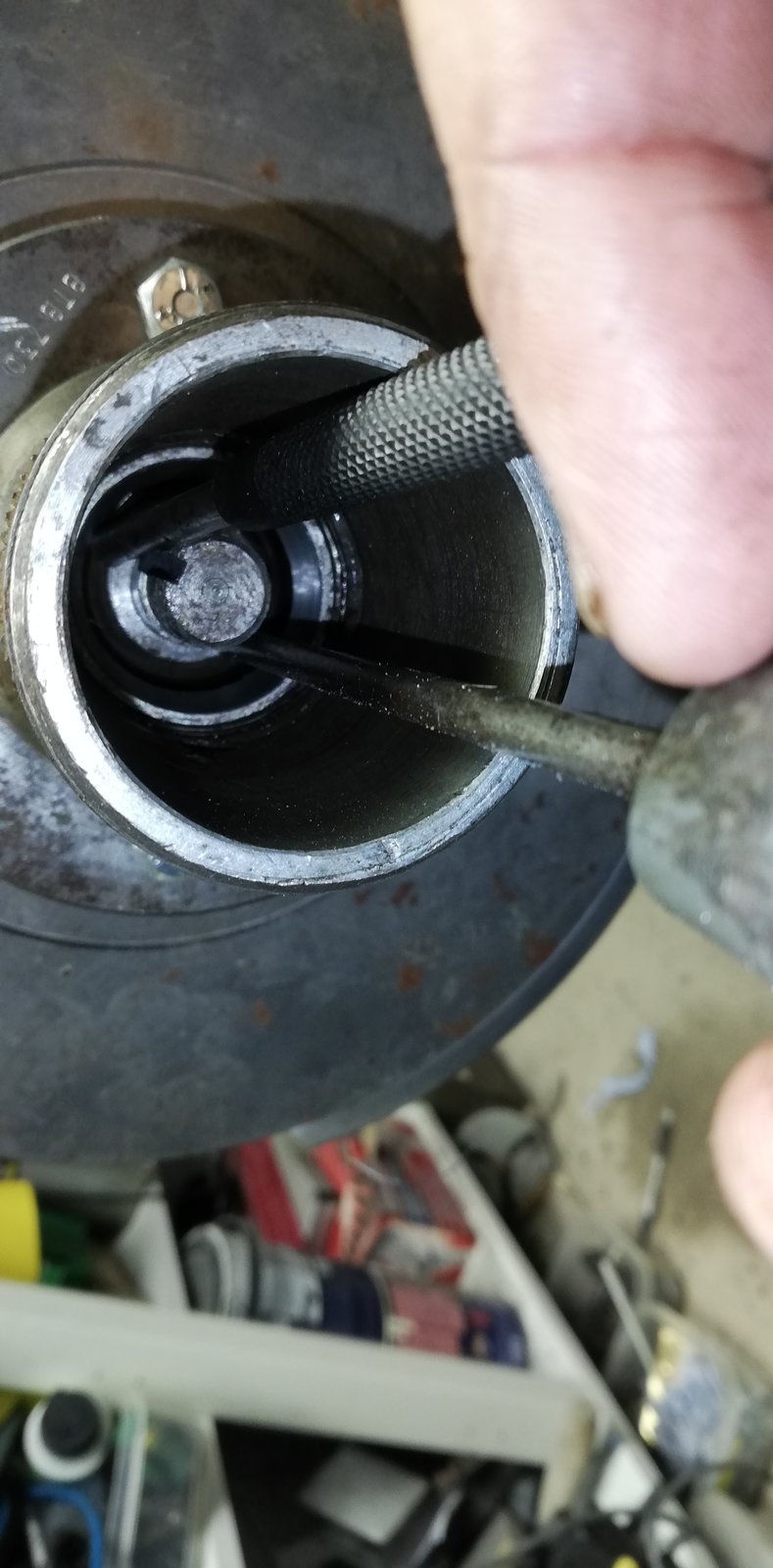

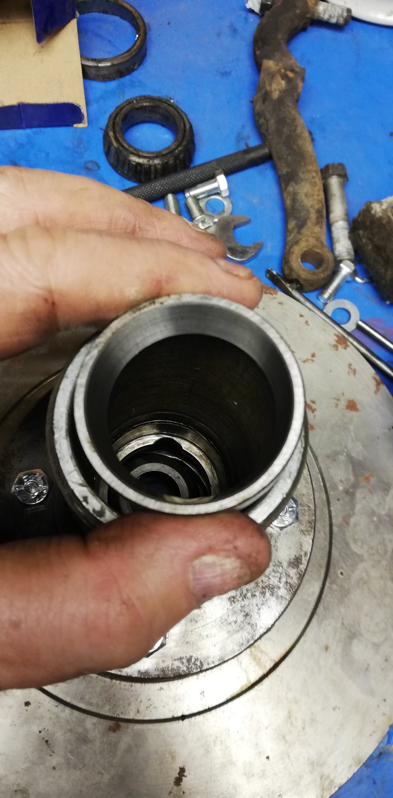

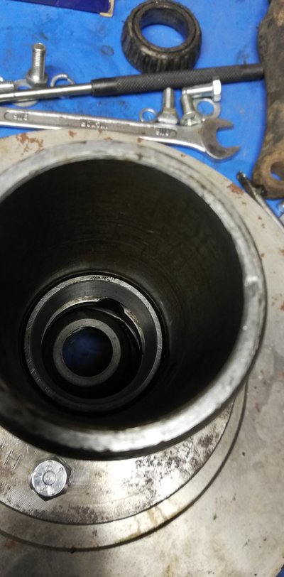

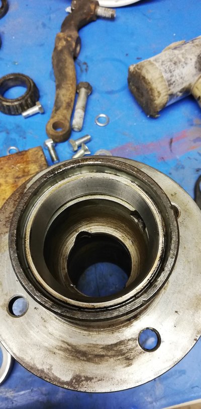

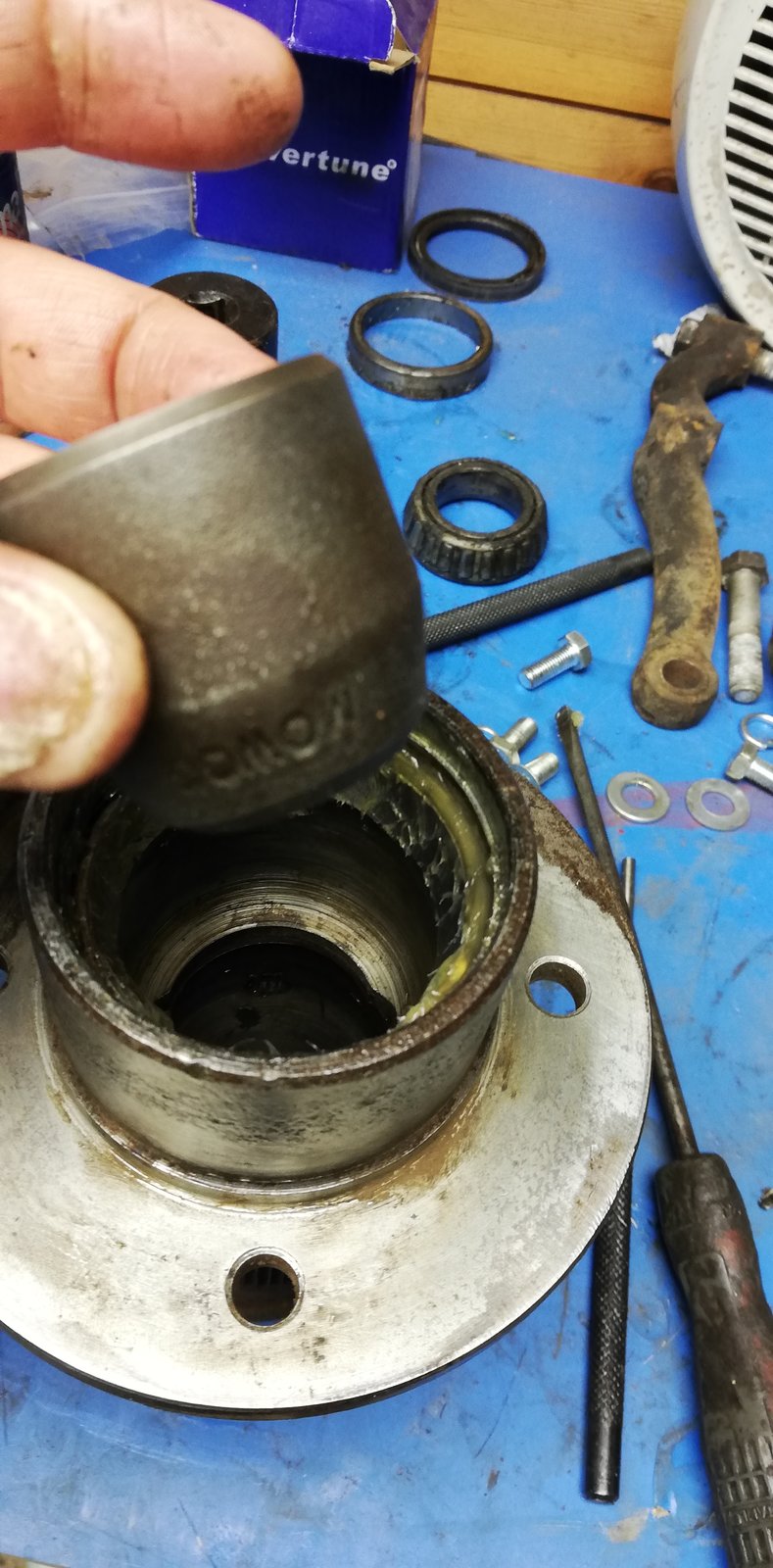

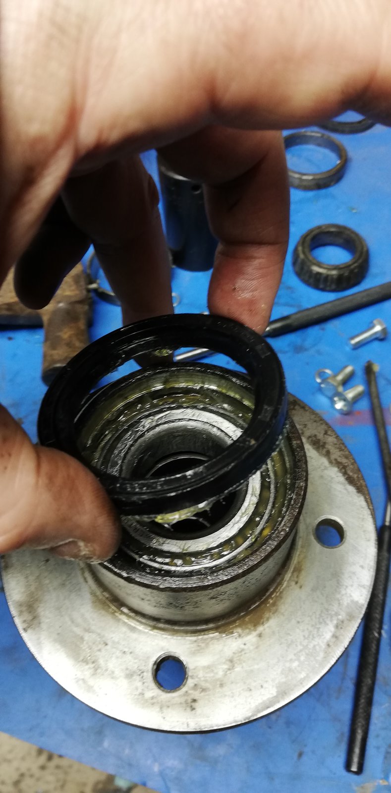

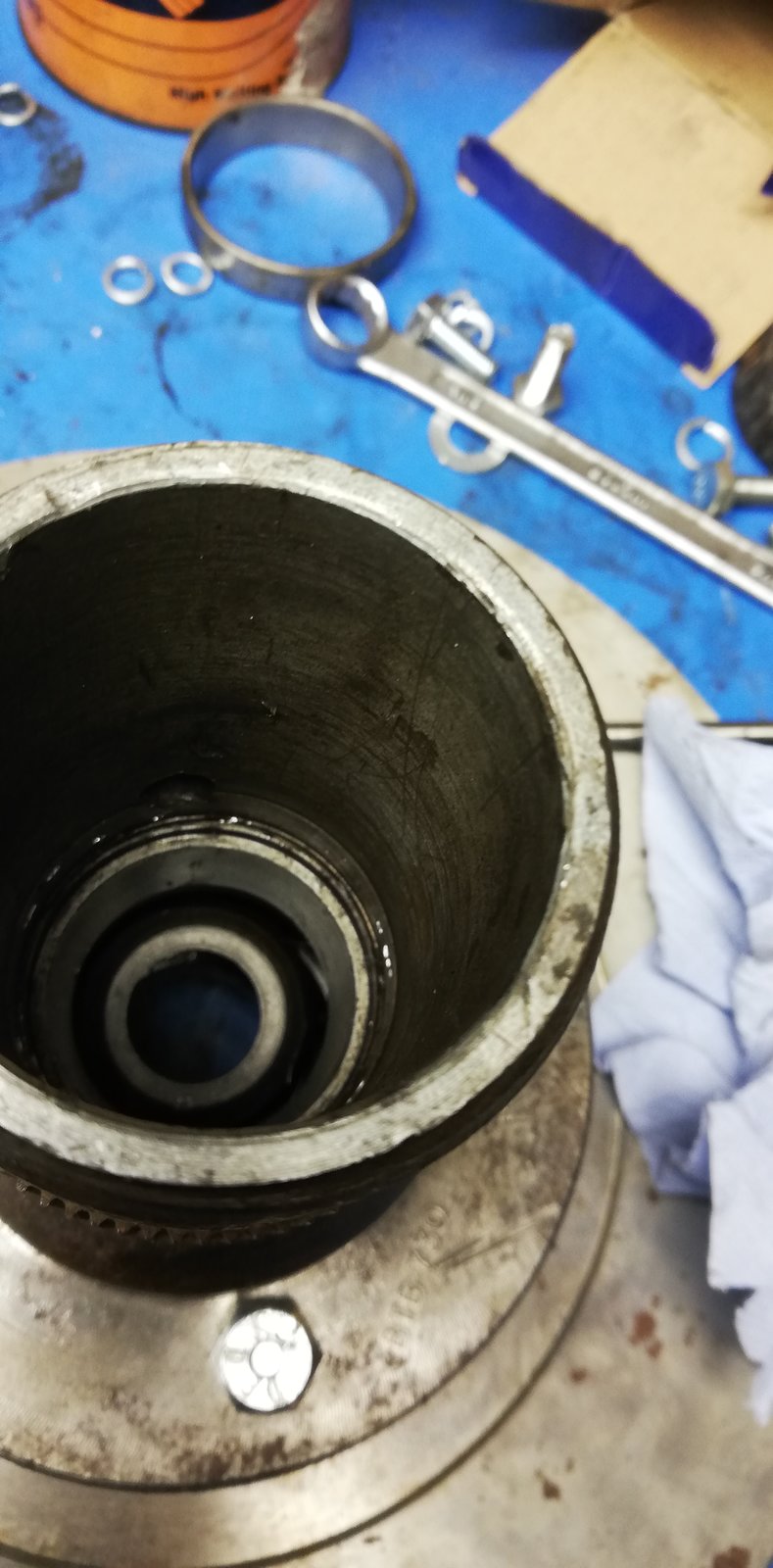

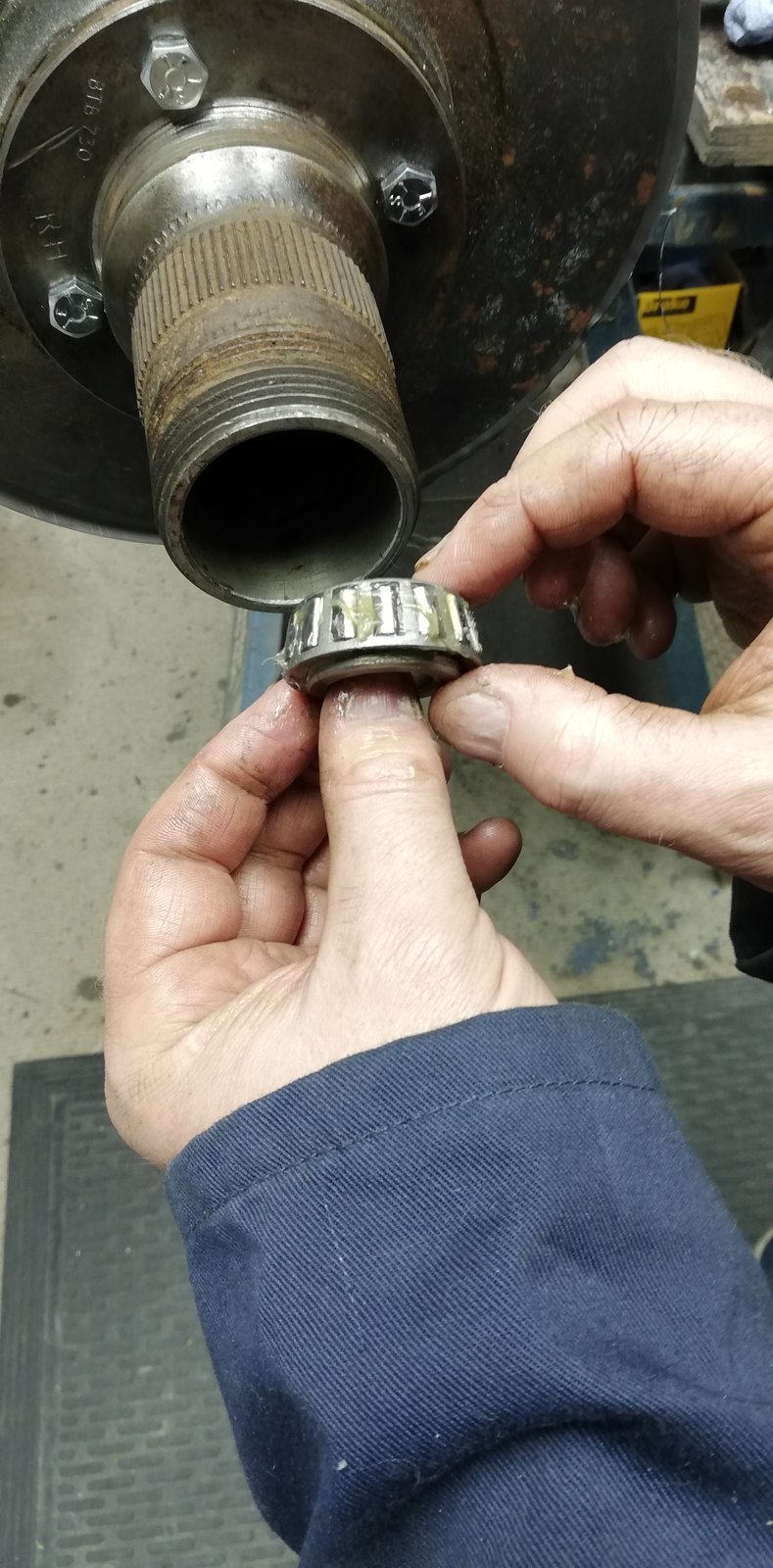

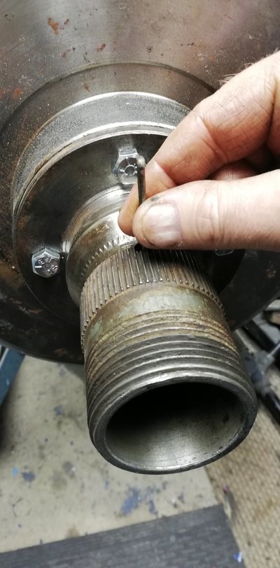

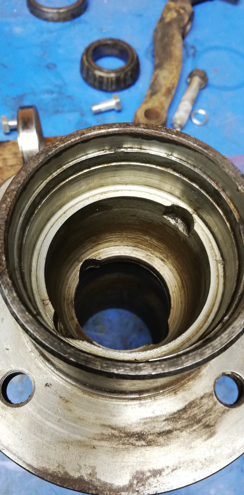

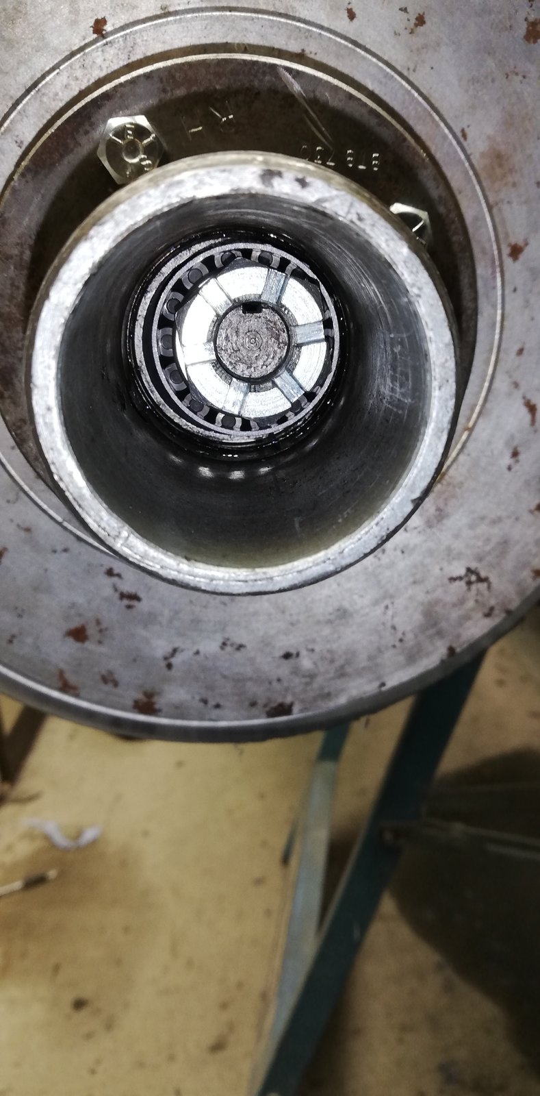

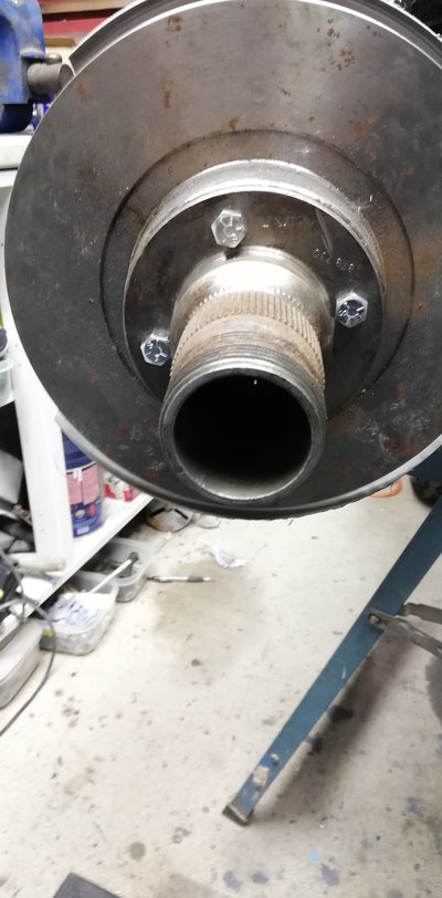

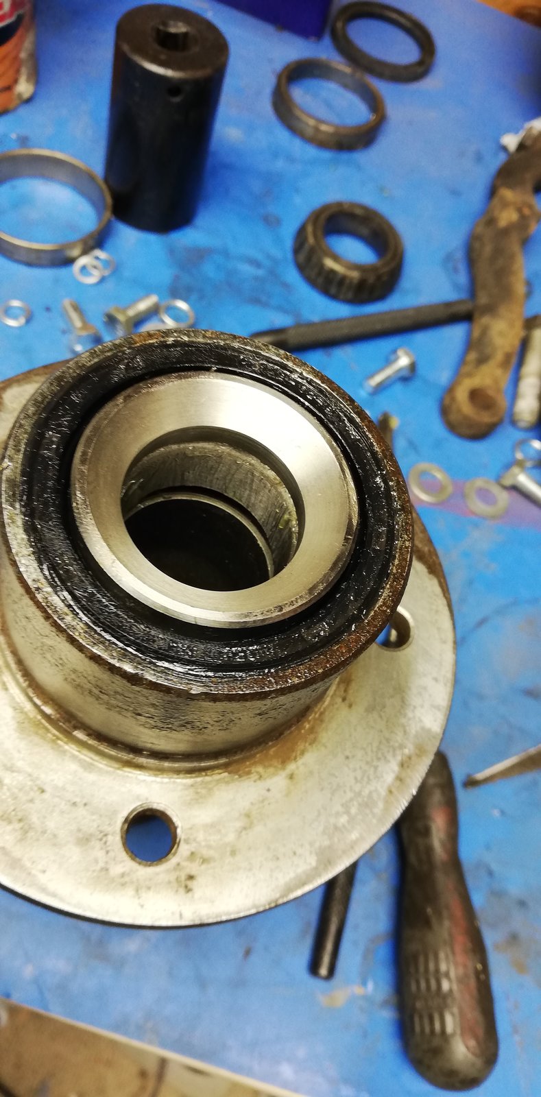

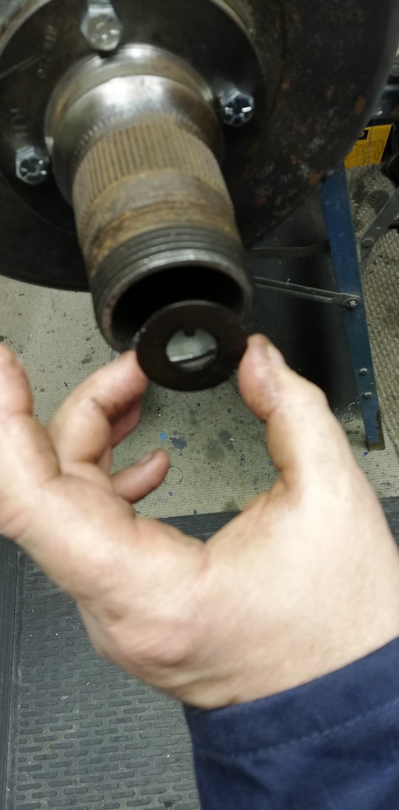

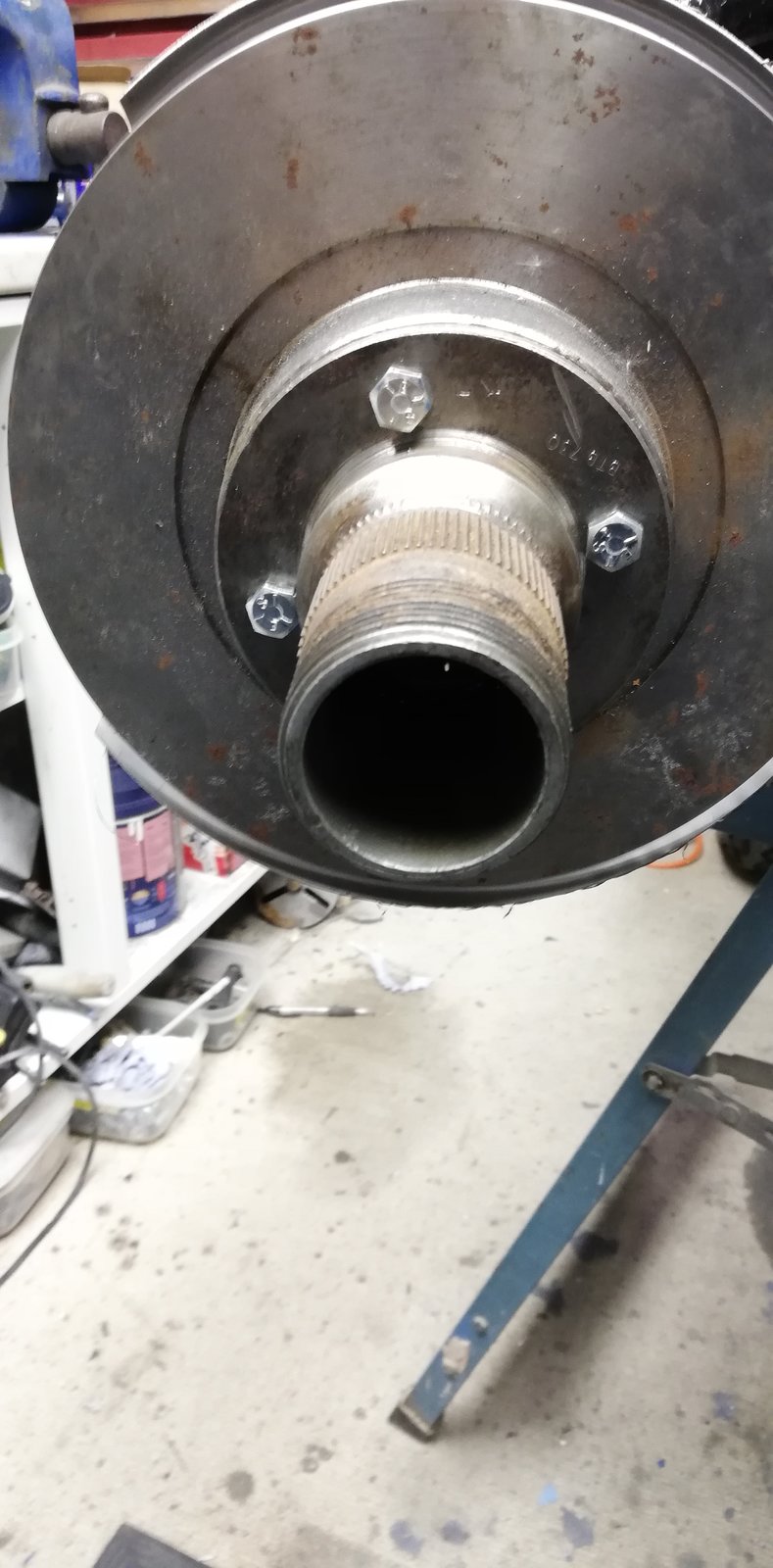

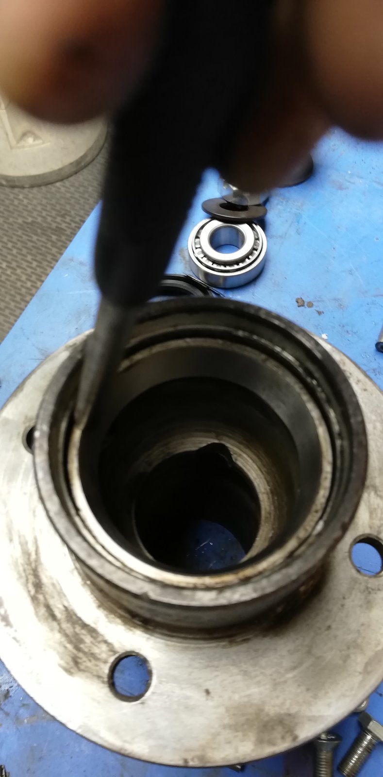

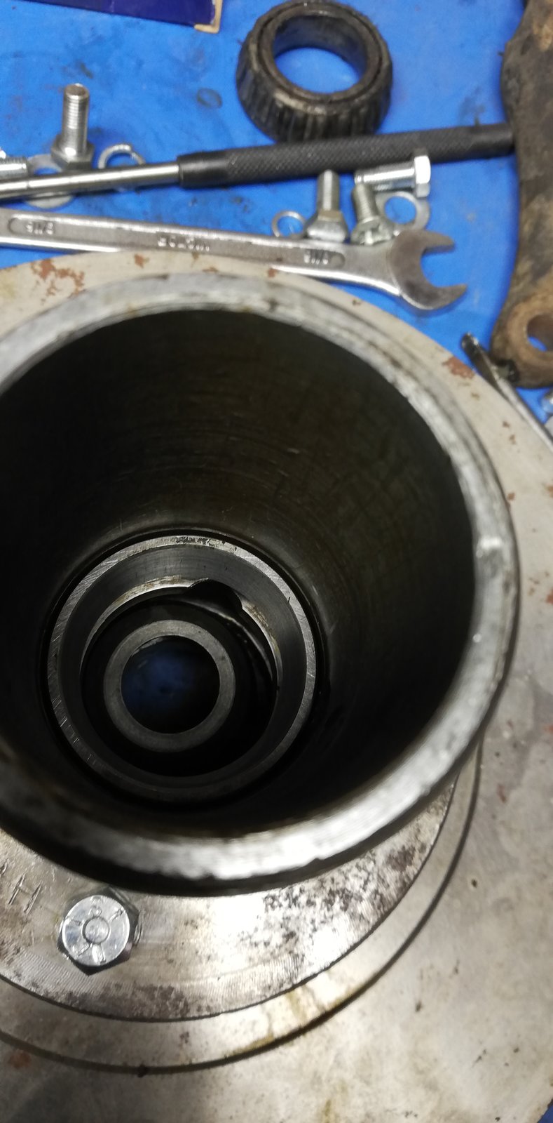

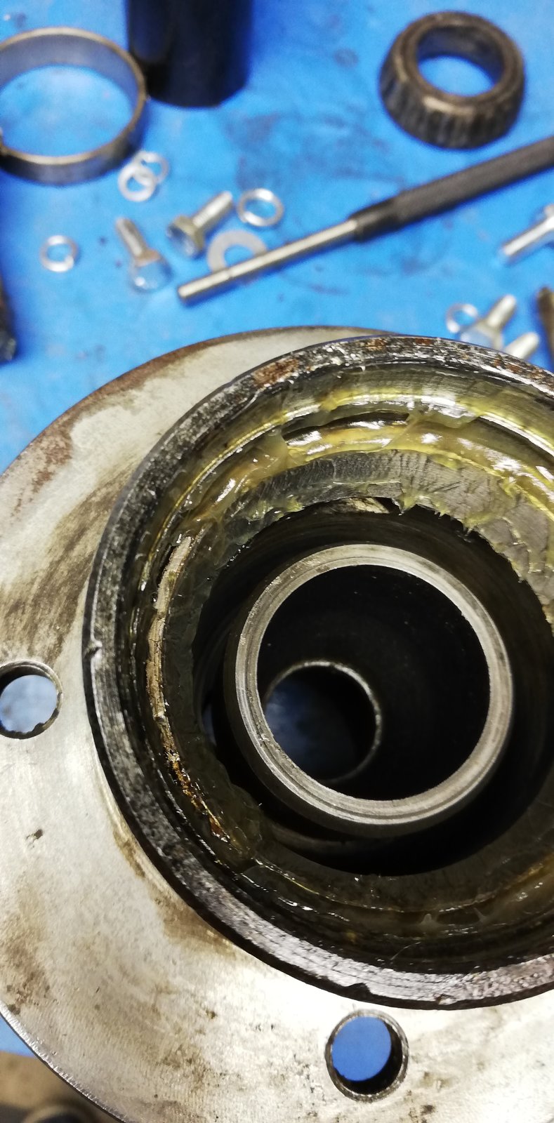

Fitting a new set of wheel bearings onto the new stub axle.

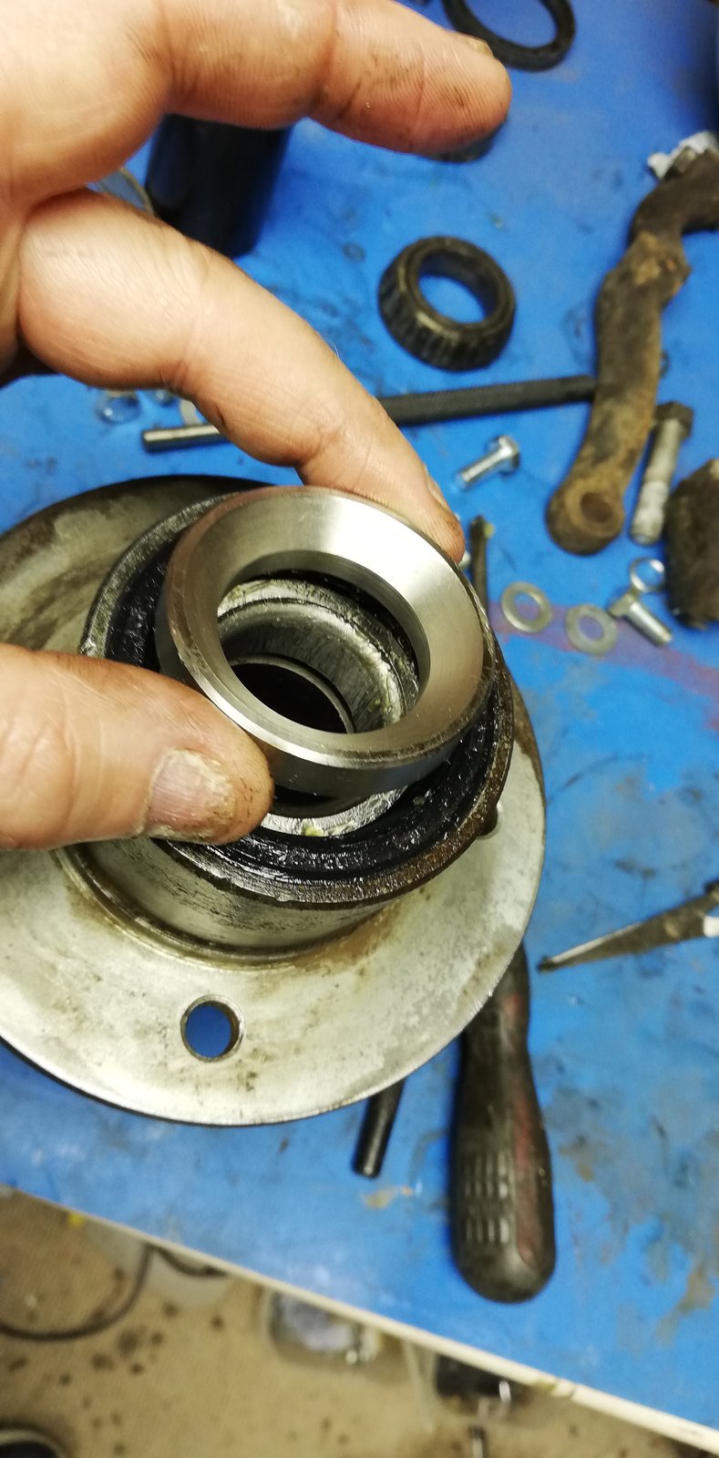

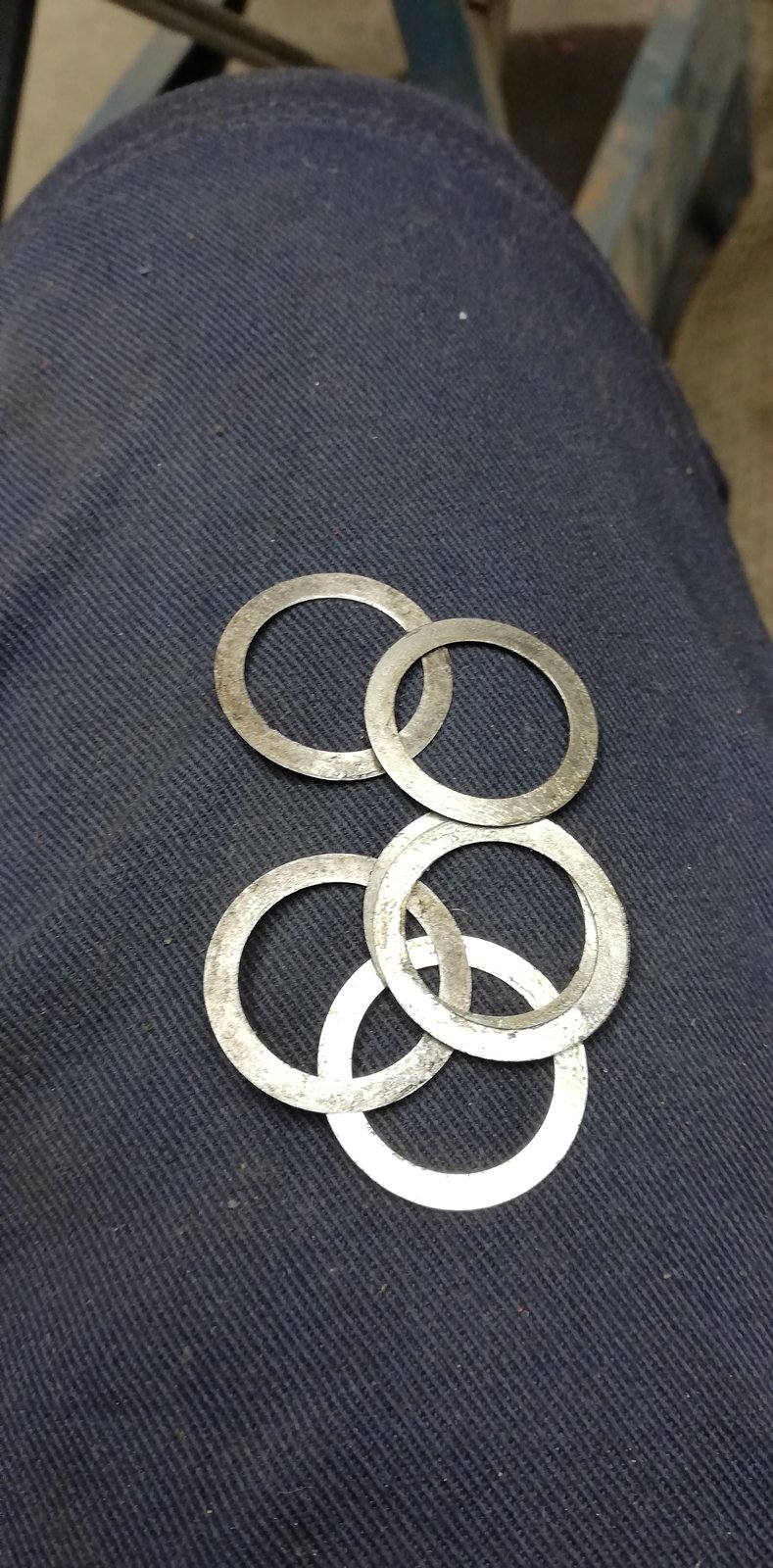

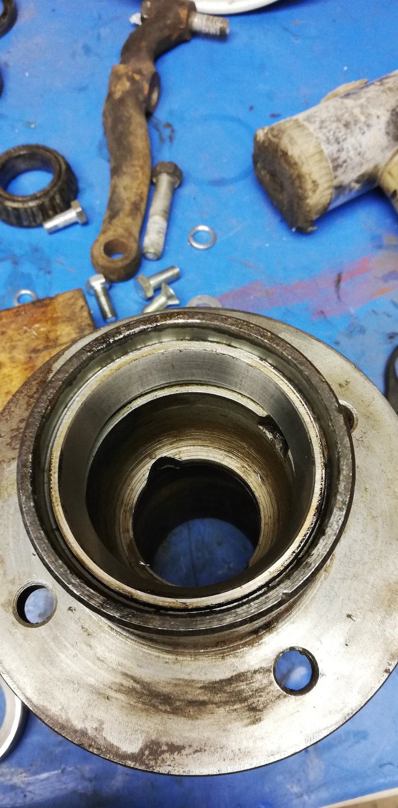

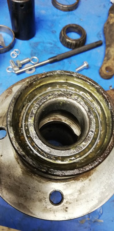

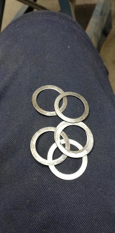

Important thing with mgbs is to get the shimms correct between the rear and front bearing.
Something that the previous owner of this car never bothered to do. In fact they didn't even put a rear oil seal collar on.

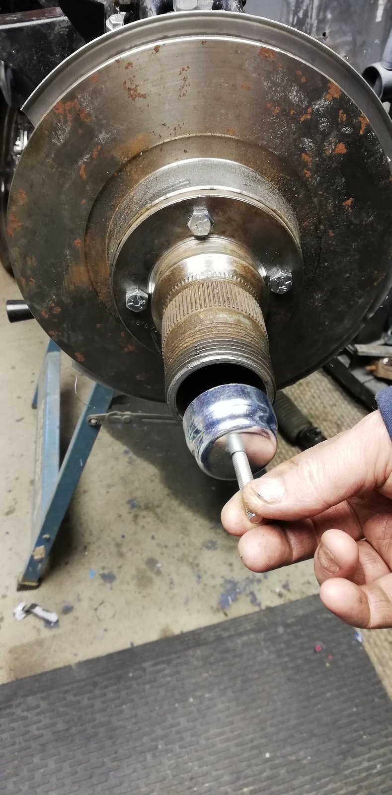

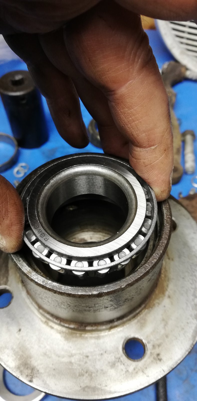

This job takes a bit of patience as you have to assemble them disassemble the hub several times to get to the 0.3mm backlash. Dial test indicator is a useful tool.
Looking forwards to the other side next

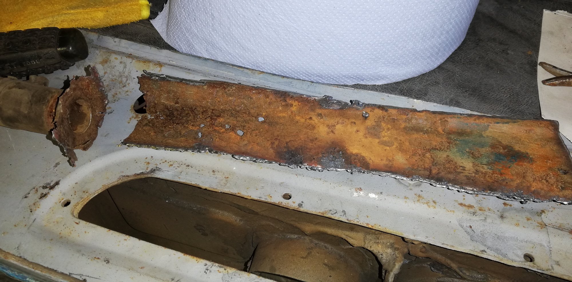

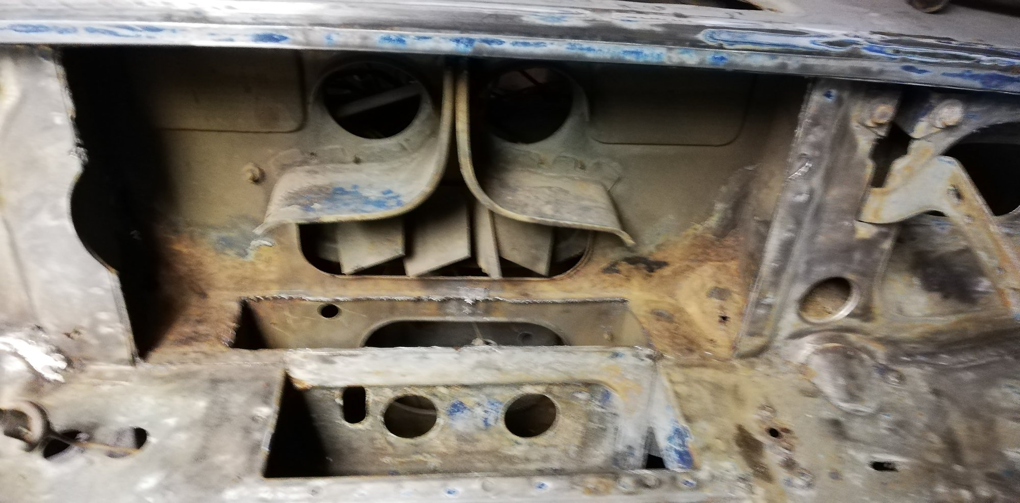

Sorry for crossed wires. I love the design of the wing. However my wing is ugly from previous restorations where it has deep cuts and poor repairs. I'm a huge mg styling fanI'll have you know sir the rear wing are NOT ugly , that's (spelling ... I can never spell it ) Piannia Ferina ...
Styling roof and rear wing when they hard topped the soft top ....

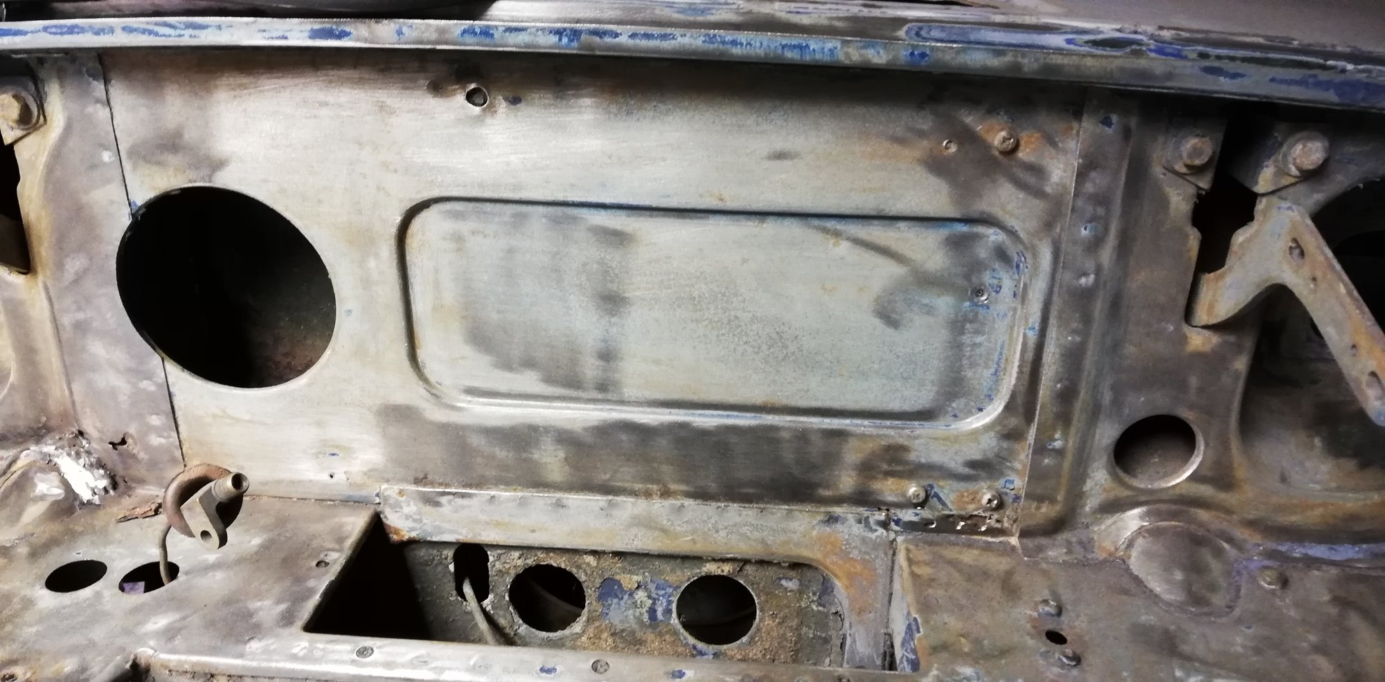

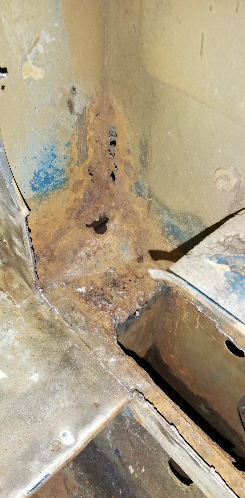

Aside from that , I agree the rear seam and also scuttle to wings is a rust trap and mine will be going ...
Nice going on the rest

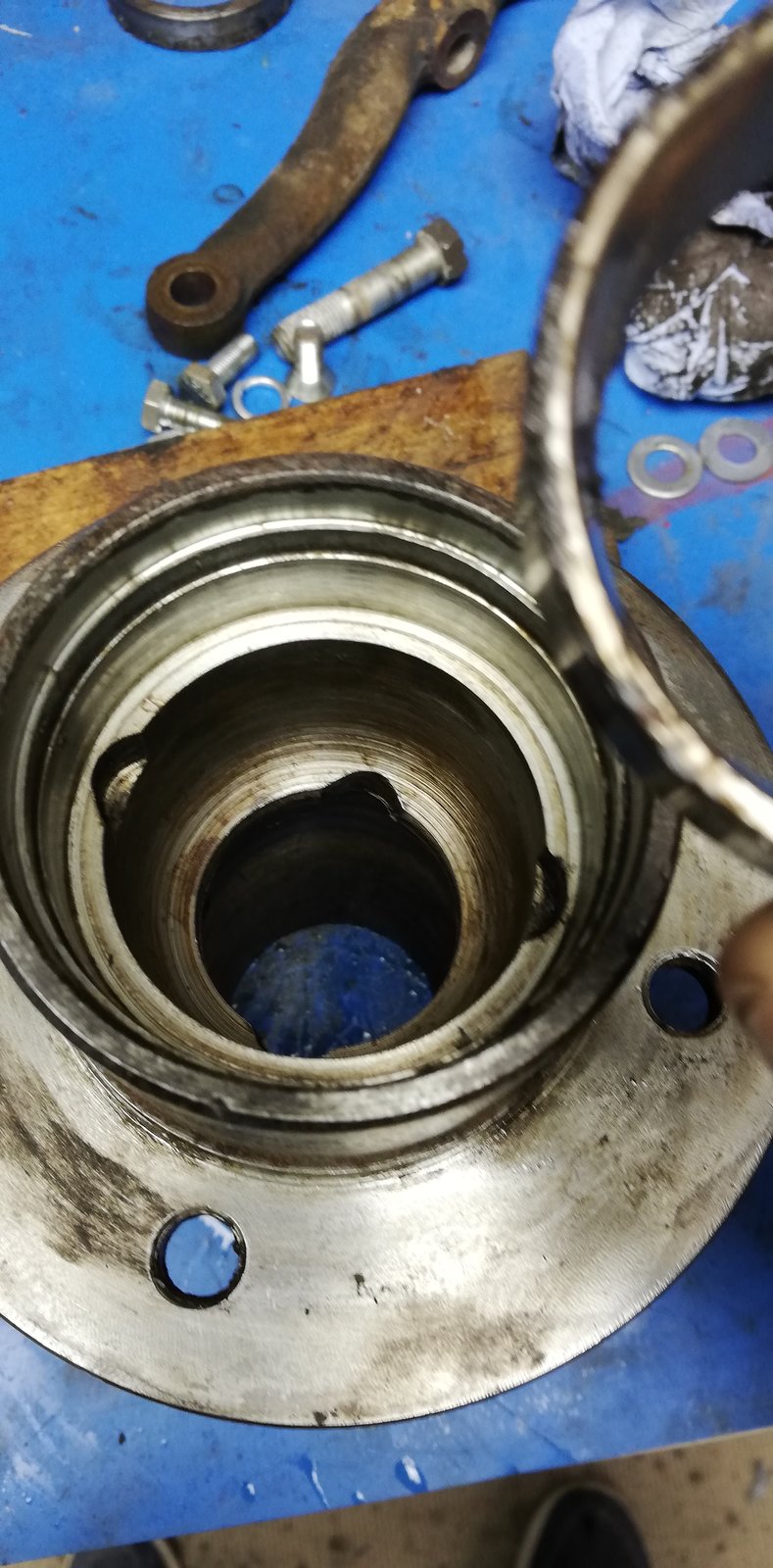

Did you find that you needed a lot of shims before you got near to achieving the correct amount of free play?
I’ve got no feeling on the best approach for this job.....
Also, how difficult was it to insert the new inner (rear) bearing - that’s the one which is an interference fit in the housing if I remember correctly - any tips you can pass on?
