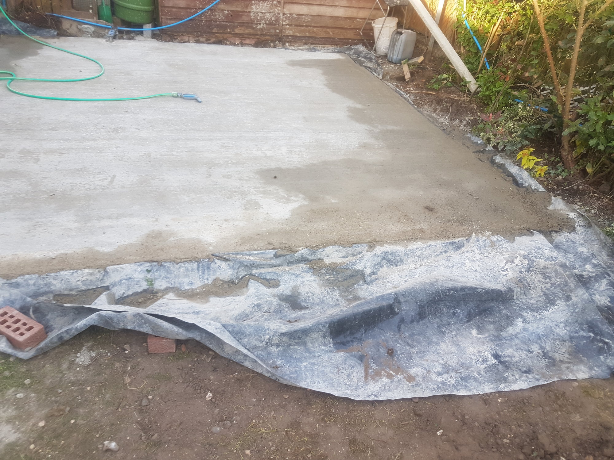

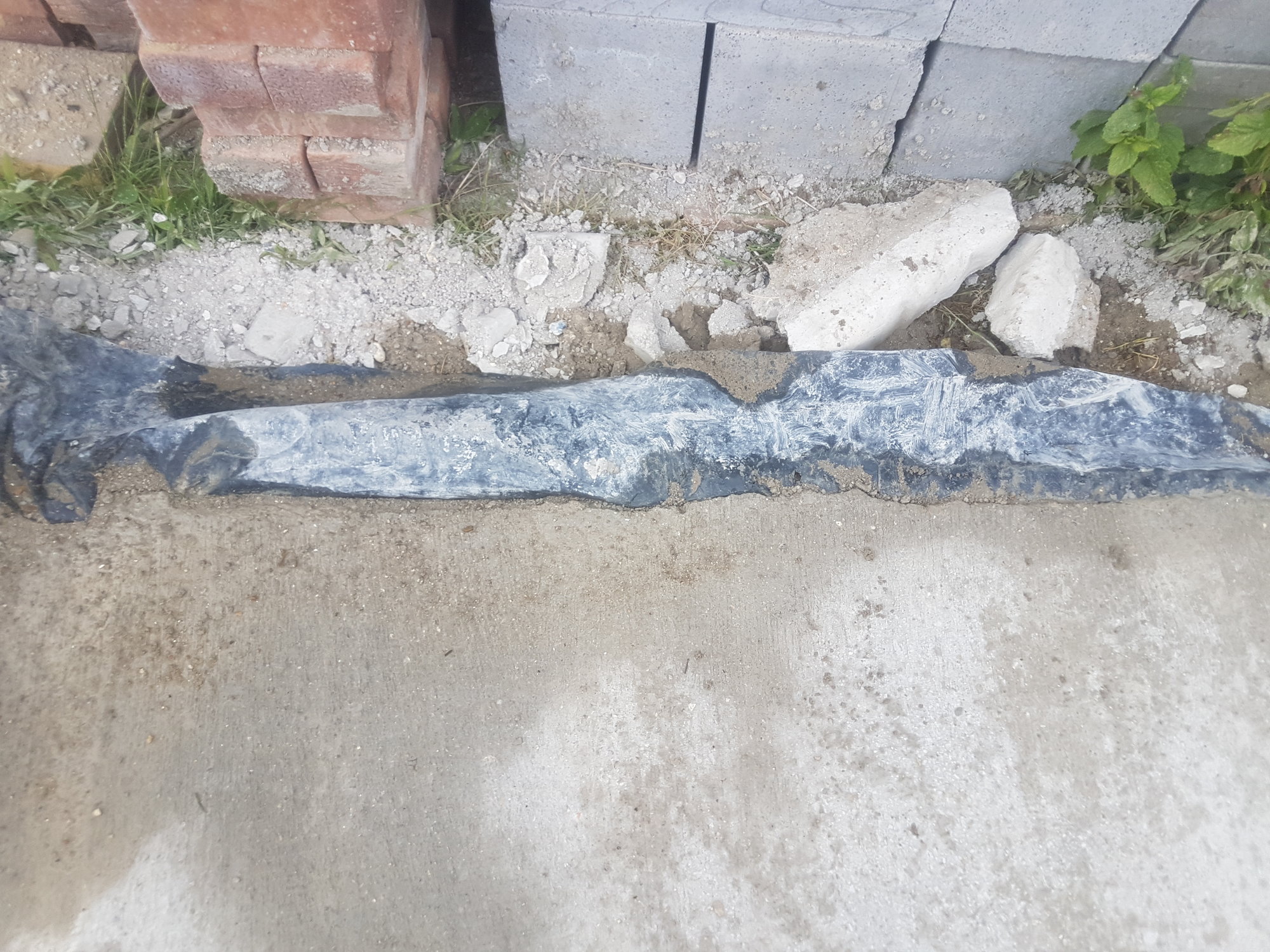

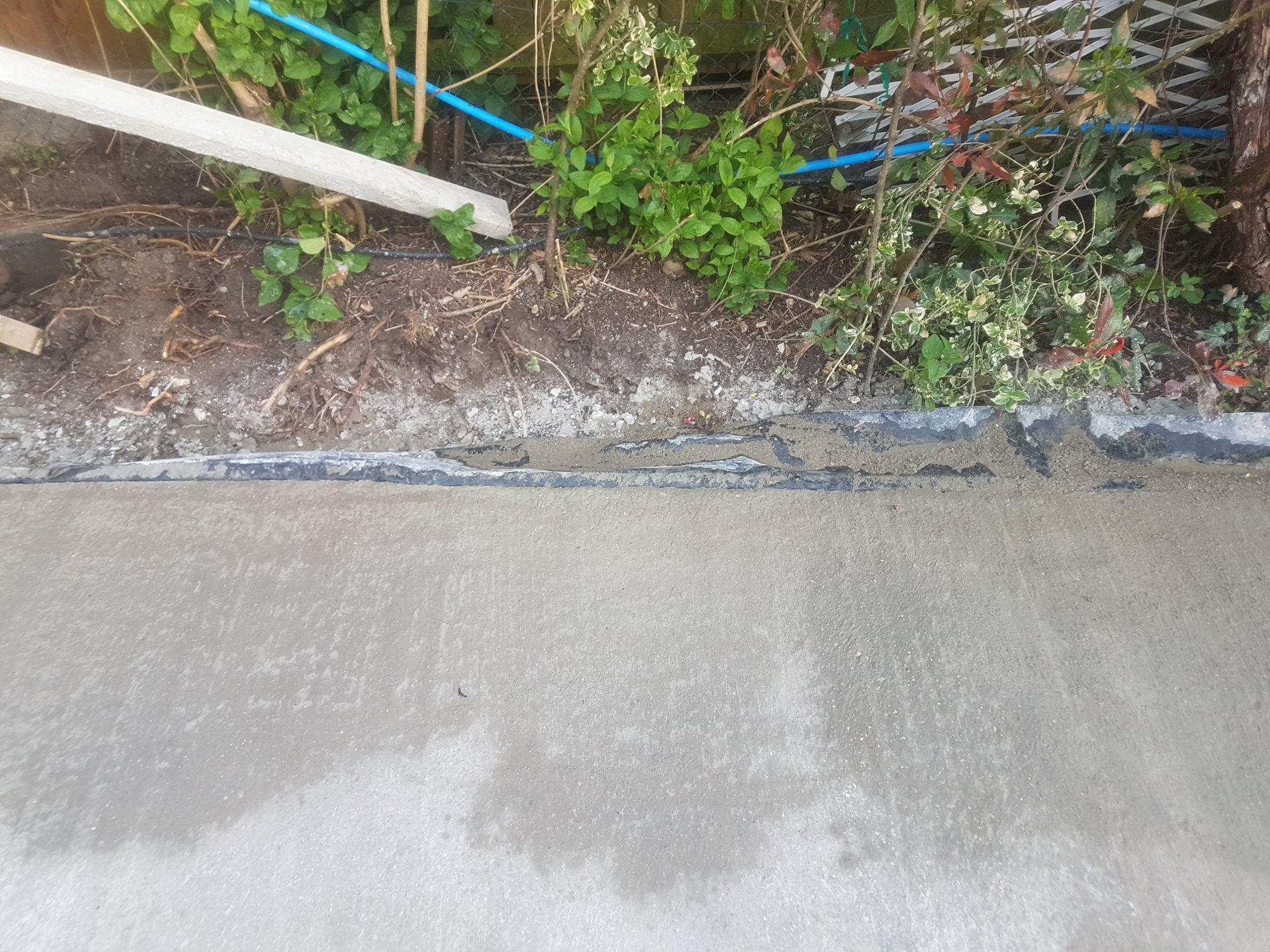

Pics?Ok now the slab is curing what do i do with the DPM that is left over the edge? Just trim it or fold it up the frame when building?
Pics?
I’m not sure what you’re building the shed out of but if it was wood and you’re using DPM on the walls I’d leave it long and overlap the wall dpm so that no water goes onto the wood. I did similar on my shed.
Sounds very similar to mine, yes don’t cut that off. Tuck it behind the wall DPM. Saves water ingress from the bottom. Most damp issues seem to stem from the bottom of any wooden structures. At least from what I’ve seen.I shall grab a pic or 2 now going out to spray it, yes timber frame 3 sides retaining wall one side about 80cm-1m high then timber on top.
I shall be using a membrane over the frame once it has been boarded with OSB.
Thanks long bit is to go up the retaining wall between the insulation and wall then it's getting filled with soil for a raised bed.Sounds very similar to mine, yes don’t cut that off. Tuck it behind the wall DPM. Saves water ingress from the bottom. Most damp issues seem to stem from the bottom of any wooden structures. At least from what I’ve seen.
Rubber floor tiles work a treat, lift wood just enough to keep it dry if there is any water ingress. I used stork boardfor the same thing on our chicken hut.I was thinking to lay the frame work timbers on some felt to protect them a bit too
