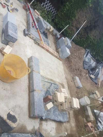

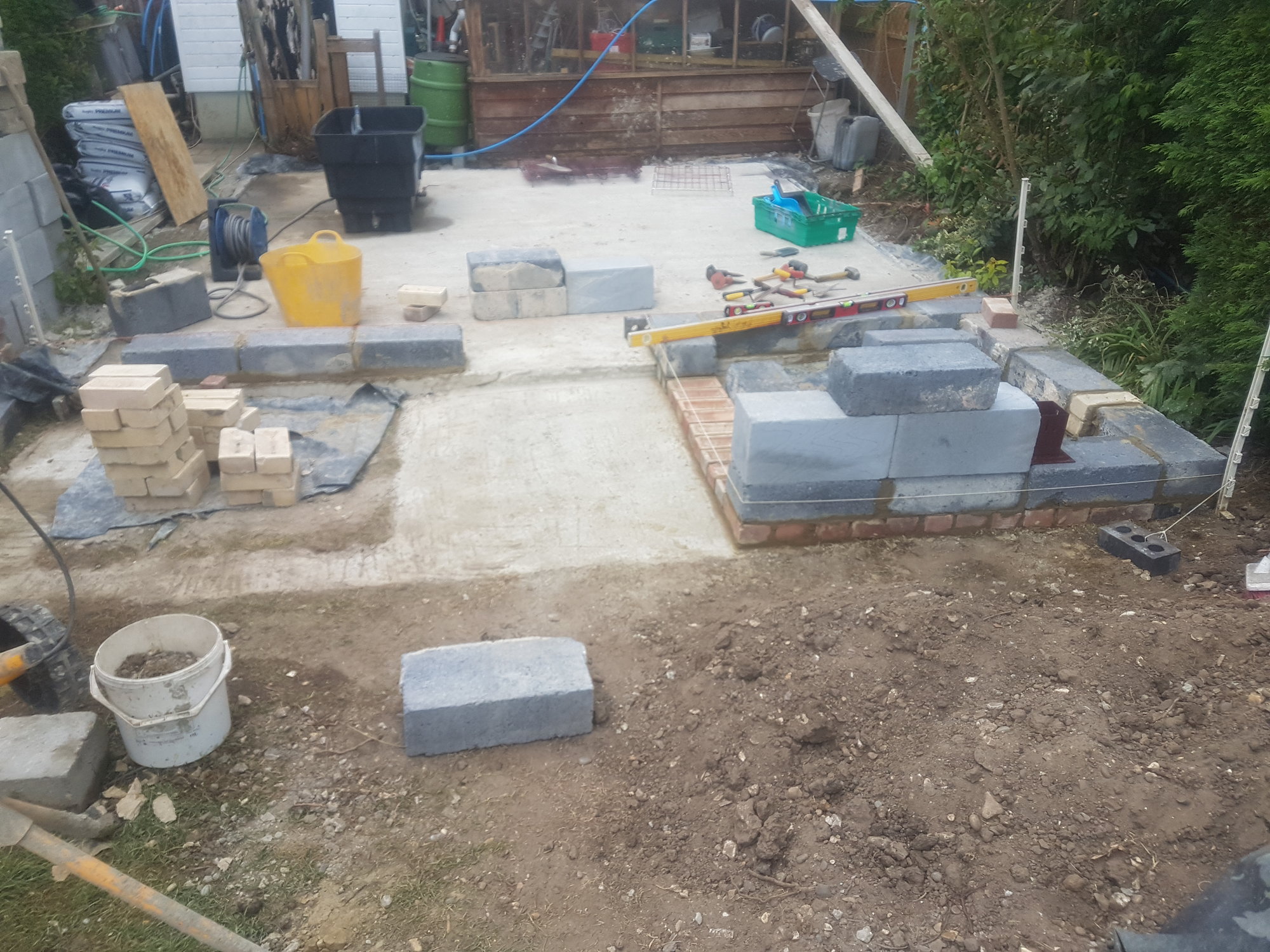

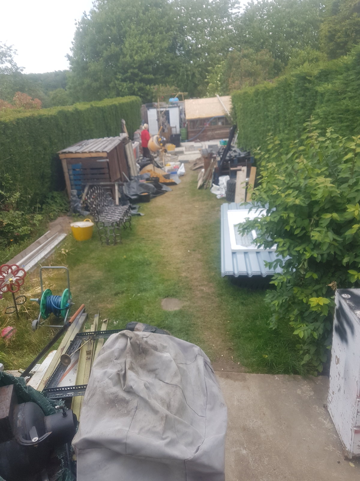

so roofing felt wrapped both sides of the frame

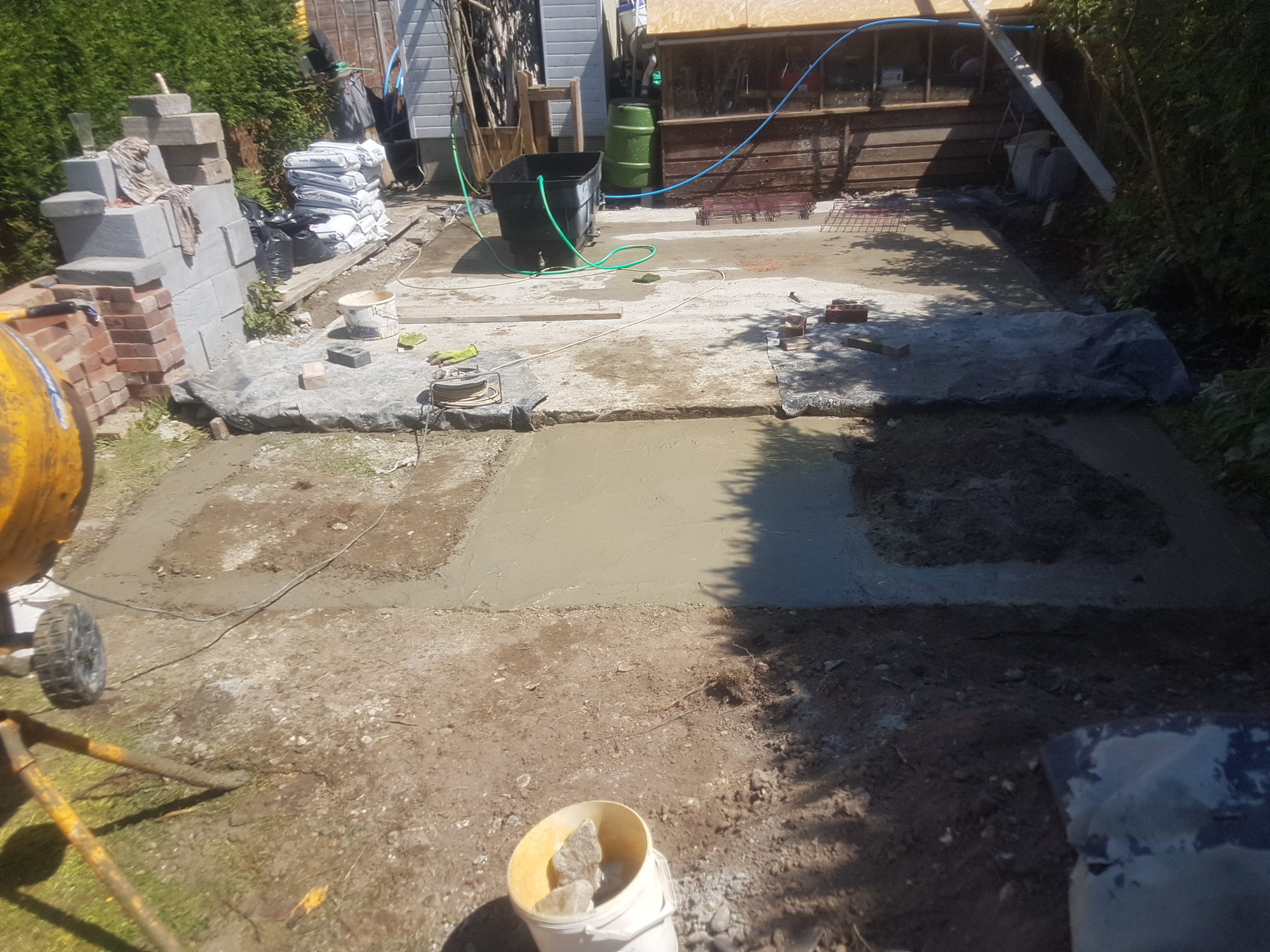

Ok now the slab is curing what do i do with the DPM that is left over the edge? Just trim it or fold it up the frame when building?
When you remove e shuttering, the wrapped up dpm is very vulnerable to damage anyway.I've never quite worked out how to sort that out. It needs holding up above soil/rain line, but looks a mess if you clipped under the shed walls. An UV will probably ruin it after a while. Or you could run a plank of wood around to cover it, but then the wood is down there with the rain and soil.
Guess what you do depens what you are doing with the ground levels around the slab. Personally speaking, I like to keep the ground back so the edges are exposed to air, but not always possible.

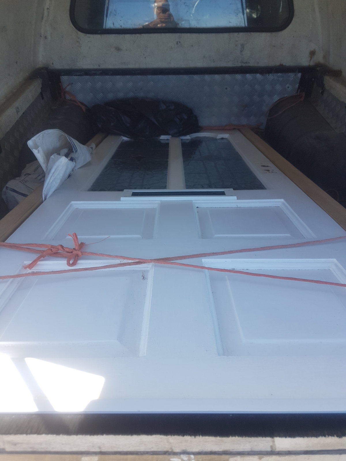

UPVC garage back door is on order too, but with a four week lead on it everything has to be moved down the narrow side passage to get in/out of the back yard.
The door will replace that window.

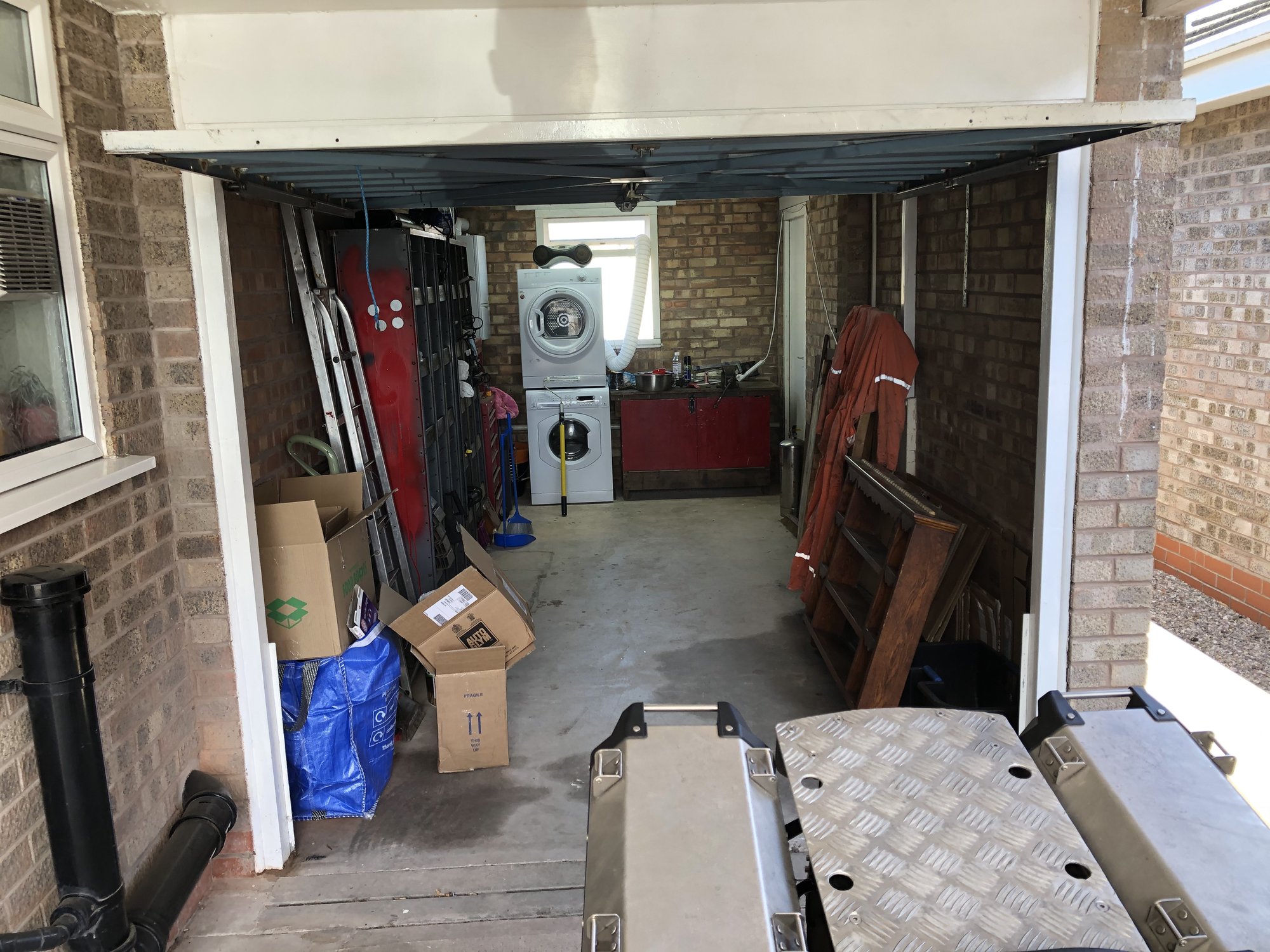

Is that white goods in your garage? How did you let that happen?!!!![]()

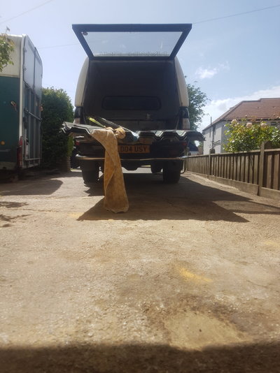

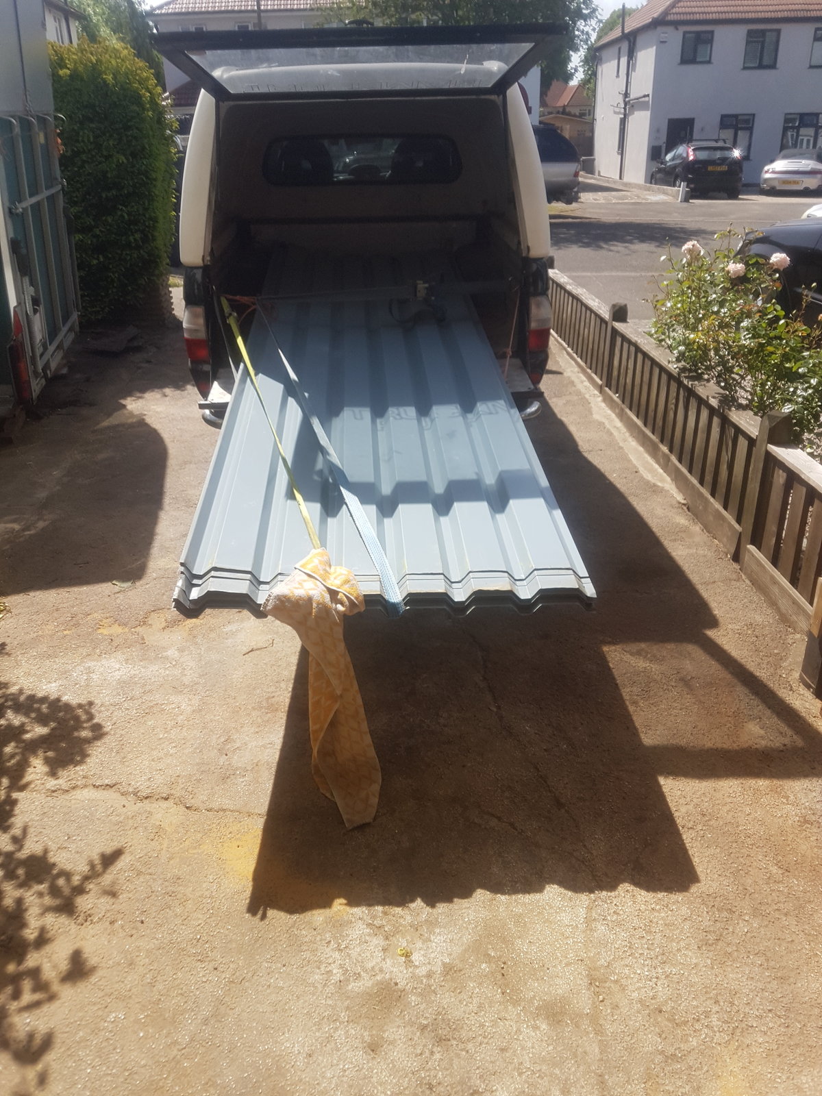

thanks mate yes i just watched a video on the subject. its upside down for sure!Google will get you fitting guides etc , the sheets are fixed in the valley , lots of guys on here probably do it for a living ,the side you have facing up in the pic is the underside ,
Lots of info on the interweb,
