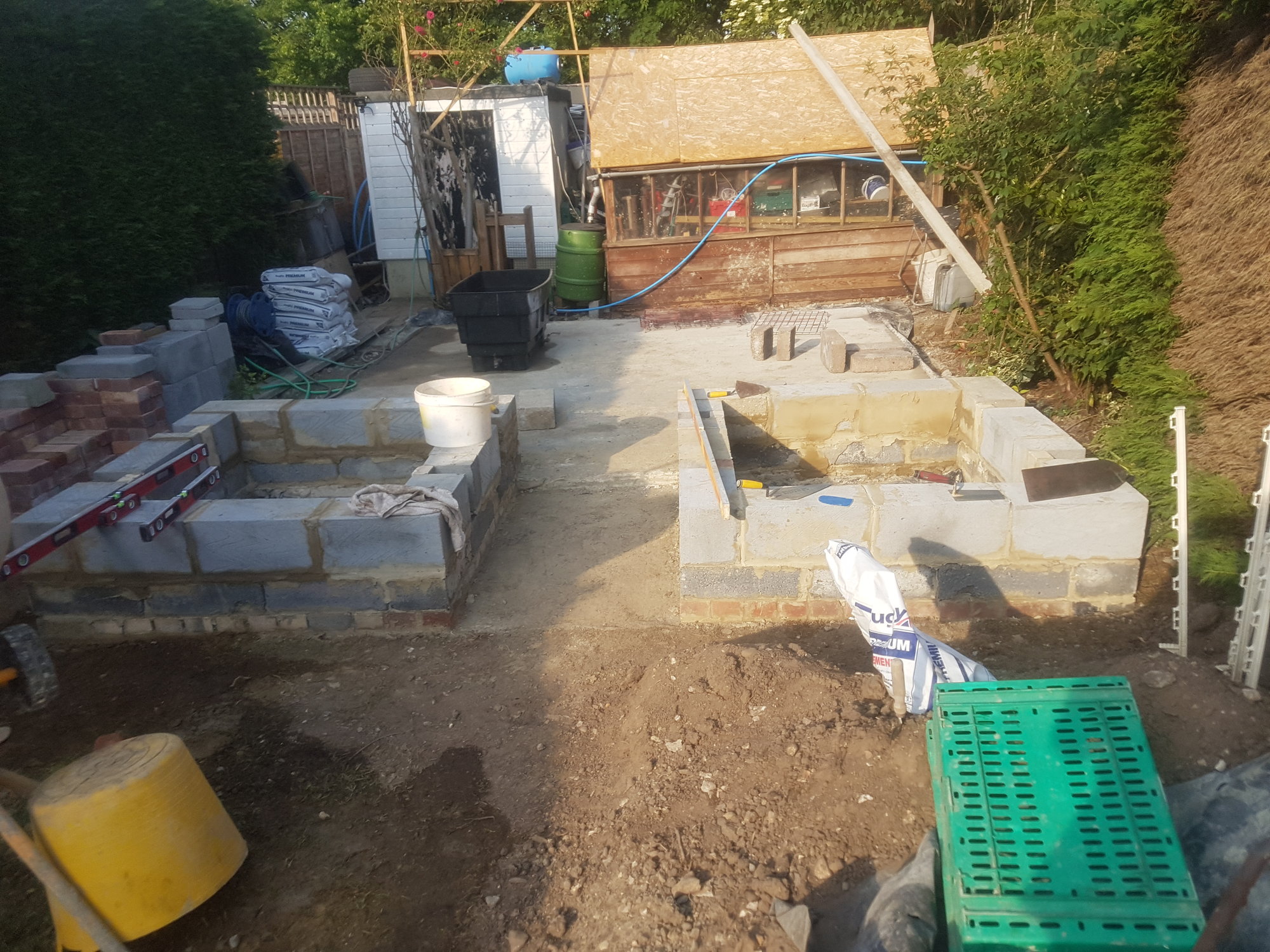

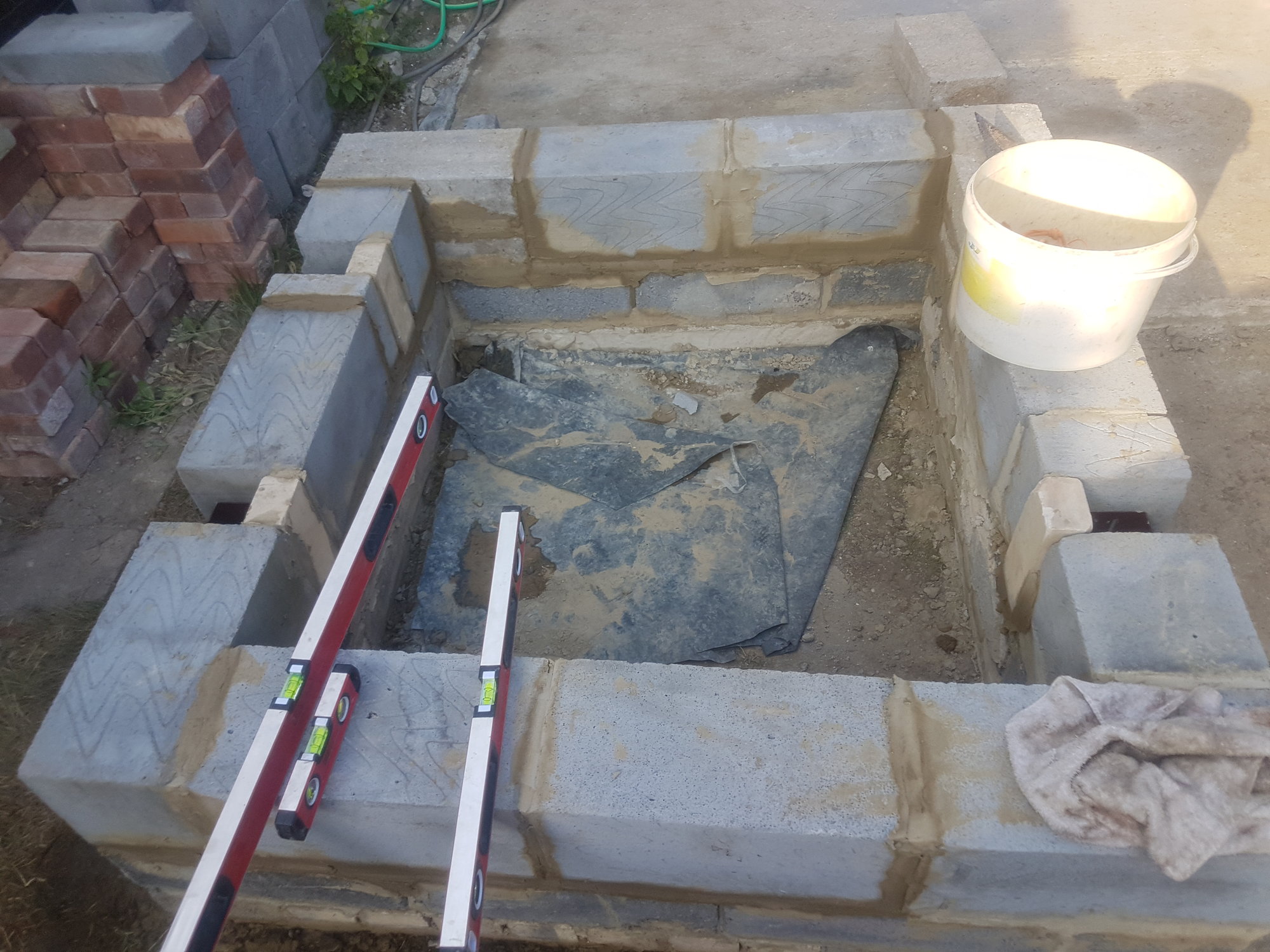

the thermalites aint stuck down yet, if It is a mistake to use them in this aplication I will re think.
Mate i hate being one of the "you cant do it that way" brigadethe thermalites aint stuck down yet, if It is a mistake to use them in this aplication I will re think.
its a proper mish mash mate, the lower level is engeneering bricks then solids the top course will be thermilities. They were all free thats why, if I was buying them solids all the way! they will be ok wont they?
i respect everyones input, I have no experience in building one of these yet! I dont want to be re doing itMate i hate being one of the "you cant do it that way" brigadejust use what you have to hand as life is too short..
well save the light blocks for another project and find some concrete solidsi respect everyones input, I have no experience in building one of these yet! I dont want to be re doing it
Really are they that bad! what are they good for then? apart from getting a nice edge on plastering trowleswell save the light blocks for another project and find some concrete solids![]()

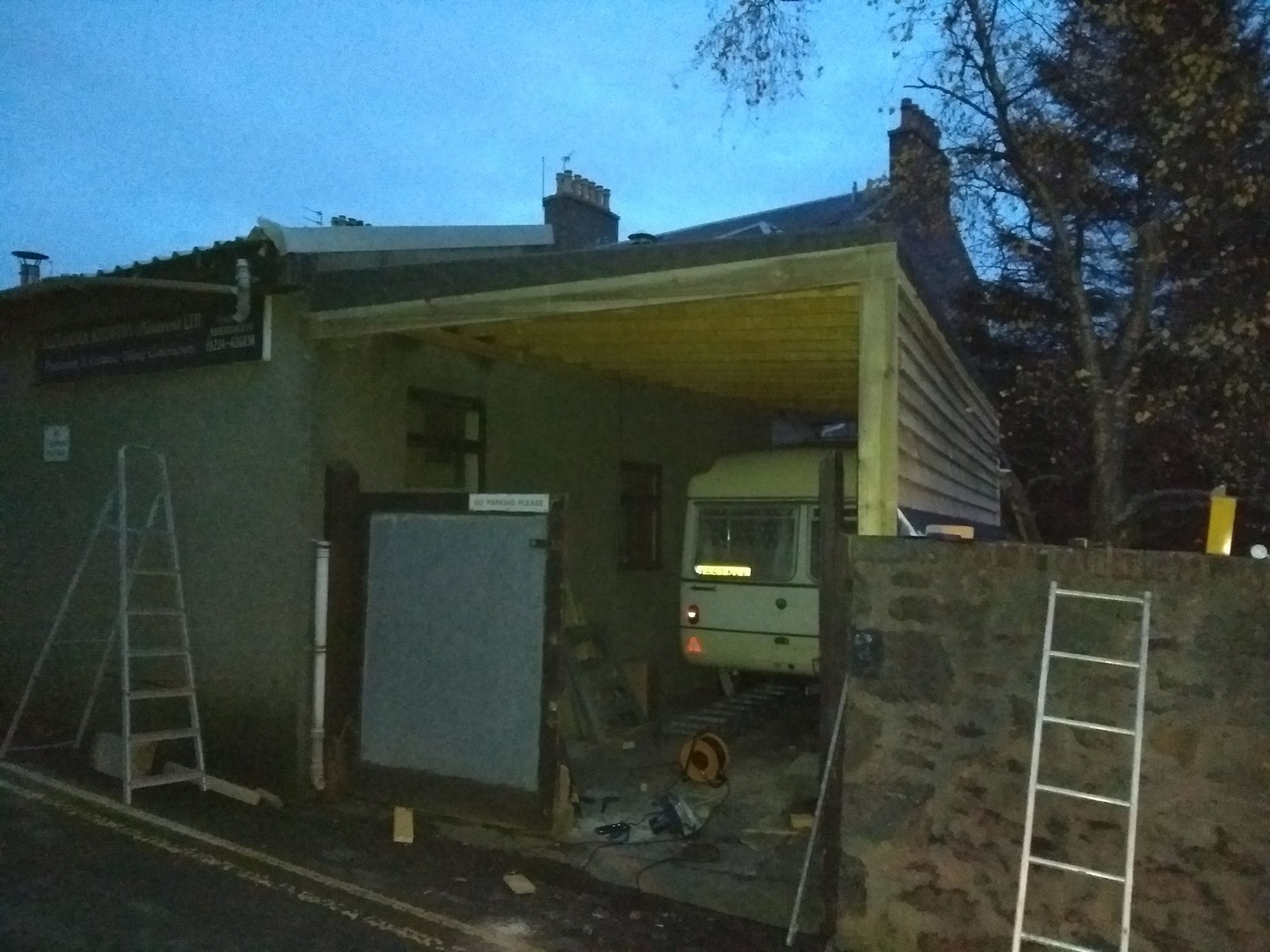

just making a list of the timber I need.

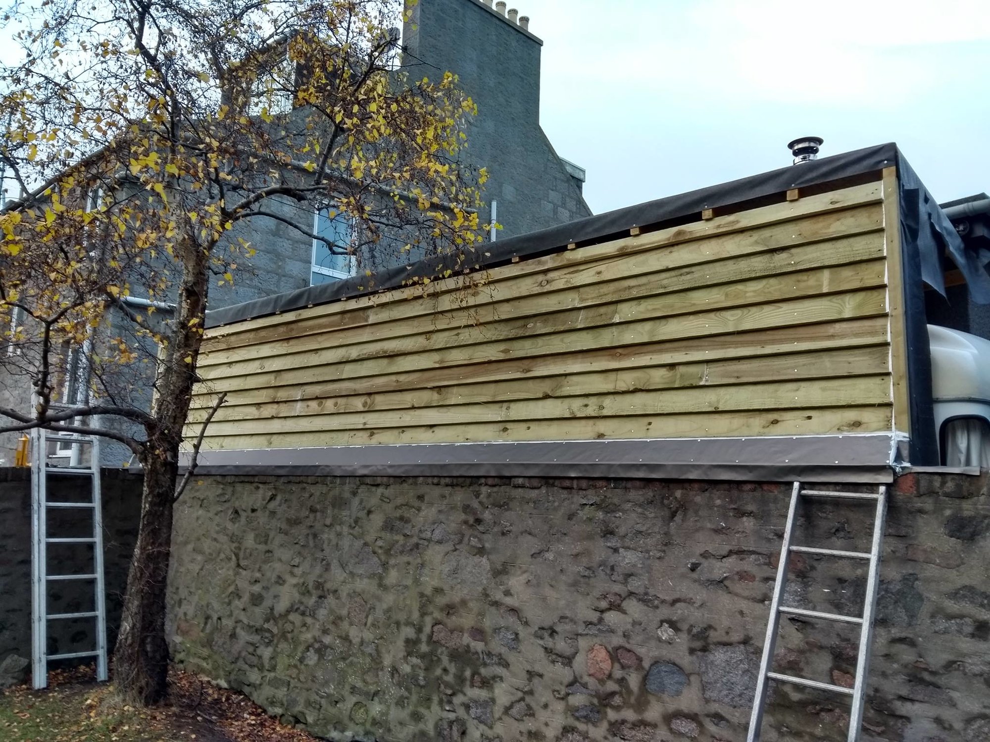

Is it good practice to use osb on the frame on the outside then membrane then lathes/battons to fix the ship lap to
do I not need a air gap betwwen the shiplap and the breather membrane?Don’t need batons on the outside.
Are you just lapping on square timber, if so there will be a gap naturally. You can add the batons if you like, no harm but shouldn’t be required.
another question OSB or Ply for the interior and exterior? walls and roof
for the price difference might as well go 18mm i know it will be heavier especially on the roofOSB3 preferably.
