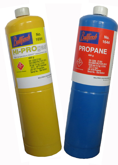

@Hopefuldave is LPG cheaper than their fuel?
a few of mine ive fit a shrader valve in the screw in safety solder plug and fill from there saves taking the torch of all the timeI refil primus 2012 2kg cylinders, Ive never managed to get one of them more than half full. I weigh them as I fill them.
the bottle u fill off has to be turned upside down and the filled bottle uprite underneath it so presumably u have large propane bottles to fill off
yup stringing a 47kg bottle up is no funI have access to plenty of Propane bottles, some of them a bit too big to be putting upside down :-)
only if the bottle is one that they use in campervans designed to be filled by joe public not the ordinary shell or calor bottlesAre there refillable LPG bottles that petrol station is happy with being refilled?
You can get the refillable bottles for camper conversions where the fill up point is mounted to the body of the vehicleAre there refillable LPG bottles that petrol station is happy with being refilled?
That's because they aren't produced on mass scale + they need to be safety approved I'm sure!Had a search they are not cheap, 150 quid supplied empty.
Only if you want to die. Cars and fork truck tanks take the feed from the bottom of the tank, feeds liquid as opposed to ordinary bottles that takes gas from the top. Saw a picture of a van conversion that had burned out as the cooker turned into a flame thrower when he lit it.I bought a 80L(?) Lpg car tank from the scrappy for a tenner.
Wouldn't be that difficult to mount it in a trailer with the correct filler connector, then just demount?
