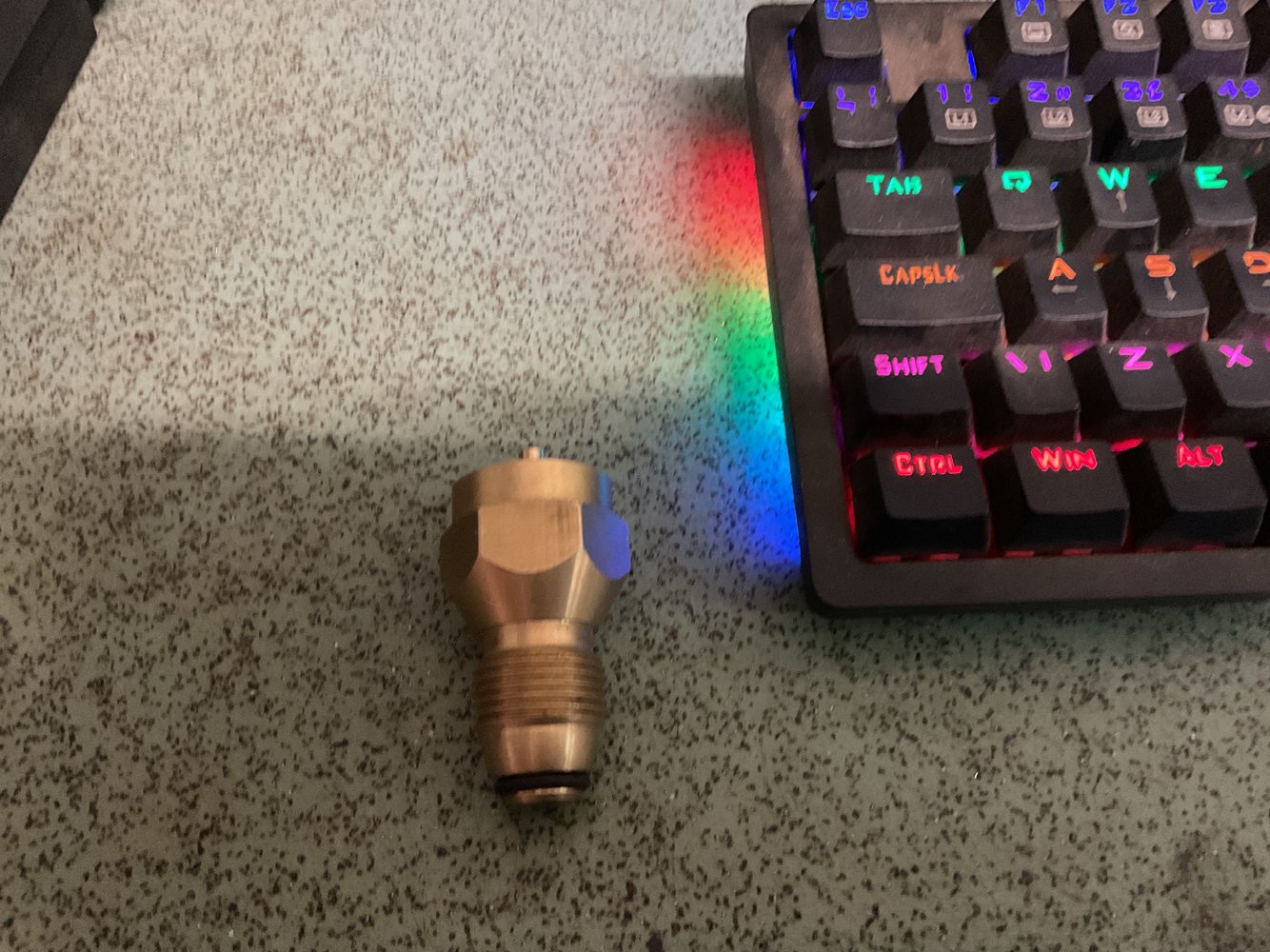

????well like the post above saying its safe to do outside, part of the filling which relates to safety has been missed, and you cant assume that people will know the important but that you've missed out. Also it has been advised on this forum that you can use schrader valves (car tyre valves) to bypass valves on bottles, but the vast majority of them are not rated for the pressures that propane can exert.

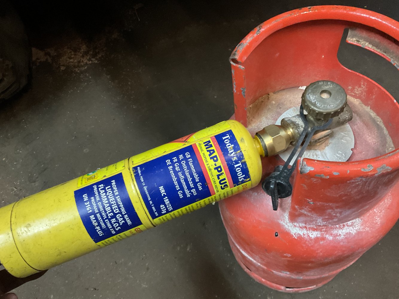

I refill the common 1 lb bottles from my 20 lb bottle with no problems nor modifications.
Yes, but he mentioned modding the bottle, my way (and I think your way) does not mod the bottle.Fred, @optima21 is merely pointing out that from the forums point of view it cant be condoned in case something goes wrong. Make something idiot proof and they evolve into better idiots

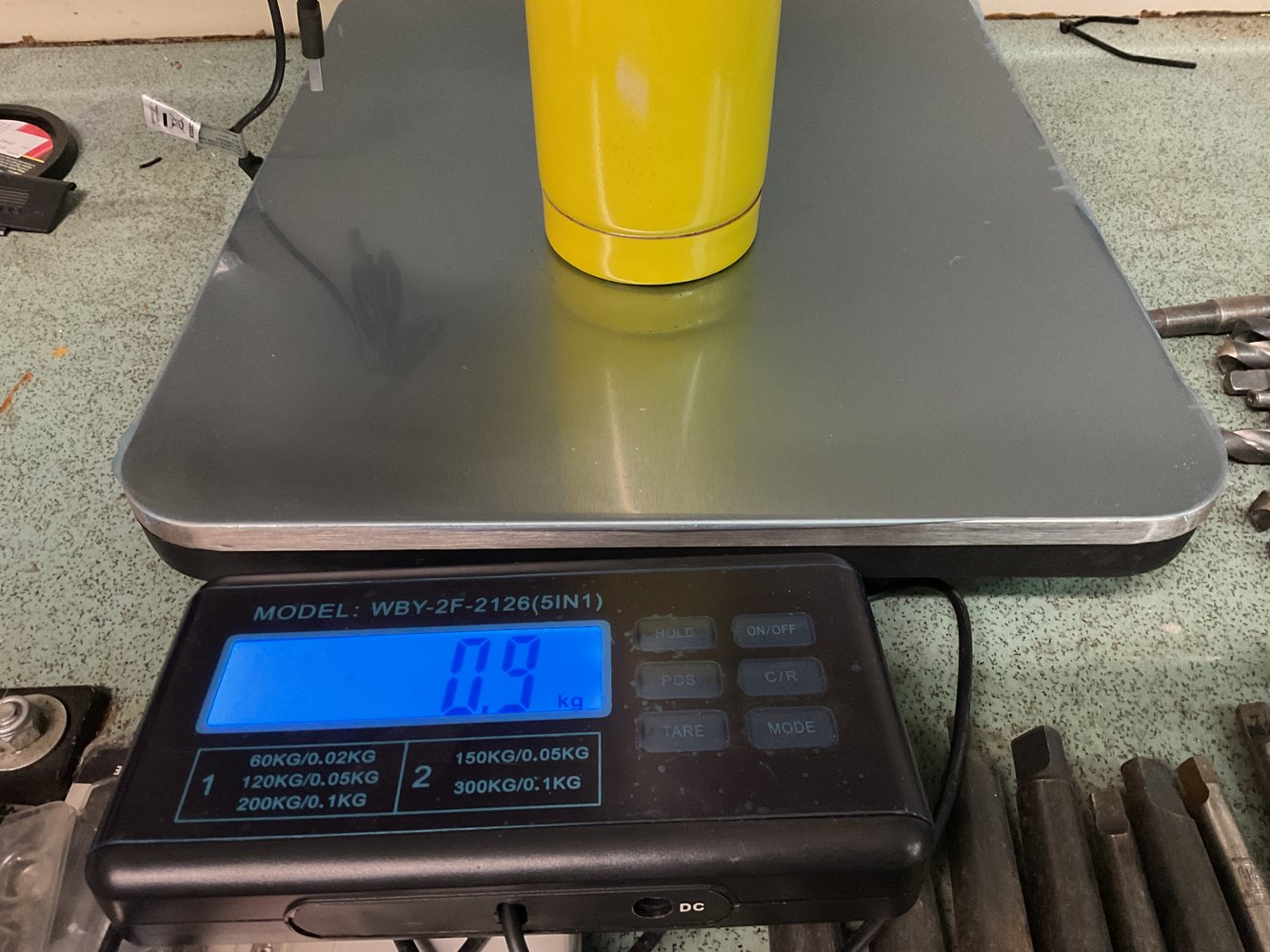

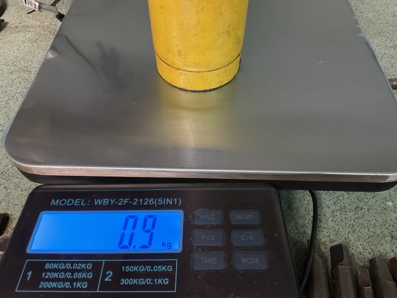

We need a proper how-to guide. Someone mentioned its important to weigh the bottles and only fill 80%?
On the ones I refill, there is a dip tube set at 80%We need a proper how-to guide. Someone mentioned its important to weigh the bottles and only fill 80%?
that wont happen as showing something like that will cause the forum issuesWe need a proper how-to guide. Someone mentioned its important to weigh the bottles and only fill 80%?
That would be the 80% rule then.Only people who can explain what ullage is should be filling bottles.
