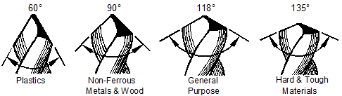

If the stud shears flush, I would drill it and to keep the drill central, if logistics allow, would replace the head then make and temper a steel bush that would slide in the stud hole and have a clearance hole for the pilot drill.
