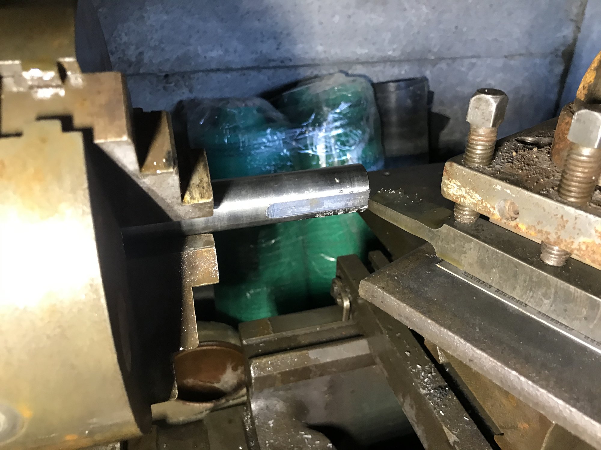

I saw some one do similar with a burr in a dremel mounted on the tool post. What ever works on the day.It works, I've done it loads of times. I put the spindle lock on and block a jaw up off the bed with a piece of wood to stop it moving then grind a tool and line it up by bringing it up to the end of the bar and measuring down from the top of the bar half a diameter less half the width of the tool. Use small cuts and a bit of lube.

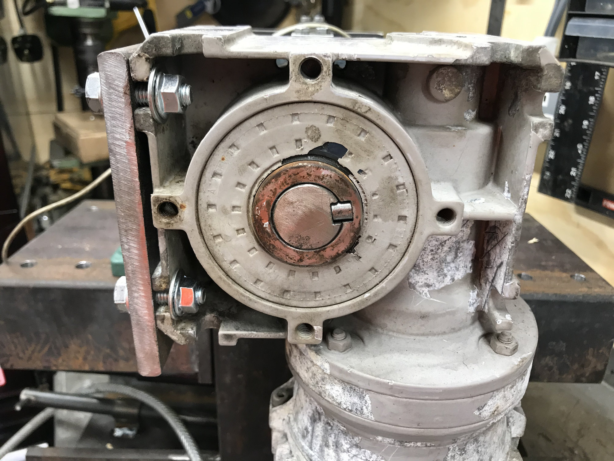

Well, I think this is one of the few projects that I have actually finished properly. Nearly anyway. Small bit left to do.It's called Research and Development. Don't paint anything so it stays in a perpetual state of R&D.
I should’ve to be honest but I couldn’t see me getting that all lined up straight, thinking back right now I think I could’ve but it’s a bit late not. What I will probably do is clean the keyway up when I get a mill or something at some point.Drill a hole at the 'blind' end of the keyway, and using your (unpowered) lathe as a shaper, plane up to the hole with a sideways parting tool. Done it loads of times and it works.

Yes it worked and I have a blister on my hand. Silver steel is pretty sturdy. I think I was winding it back and forth for an hour or more. It was slow going that’ll teach me for not having the tools for the job.You cutting a key way wiping a tool up and down on a manual lathe? Fair play.

What depth are your strokes.
Does it really work?
