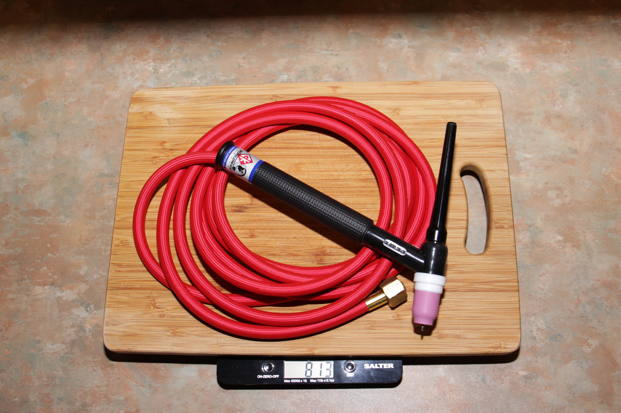

@Gazz292 you've saved so much on the welder so why not just get the CK superflex cable and 17 torch (good for 150 amps)?
https://www.rapidwelding.com/dynamic/DisplayItem.aspx?c=CK-CK1712RSFRG&zl=3
https://www.rapidwelding.com/dynamic/DisplayItem.aspx?c=D3595-1-4
I assume it's a 3/8 bsp connection on the front of the Sherman 206p? If that link above becomes painful to keep unscrewing and redoing you can cut the gas hose in half and add a rectus 21 so it's just an inch or two of hose dangling out of the front of the machine.
I don't have the 206p - I have the Sherman 210 and that's got a rectus 21 (or similar) mounted to the front already.

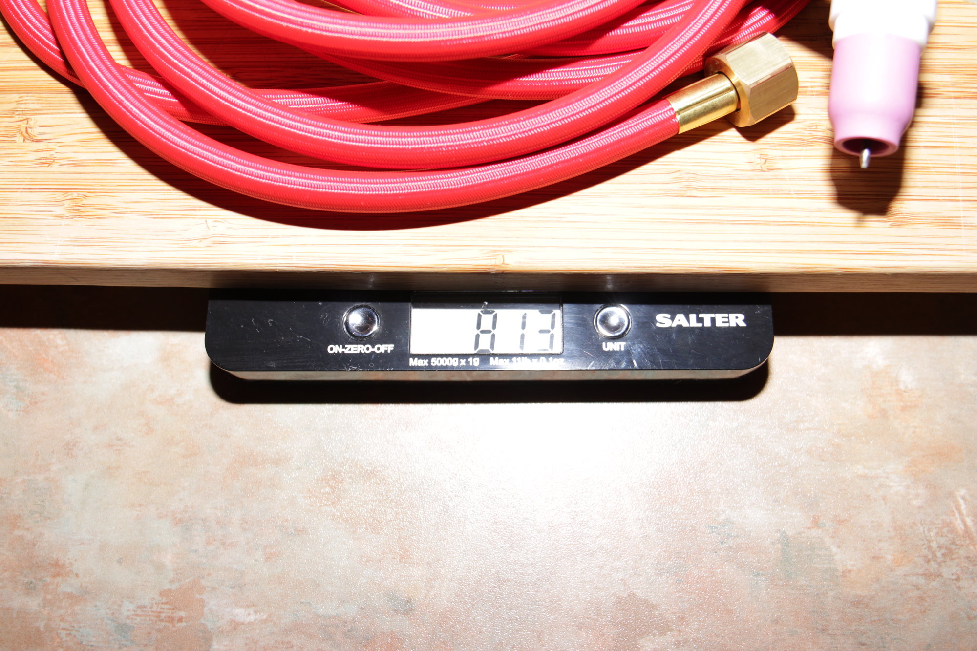

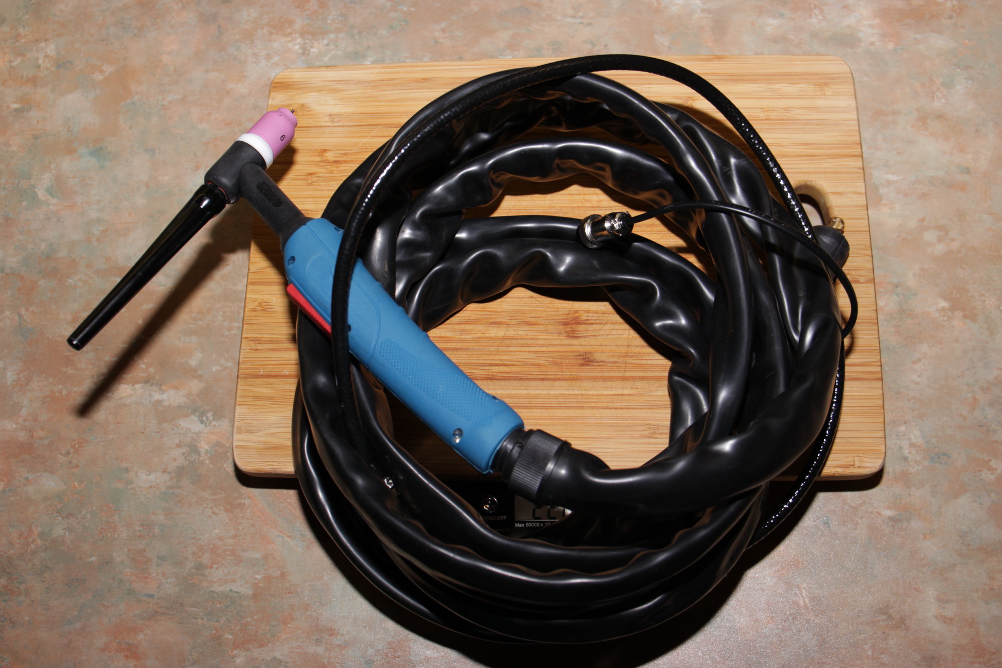

Just got a superflex. So nice...
