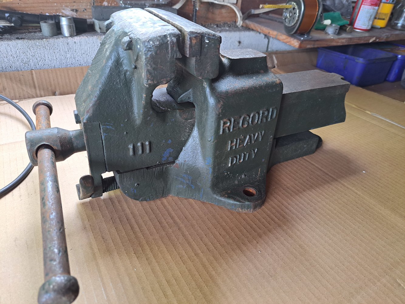

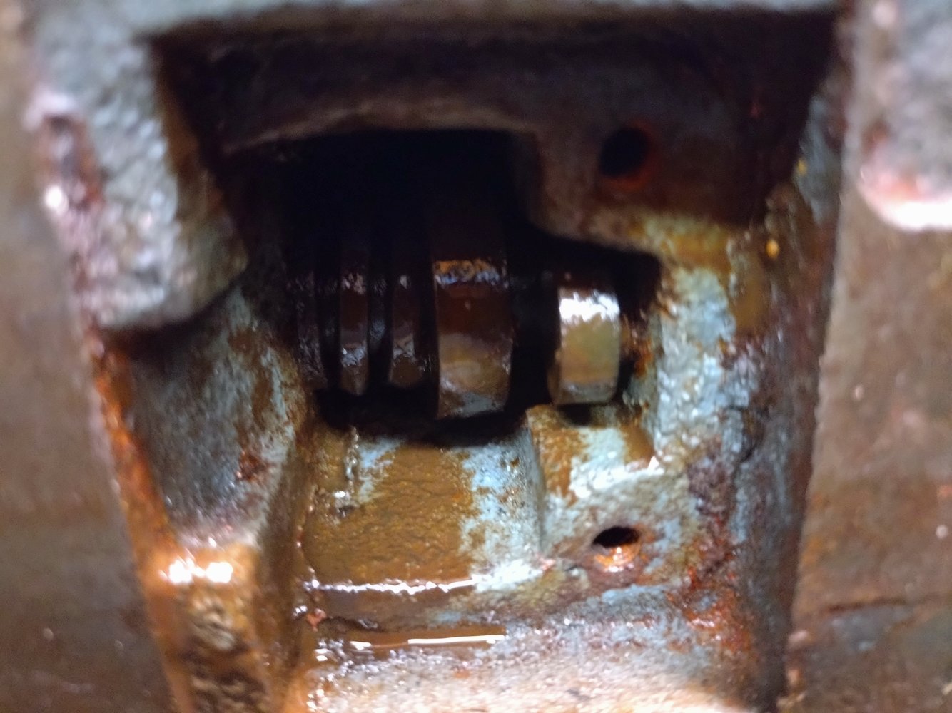

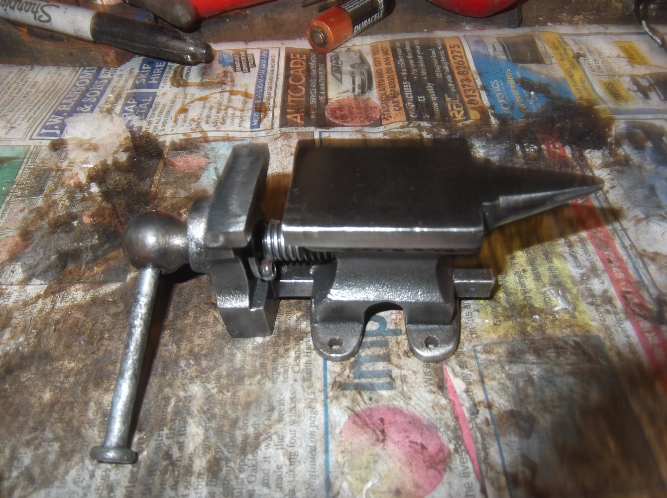

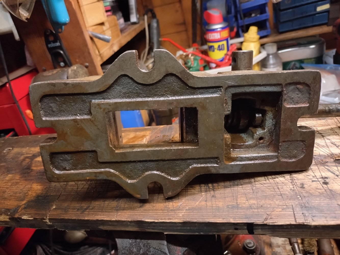

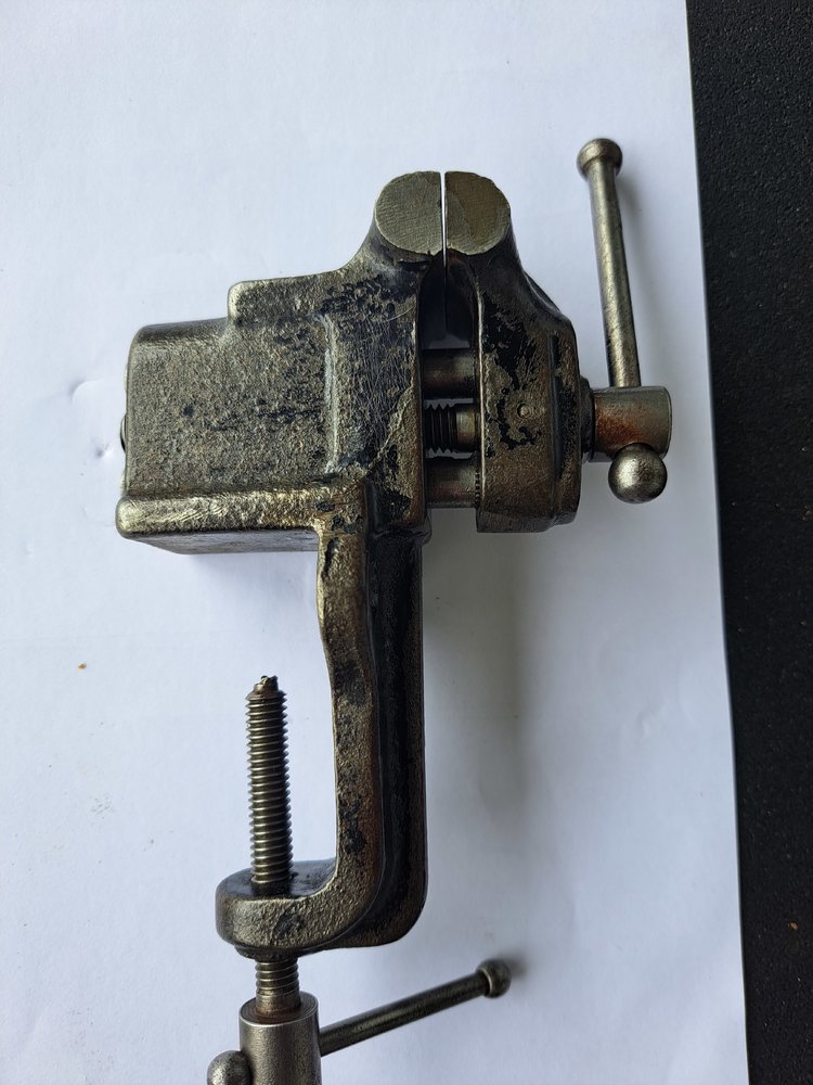

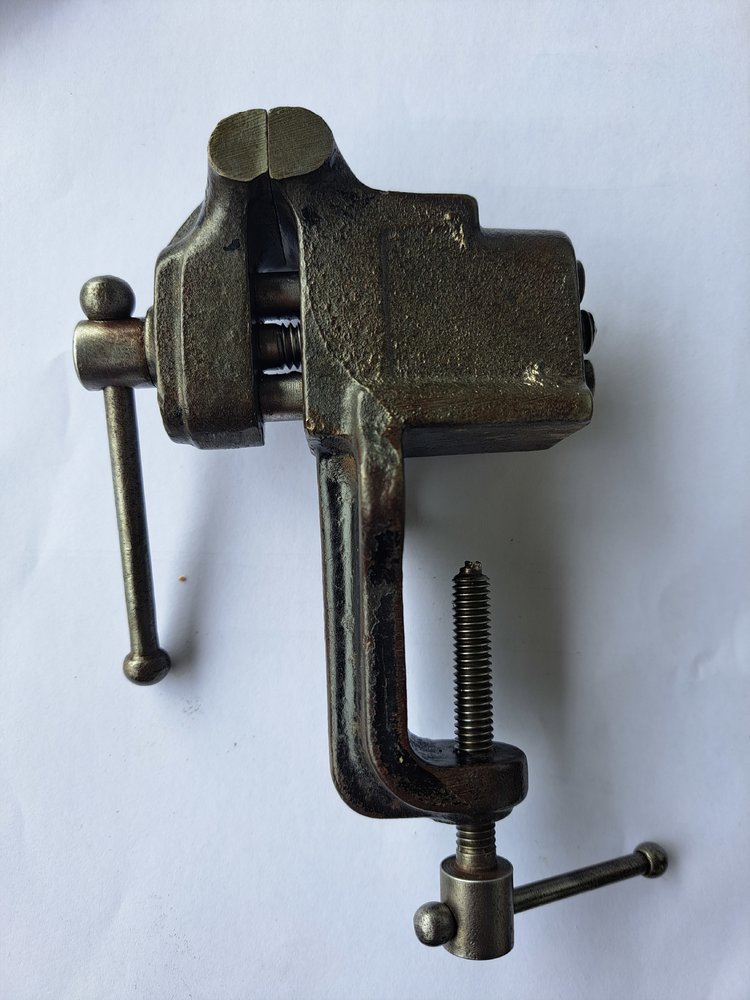

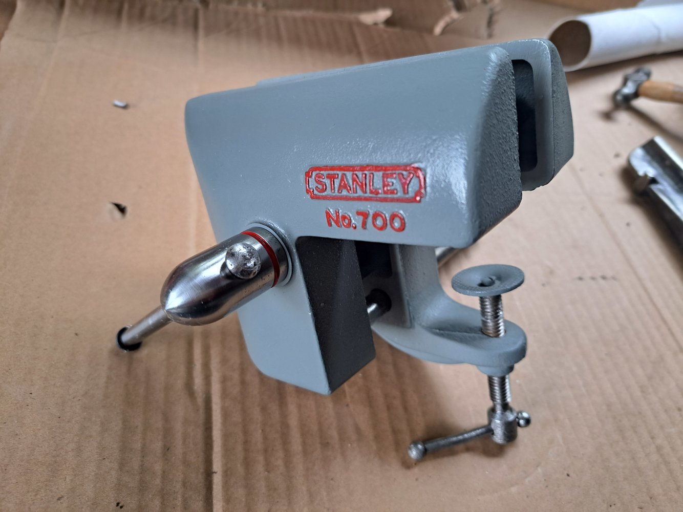

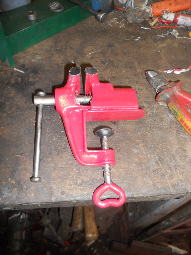

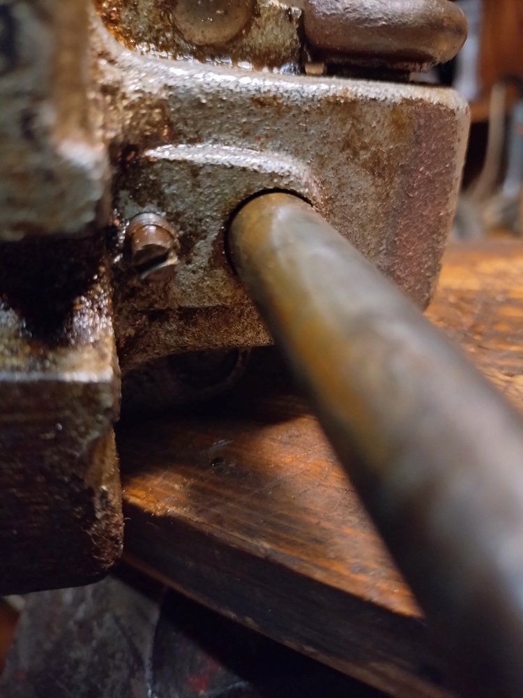

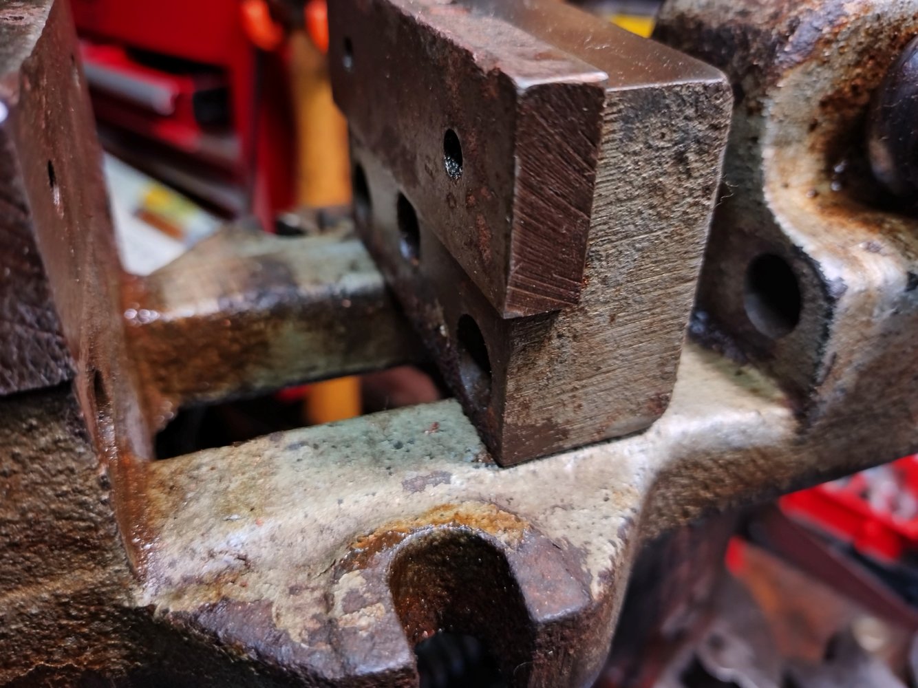

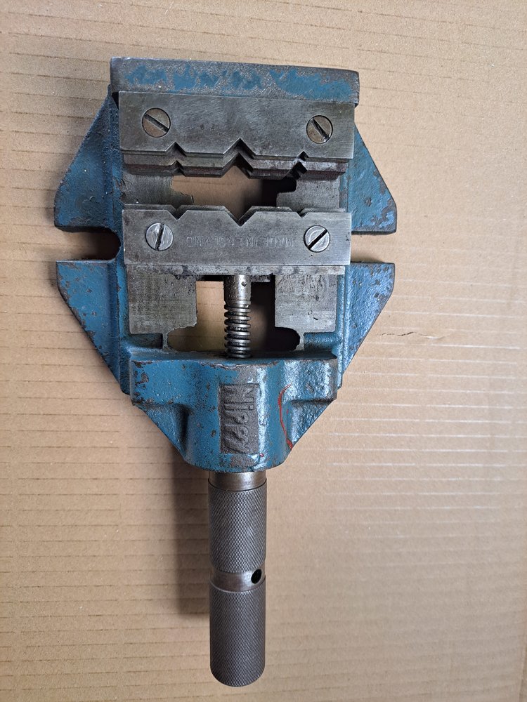

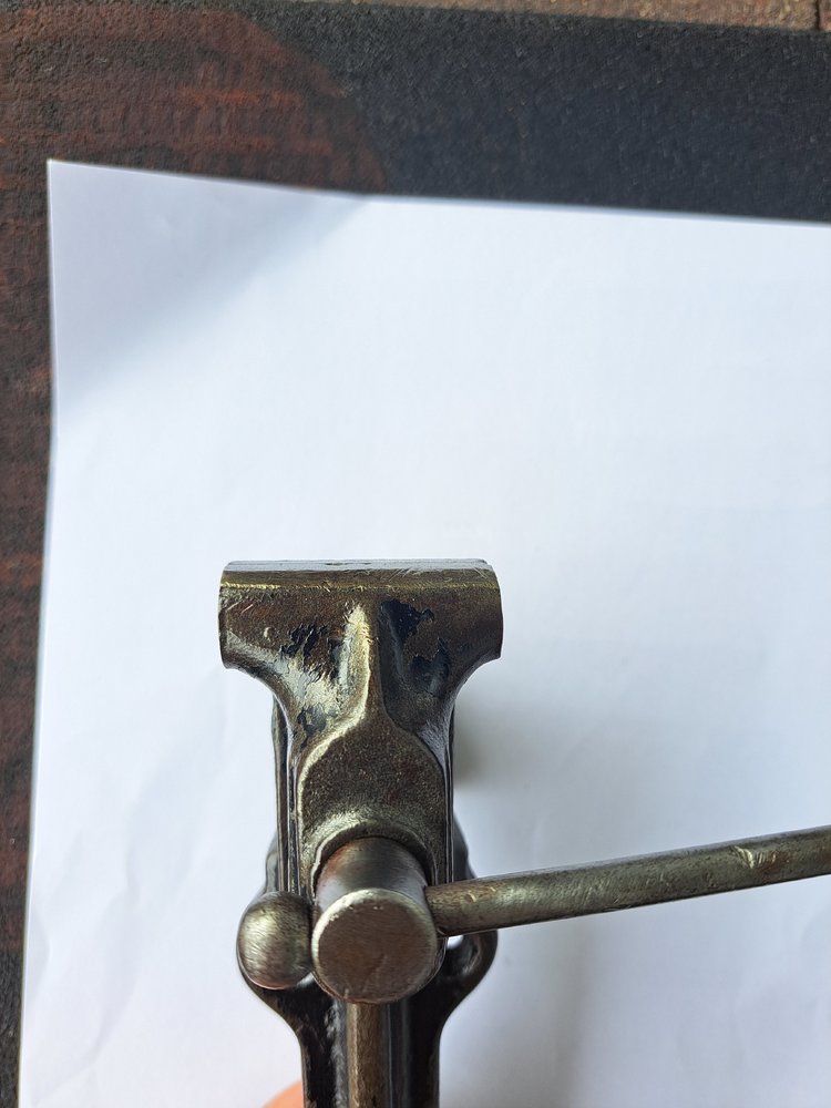

The little drill vice I picked up on Sunday is proving to be a bit of a pig to dismantle, so I'm looking for some help. Removed a lot of rust and crud, got the locking mechanism working and its a bit cleaner than it was. The slides, which were held in place via a transition fit, have been removed, but that's as far as it's got. The vice won't open, but when persuaded to closes very easily. The lock seems to have something to do with a knurled fitting, picture 1 &2, which is adjusted via a grub screw beneath the spindle, picture 3. I'd like to know how to disassemble this and any ideas as to why the vice refuses to open will be helpful. The final picture shows the moving jaw and the spindle is attached the other side of the middle hole. Could this be threaded?
