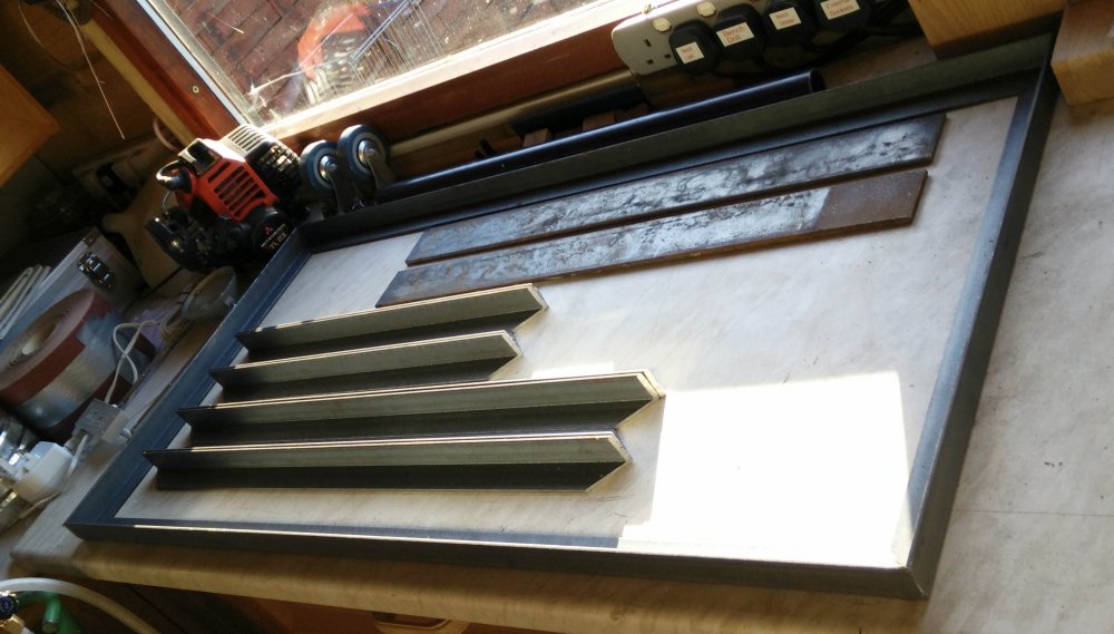

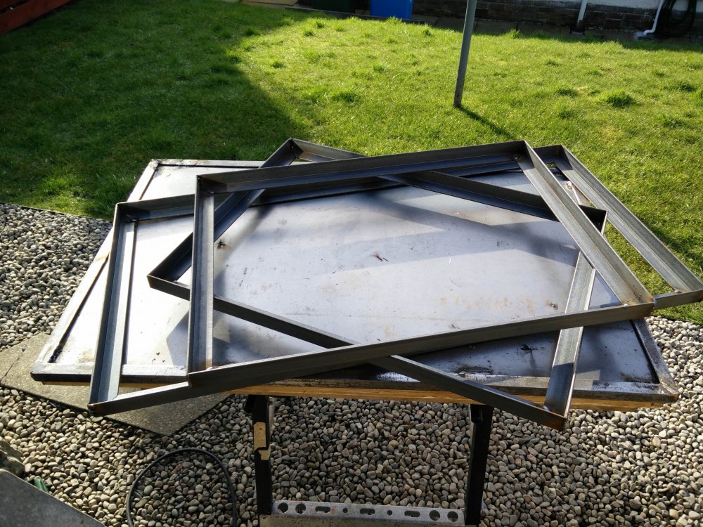

], cutting and mitring the angle iron for my welding trolley. Got enough done for the three shelves, castors cross brace/support and the handle.
] and I'm ashamed to say I've had the steel lying in the shed for ages
- this project has a gestation period longer than an African elephant......
but I'm reliant on doing it outside, so the weather will now dictate progress - don't be holding your collective breathes.......

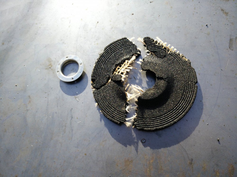

You weren't running it into anything were you or trying to cut with it.
How old was it? Grinding discs have a use by date.
Me too. I've only ever bust cutting discs and usually by cutting something then quickly removing the burr with it (lazy and not swapping to correct disc)I've not seen an 'out of date' disc fail - not to say it won't happen...
I've seen them fail in that manner if they're wet or if they've been dropped though.
Edit - and overtightened/with no shims too, nearly forgot that. -- I've only ever had cutting discs fail on me, and that was entirely my own fault for cutting incorrectly supported tube...

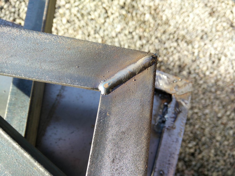

I know that's why it surprised me as they take some force to smash them. I believe you mate I'm just shocked as I've not seen one break like that before. I've had small chunks come off the outer diameter before making them run like a bag of **** but never properly smash up like that. Your lucky it didn't fling a bit out at you. Any way back to the trolley. It's a blinding job and the welding looks great.This was a grinding disc.
Nice looking job first one I have seen with a strimmer engine fitted to it though.
The engine was off a sprayer which I had to junk after the big tank sprang a leak.
