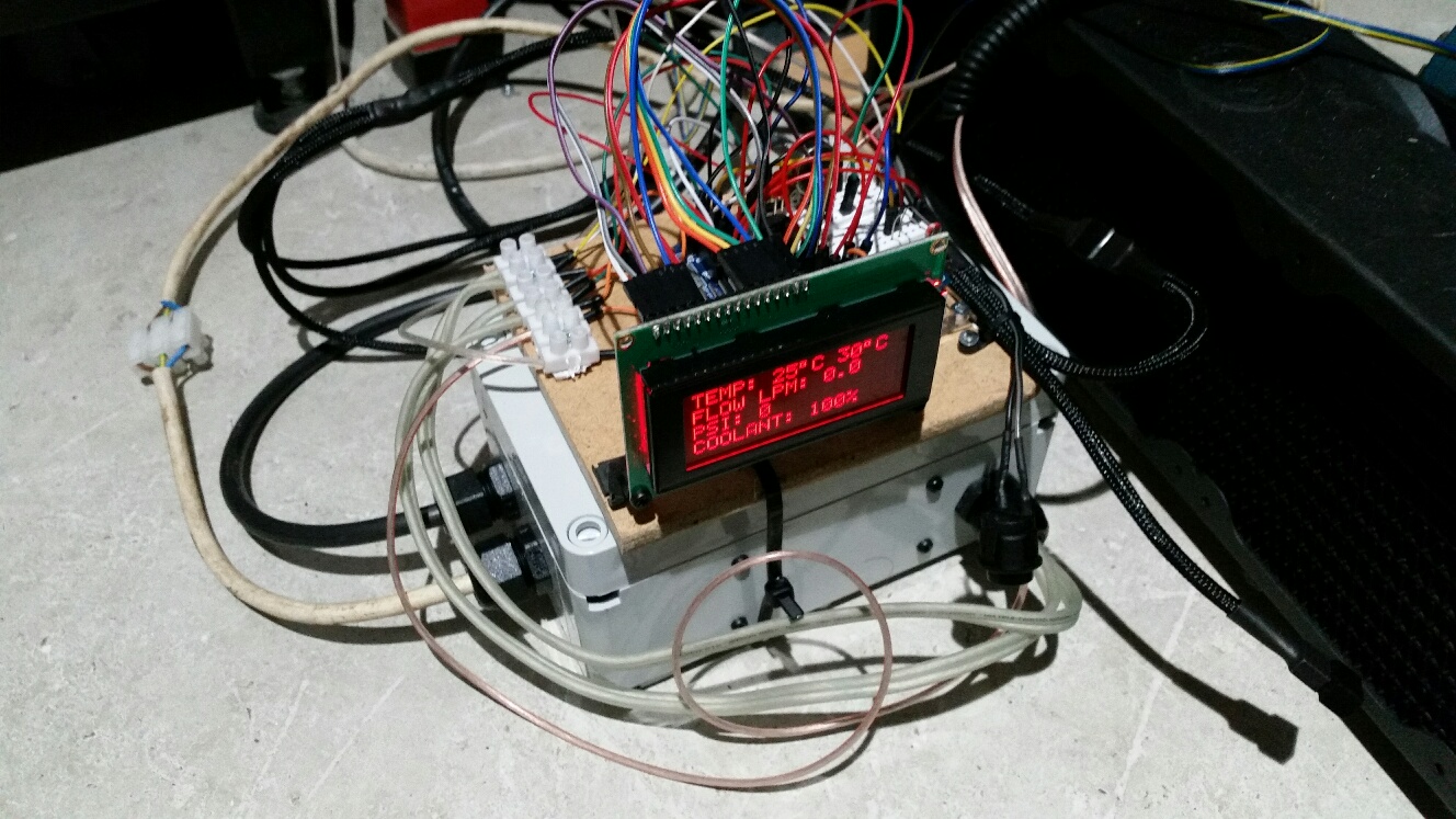

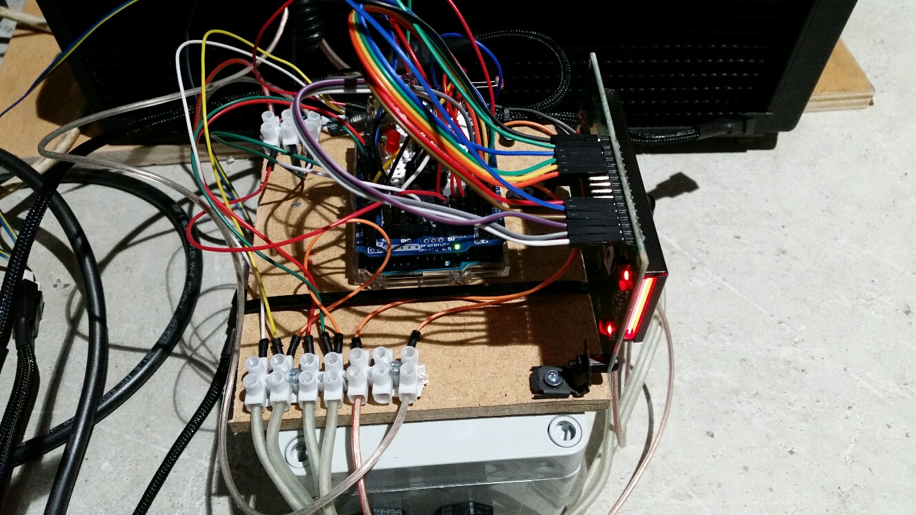

If i wasnt so far away i would send you my torch to compare as mine is a parweld. Is 50/60 psi ok whats the max these torches can take.Maybe you have bigger bore pipes on the torch than mine or maybe there is less restriction in the torch head, certainly seems to be almost double the flow for the same pressure.
Read articles that say 0.9L/min is the optimum, others seem to converge on 1.2L/min, Parweld never got back to me (second email they have ignored ) so not sure what they would have said.
