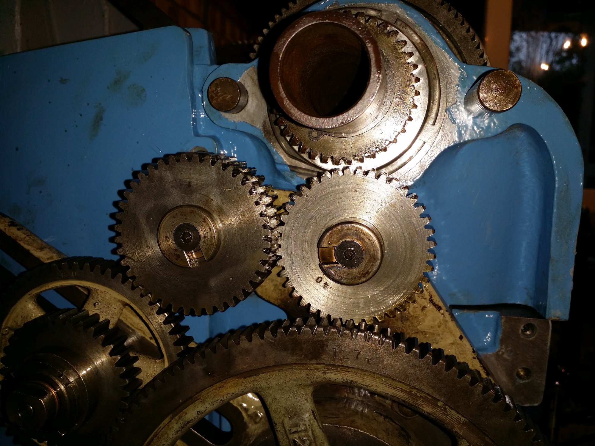

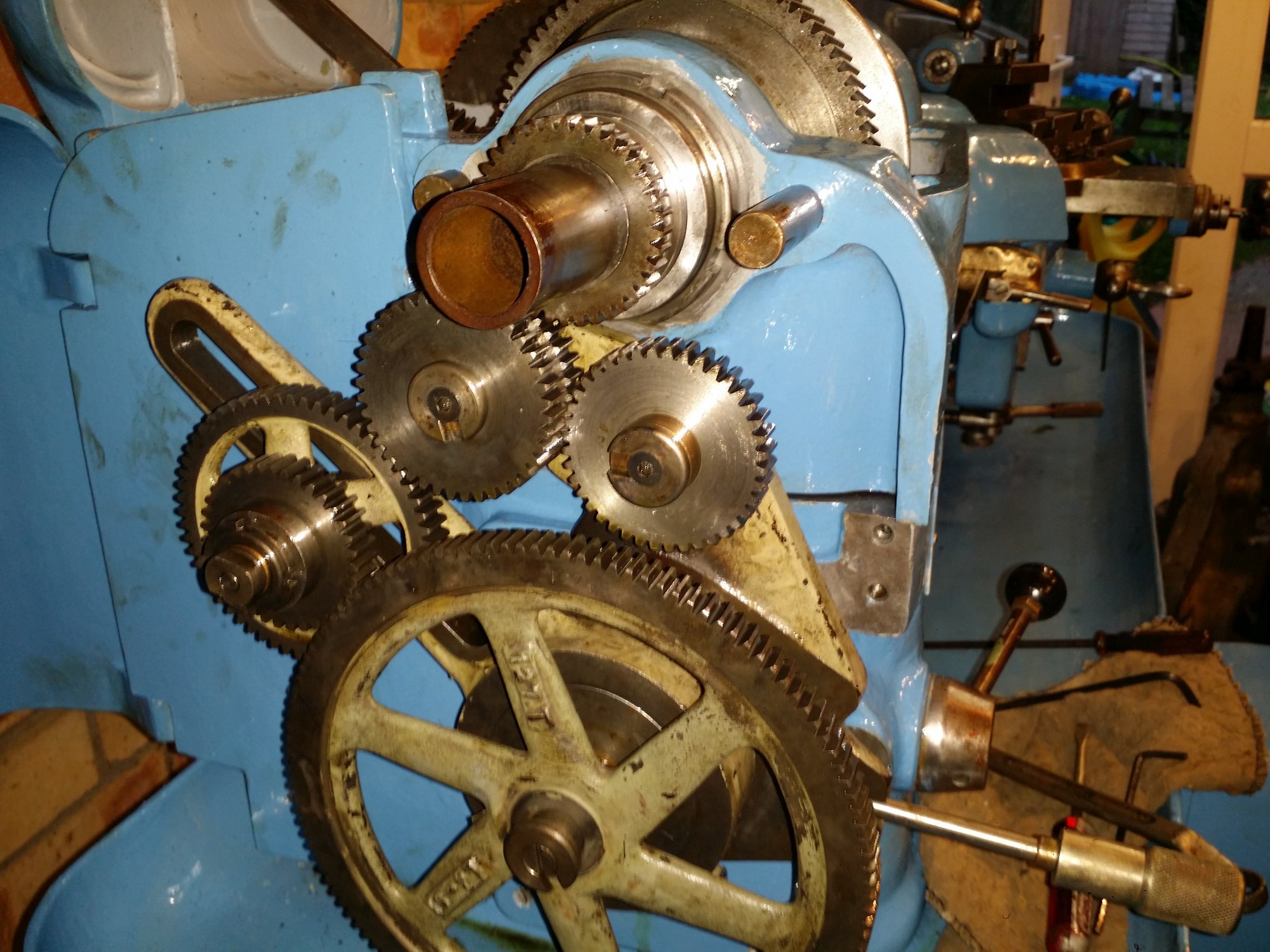

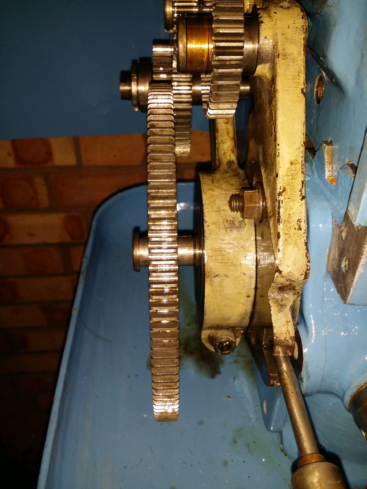

Original bracket is in two pieces and I don't have the second piece Unfortunately.It doesn't look like the tumbler teeth match the change gear teeth. Can you post up OD and tooth count for those because they look like they are different DP.
Why can't you use the original tumbler?

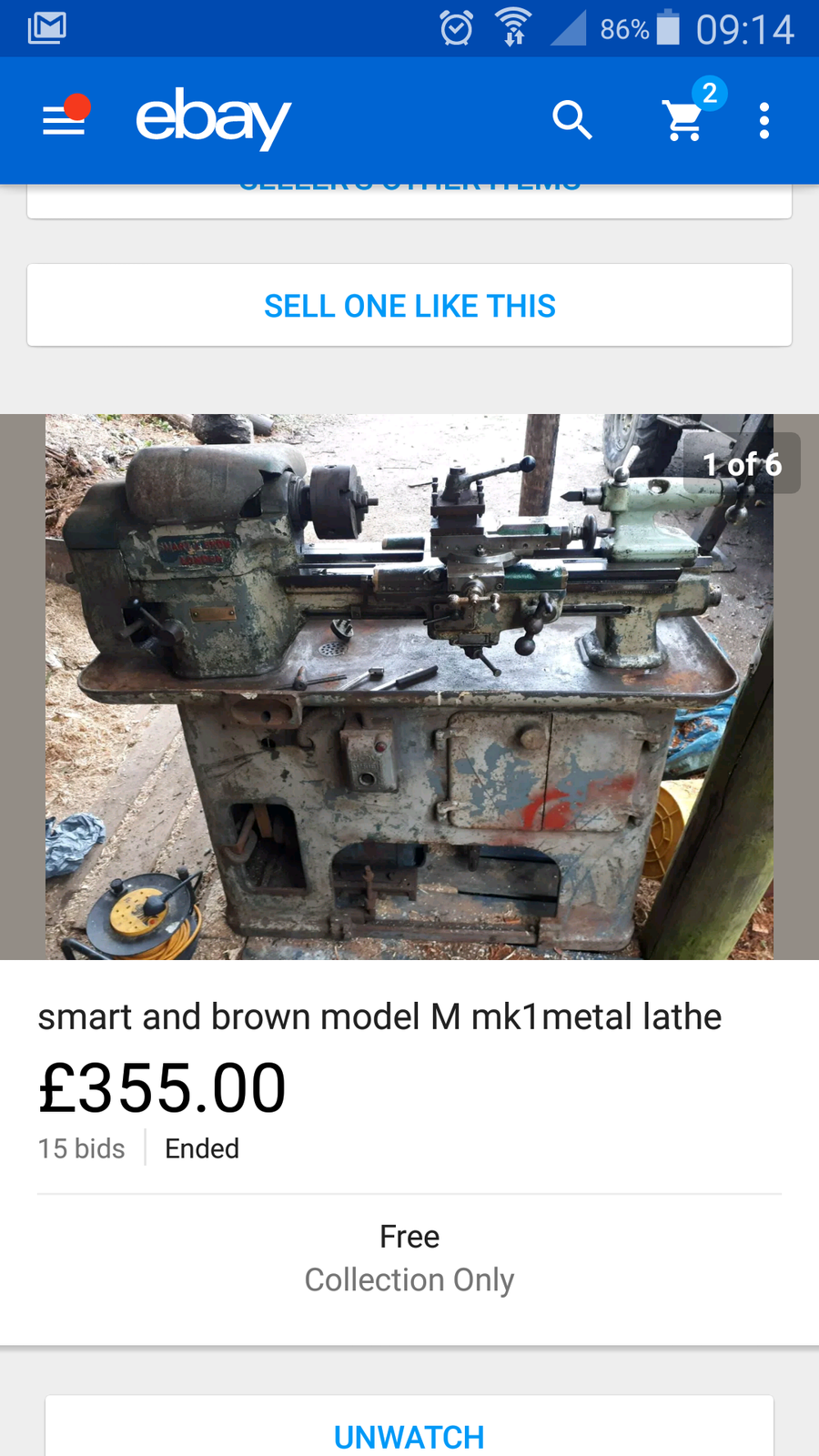

Yup. Would have given 200. Taken what I needed faceplate chabgewheels tailstock etc and sold the rest on for a reasonable price to recoup my money.That's a piece of scrap or a boat anchor..
