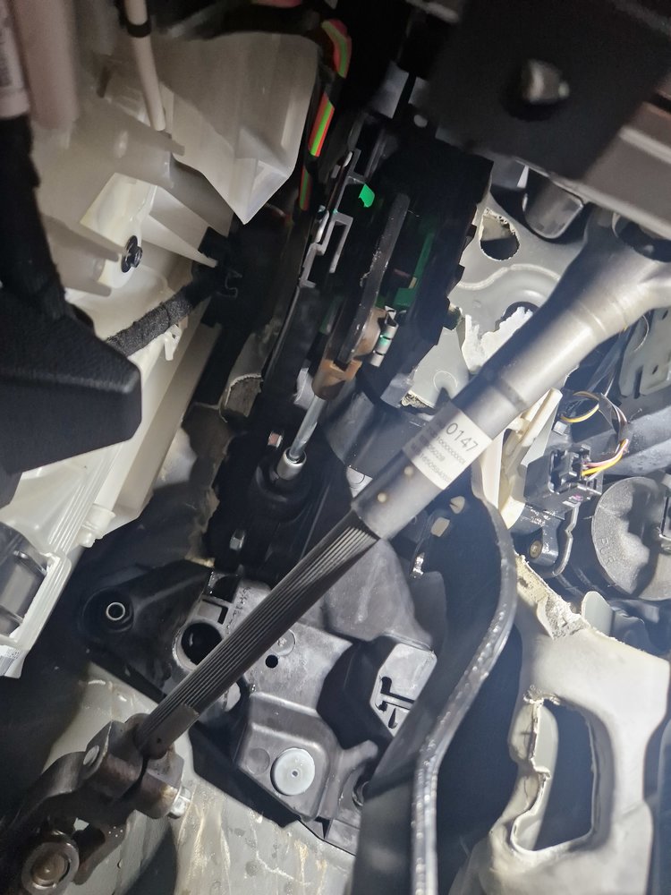

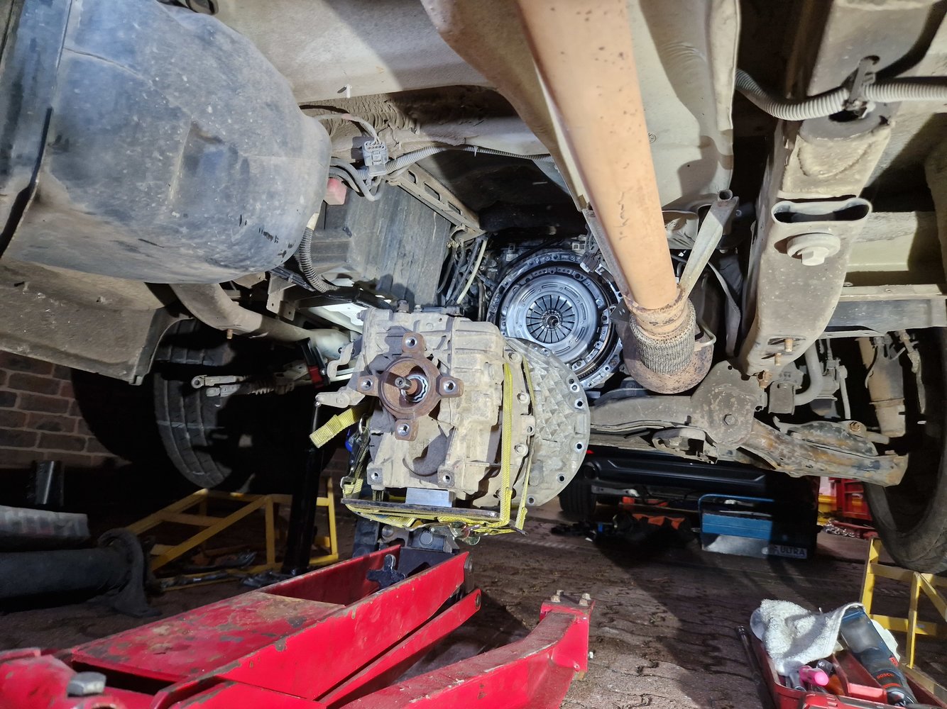

The joys of rear wheel drive.Put a new clutch in the Sprinter yesterday.
Had an odd issue with the clutch getting heavy when not used, like in one gear on the motorway for a long time.
Aside from being annoying i didn't want it putting extra strain on the hydraulics and causing the slave cylinder to fail.
Such an easy vehicle to work on.
