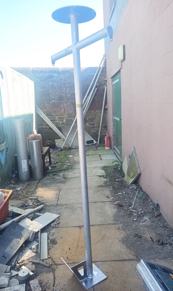

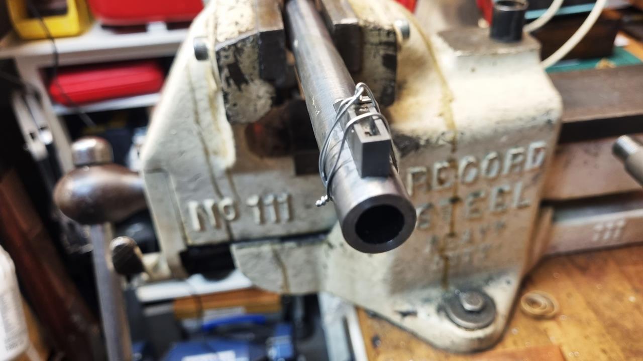

Mast looks like it could be used as a scarecrow if it doesn’t work out…Another mast today but just a boring one.

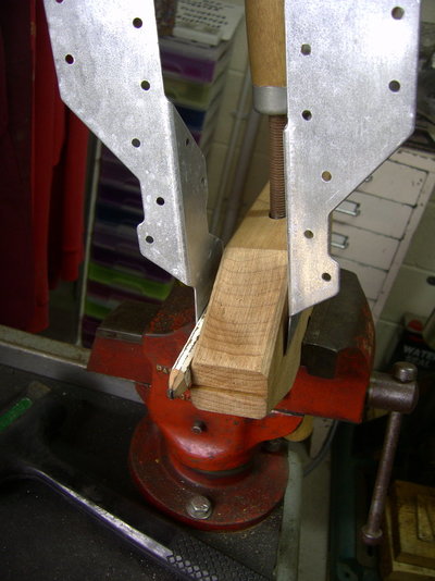

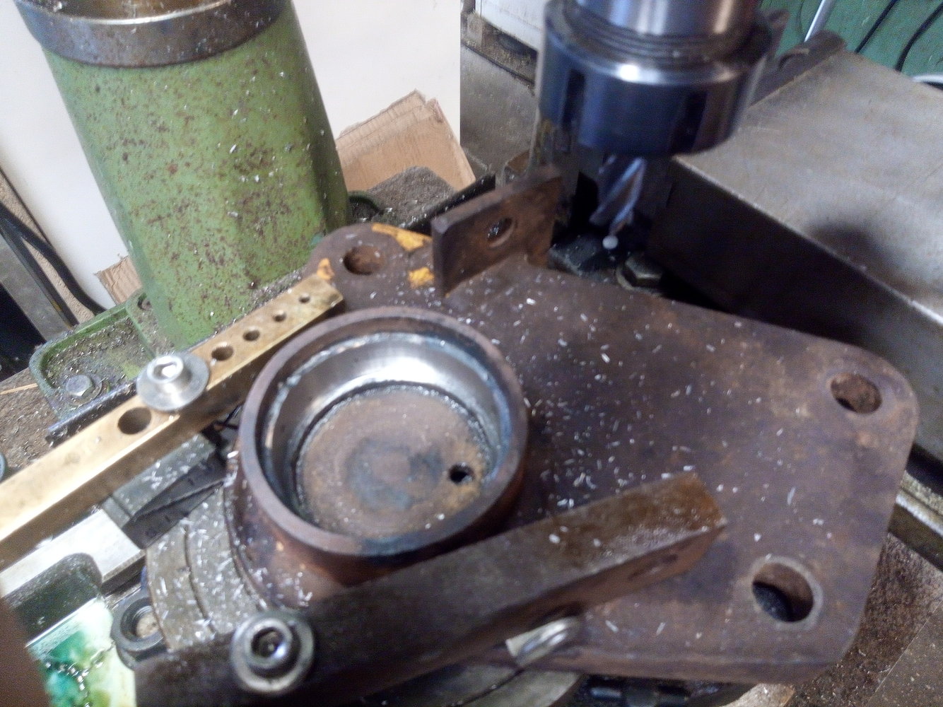

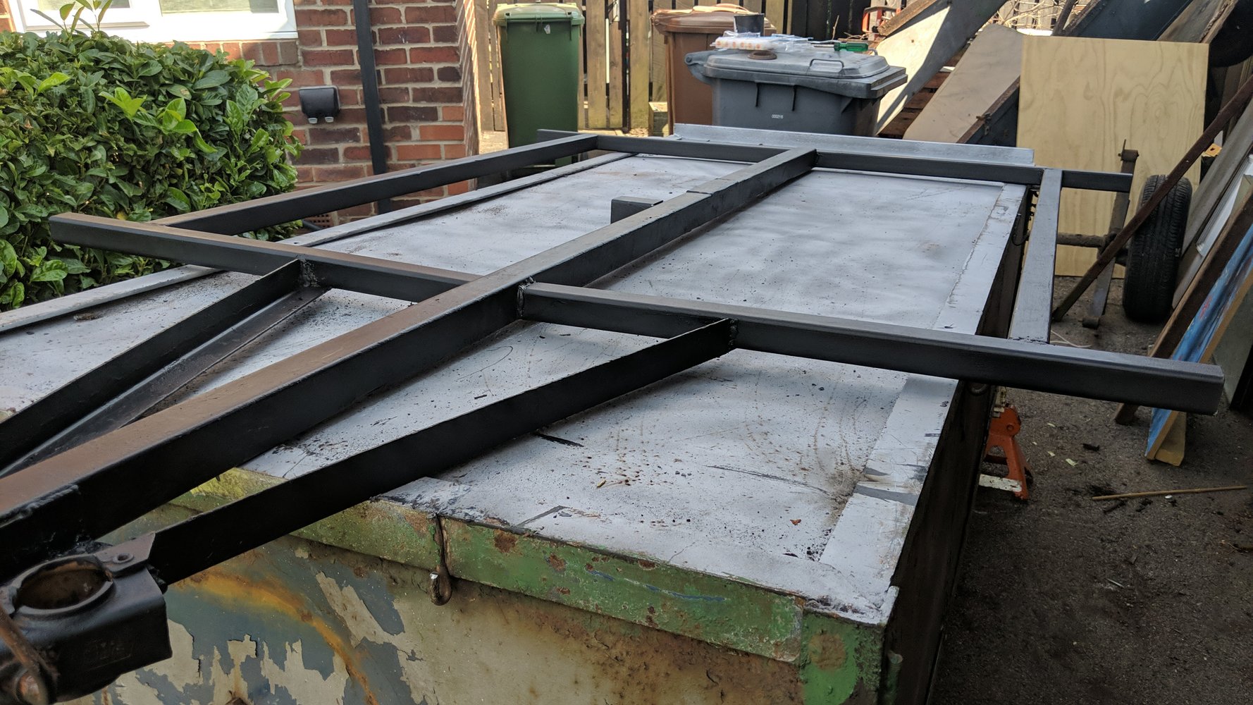

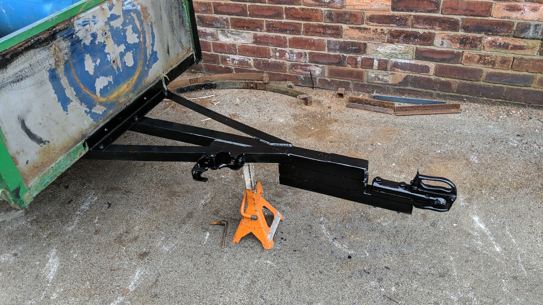

A mount for a Ram that will be fitted to the mast of a boat in which the guy is doing some sort of charity trip.

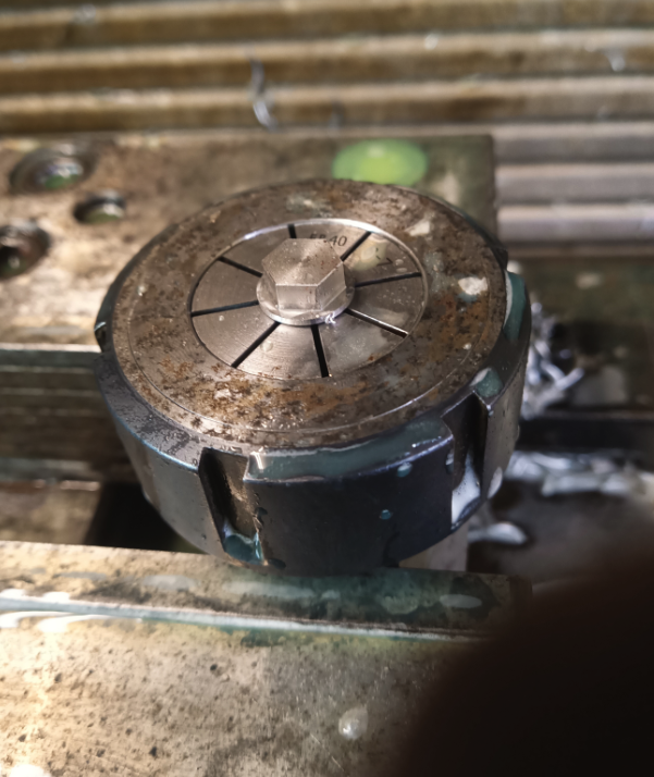

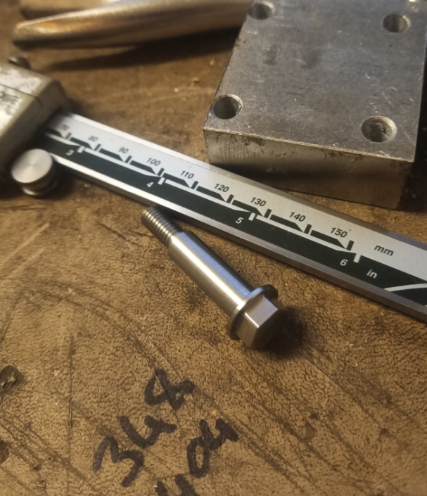

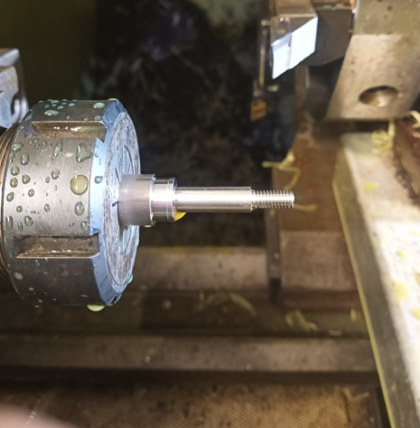

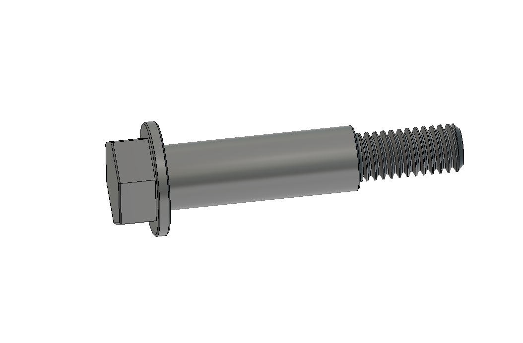

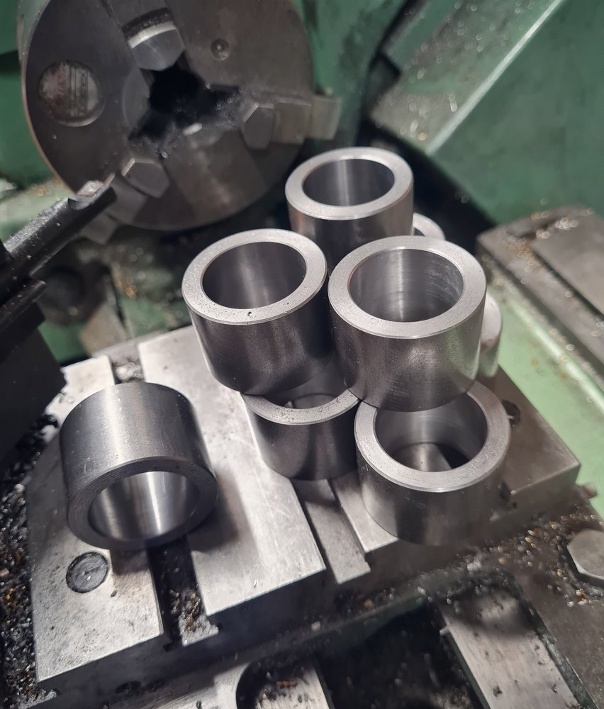

Ok, quick measure and draw up in fusion.
Chuck up the ER40 holder with some 16mm dia 316 and let it do its magic.
Part off and turn in the collet holder and into the mill and make a 10mm hex.
Job done, 3x more expensive than buying one but at least I don't have to wait a week
The greater majority of people don't even remotely understand what goes into producing this simple bolt.

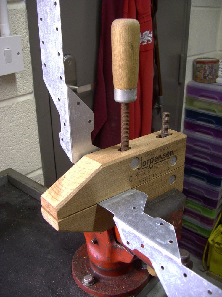

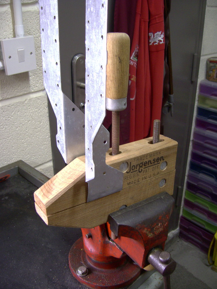

I bought a 47mm 2" one in Wickes last week for £1.20.I stopped by my local builder's supply for some 47mm wide joist hangers, and was shocked at the current price , so went to another builder's supply that was a bit farther away. They only had the 38mm wide size, but the price was reasonable; 90 pence each
