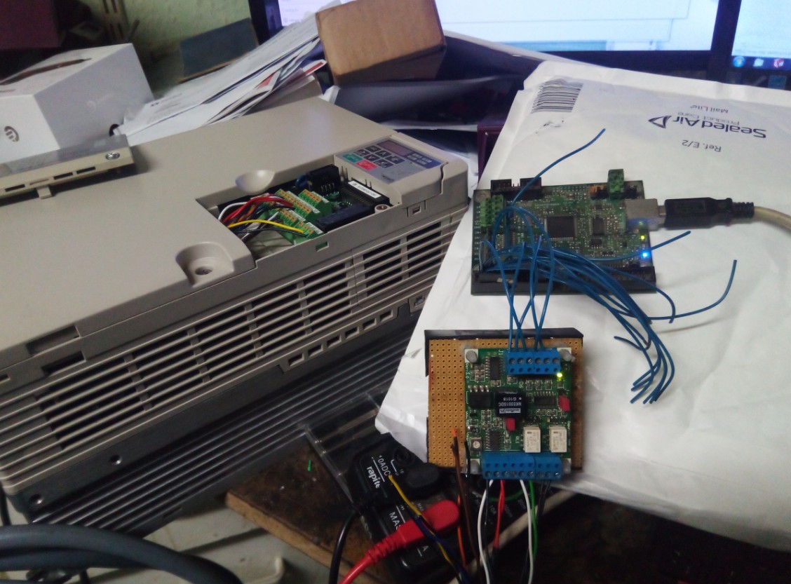

My CNC lathes spindle drive crapped out a month or so ago and I haven't had time to do anything about it.
The servo drive that it uses is about £5-6k new and even a repair is £2k so I wasn't wanting to splash out that much as I do not use the lathe for production work and in fact it can sit for several months or more unused.
I was going to put the lathe back to the way it was when I originally got it, a 12Kw induction motor working through a gearbox that had electro magnetic clutches to give a range of speeds. My friend however had a 15Kw VFD sitting doing nothing so I got that. I will, at least at first, just set one gear up and use the VFD to vary the speeds. In the future I may get fancy and have it set up so that the gears are used and the VFD will vary the speeds within a range, that is the future though and I may not even need to do that.
So today I raked out a spindle control board I got years ago from Peter Homann in Oz and decided to wire things up and do some bench testing. Everything is working as it should so all I have to do now is get some more time to remove the servo motor and fit the belts up to the gearbox and then work out the PLC and other I/O and then wire things up and I should then have a working CNC lathe
Pic of the VFD, the spindle board and a USB SmoothStepper I am using to bench test things with.
