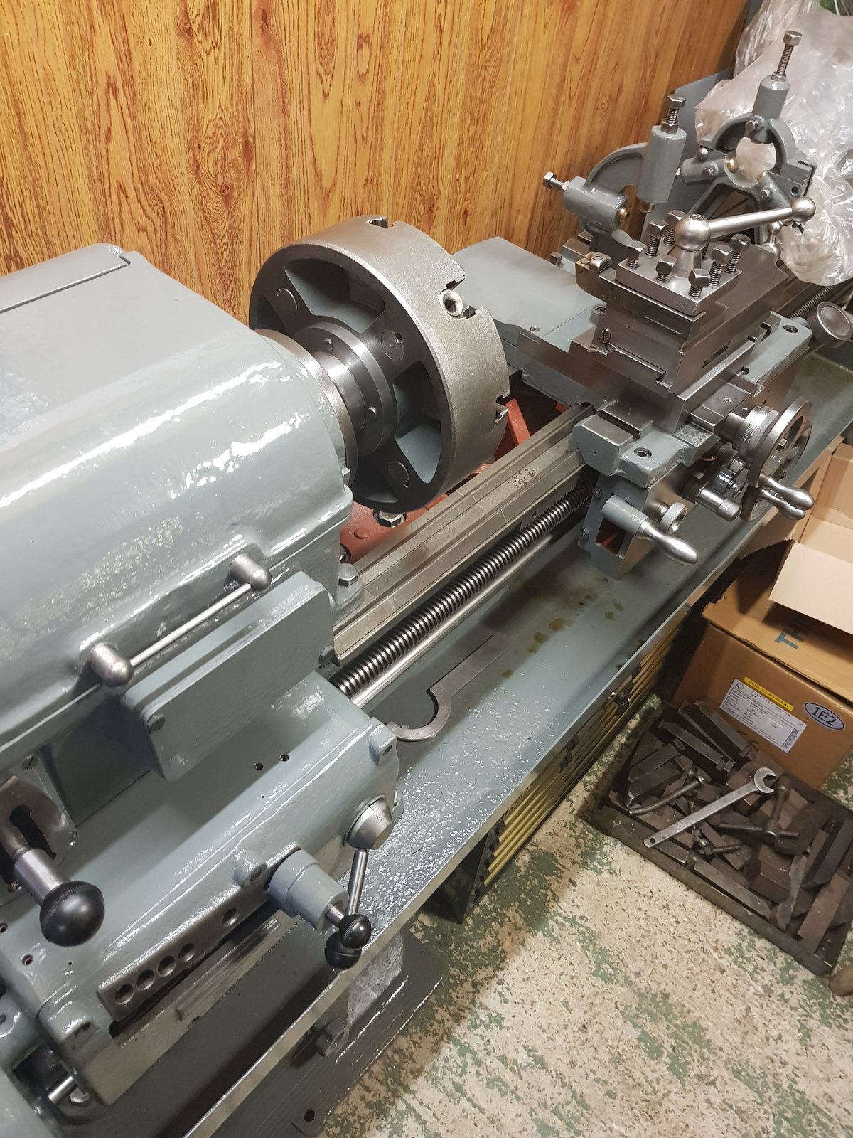

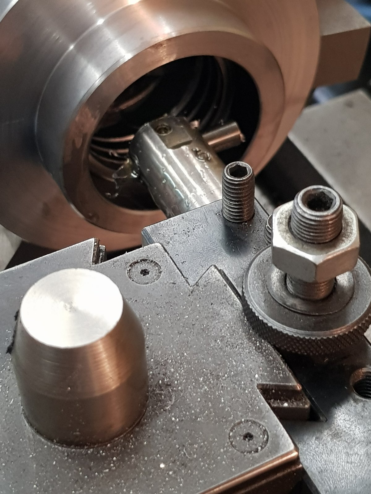

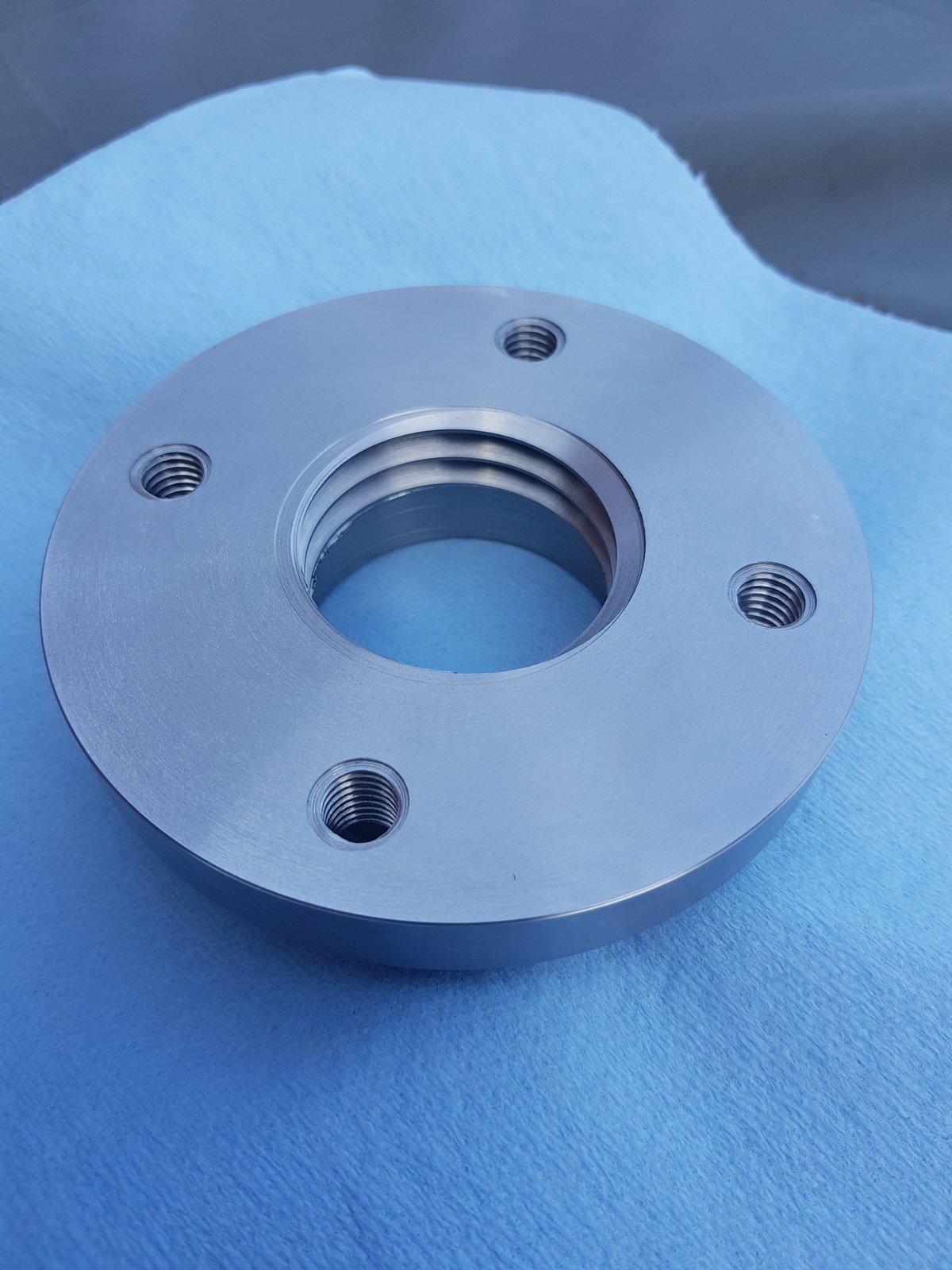

Here is the finished product. Fits nice...a fantastic job. many thanks to pete for his help and support and guidance and allowing me to operate such an awesome machine..Not today, but Sunday just gone I made a tool for cutting a 4tpi Whitworth thread. I wanted to use it in my home made boring/grooving/broaching bar but couldn't find any 5/16" or 8mm HSS, so I trashed a nice 8mm drill bit (after checking it was hardened it's whole length).

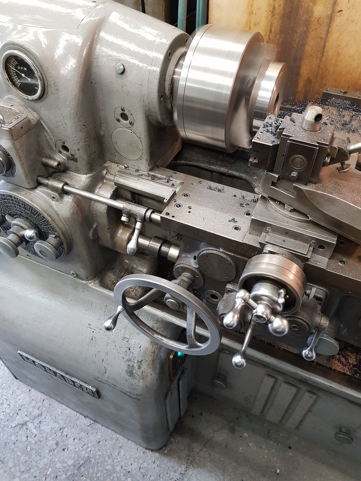

This was to make a backplate for Spencer's Empire lathe, so that he could mount one working chuck and make some more himself. Spencer did a lot of the turning but I cut the thread because he didn't want to be responsible for crashing my 10ee, though I did coax him into taking the spring passes to finish it off
As you can see, it cut a very nice thread indeed.

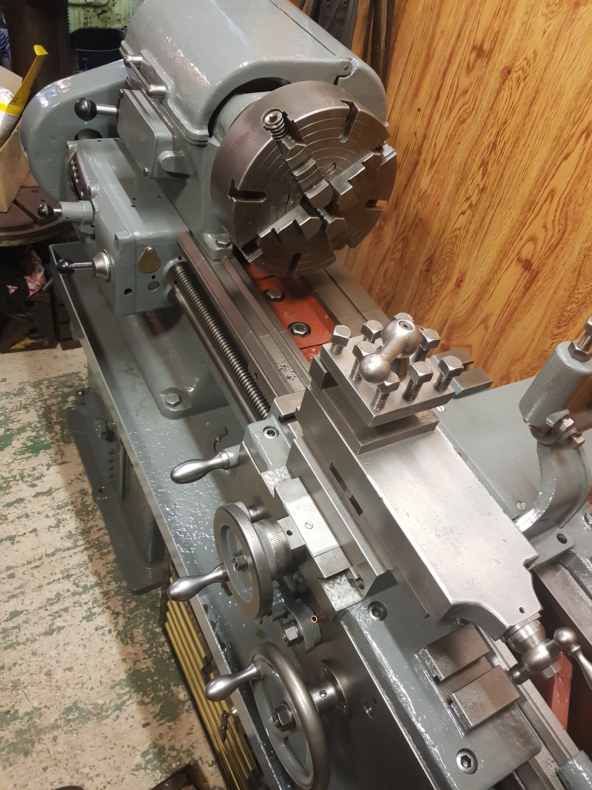

The chuck did clean up really nice and matched the machine..very chuffed...That chuck really looks the part now it's cleaned up. Not over-done so it looks like someone tried to polish it new. It just looks right.
Is that a 10EE? Beautiful looking machine, I've never seen one in the UK. That or a Hardinge HLV would be my dream lathe.Here is the finished product. Fits nice...a fantastic job. many thanks to pete for his help and support and guidance and allowing me to operate such an awesome machine..View attachment 187083 View attachment 187084 View attachment 187085 View attachment 187086 View attachment 187087 View attachment 187088 View attachment 187089
It is. A fantastic machine.Is that a 10EE? Beautiful looking machine, I've never seen one in the UK. That or a Hardinge HLV would be my dream lathe.

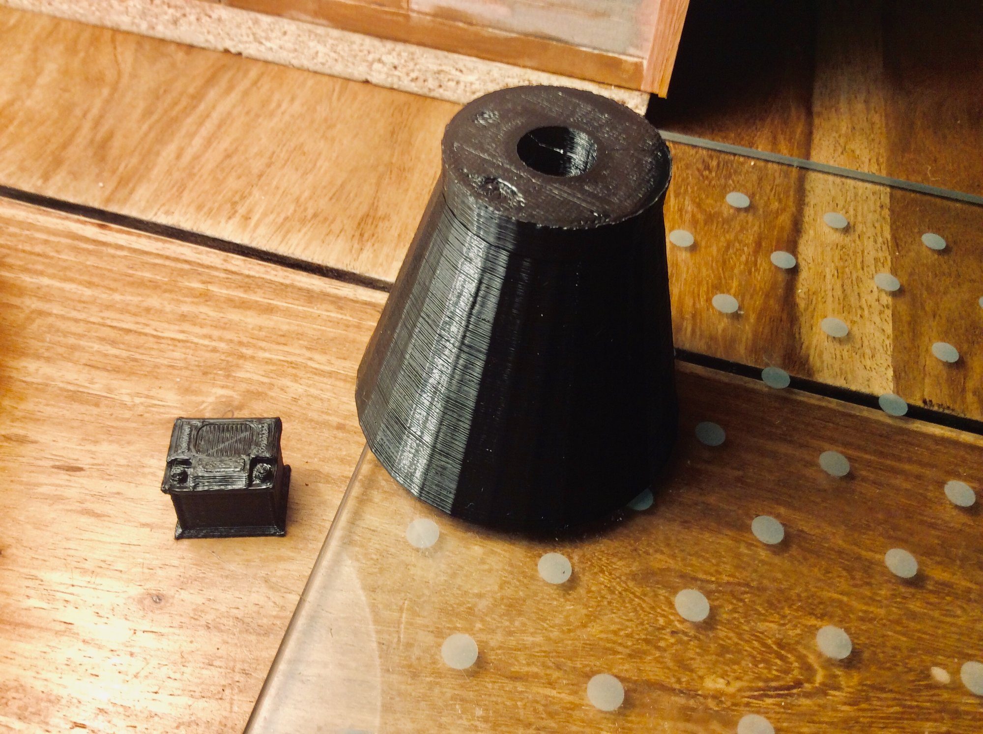

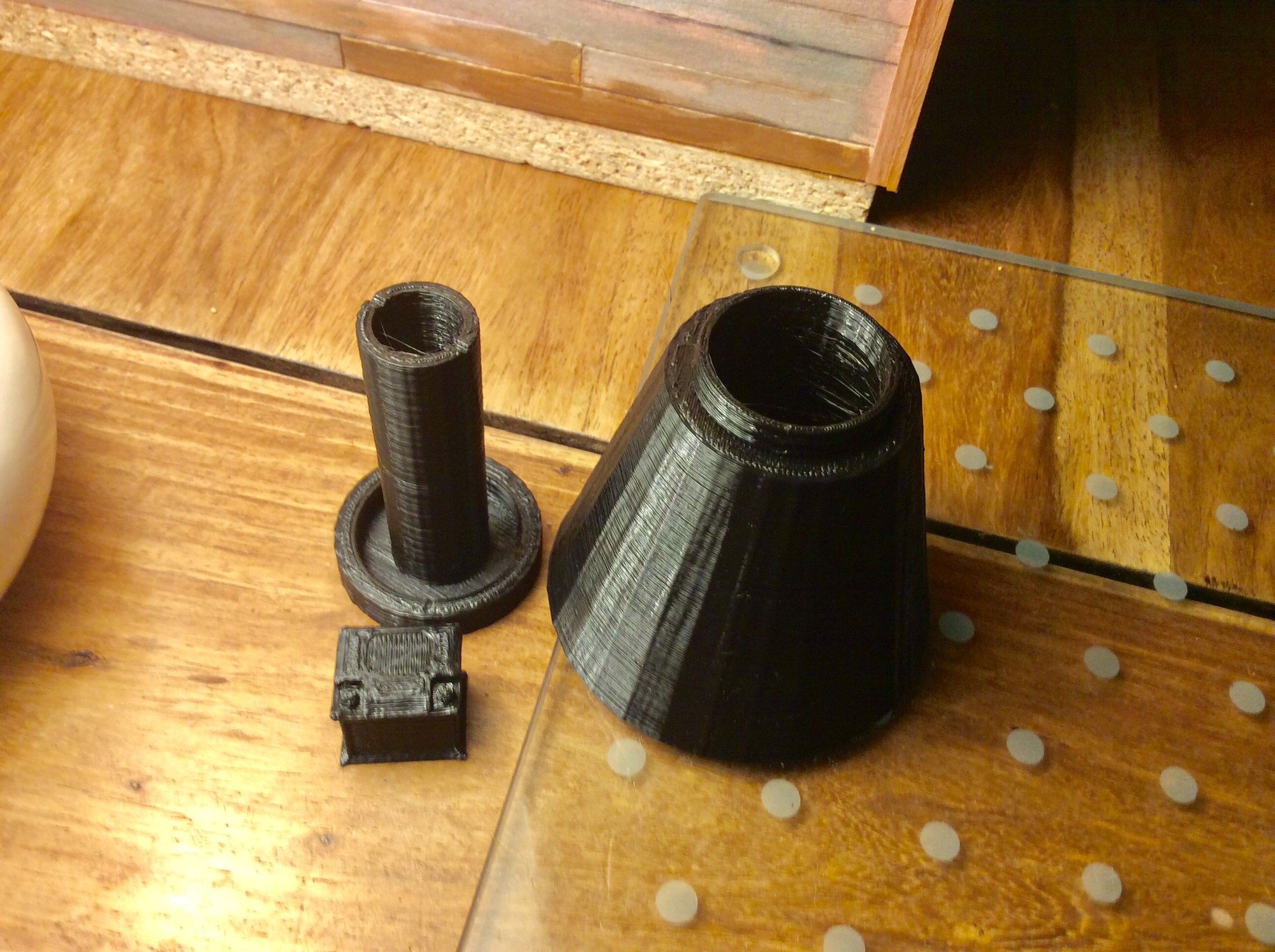

He's not finished yet, but mocked up pretty well. LED strip inside the "head" and I need to get a couple of bulbs for hands then make a wooden base for him to stand on from some oak I have.
