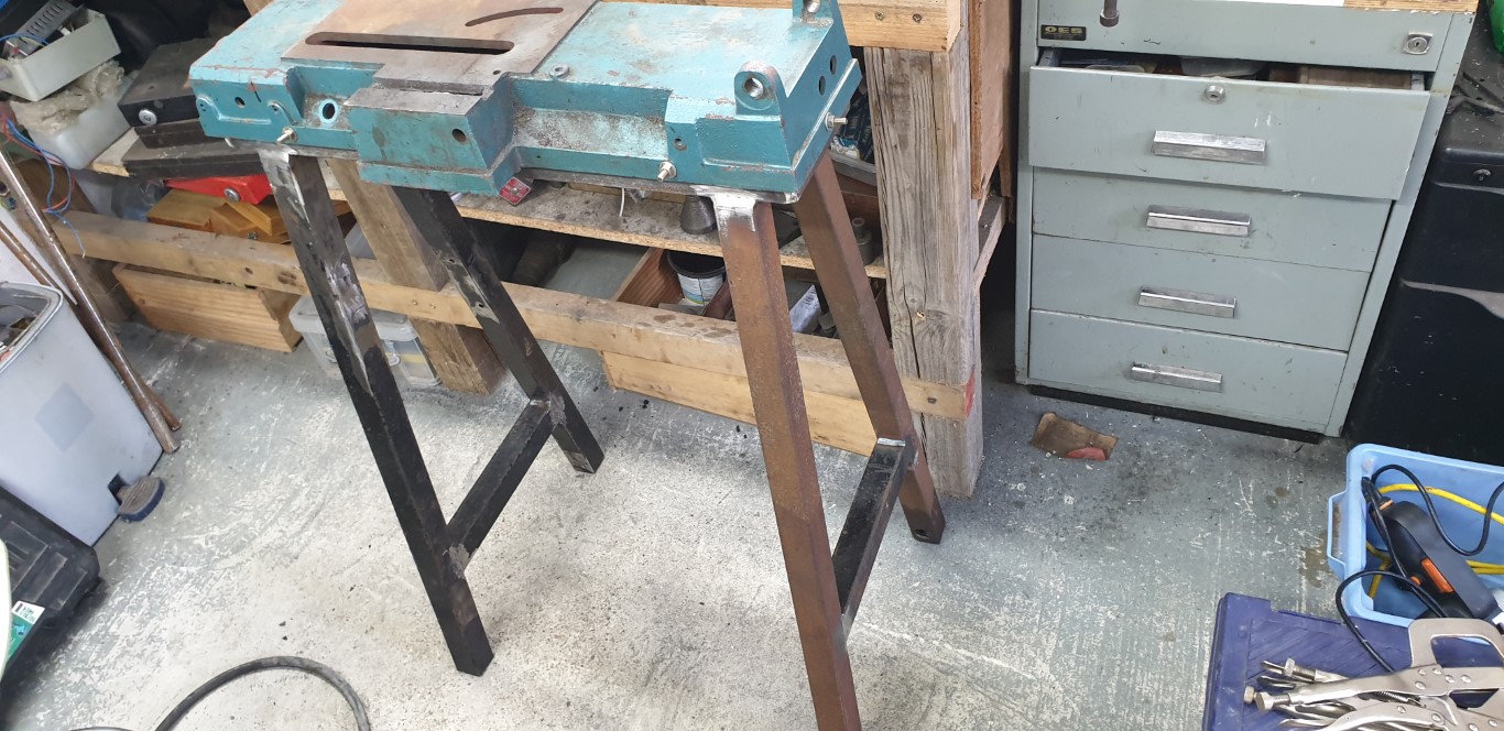

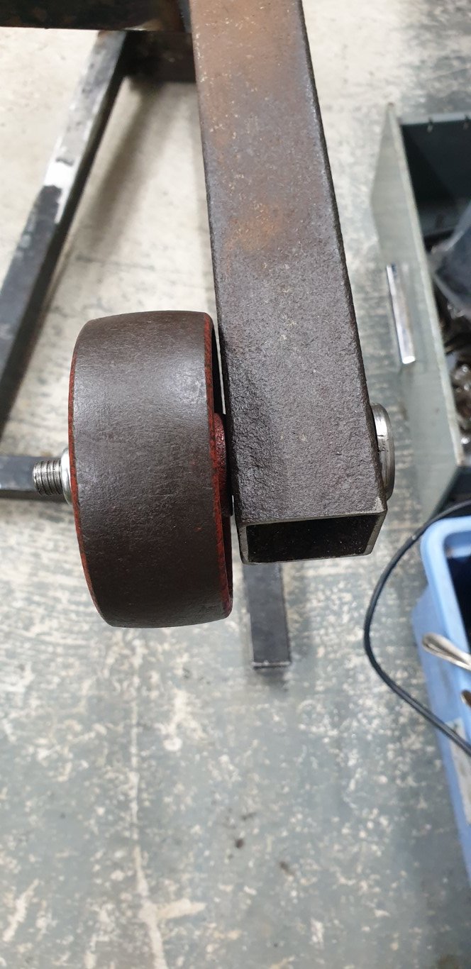

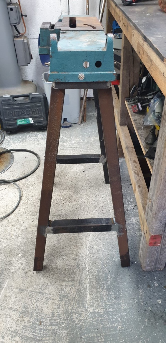

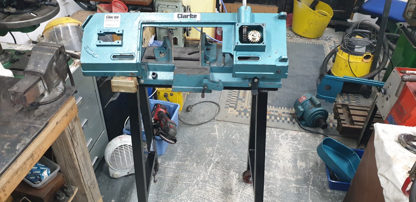

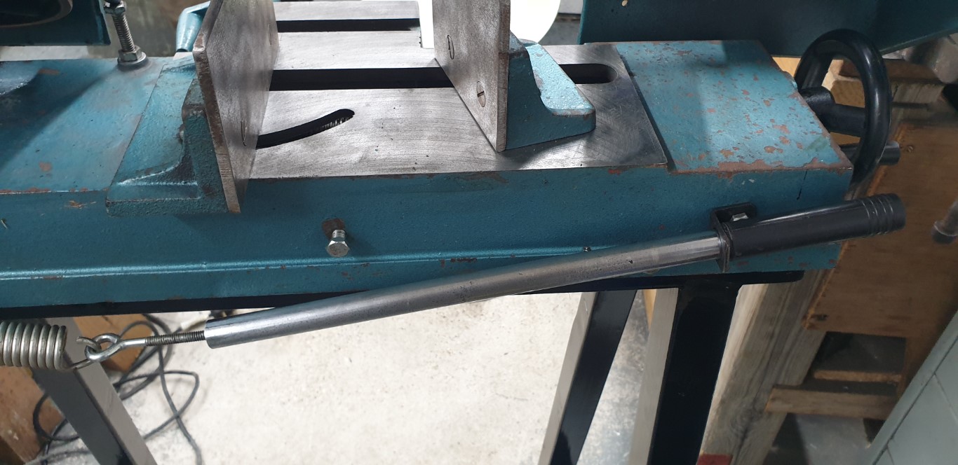

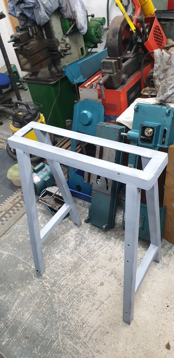

I made a similar base for my saw but at the front end I put a single leg that along with the wheels makes it 3-legged so it will sit level on any surface. I also added a handle for moving it that hinges down when not needed.

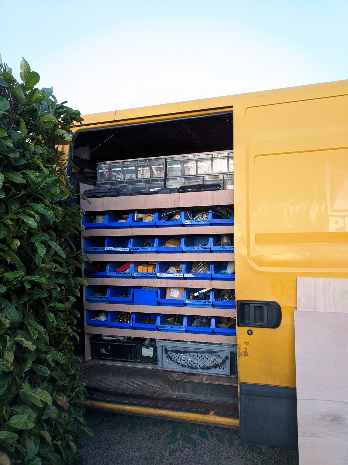

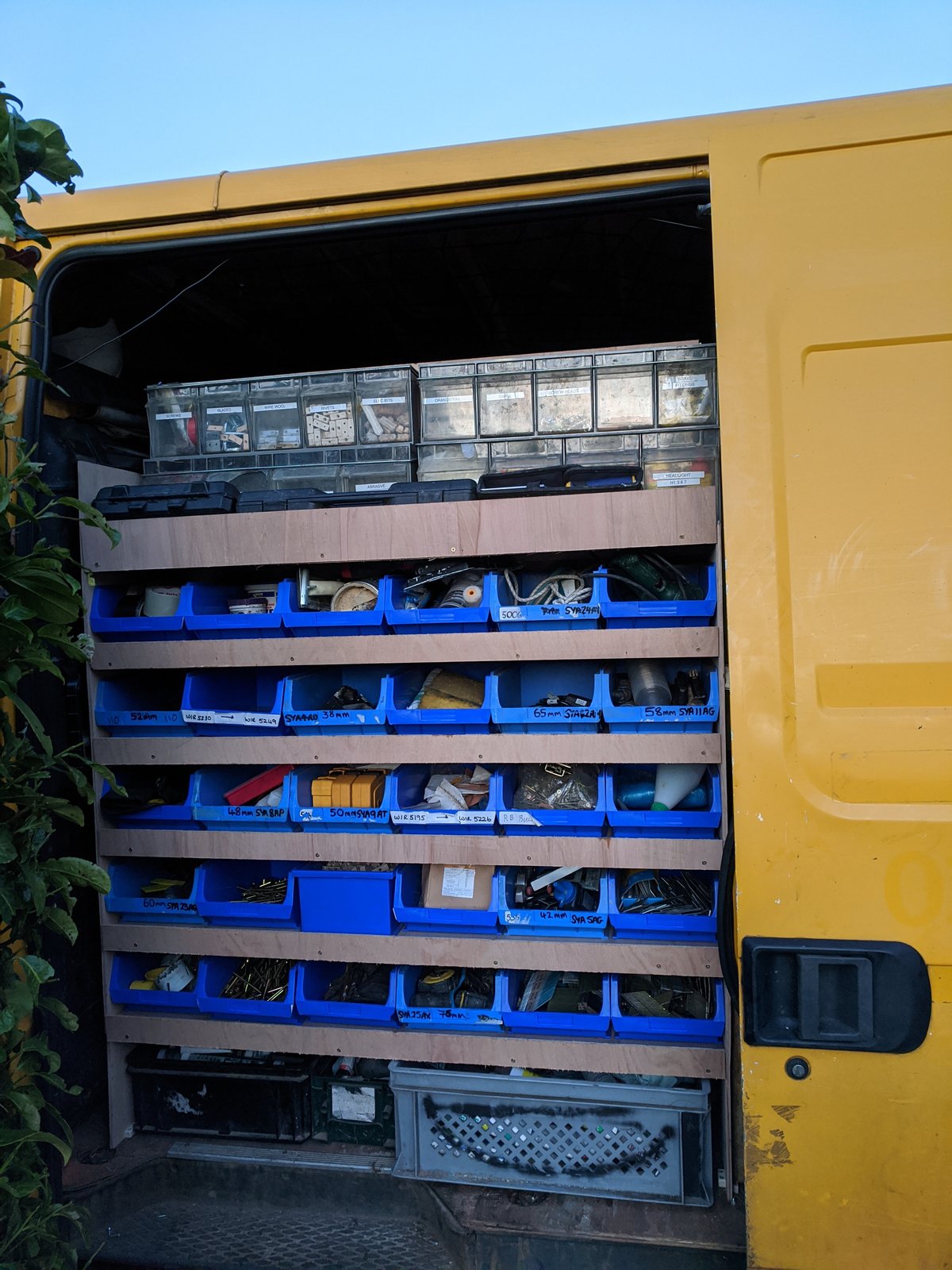

First step of the van organisation.
Yup. Was using eurocrates before stacked up but sods law dictates what I want is always at the bottomIt's like a portable Pic'N-Mix.

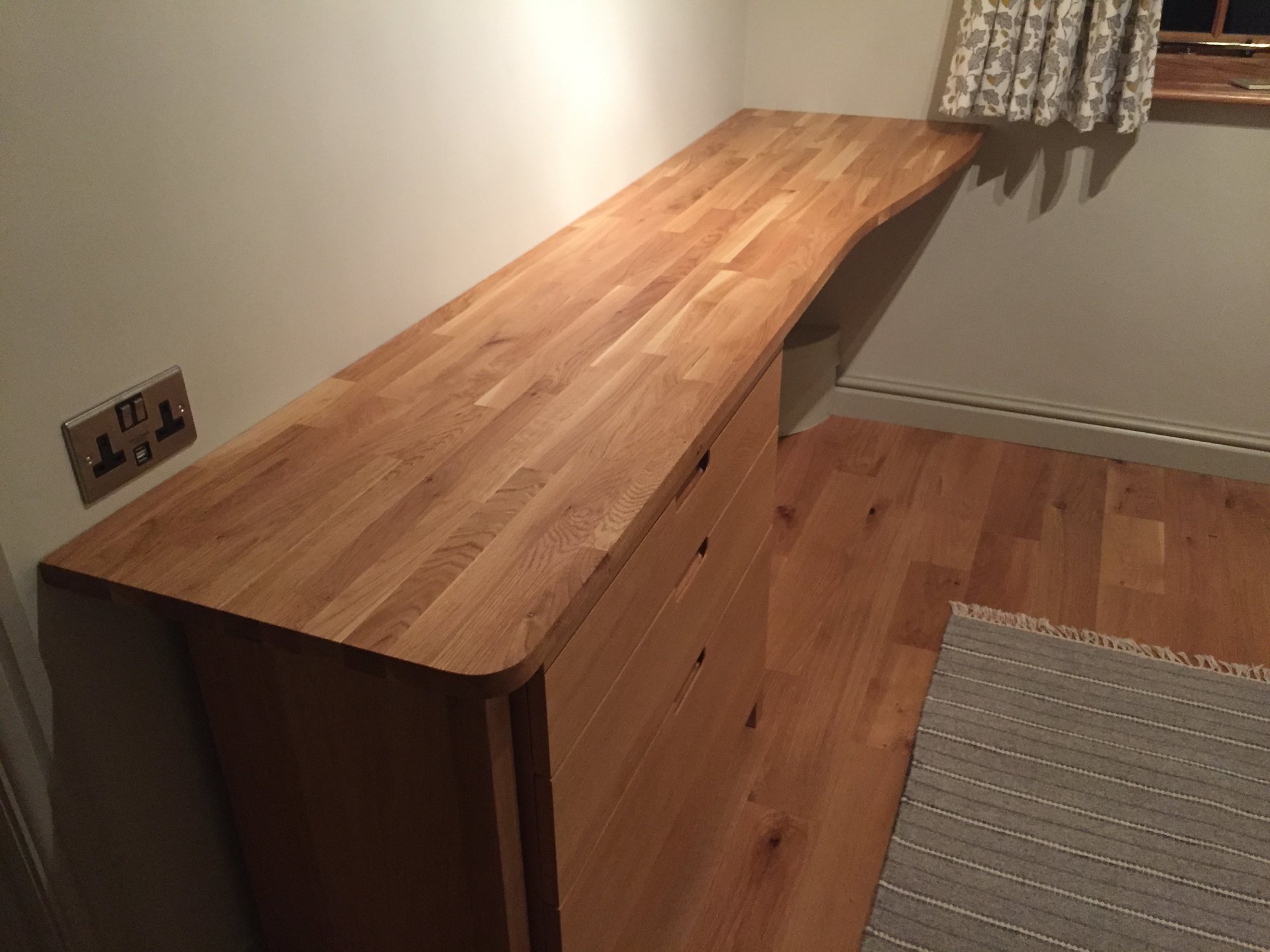

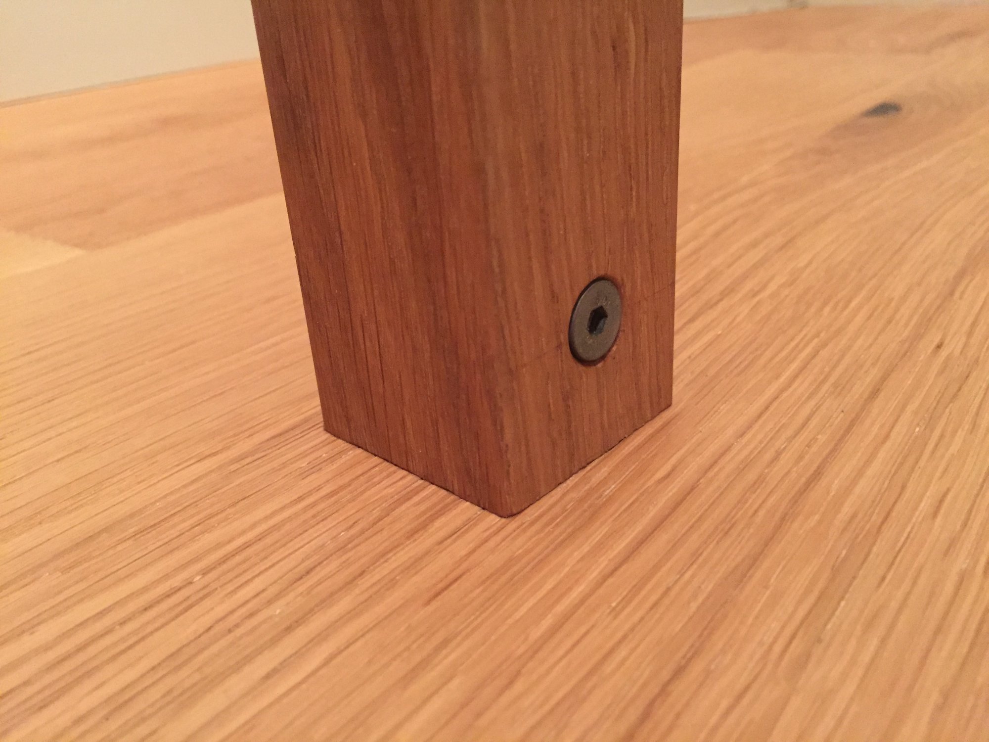

Would have drilled the End's freehand myself. Or used an offcut drilled on the pillar drill as a guide.I’ve been working on a sewing area too, for my mum.
That there chest of drawers has to slide out as the mains water isolator is behind it (although I’ve fitted one of those remote jobbies on the other side of the wall so unlikely access will be needed often). So supported the worktop on a couple of oak legs.

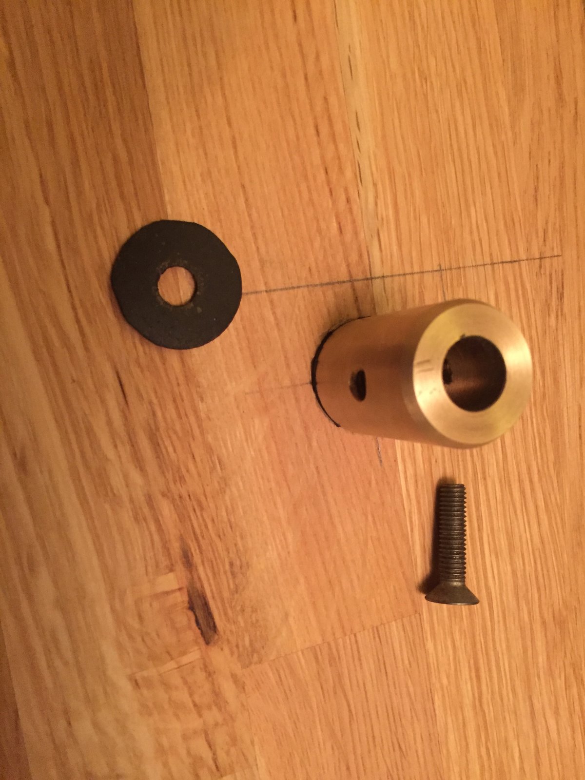

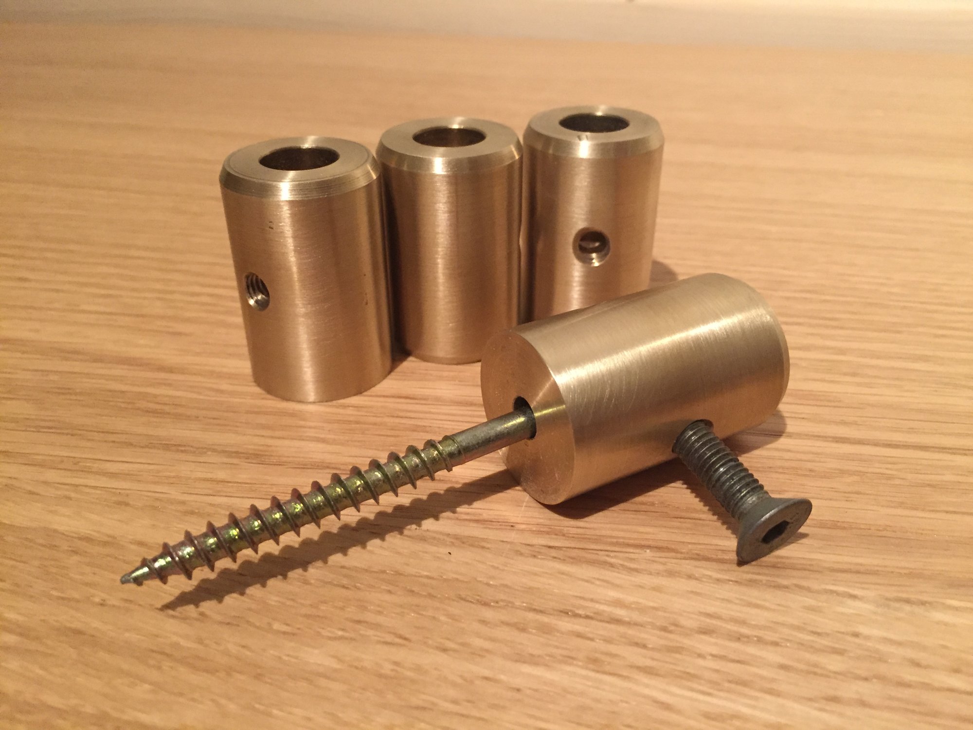

Made these thingybobs with hidden screws to fix the legs:
Seems rock solid so pleased with it. Is there anything like this commercially available I wonder? I couldn’t find anything and needed them quick anyway.

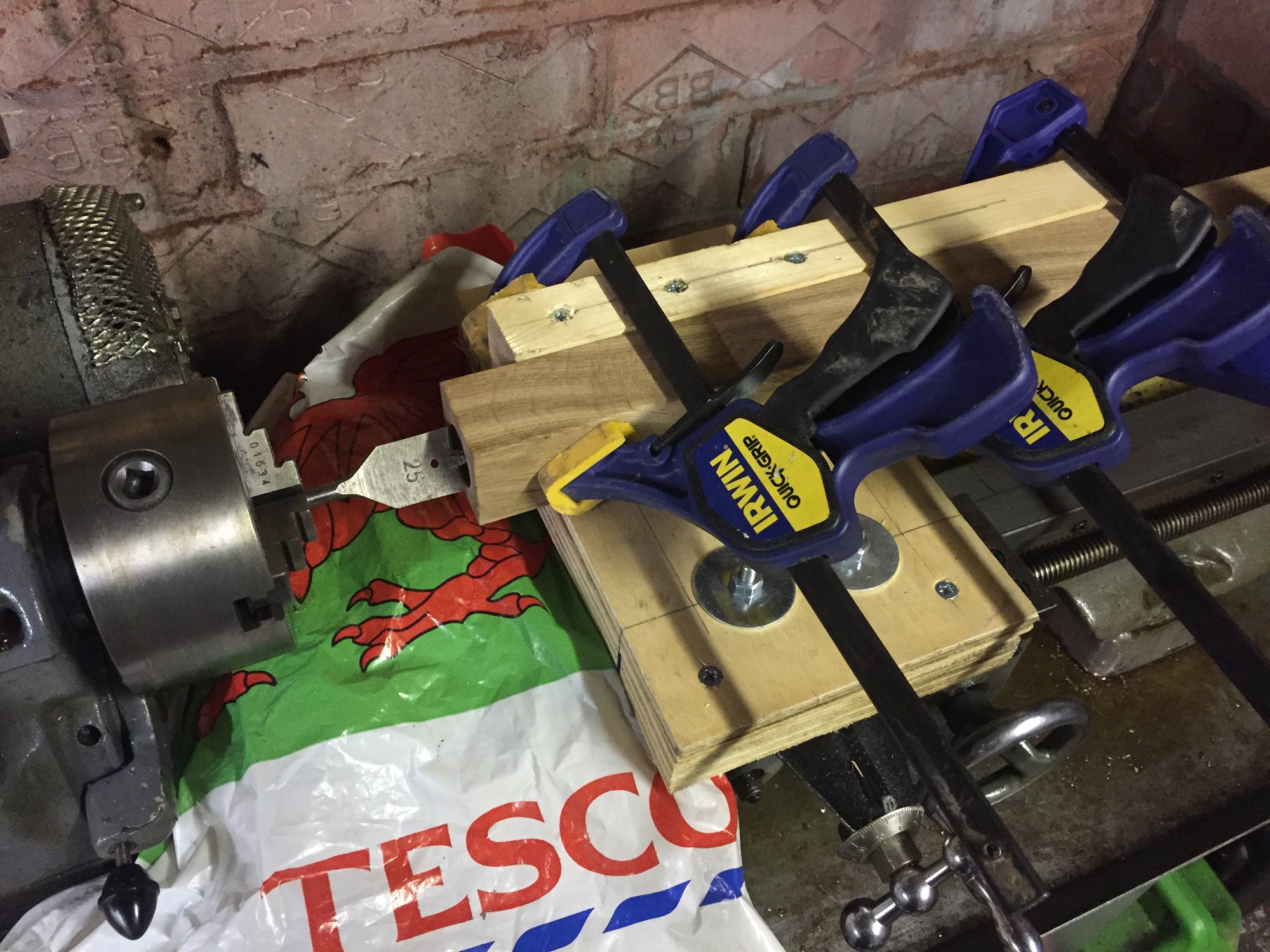

Didn’t like cutting wood on the centre lathe thoughcouldn’t think of another way to do this accurately.
I suppose there’s a woodworking machine for this but I haven’t come across one yet. Tenoner?

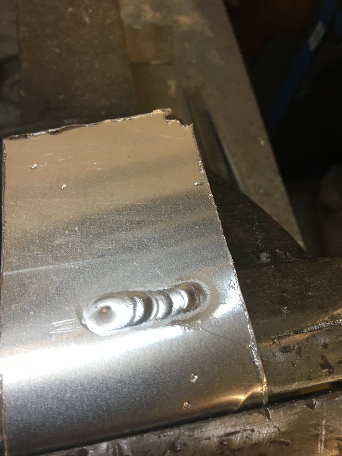

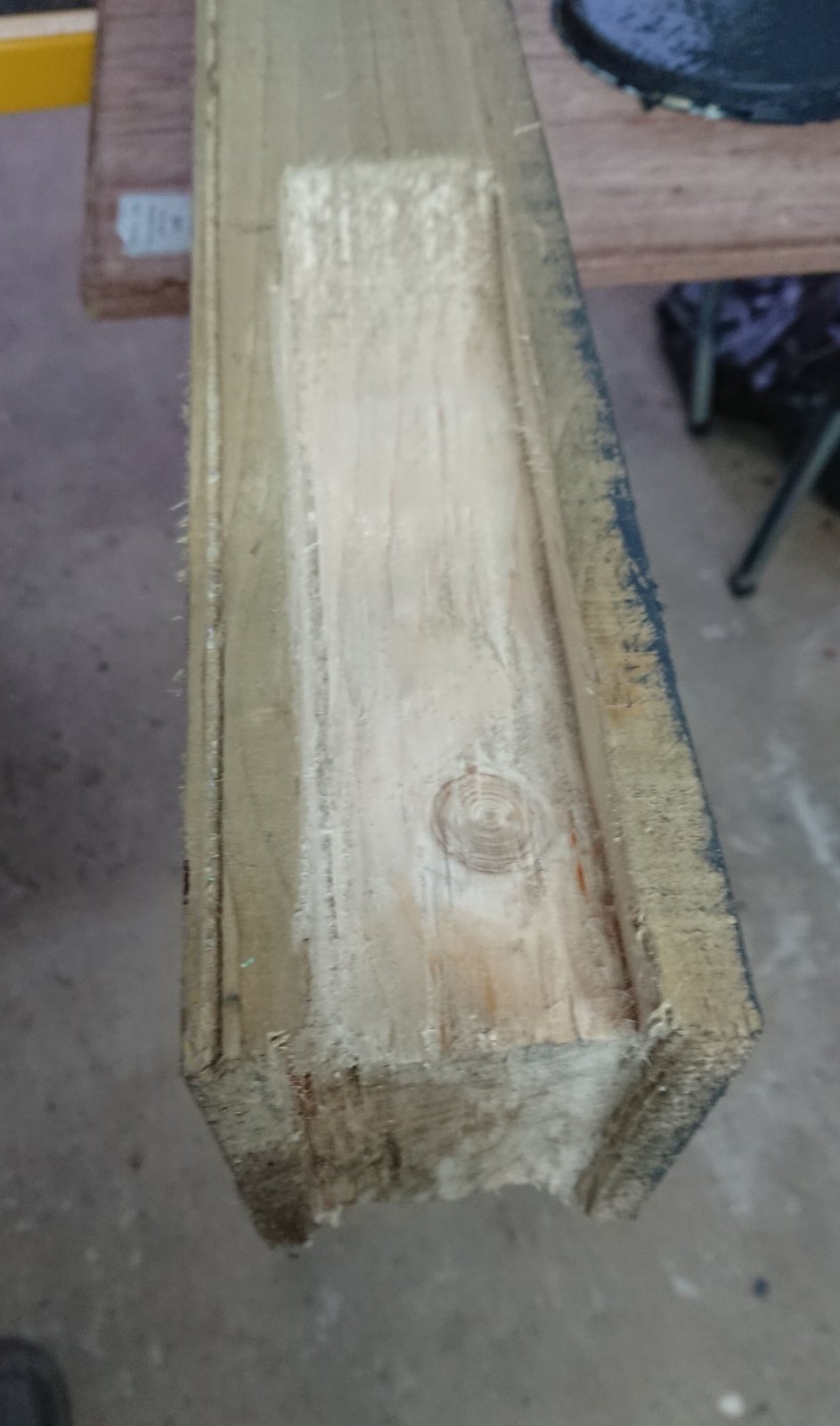

I gave a like for the humour and not the breakage.
Saw the pic before I read the text...some bad language went through my head![]()
Plenty of practice freehand though.
Nice idea on the feet.
Wouldnt mind an off the shelf option.
Can see a use

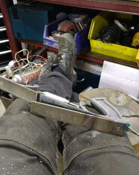

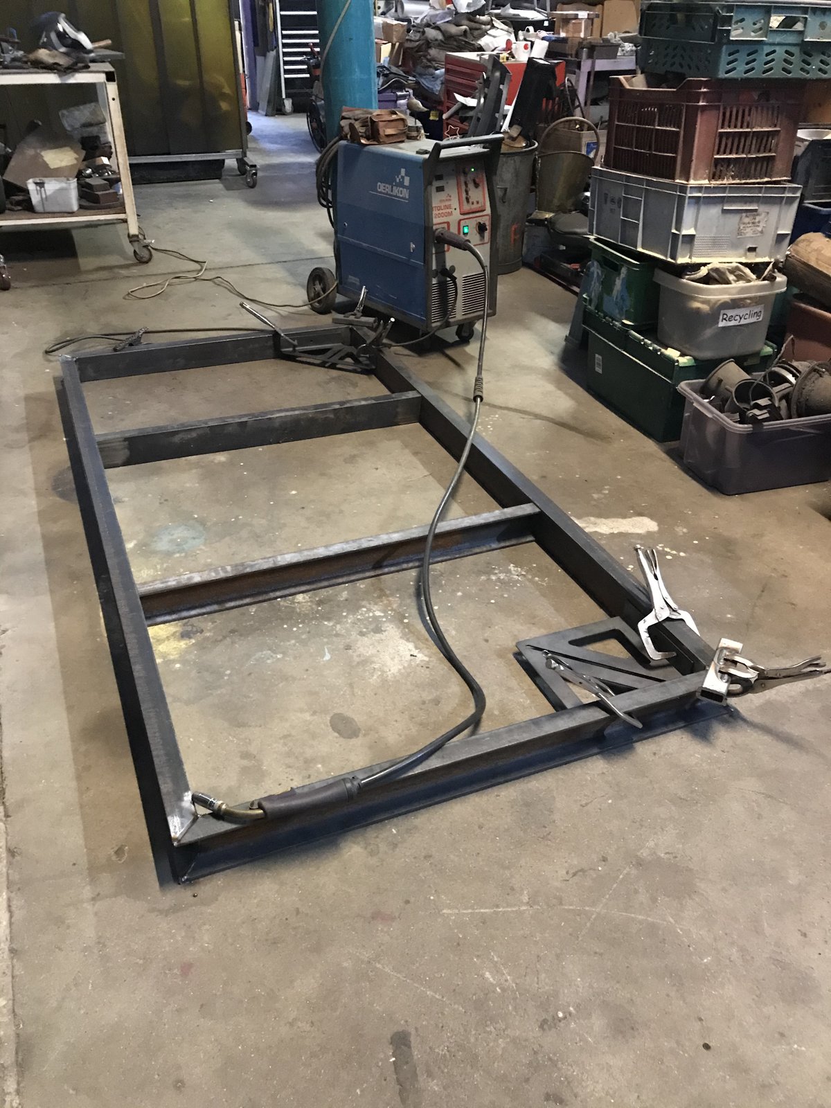

...but none with sharp eyes to see the two welds from previous f...k ups![]()
I saw the heat marks and just thought you were a fast worker...but none with sharp eyes to see the two welds from previous f...k ups![]()
