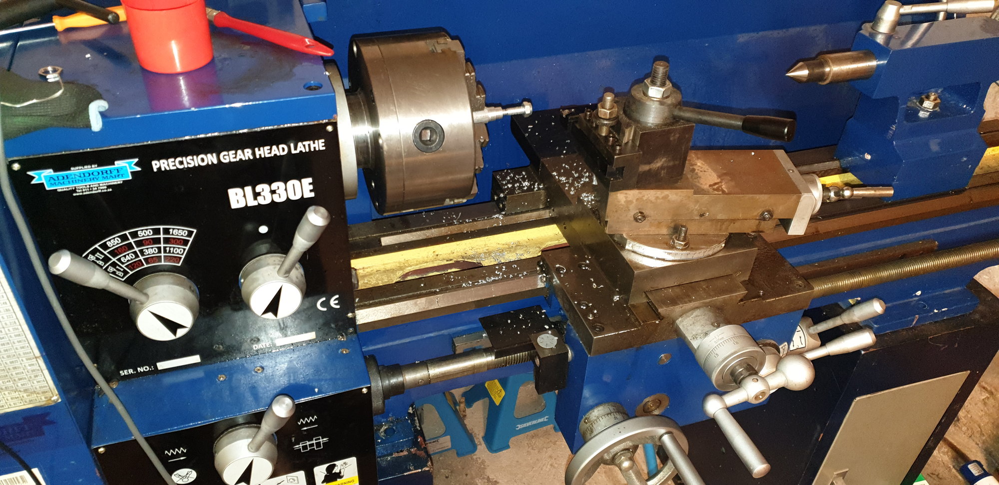

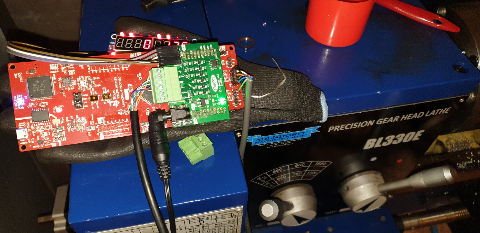

Turned my Lathe into electronic screw - it works need to now make it all nice looking

I just leave the half nut engaged and reverse the stepper motor after backing out the cutterNice job.
How will you sync it for screw cutting?

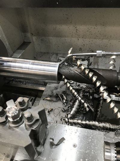

Some big swarf. Haven’t used my 62mm drill in awhileView attachment 211285
The electronics has an encoder which is run off the head stock in the back of the lathe which then calculates the stepper motor speed based on the gear ration and stepper micro steps setup on the Stepper driver and in the controller. this is not my design but rather https://github.com/clough42/electronic-leadscrew/wiki - I just followed alongHow do you sync the tool travel speed with the rotation of the workpiece for a given thread pitch?
