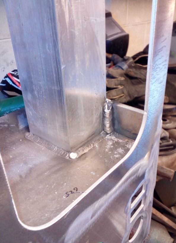

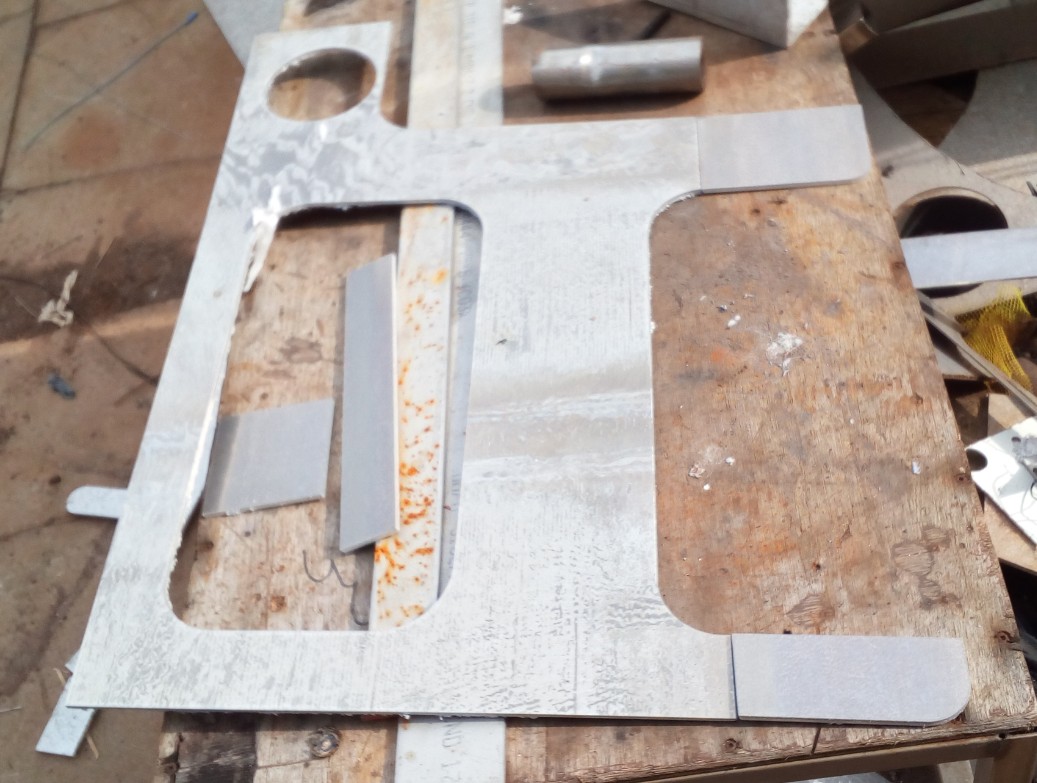

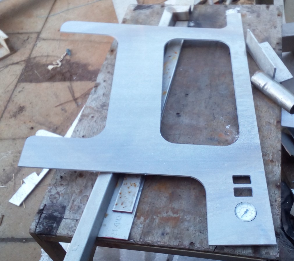

Went to the workshop this evening and decided to start on the new welder wall bracket/cooler.

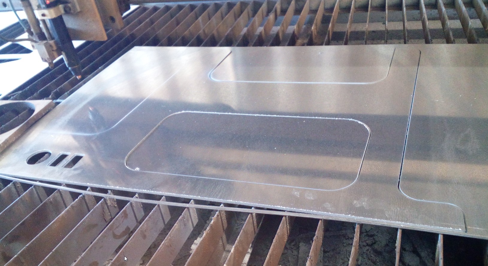

Had done a redesign to my first drawing, this one had one piece sides.
So into steel container and cut out a side on the plasma. Only had enough for the one side, thought I had more but nothing big enough
Pressure gauge fits

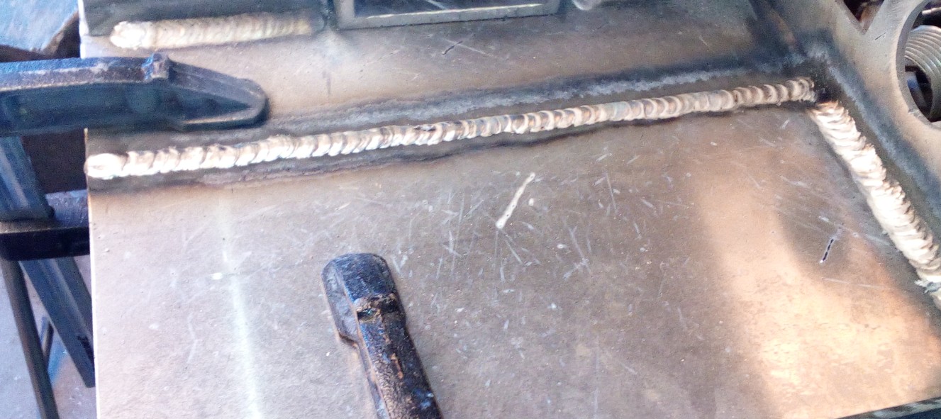

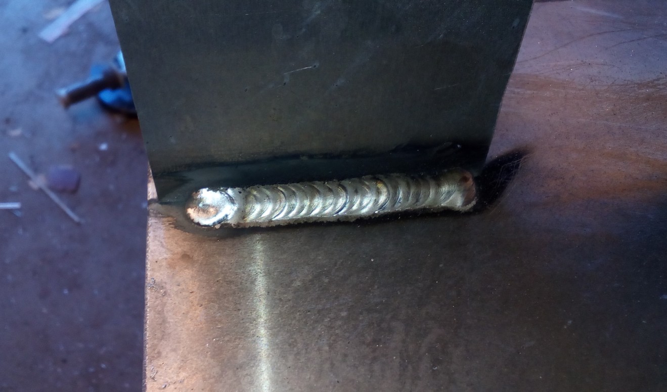

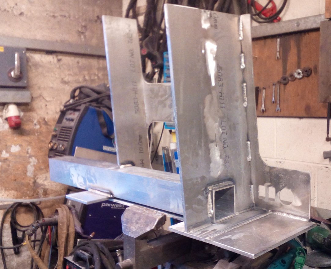

Chopped up some of the 150mm x 10mm and the 4" x 4" x 1/4" wall box and started welding it up. Not sure why but getting a lot of soot today, checked everything and all is fine so the only two things that have changed is a new roll of wire and a new cylinder of Argon, I suspect if anything it may be the Argon.
Anyway this is as far as I got, will have to see if I can find enough smaller pieces of plate to get the second side made up in 2 or 3 bits.
Oh and a howler of a vertical weld that I will have to grind out and redo
