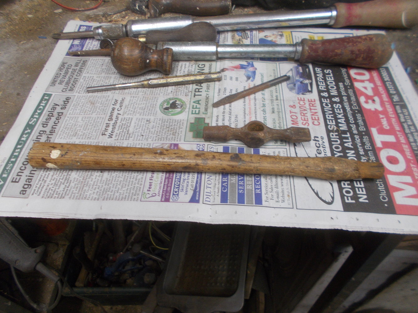

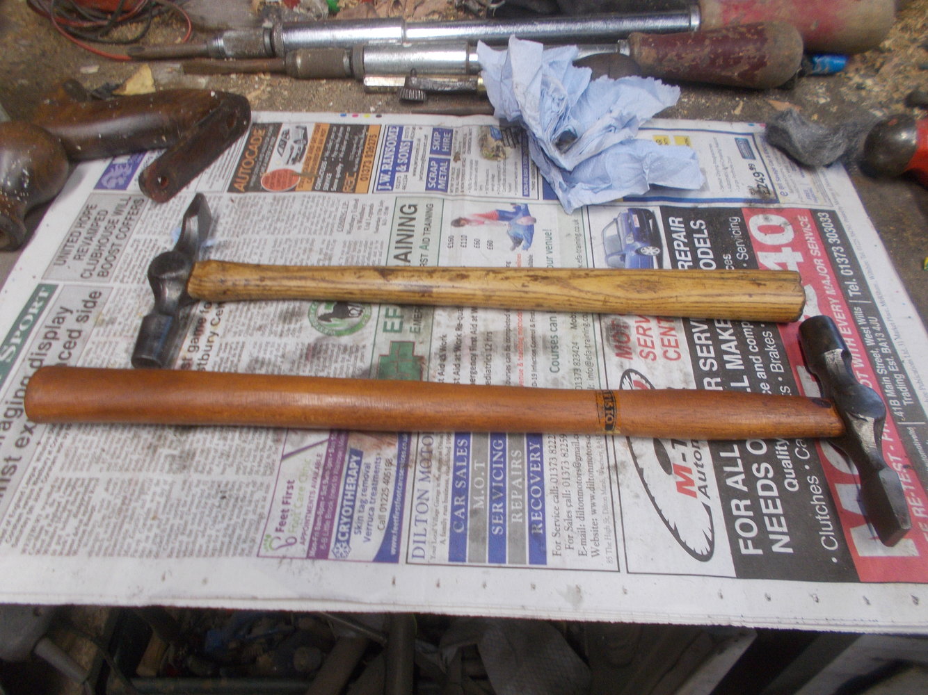

Couple of Hammers, both heads were loose on the shafts.
Both had nails forced in against the soft metal wedges to try and keep them tight.
So both had the nails removed, shafts cleaned up. Heads were cleaned with a bench grinder wire wheel.
The hole in the head was cleaned up, then 80grit paper was used to give a rough surface.
New Hardwood wedges made, then the heads refitted.

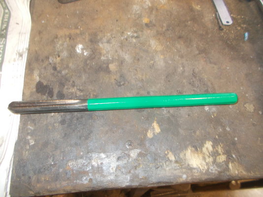

This 1/2" hand masonry drill has had a good deal of use.
Blunt, head mushroomed and a damaged flute.
I had time so why not.
I even redressed the tip. The information was in a Home improvement book, from the 1950's.

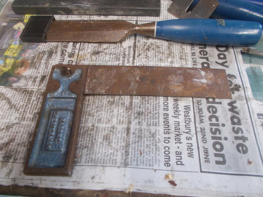

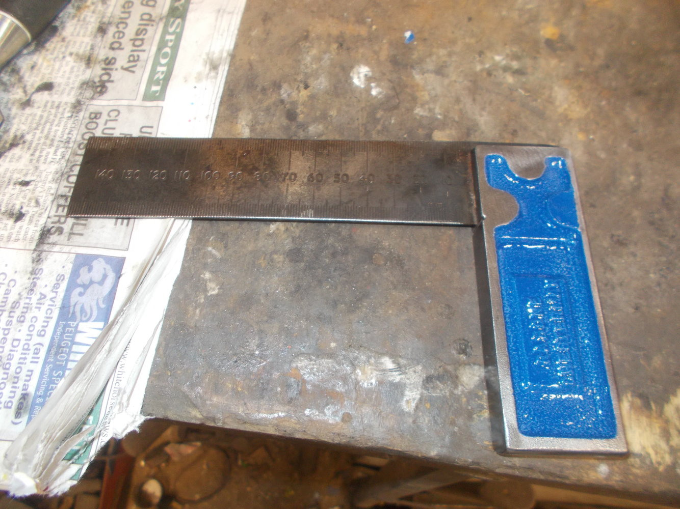

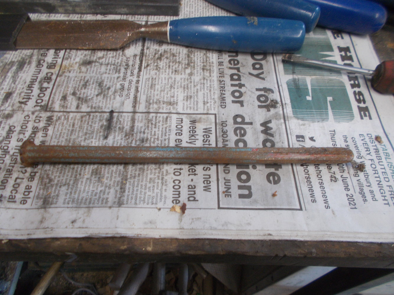

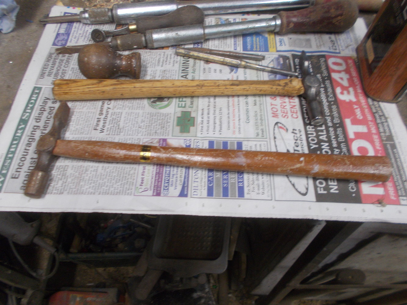

This square was one of those small jobs that was done to fill in time between the others.
The is the best side. The other was covered in white paint. That was easily removed with modern paint stripper. But the blue paint was some sort of Hammer finish, added in it's life.
Hot caustic dip had that off, then a clean up of the blade with a brass wire brush. The square faces had the rust removed with 800 grit wet and dry on a glas sheet.
All done. Just a few more coats of hard wax needed.
