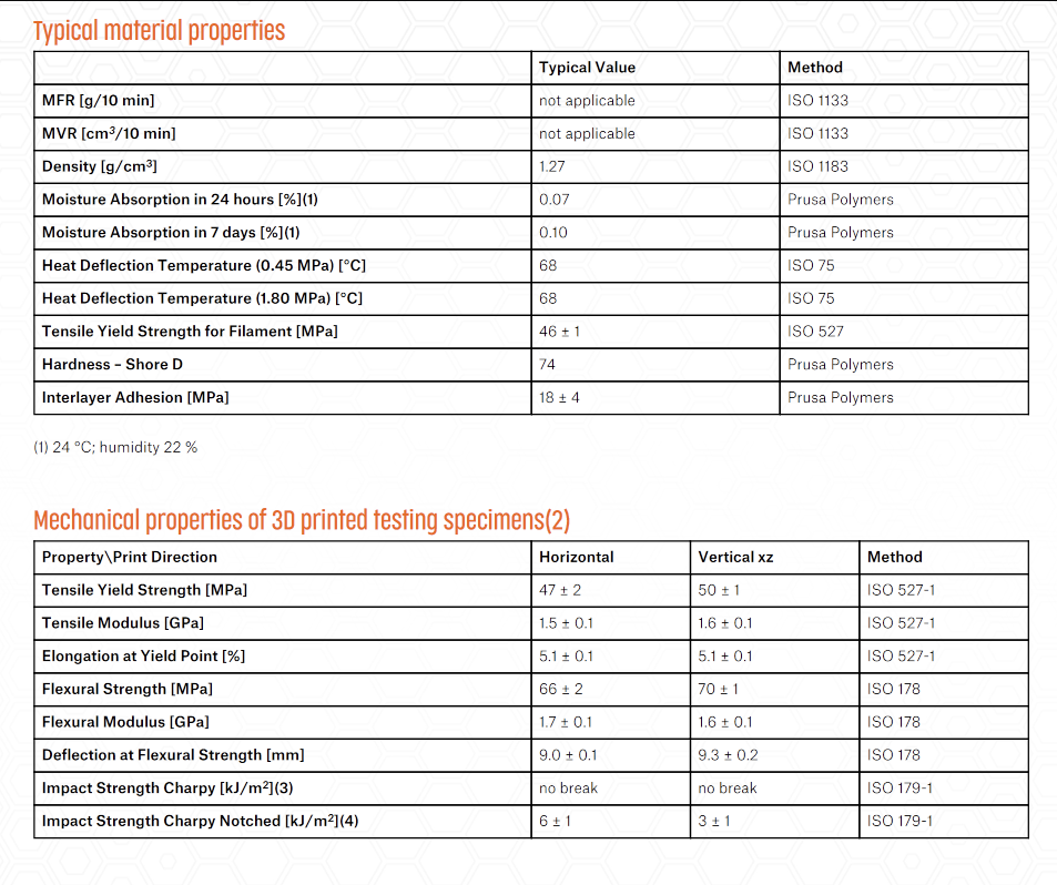

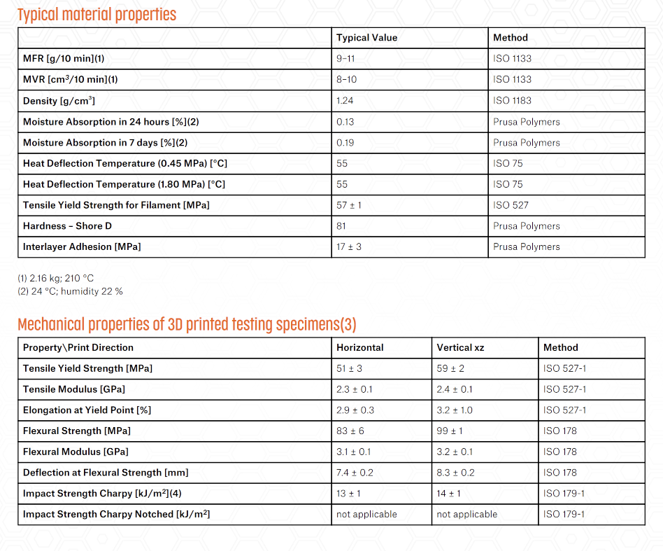

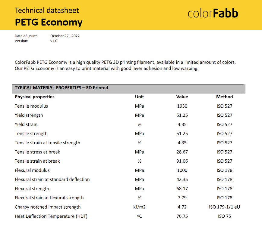

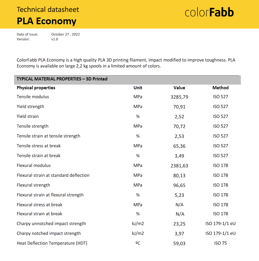

What are the general differences between PLA & PETG, in regard to suitability for certain types of item?
I haven't used PLA since I got the machine. My understanding is that PLA might be a bit stronger or tougher because it will yield. PETG is harder and "better" for practical working parts/mechanisms, has a higher heat tolerance and a lot less susceptible to UV degradation.
