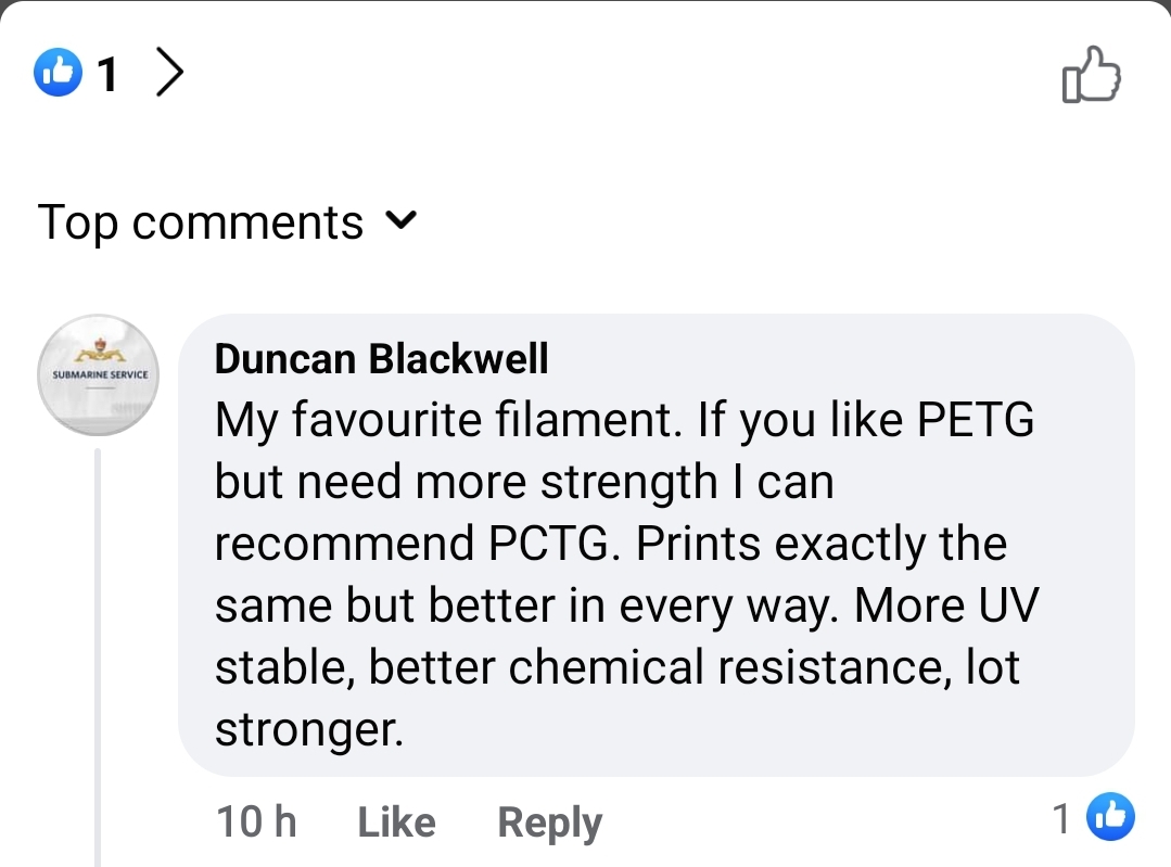

I would not know either way. But I read this on Facebook so it must be true.I haven't used PLA since I got the machine. My understanding is that PLA might be a bit stronger or tougher because it will yield. PETG is harder and "better" for practical working parts/mechanisms, has a higher heat tolerance and a lot less susceptible to UV degradation.
I told you...it was on Facebook so it must be true.I've tried PCTG and I wouldn't say it's stronger - it tends to have much lower layer adhesion than PETG so even though it matches up as a virgin material it's properties drop a fair bit in an as-printed state. At best it matches PET-G in things, quite often it's a good 20% behind it for absolute strength and yield points.

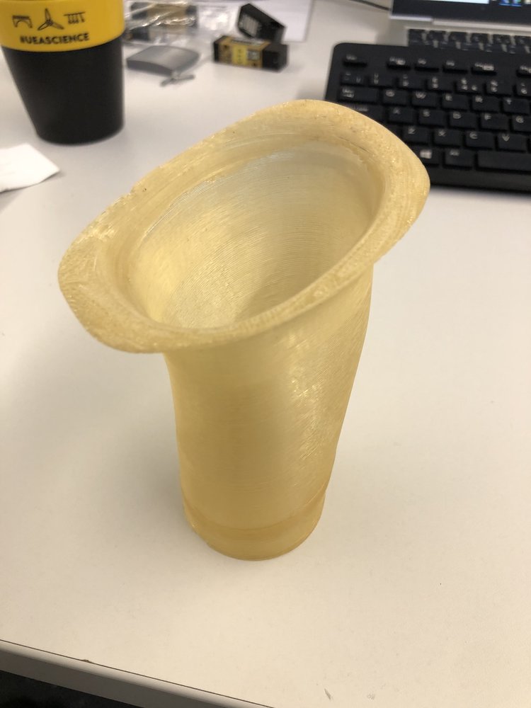

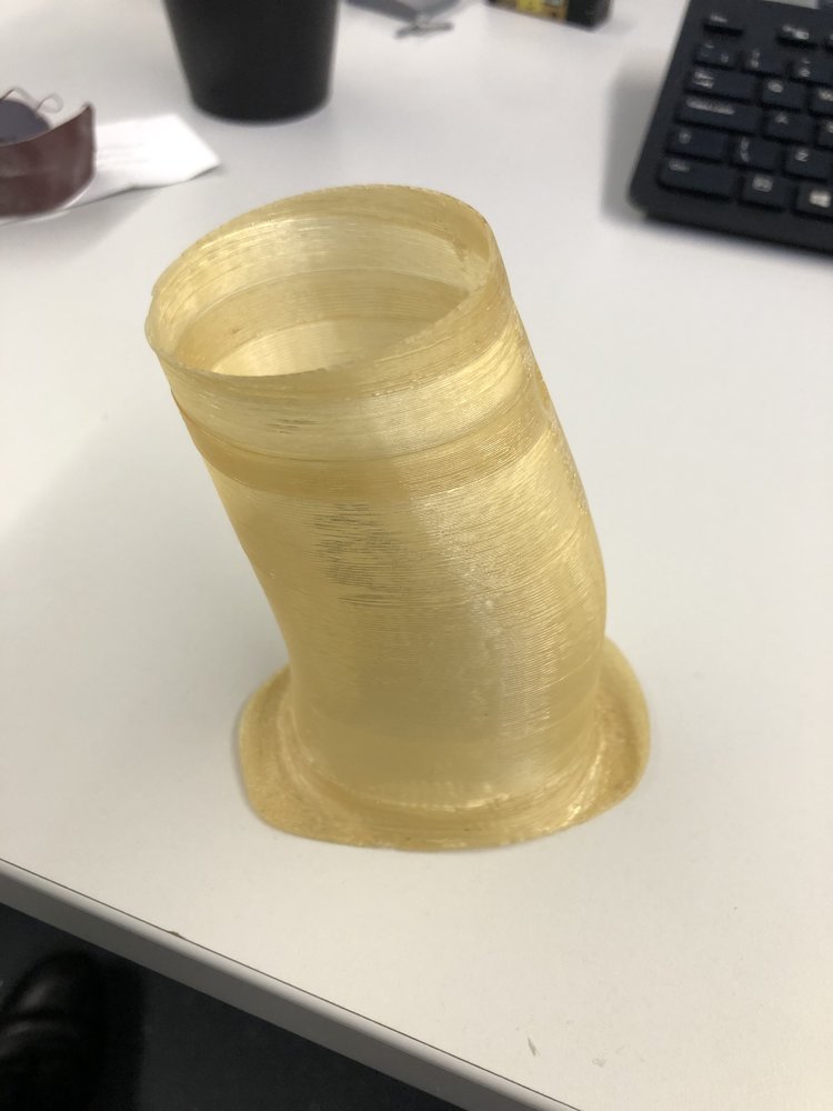

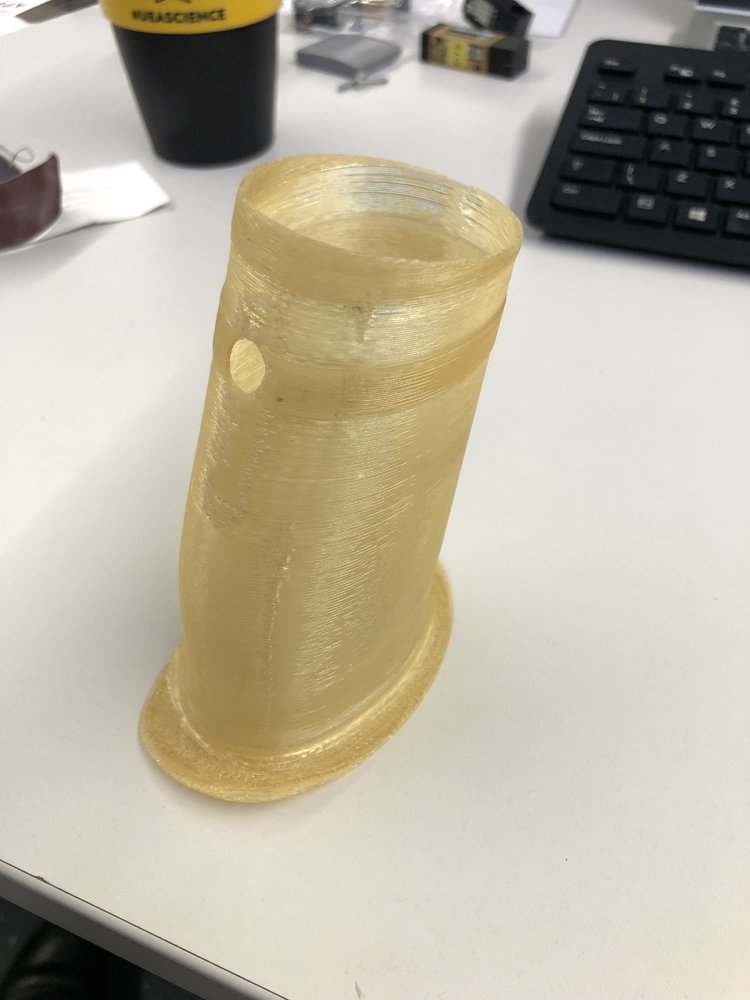

I had an enquiry to print some intake trumpets to see if it was a viable alternative to composite construction.
This is 0.8 mm wall thickness, printed in Ultem 1010.
So fuel proof, incredible heat capability, strong, good flexural strength, but notoriously difficult to print successfully on most printers.
Fantastic material
Remarkably strong for such a thin section created on an FDM printer.
Printer is a Stratasys Fortus 450.
