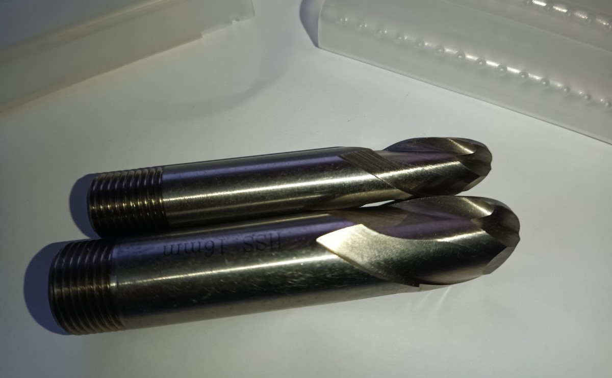

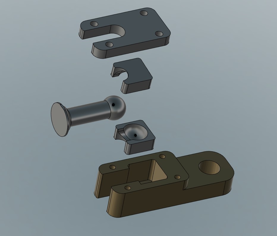

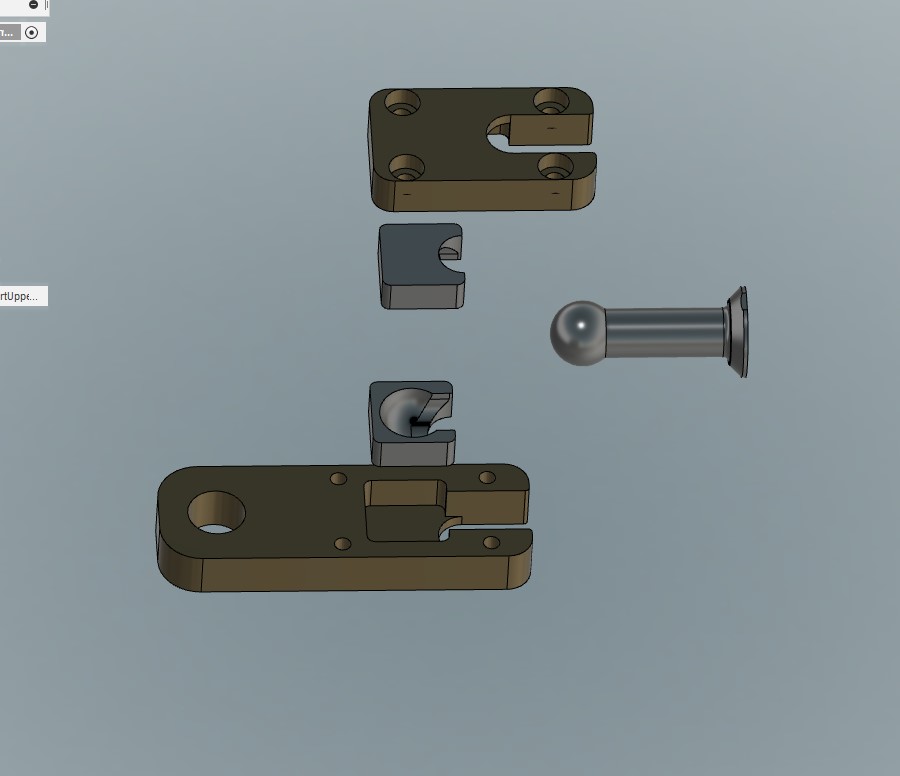

3D print the blocks or will they not be strong enough ?Today I acquired a couple of cheap ball end slot drills.
It is to make up a load of these from Acetal, hence why they don't have to be top quality, well as long as they are dimensionally ok.

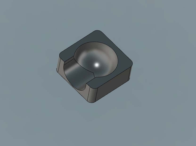

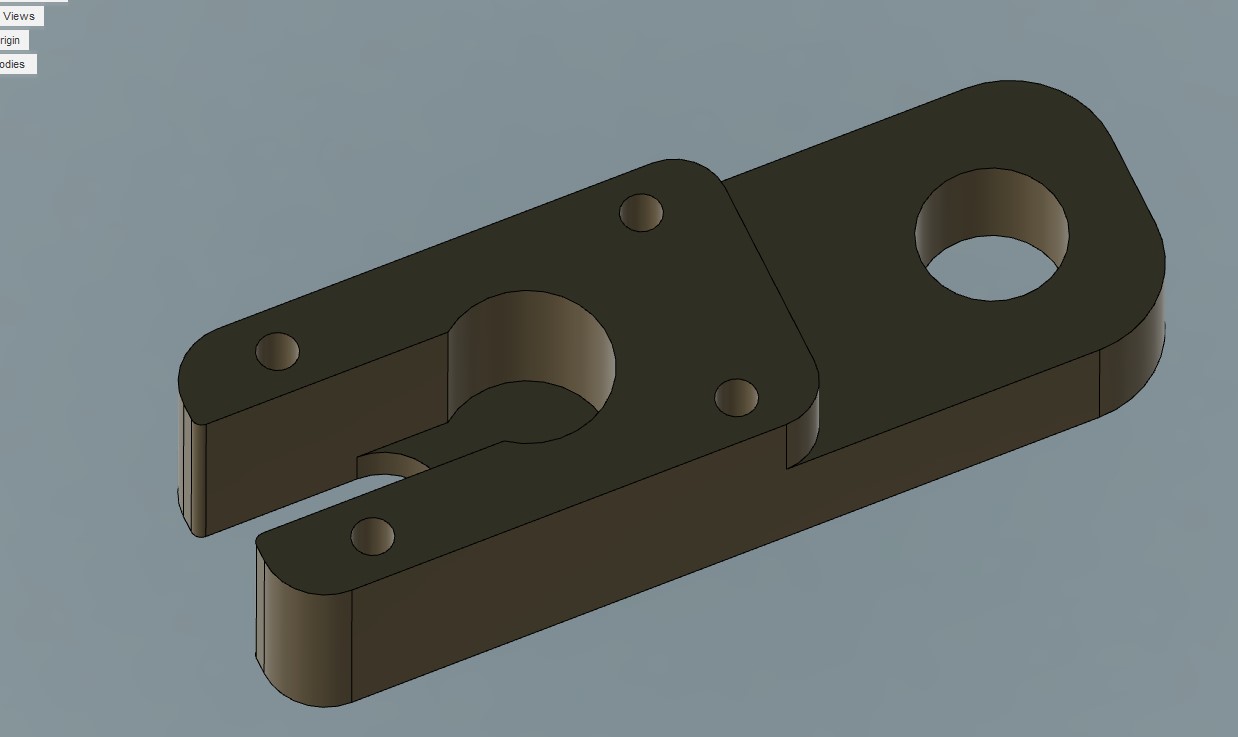

I have modified the steering joints I make for the Cats to incorporate replaceable wear parts, previously I just milled a round hole in the phosphor bronze for the stainless ball end rod to sit. Works fine but after a few years they start to rattle. Very little wear, not enough to affect their performance but it does introduce a metallic clatter when the outboards are idling.
So on current ones I will mill a square pocket for the inserts.
On any future ones I will make them two part and likely from 5083 aluminium which will cut the costs considerably.
