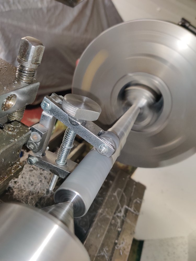

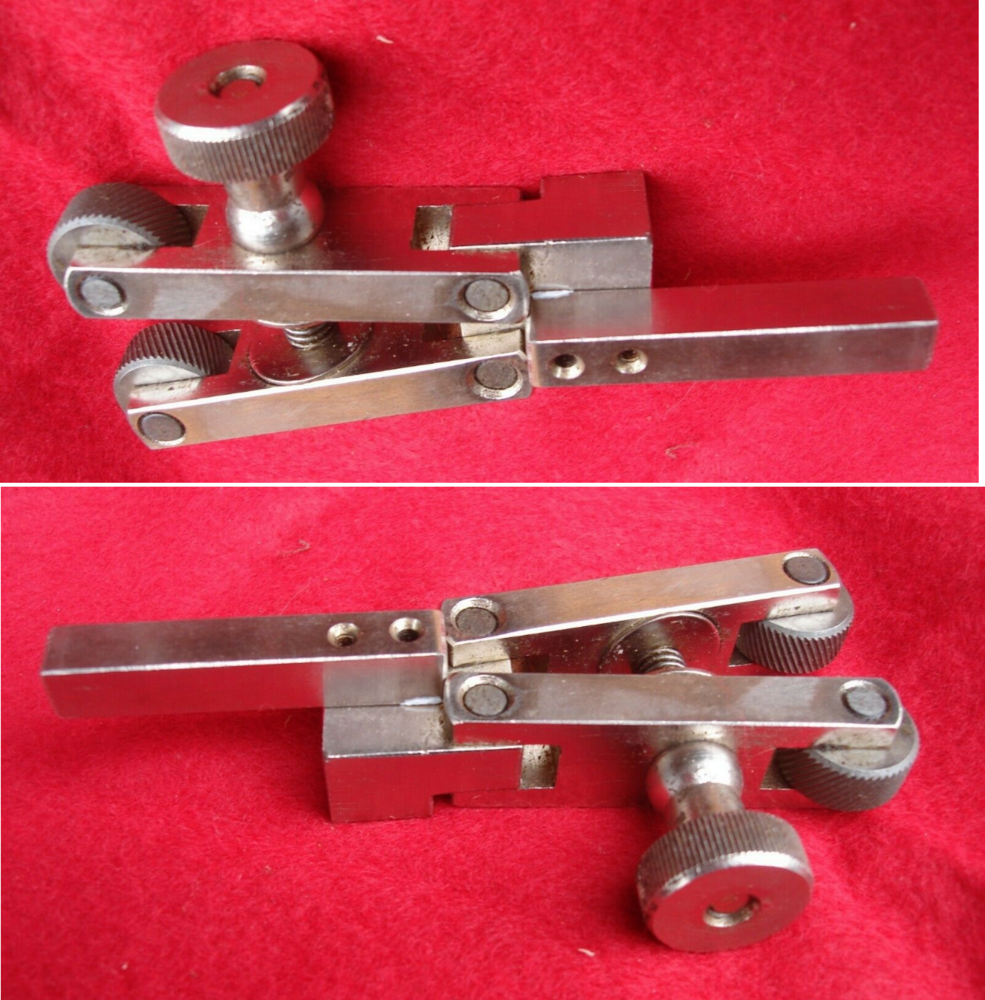

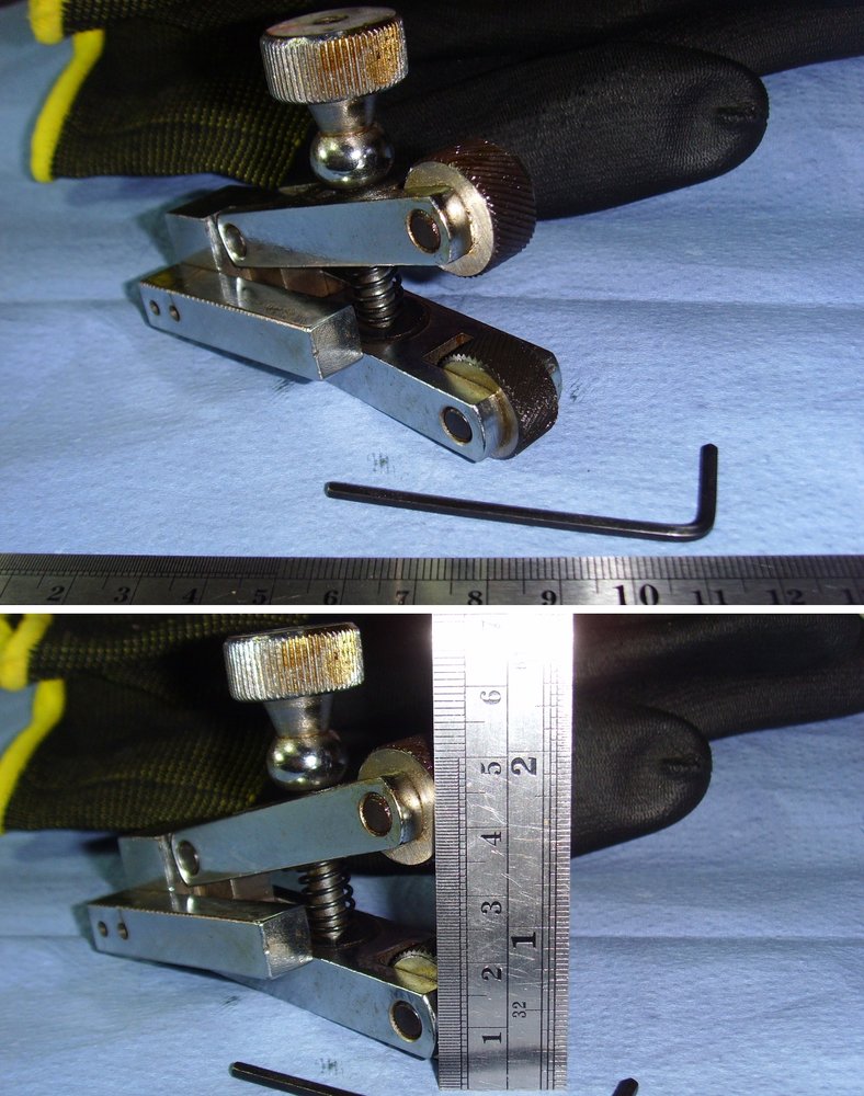

The two little wheels are spring loaded and hold the wire securely, the thumbwheel on the left adjust the distance between the two legs.

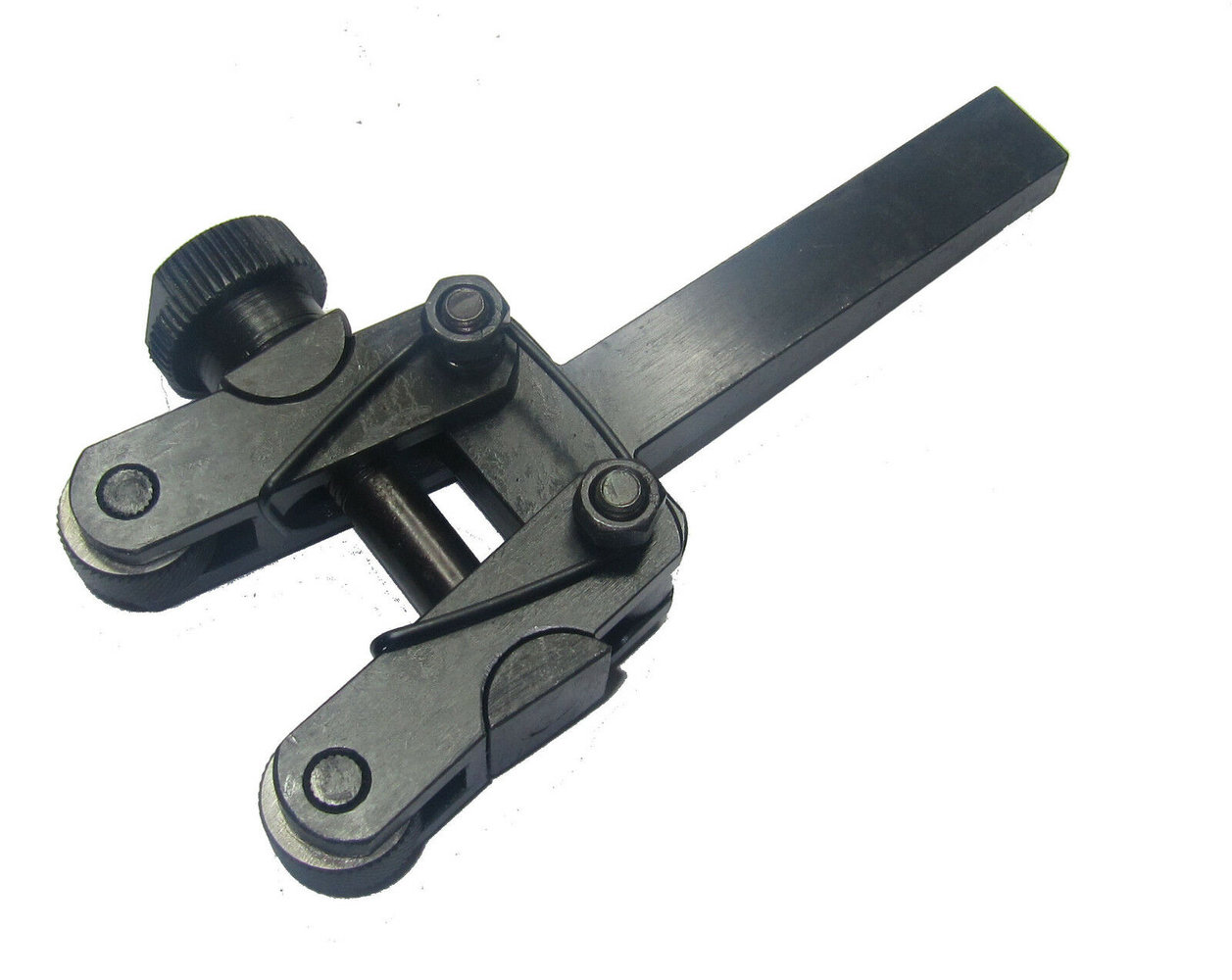

Don't bother with those knurlers, the clamp type work much better, especially on small lathes. A "Cut knurler" is the best but you better be sitting down when you see the price.
These clamp types are better. Kinder on the lathe bearings.
20 quid on UK ebay

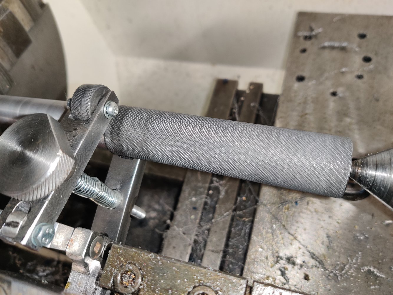

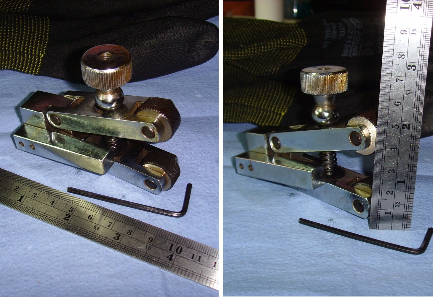

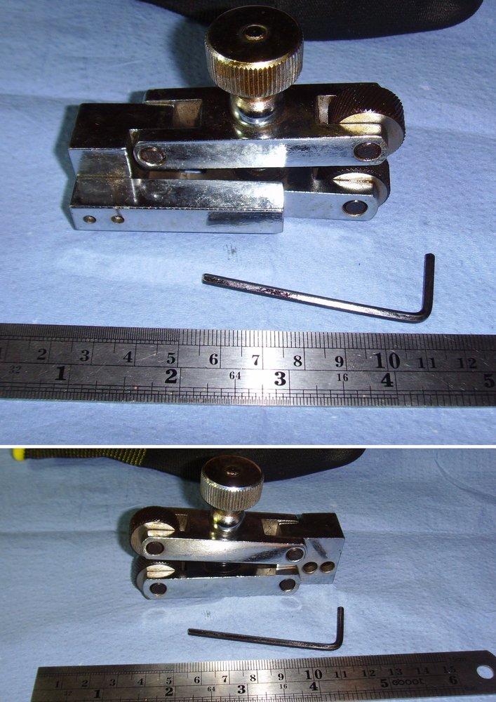

Im too tight to buy stuff so after @Kram kindly sent me some spare knurl wheels I made one
